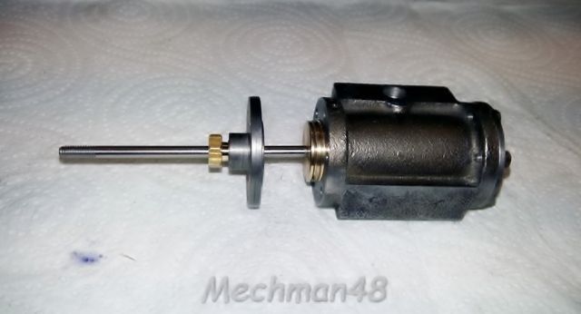

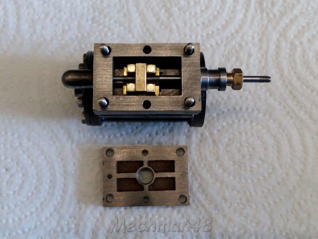

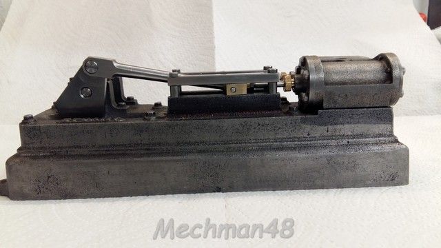

                                            A bit more done on my S50 engine…
                                            George.

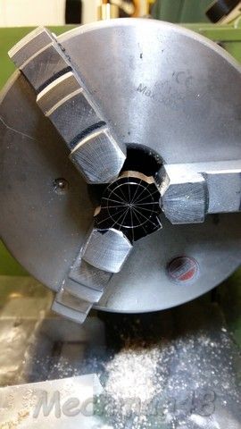

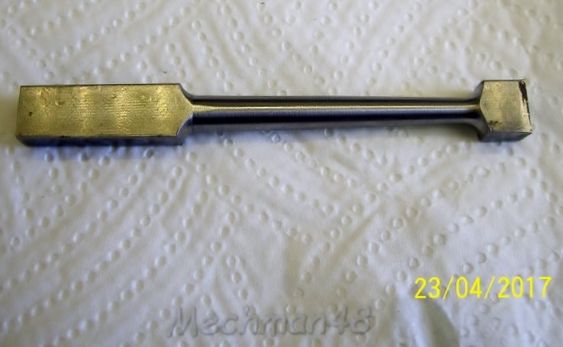

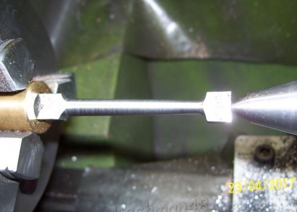

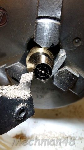

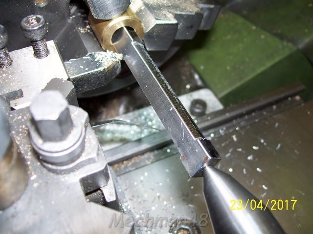

                                              Machined up the conrod & crosshead for my S50, getting there…

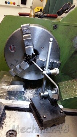

                                              ​couldn't be a****d changing from 3 – 4 jaw chuck so made up a split bush…
                                              ​Machining taper on conrod, bit to go yet …
                                              ​Ready for, cutting to length, mark out & drill crank pin & crosshead pin holes, actually marked out on t'other side…
                                              Trial fit to engine…
                                              George.

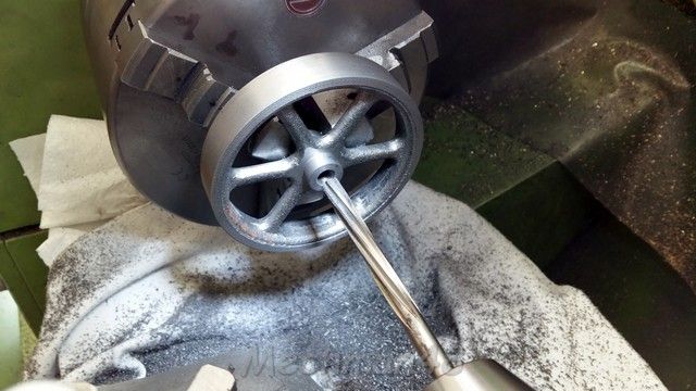

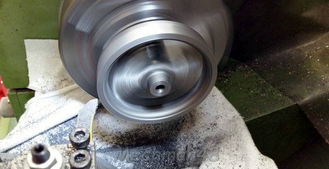

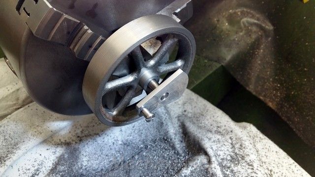

                                                  Machined up the flywheel yesterday…
                                                  reaming for crankshaft…
                                                  nice smooth fit…
                                                  George.

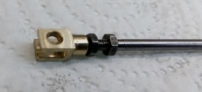

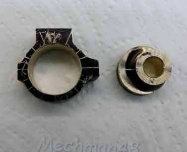

                                                    … Set up & machined the eccentric & strap, just need to drill & tap for 7BA lock bolt & split, drill for 7BA grub screw in the eccentric. Etch primed cylinder assembly, 1st coated flywheel… clean up & polish…
                                                    Establishing centre of eccentric strap…
                                                    Looks good…
                                                    Eccentric…
                                                    So far so good…

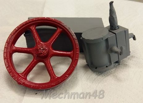

                                                    ​Etch primed cyl. Assembly & 1st coat flywheel.
                                                    ​George.
