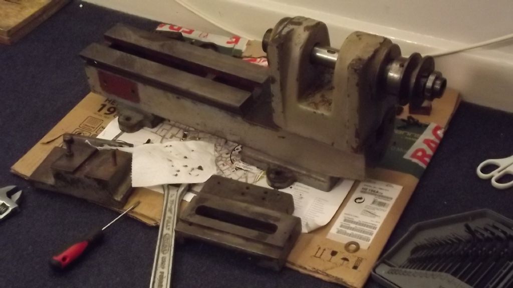

            Now own 3 lathes, will make a thread about it later

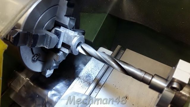

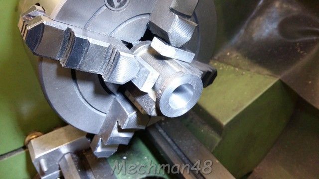

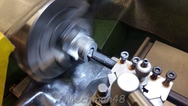

                Yesterday… Machined the cylinder of my S50 stationary engine…
                Flanges…
                ​Used 9/16 drill to minimise boring cyl….

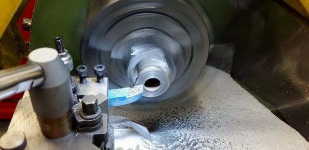

                ​Boring !…
                ​Bore finish looks pretty good… & its bang on .625"… this end; will check for parallelism all the way through bore as usually there is some difference by the time machining is completed… for me! so some judicious honing may be called for?

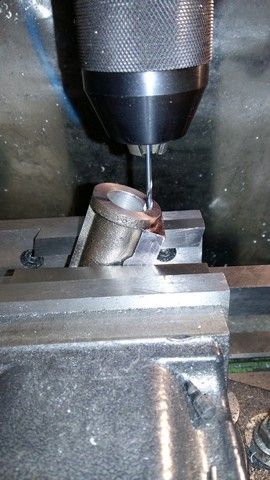

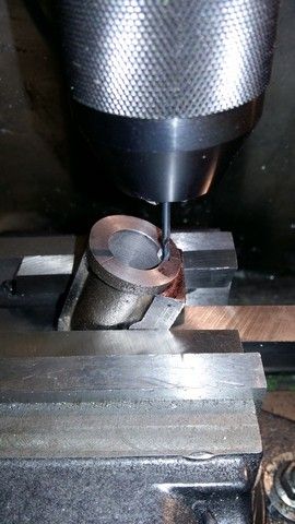

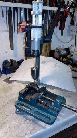

                    Update on my S50 progress, drilled & tapped cylinder fastening holes, drilling steam ports, or in my case air passages, plus a concocted home made tapping stand…
                    Drilling angle worked out at 21*…
                    ​Home made tapping stand…
                    ​George.

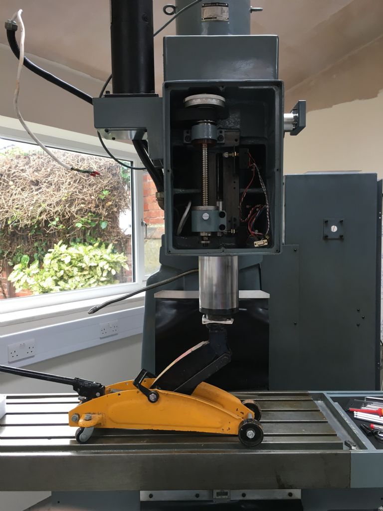

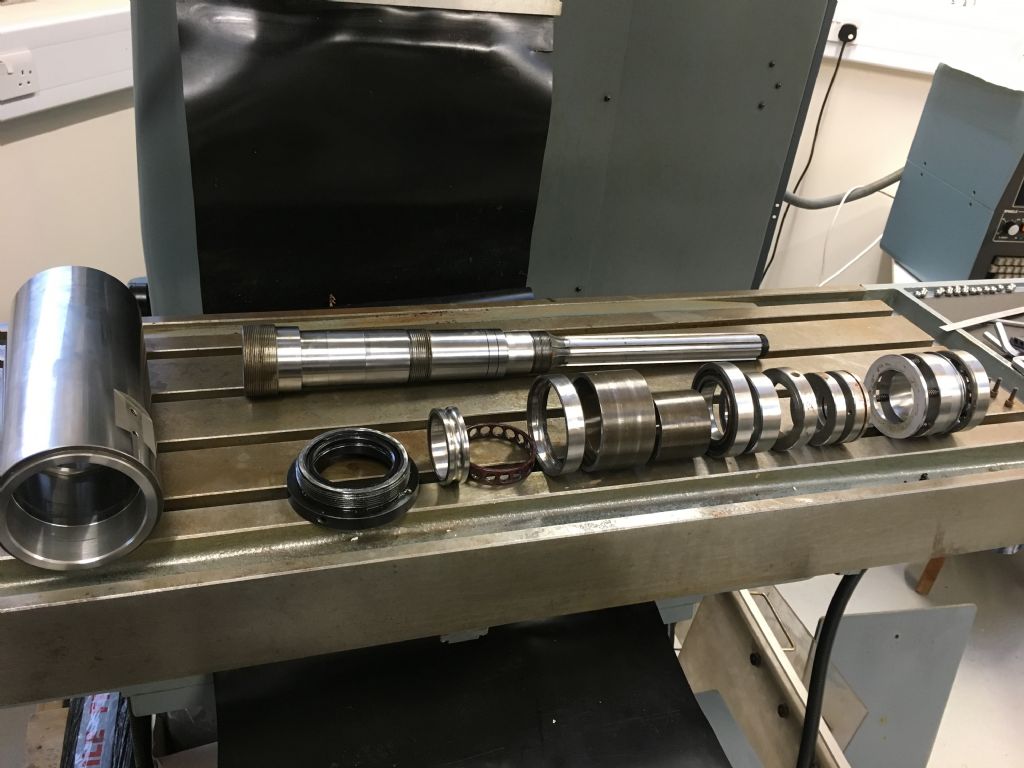

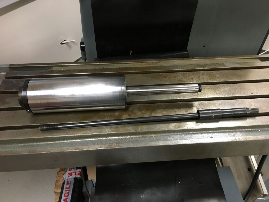

                        I've also been doing more work on the Shizuoka CNC milling machine. Having overhauled and replaced the X and Y axis leadscrew bearings before my travels, I moved on to the spindle and quill. It didn't sound or feel right to me and was actually quite difficult to turn when I first got the machine. It had been in storage (industrial unit) for 10 years but there were no signs of water damage on any of the exposed metal. I may never know what the problem was.
                        I dropped the quill, using a trolley jack to control its descent(!), then dissassembled the spindle and bearings. I was relieved to find that the 3 bearings are fairly standard sizes and I was able to get good quality replacements from The Bearing Boys – a pair of matched Nachi angular thrust (main) bearings and an SKF radial (top) bearing. Some change from £200, so could have been worse. Now feels and sounds a lot happier.
                        On the good news front, I also recommissioned the Bridgeport clone milling machine (VFD, DRO, power feed, quick change drawbar etc). On the not so good front, the ancient controller on the CNC mill has just died. I'd hoped to reverse engineer the existing servo drives while they still worked but that would be pretty tough to do on a dead system. I reckon the CNC gods are telling me something. So I will need to rip all of the 1980s electronics from the control cabinet and set about installing the Chinese controller I brought back in the luggage last week from scratch.

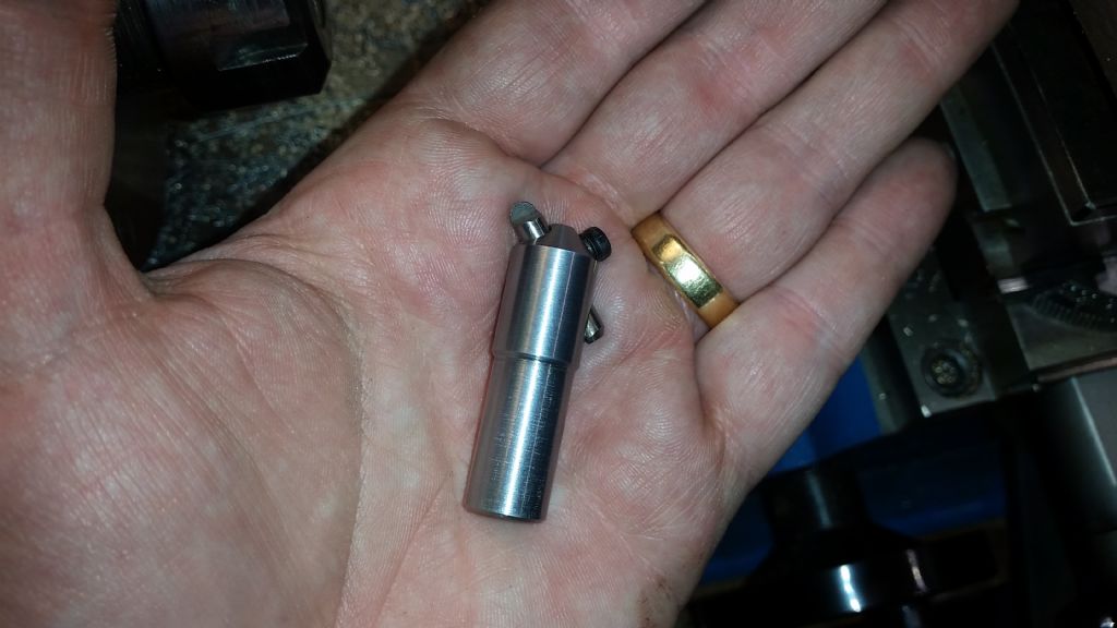

                                                  Made a little fly cutter-cum-boring type tool…
                                                  Oh badger will add pic from PC in a while…
                                                  Edited By Steven Greenhough on 31/03/2017 19:25:15
                                                  #291522
                                                  Steven Greenhough
                                                    @stevengreenhough56335
                                                    As promised…

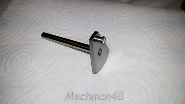

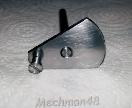

                                                      Made up the crankshaft, web & crankpin for my S50 engine…
