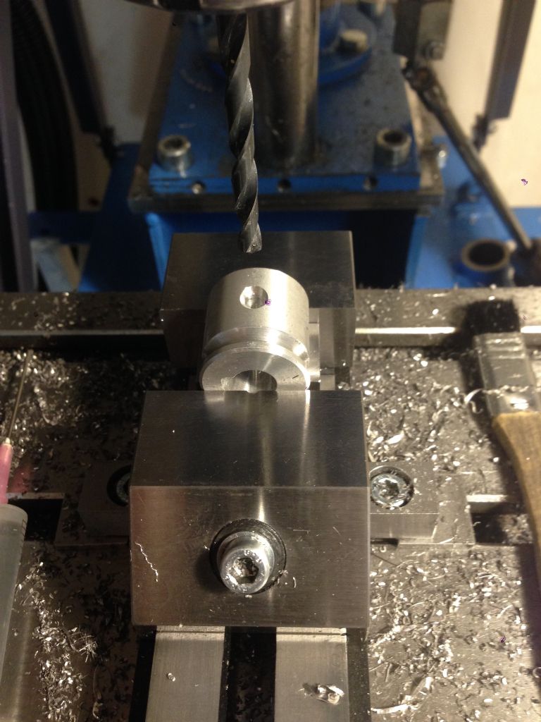

          Benny Avelin
            @bennyavelin86238
            Thought this would be useful. Not sure

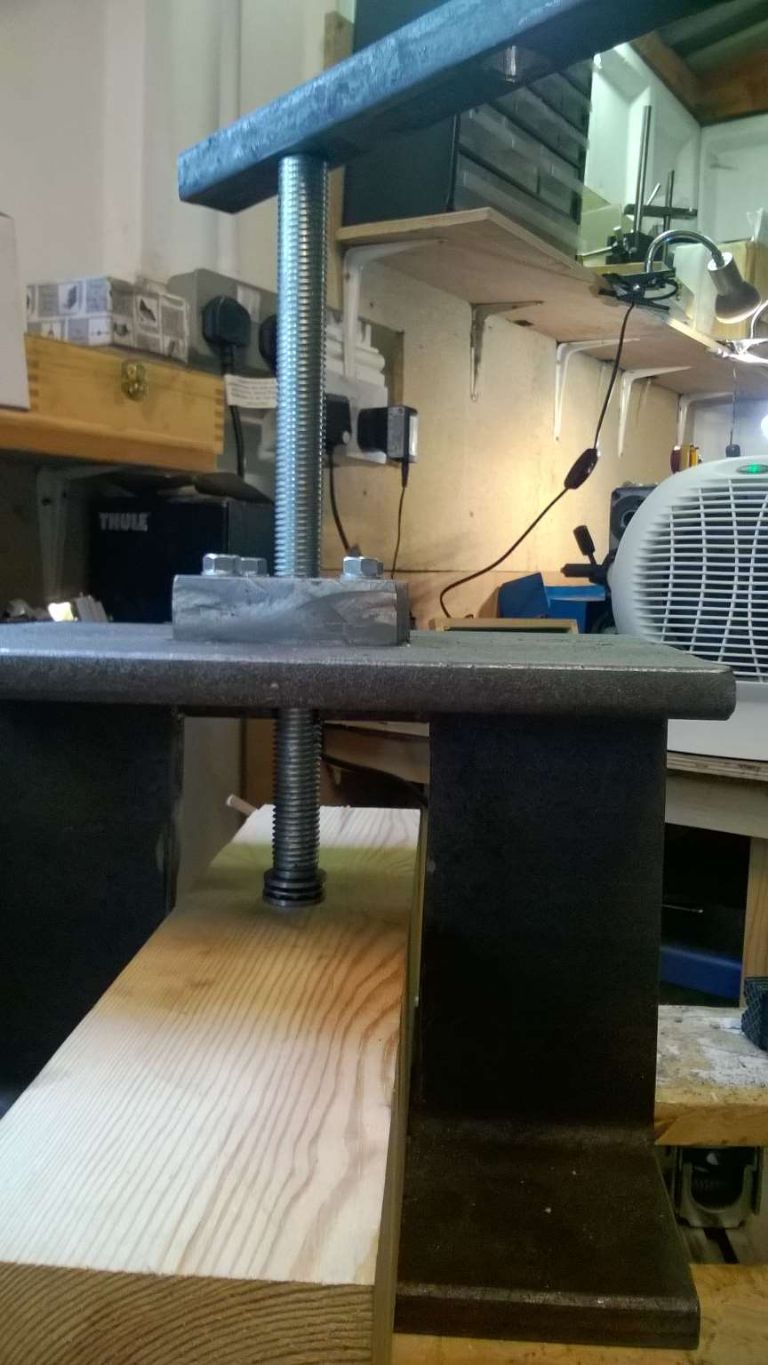

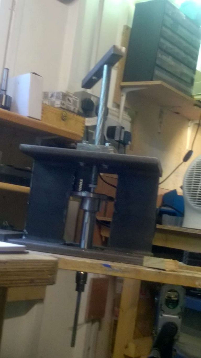

                  The scrapyard press!
                  At long last I've finished my press. It's designed to press down (not the thrust bearing at the bottom)
                  And pull up.
                  My new spindle is shown in this example.
                  Hopefully, I will now be able to disassemble and reassemble the headstock without recourse to a hammer and I will instantly become a brilliant lather…
                  It's not pretty, but it should be able to squish stuff nicely!

                    Benny, it will be. I made a similar device using the spindle and chuck from a defunct Makita battery drill fitted to a wooden handle. Only took half an hour or so, very useful for holding small screws and pins for grinding or filing. Dave

                      JA, I actually made it to hold a countersink so that I could hand-deburr stuff, but as a pin chuck it would be great… why didnt I think of that?
                      Michael, I didnt have a file handle I felt I could spare so this was the easiest step, took maybe 15 min or so. But I am lost as to why a centerdrilled hole would be of use, what am I missing, a small chuck for turning between centers?
                      Dave, great!

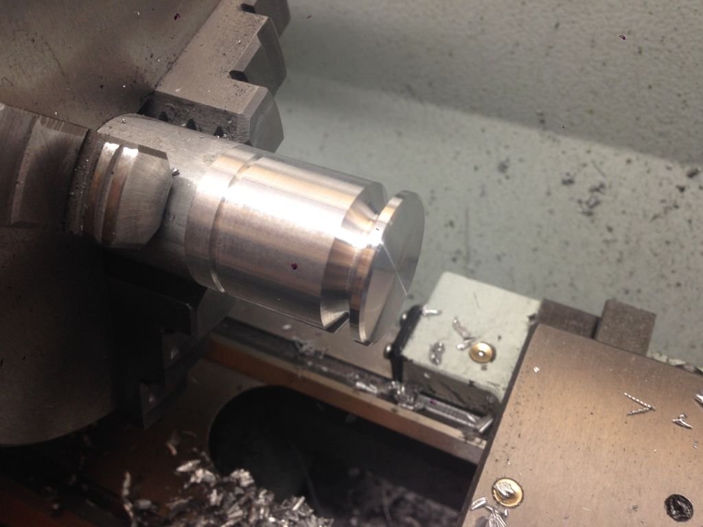

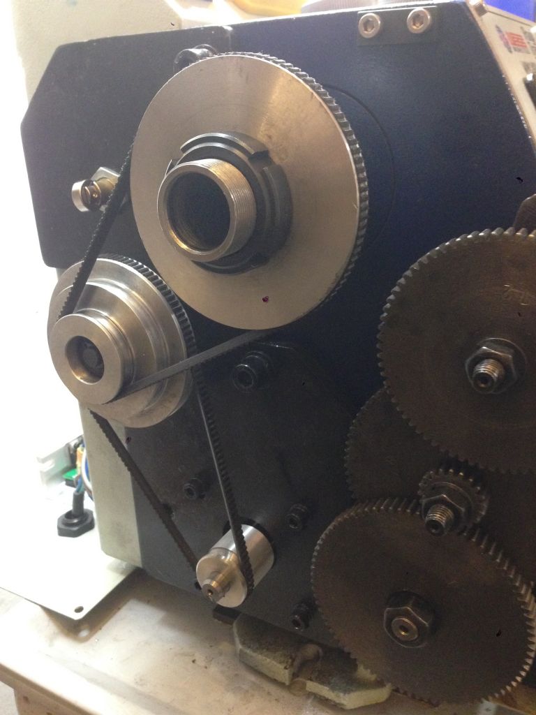

                                  Benny Avelin
                                    @bennyavelin86238
                                    I decided to perform one of Steve's improvements as found on this website **LINK**. This amounted to turning a new pulley for the motor, this one is approximately 1" (25mm).
                                    My particular version of the mini-lathe had a different setup for adjusting the belt tension, essentially there was no bracket at the end where the adjustment screw was, instead it was built into the plate, so I had to begin by milling away that material, making a flat on the top and two holes for mounting.
                                    This is how the bracket turned out
                                    Everything mounted and adjusted, now the max rpm for the low ratio is 600 and the max for the high ratio is 1200. Previously it was 1200 and 2400.
                                    Looking forward to trying it out.

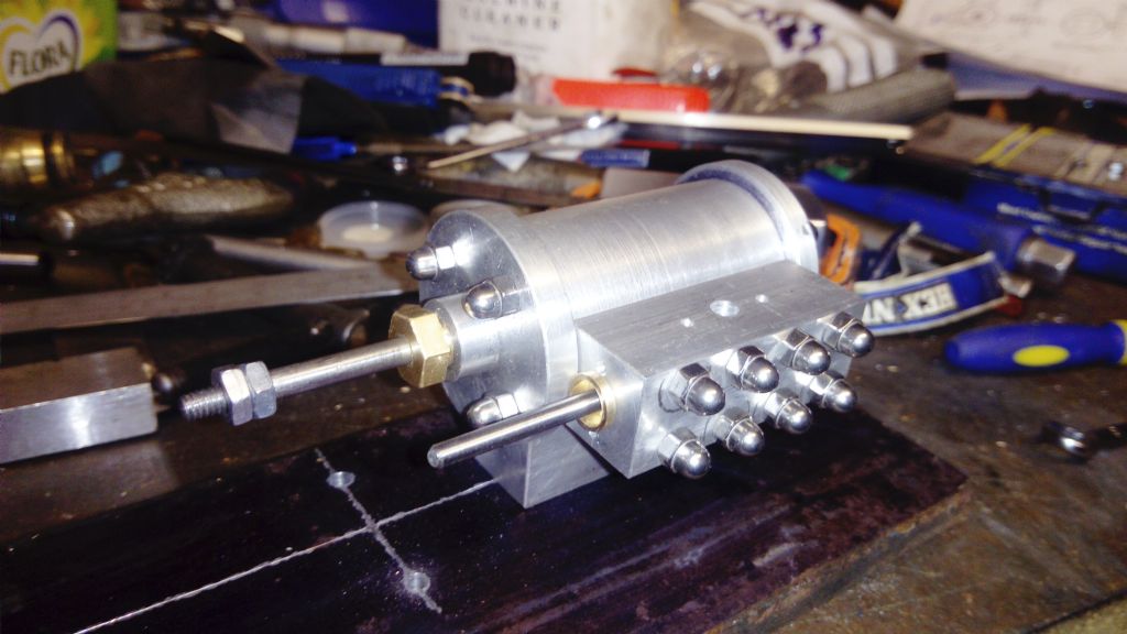

                                                    so I am glad to say I am finally making some progress on my horizontal mill engine
                                                    have got the cylinder and the valve block all done, I just need to get some M2 stud and nuts to finish the bits on the valve block, and even managed to get it bolted to the base, at least it is a start 😀

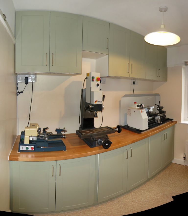

                                                      Finally finished my new machine bench
                                                      The photo shows the bench and cupboards installed along one side of my small upstairs workroom (2.7 x 2.1m). I had to stitch a panorama to get everything into the picture!
                                                      It is based on kitchen cabinets with extra strength from wall plates back and sides and two stout triangulated brackets that go between the cabinets. The static load is taken by the cabinet legs to the wooden floor, the brackets taking dynamic loads back to the wall. The result is satisfyingly rigid.
                                                      more…
