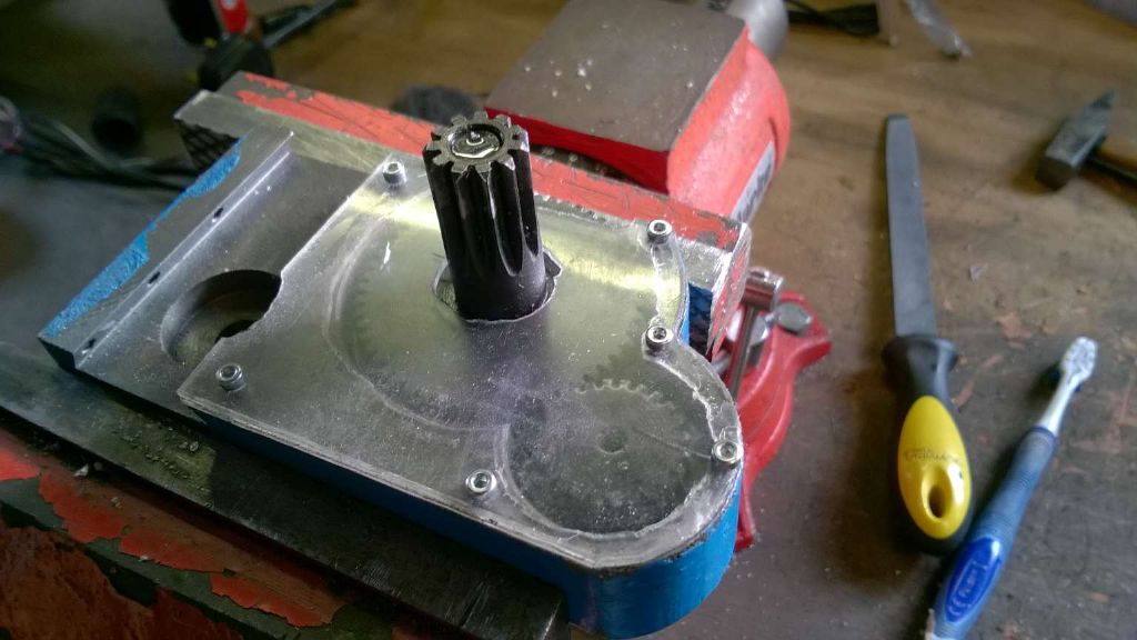

        An unusually productive day today.
        I've stripped my lathe down and have been Wyattising it
        This fairly nasty piece of work is to keep swarf out ot the saddle gears. In my defence, I broad my fretsaw blade after doing the outside and can't find the 10 I know I have somewhere. The inside was done with a dremel hence the erratic nature (I know – bad workman and so on).

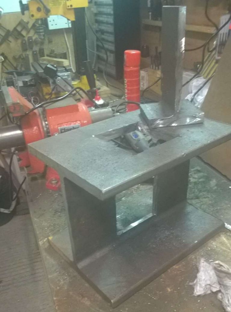

        To do that I'm making a press. A bit of 12 inch girder from the scrapyard is the starting point. Chop out some of the middle…
        A strikingly challenging task which has consumed 2 angle grinders half a dozen milling cutters, a hacksaw blade, a considerable amount of time and a very large amount of bad language.
        Today I was boring out the hole in the top with a core drill. The girder *just* fits under my mill, so I was able to mill a flat on the top, but no way will it get a chuck there. and I'd burn out it's little motor.

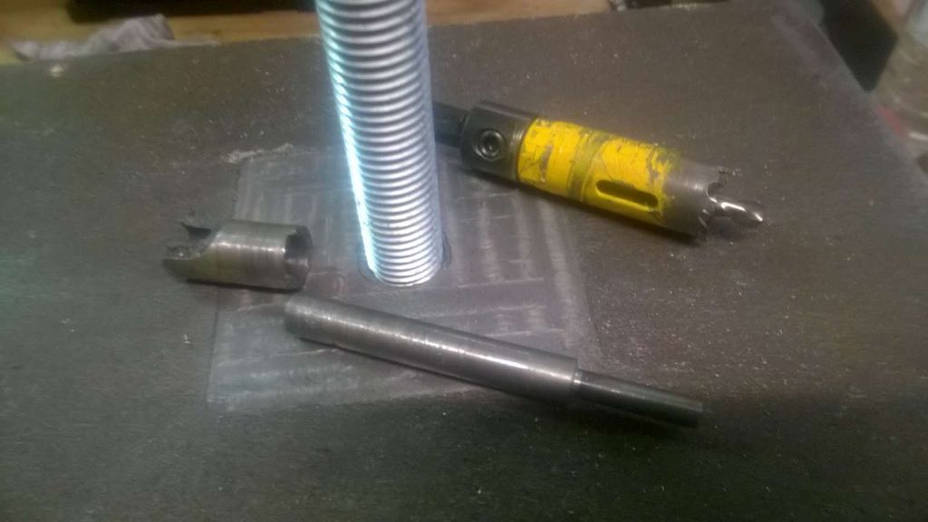

        This worked much better than I expected, though it took 20 minutes or so. I'd managed to get a 10mm hole through with a milling cutter, so I made an 10mm/ .25 adapter for the arbor which work quite well (which is what I've been waiting for to get the lathe back together).
        core drill top right, core on the left and the adapter (the drill bit wasn't in of course) at the bottom.
        I did try and cut an M20 rod on my lathe, but this was not a success, so I invested in one made by a professional.

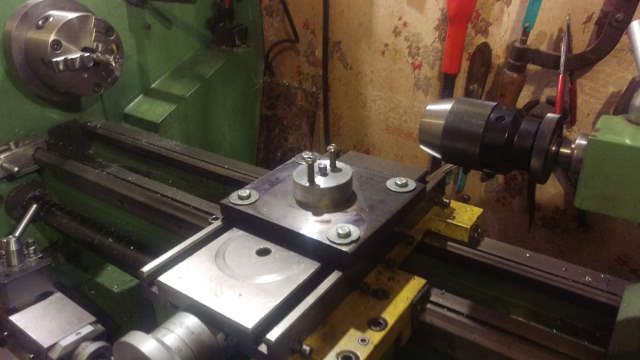

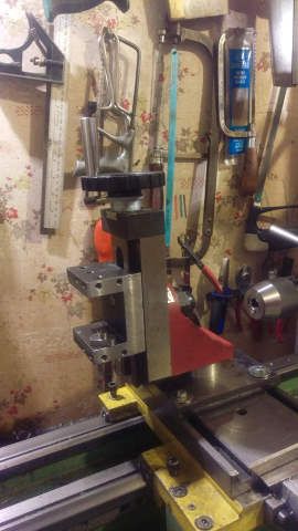

                            Finally got around to making a milling/drilling attachment for the lathe. I didn't want this to be a big complicated project, nor did I have any suitable motors or other bits in the junk pile.
                            I did keep the mini-lathe vertical slide when I bought a bigger machine, and it seemed sensible to have a collet spindle. So, I bought an ER11 spindle motor, and adjustable power supply, mount and collet set off Ebay for about £80.
                            This replicates the mini-lathe slide mount, and can be positioned anywhere along the cross-slide:
                            Slide in position, although it does need more support along its front edge:
                            The extra holes allow the spindle to be fitted along the lathe axis:
                            or across it:
                            The slide tilts and the mount rotates, so all sorts of weird angles could be created.
                            And a quick and dirty test piece using a 6mm ball cutter and indexing the chuck jaws by eye:
                            Used with a headstock dividing attachment(my next job: one of the stepper motor types) this will allow easy cutting of the clock wheels that were the real reason for making this, keyways, milling squares and hexes, fluting and drilling on a PCD without having to move the workpiece to the mill.
                            Edited By Nicholas Wheeler 1 on 19/02/2017 22:41:45

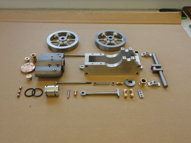

                                            Today I finished making the parts for the Jowitt poppit valve engine drawn by Jason B. I’ve made few changes from Jason’s build log, mainly in materials to suit what was to hand and fabricated flywheels rather than use castings, but it’s taken a while longer than Jason did.
                                            All (all??) I have to do now is get it running and paint it up.
                                            #285300
                                              Looks like a very good job so far.

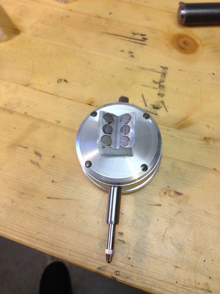

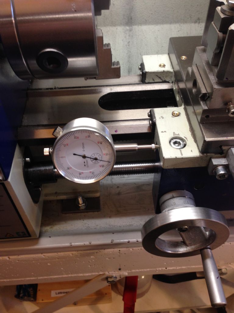

                                                I have finished this magnetic backside for a cheap indicator I had bought a long while ago. Works like a charm both for my mill and my lathe.

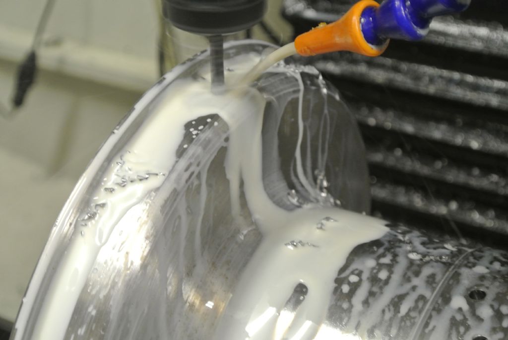

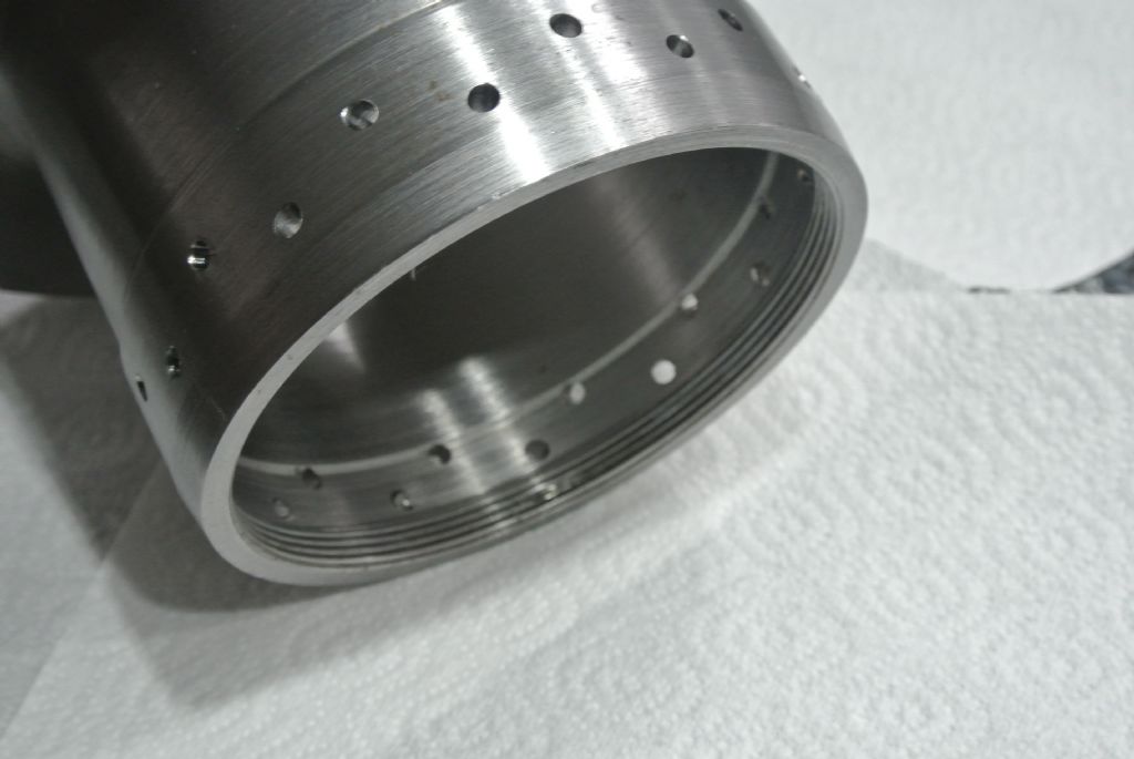

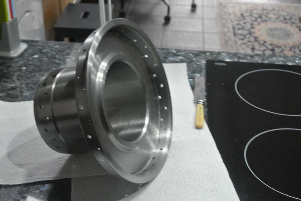

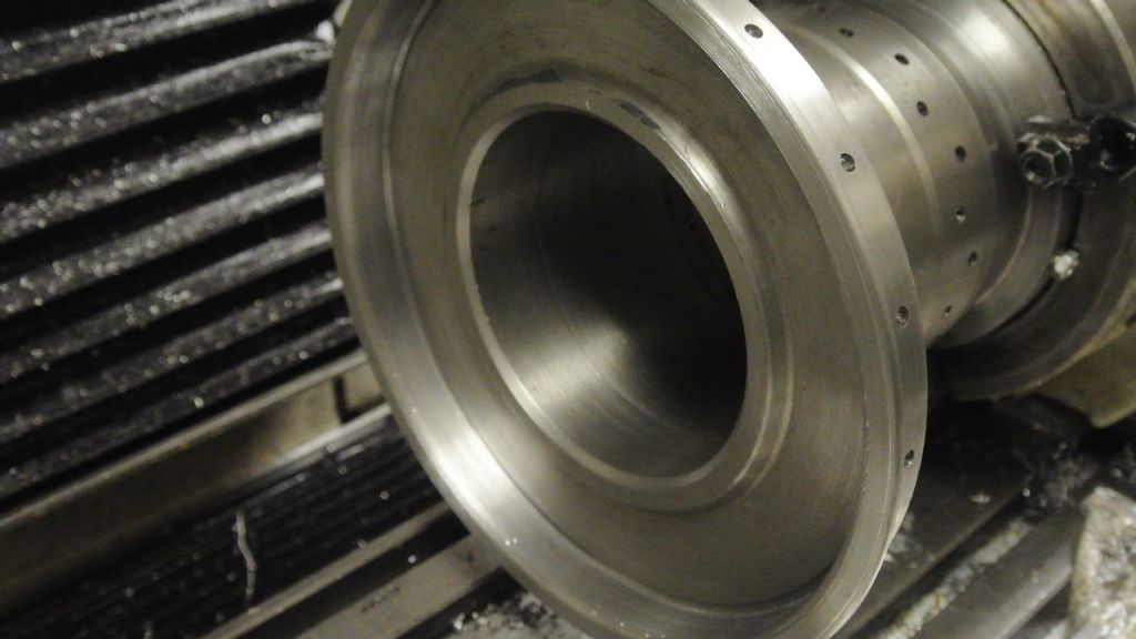

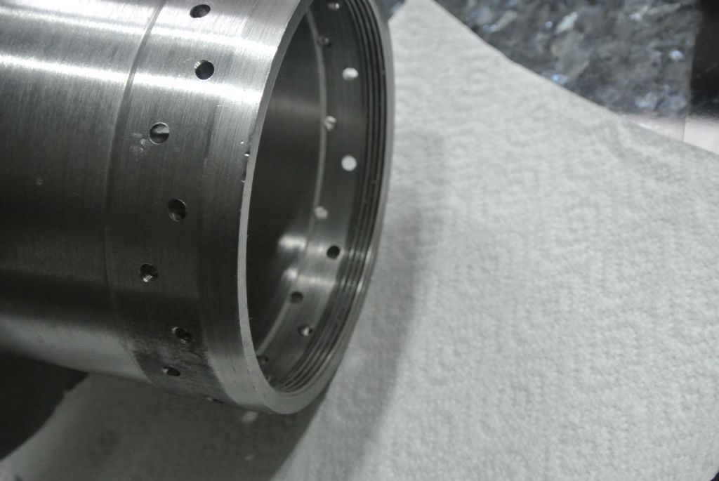

                                                  Today I finally got one of the batch of Wire Wheel Hubs I am drilling for somebody done after recovering from a nasty CNC crash. This was caused by me making a Freudian slip when I entered a Z value in my g-code as 48 instead of 84. I could see that the spindle was going to hit the work if I didn't stop it but I had the camera ready to take a picture and by the time I put it down it was too late.
                                                  The spindle contacted the work, snapped the drill, rotated the threaded hub anti clockwise and while it was doing this it pushed the adjustable angle plate out of alignment and ground the ER collet nut up a bit. The hub seized on the thread and took a lot of effort to get it off the faceplate fixture. I had to take the fixture off the rotary table, put it in the lathe 4 jaw chuck, fit the three jaw chuck on the small diameter and using metal bars and a 3foot long cheater bar on the end of one of them work the hub free. Much to my amazement there was relatively little damage to the threads on the fixture or the job and I was able to dress this with the Dremel. The outer diameter of the hub was badly marked and I had to re-machine this to get rid of the damage but I don't think this is critical so all in all a good recovery.
                                                  The job is not as straight forward as it looks because the spokes are drilled at an angle through the small end so the two rows of holes at that end are drilled separately with the angle plate set at 14 degrees then 13 degrees respectively. They are also drilled with an offset from the centre line. Getting the angles sorted out and drawing the hub was the biggest part of the job. I still have to countersink the holes which I will do as a separate programme but at least the main bit works.dsc_4078.jpg
                                                  Edited By Bob Rodgerson on 23/02/2017 11:05:36
                                                  Edited By Bob Rodgerson on 23/02/2017 11:14:50
                                                    The time between tool to metal contact and hitting the E-stop is the shortest period known to man; and is always positive. crying 2
                                                    Hooray for CNC I say. thumbs up
                                                    Andrew
