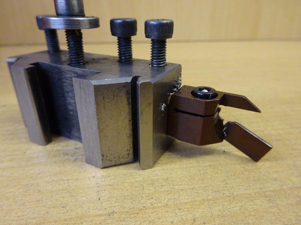

            Well there could be one other reason for the dodgy colour of teh photos as the air in the workshop was a bit blue todaycrying

              Ouch !!
              I have been pondering whether to buy one of those grooving tools for a while now.
              You have just made up my mind for me.
              Phil
              #282536
                Phil, thats a 10mm shank one so if you could fit a 12 or 16mm holder in on your lathe that would have a bit more meat under the insert.
                I like it a lot, cuts well and the 2mm dia end inserts are nice for getting a small internal radius as can be seen on the conrod and the crosshead where the round joins the rectangle.
                Think I may not have had enoug material in te collet. It happened about half way through parting off the piston from 1" bar and ther was only about 10mm length in the 5C collet.

                  Good grief, that's a bummer and a half. If it had happened to me I'd be on the third beer by now.

                    That's an >ouch<

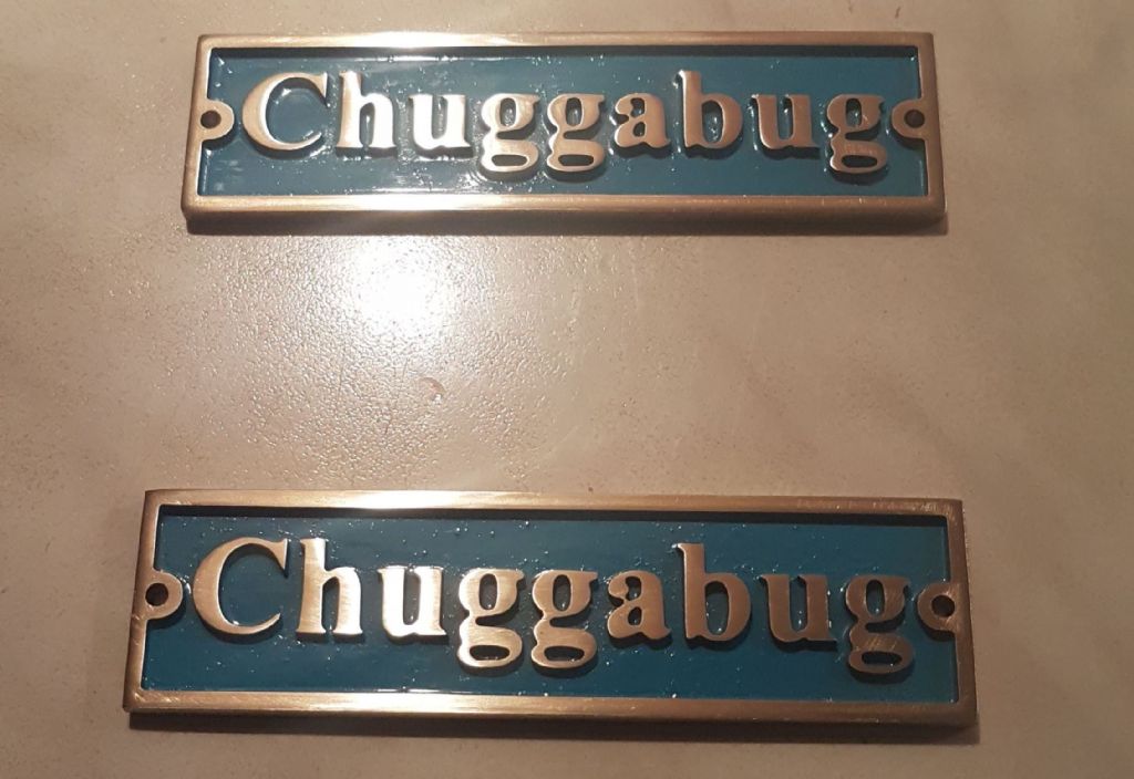

                        A while back I posted on this thread on making some Tich nameplates – here's the finished articles, thanks to John Lintorn for letting me post this picture.

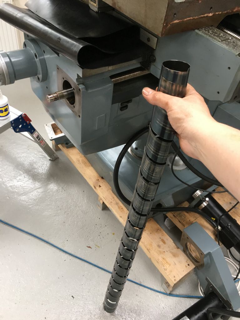

                                              Made good progress removing the bearings from the X and Y axes of the CNC machine. The X axis bearings were moaning louder than a Daily Mail reader on the Jeremy Vine program and sure enough the bearing surface was visibly shot. The Y axis bearings didn't sound too bad but it seemed like a good time to check them. As it would be otherwise exposed, the Y axis ballscrew has those conical spring covers to keep swarf and coolant off it. I knew it would be easier to get them off than to get them back on but obviously that didn't hold me back. So now I have the challenge of getting the thing back on.
                                              Genie and bottle
                                              Sounds easy enough but the large end has to fit into a cylindrical hole that is smaller than the spring wants to be and it is a spring ie wants to be longer than the ballscrew. So it's going to involve coiling it up from the fat end and trying to stop it jumping out as I go. Just to make matters worse, it's as greasy as a very greasy thing and could potentially be quite sharp (=gloves). Being quite sizable, there will be a fair amount of potential energy bound up in it when finally confined.
                                              Does anybody have experience of doing this? I'm sure we all have ideas how we might do it but hard earned (bitten?) experience would be helpful at this stage. I don't see any instructions on the few websites that sell them but I may have missed something.
                                              In the absense of any btter suggestion, I'm visualising a broomstick and possibly some cable ties to progressively confine it as I gradually cram the genie back in the bottle. Possibly a piece of plastic pipe the right size if I'm lucky. Finally I would feed it onto the ballscrew and release the ties once the bearings are back on. I'm sure it will still be somewhat fraught….

                                                Murray, it's a cop-out but cncyourmyford uses Dyson Van moses to cover the leadscre and keep the swarf out – maybe just replace it?

                                                      Telescopic spring leadscrew guards come wired fully closed. Put it on the lead screw and assemble completely then release the wire and fit the ends into or over there location.
                                                      so your first job is to slide it over something, a broom handle and collapse it to wire it up, plastic cable ties may be risky on the sharp edges.
