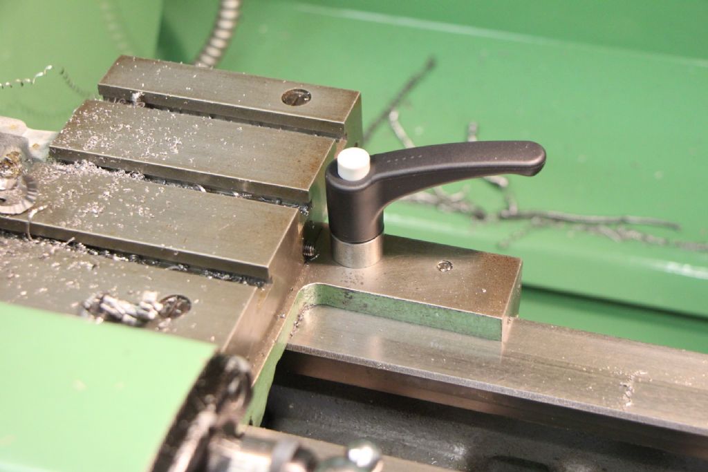

        Just added a 'proper' saddle clamp to replace the old ring spanner that was always in the way or not there.img_1976_1.jpg

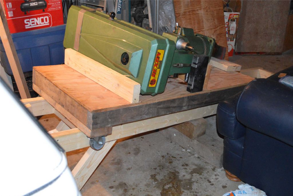

                  It took me a week but I got the Rexon RDM500M mill drill back together again and installed the vise at about 2:30AM this morning. Second time in a row I put the heavy end somewheres I couldn't reach it easily. Had to make a little ramp to ease it down as the driveway was never put in and what was is 8" below the concrete of the garage. Made my new little crane pretty useless. Getting the head up on top of the column was a bit dodgy but luckily it wasn't that heavy. I'll be happy to get back into making chips ASAP – hopefully tomorrow night. I forgot some belts and we ended up using plumbing strap in two places but got lucky and lost little or no paint. Should have thrown something under the strap but didn't think it through.

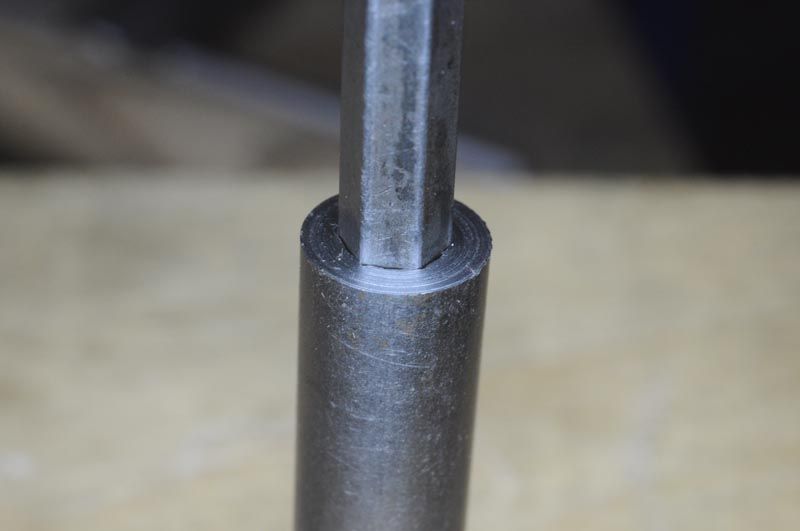

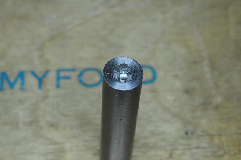

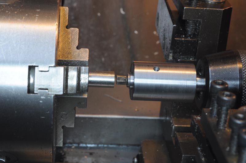

                          As well as the Linishing Disc, I got the kit for a wobble broach from Hemingway. There's a few designs for one of these. Jock Millar did one in MEW back in November 2009 but that's a bit chunky for me. Mike Cox has a nice simple one but the Hemingway one designed by Mircea Halmagiu incorporates 3 ball bearings including a nice thrust bearing.
                          The tool is offset from the centre line by 1 degree, which I set up using my Wixey. The cutter has 2.5 degrees relief and I was able to use the Wixey again to tilt the head of my mill to the appropriate angle.
                          Seems to work very nicely, if somewhat unspectacular – it just feeds in!
                          That's a 5mm allen key snugly fitting in the socket.
                          I'm set up now to have a go at making some MiteeBite type fixings for my little CNC mill.

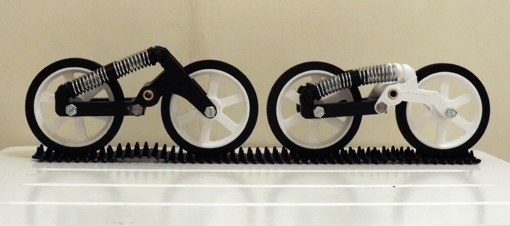

                            Might not look like it, but there is some traditional machine work in these suspension units. I still need to add the 1/8" rods through the middle of the springs etc. This is actually the inside as the nuts go on the outside.

                                  Nice work Rod. I've been watching Randy Richard making this Hemingway kit on his Youtube Channel. It's on my list to do, not least as they seem to cost hundreds of coupons to buy a commercial one. Simple enough concept.
                                  Did you buy the whole kit including materials – or just the drawings? I dunno how it works.

                                    Hi Murray,
                                    I bought the whole thing – didn't really need the lumps of 7/8 and 1" steel but the 3 bearings and the screws are in the kit as well. BAZ, who posts on here from time to time, put me onto it.
                                    There is also a length of 8mm silver steel. I bored the the holder for the bits a nice snug fit and was very pleased with myself. Unfortunately, after hardening, the shank of the bits had swelled to 8.03mm so I had to put the holder back in a collet and bore it out again angry

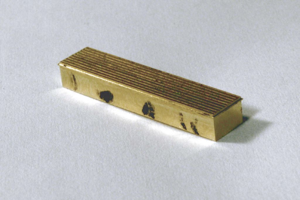

                                              Here's a little loco part:
                                              It's one half of the grid section of a an EMD FT loco dynamic brake housing. Needs one slit across the middle to .01 with a .008 slitting saw and before I can try casting it. I believe this is a phase III version as the locos it will go on were made in 1944. It's N scale (1:160th) and part of a suite of parts to represent the much modified Northern Pacific versions that roamed Western Washington right up until 1970 and the BN merger. A friend wants to have all 11 ABBA sets for the 1955 Sumas branch layout he is preparing to build. I had previously made some of the parts out of Styrene to fit the IMRC model but decided to do all new masters in brass. The little flange is .004" thick to (hopefully) ensure it casts. The grid was done manually with a .004 thou engraving cutter but other parts with trickier organic surfaces have been or are being done with CNC. Did the later number boards and an aborted injection mould that way. The pilot is a bit of a pain and testing my ability to draw the surfaces. I think I am going to fix my probe and use it to figure out the mounting area on the IMRC shell. Present work is centred around building a buck and then forming the metal (.015"  ) and laminating .002" shim embossed with the bolt heads. There are easier methods but I need to use this method elsewhere so I'm trying to work out the bugs where possible. Need to work on my soldering amongst other things and one of the reasons I ran back to something easy for this afternoon's work.

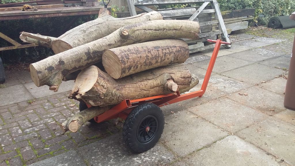

                                                      Finished off a log and brush moving trolley (for tree surgery) by painting it yesterday and testing it out today.
                                                      Rubber handles on order from China smiley
