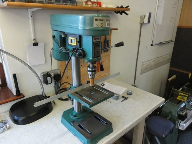

          Posted by mechman48 on 14/12/2017 15:46:57:
          Hi Jim
          Plinth looks good… from here on my screen.
          George.
          p.s what method did you use to create the effect, small wire brush, rolled emery cloth, abrasive pad?. I have used various methods to varying effect, just a point of interest.
          ​George.
          #332169
          Jim Nic
            @jimnic
            Hi George
            First off I bought a very low grade drill press off e-bay for £20 specifically for this job and with the intention of selling it again after I'd used it (although I'll probably keep it because after a bit of fettling it's OK for butchering the brown stuff).
            Then I made an abrasive tool from a piece steel rod, a piece of 20mm dowel and a pad of soft leather cut from one of Mrs Jim's unused belts (I think it was unused, it will be now!)
            After some experiments with fine and coarse valve grinding paste I settled on the fine and, after clamping a fence to the drill table, away I went.
            Jim
            Edited By Jim Nic on 15/12/2017 12:44:04
