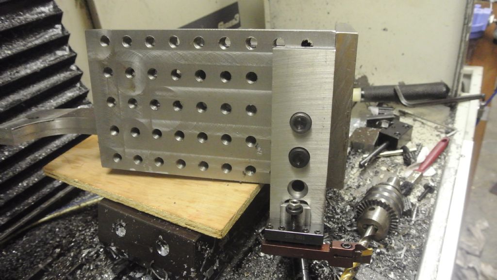

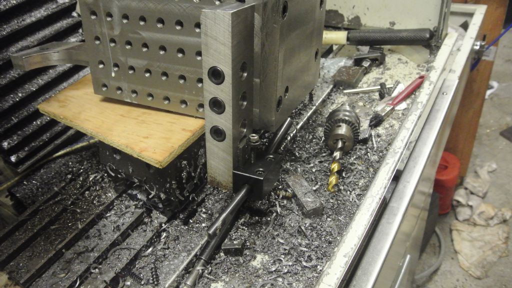

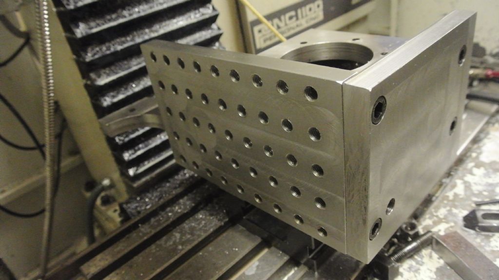

                            I posted some pictures of the progress that I have made with a gang tooling fixture for the Tormach PCNC 1100 Mill on the thread "What Did You Do Today" yesterday These showed the fixture plate without tool holders, today I managed to finish the first one.
                            Here is a picture of the finished fixture without tool hangers.
                            Here is picture with the first tool hanger fitted and a boring bar mounted on the bottom of it
                            The tool hangers can be turned through 90 degrees to enable turning tools to be mounted.
                            Here is a picture of the same hanger turned through 90 degrees and with a parting tool holder attached.
                            The tool holders are the small size QCTP type, not sure what number they are but they are clheld in position by tightening up four allen cap head screws that draw a dovetail insert into the dovetails of the holder, the insert is visible just below the counterbored bolt hole in the hanger.
                            I have two more hangers to make and when they are near finished I will mount the fixture in the mill and use the Rapid Turn Lathe attachment to bore out the hangers to accept the Tormach TTS system tooling. I will post some more pictures and vide once done.

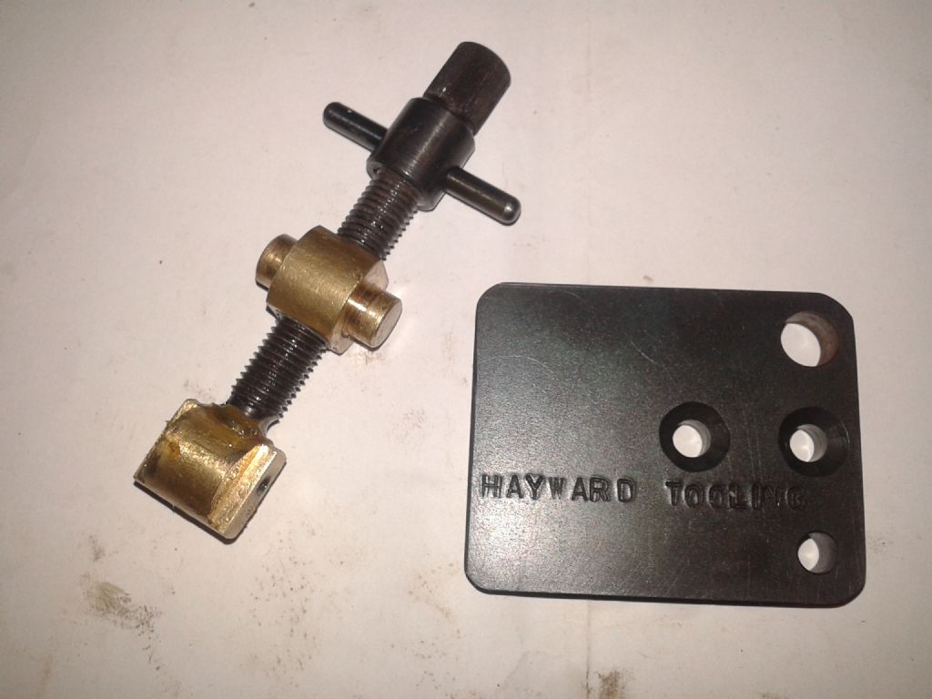

                              phone photos to sept 2017 541.jpgphone photos to sept 2017 547.jpgFinally got round to making the Hemingway Kits Marlco copy knurler that I bought in, ahem 2013. Sat under the bench till last month, now finished, guestimate total time approx. 30-40 hours in it. As per usual with all my steel tooling over here, has the usual anti-sweaty fingers and anti rust TG black finish.
