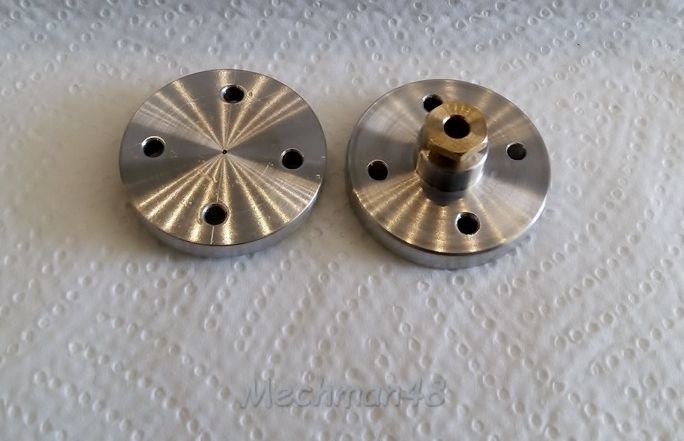

          Vertical cross progress, Top & bottom cylinder end plates…
          George.
          #309153
          Jim Nic
            @jimnic
            They look nice George, pity the bottom one won't be seen. sad

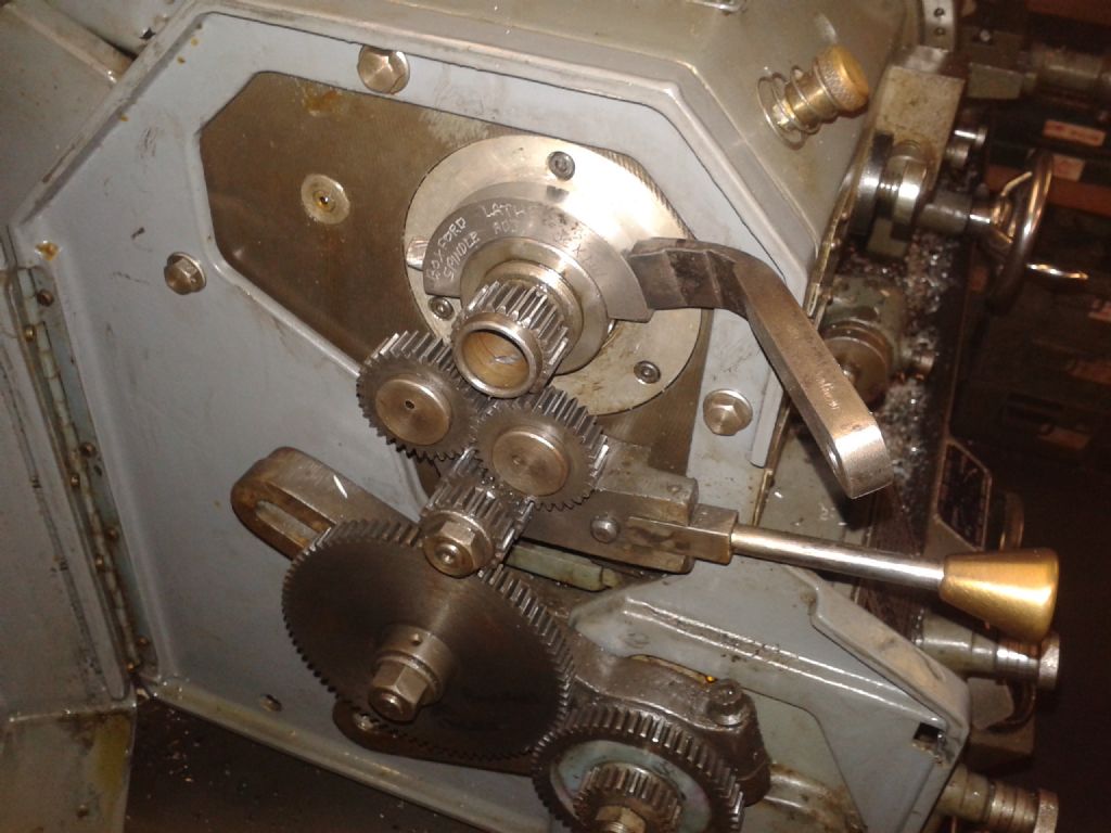

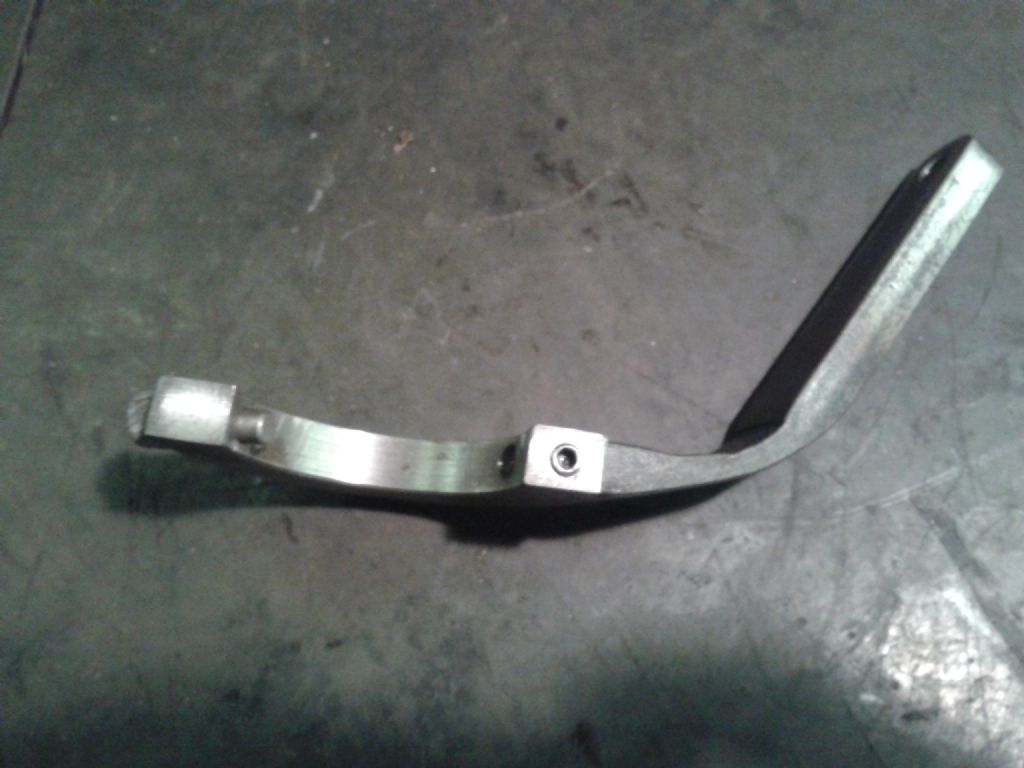

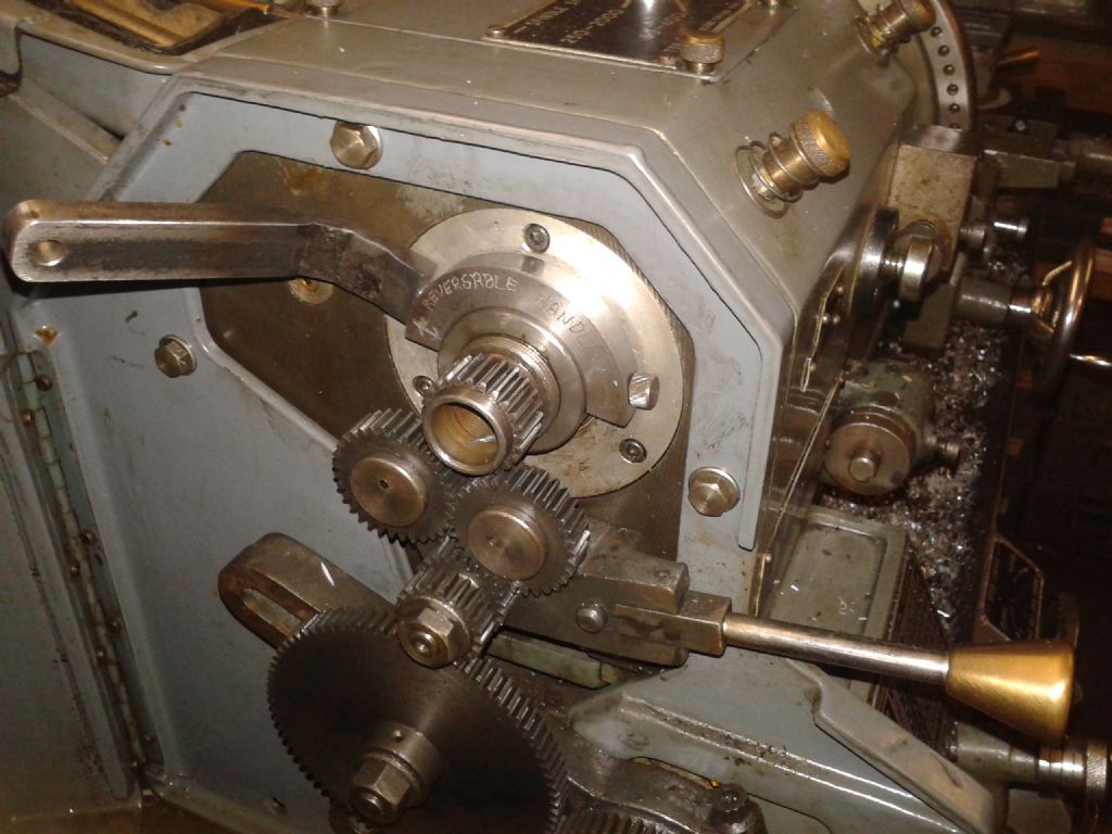

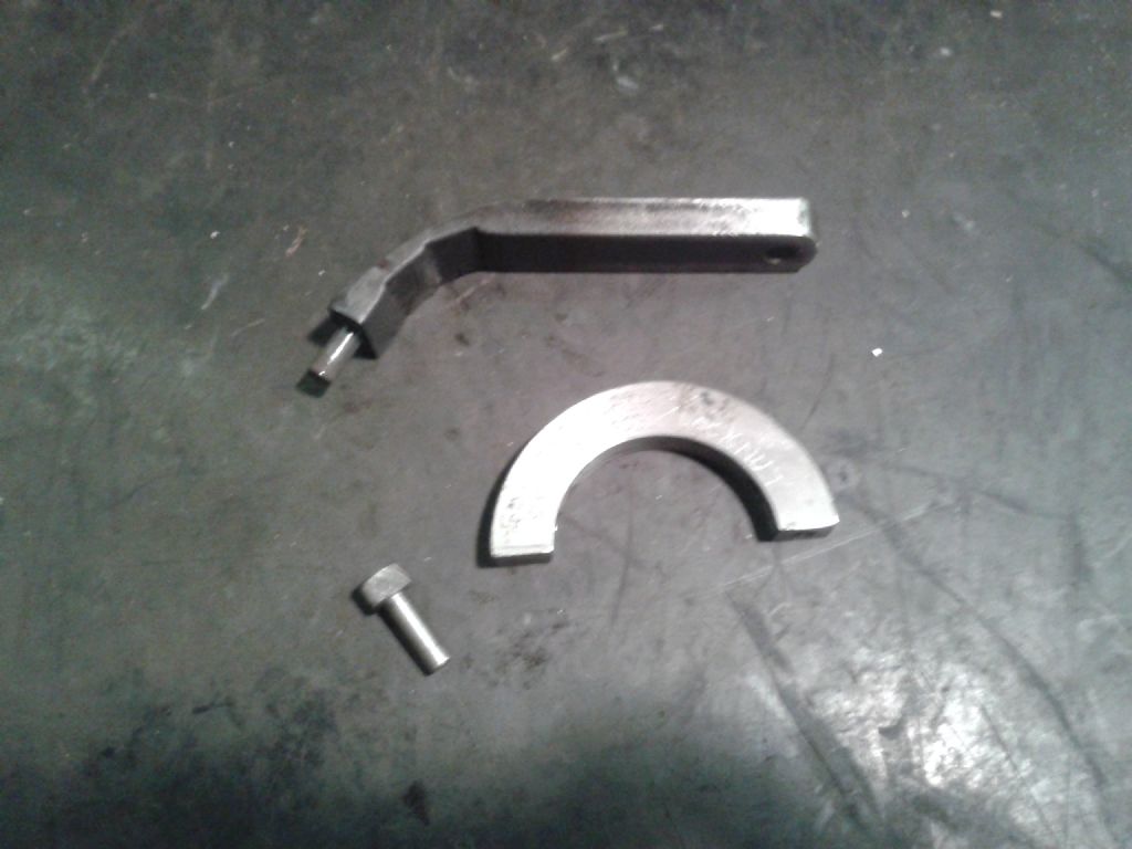

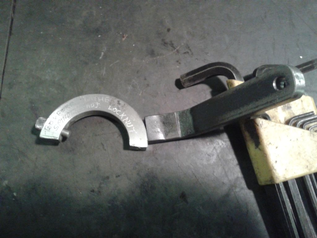

                    20170629_145534.jpg20170629_145444.jpg20170629_145407.jpg20170629_145341.jpgMany years ago, i had to adjust the pre load on my headstock spindle bearings on the Boxford VSL.
                    Adjusted they were, with a pin punch and hammer, and on that day, an adjusting / tighten / loosen peg type spanner was added to my to-do-list.
                    Fast forward many years, and i finally got round to making it…. works a treat.

                        Thaiguzzi that was interesting. My 1950's version has 2 thin locknuts so I made 2 off pin spanners. Never noticed my 1970's model, still in kit form, has your style. Drat. Will have to find my spanner after tea and see if it fits.

                          Posted by Bazyle on 30/07/2017 16:55:58:
                          MY serial no. = 1969 manufacture.
                          A pin/peg spanner is a helluva nicer way of doing things than a hammer…

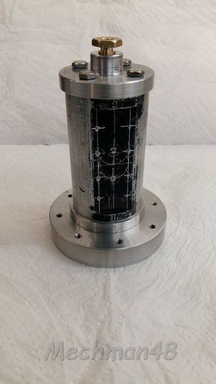

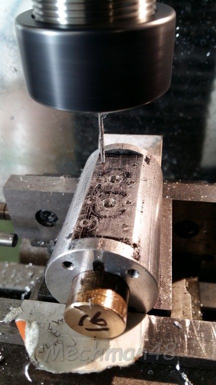

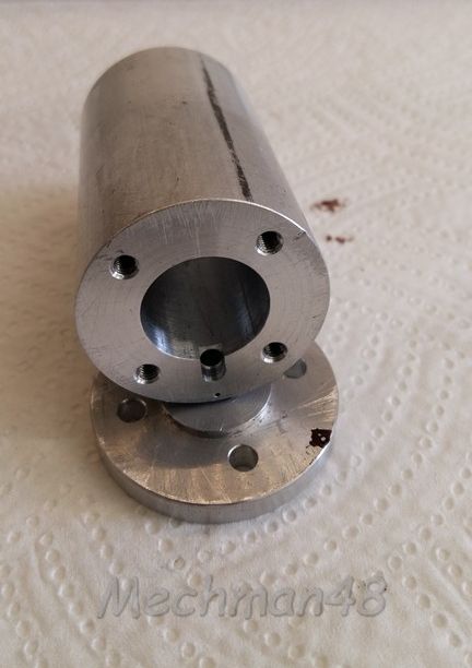

                                A bit more done on my version of the Vertical Cross engine to Stewart Hall's drawings. I didn't have any ally bar of 55mm dia. for the base, so marked out, drilled, tapped, & turned a piece of 10mm ally plate to required dimensions. The tapping mode gave me the chance to try out a 3mm spiral flute tap I picked up at a car boot fair some time ago as the tapped holes were shown as 5.5mm deep so not through holes, all tapped out nicely with cuttings coming up & out as designed to do. Must keep my eyes peeled for more spiral flute taps…
                                ​Cylinder machined & marked out for steam ports & valve chest location studs, partially assembled…
                                ​Jim Nic, on your model which avenue did you take to mate up your valve chest on the cylinder, the two options I can think of are…1) mark out the valve chest separately & hopefully the drilled chest will mate up with the cylinder studs ( always seem to get one hole out of line with mating hole / stud on other pieces ) … 2 ) locate the drilled valve chest in position & spot through to the cylinder, which I take is the best method that most members would do ?… going through brain fade episode at the mo' dont know
                                George.
                                #310674
                                Jim Nic
                                  @jimnic
                                  Hi George
                                  As I recall I drilled the cylinder and steam chest to drawing and luckily got it right. I do have a DRO on my mill/drill which makes that a better option for me than spotting through and picking up the marks. This part actually allows a little inaccuracy especially if you clad the cylinder devil
                                  Also I normally make clearance holes a tad big, normally 0.1mm, to give a bit of wriggleability. As Stew Hart (not Hall, he was the giggling fool off "It's a Knockout " from the telly wasn't he?) says "A little bit of clearance never got in the road."
                                  Jim

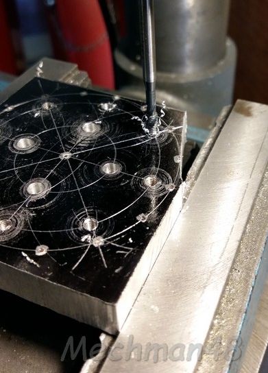

                                        Bit more done on the Vert' cross … drilling for valve chest studs, 1.6mm drill… DRO's certainly help with the hole spacing …
                                        ​Steam passages milled & drilled… not seeing any dimensions for depth of milled slot for steam /air entry passage on dwg, calculated out for 1.5mm boss on cyl. end cover ( sitting on ) milled out to 2.5mm depth, I'd decided on 1mm steam / air entry clearance. The slot was calculated ( guesstimated thinking ) to leave a 1mm wall thickness taking into account the 3mm dia. drilled passage, making distance from inside cyl.dia.to end of milled slot 4mm… not taken gasket thickness into account… haven't measured yet, but there is still 0.56mm – .021" to come off overall cylinder length as it now stands at 52.56mm so a clean up on both ends will bring it to spec. So unless I've missed something off the dwg…I don't see why it shouldn't work ?. Maybe Jim Nic / others could clarify?
                                        ​George.

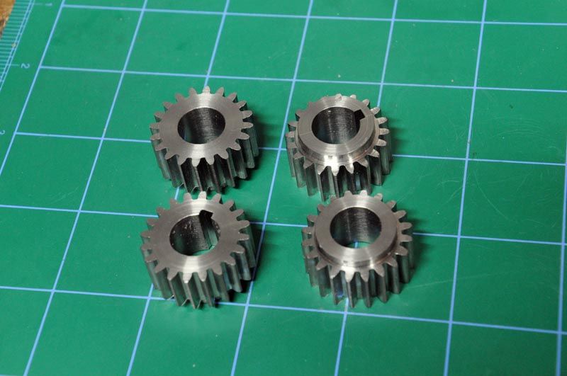

                                            I'm having a go at George Thomas' bending rolls. Made the gears today, a stick of 20t 20DP. The gear cutter came from RDG, still sharp, no sign of any wear on the teeth.
                                            Parted off, bored and tidied up in soft jaws in the lathe. Seeing as the mill was in horizontal mode I thought I'd use the slotting attachment to make the keyway in two of the gears.
                                            I had to make the slot tooling, I've never used the slotting attachment beforesurprise
                                            Nice bit of kit but probably simpler and quicker to use the hand shaper for little slotting jobs like this.
                                            Rod
                                            #311088
                                            Anonymous
                                              Lovely looking gears. thumbs up They'll be 14½°PA if it's an RDG cutter?
                                              Andrew
                                              #311093
                                              Roderick Jenkins
                                                @roderickjenkins93242
                                                Indeed it is. Presumably focussed on making Myford change gears. Free cutting mild steel – very flattering to average technique.

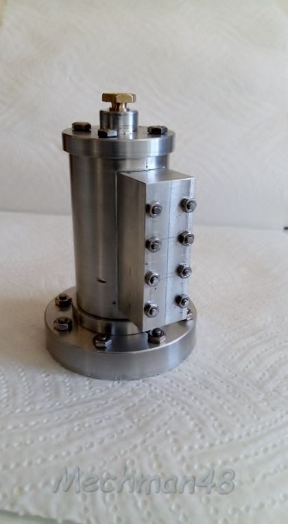

                                                      Vertical Cross progress… tapped out valve chest for studding, machined up valve chest, drilled for studs, nice to have DRO's to help … still managed to get one stud out of alignment, always seem to do that…. dont know. A tad extra clearance drill sorted it, Still need to drill for inlet / exhaust ports, piston valve etc…
                                                      George.
