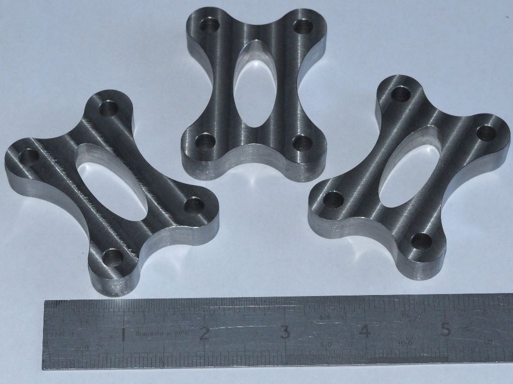

                                    Got fed up with work admin so I took a half day off and finished off the traction engine water pump spacers:
                                    Why the fancy shape? Just for the hell of it!
                                    Andrew
                                    #236770
                                      Posted by Andrew Johnston on 29/04/2016 19:40:20:
                                      Andrew
                                      That won't please the rivit counters smile p but I suppose if you have a CNC then why not play with it. Was there some form of spacer on the originals or are they needed due to the redisigned pump?
                                      #236819
                                      Anonymous
                                        Posted by JasonB on 29/04/2016 19:51:20:
                                        The rivet counters know where they can go; and if not I'm happy to spell it out for them. wink 2
                                        The full size water pump had a flange as part of the casting rather than a separate spacer. The LSM drawings have a note on the top view of the water pump saying 1/2" packer, with no further details. My spacer is 0.451" partly because my hornplates are 6mm rather than 1/4" and partly because the drawings are nonsense.
                                        Andrew

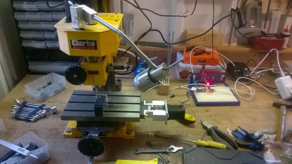

                                            Finally! I've made some progress with CNCing my mill.
                                            I was going to use a raspberry pi to drive the motors, but when I checked with a scope the (simple) timer approach was missing beats. So I pulled an Arduino Nano (one I'd bought on spec earlier!) out and set that up. This time I actually used a breadboard (seen in a picture below) rather than soldering the thing up on stripboard. Considerably quicker!
                                            The arduino is dead easy to program for, though I may end up putting something called GRBL on it which does the CNC interpretation / heavy lifting, but may main objective is to use it to surface large (relatively) plates without me dying of boredom..
                                            I've found that a 60NM NEMA 17 motor is strong enough (the NEMA 14 motors I had kicking around were not). Though the mill (CMD10) has to be set up dead on or the table is too stiff for the motor to be turned(or too stiff in some places).
                                            I've milled some aluminium and then -heart in mouth- some mild steel! I seem to be able to take a 1mm cut at around 2mm / sec (one handle turn, I think though I will calibrate this properly later).

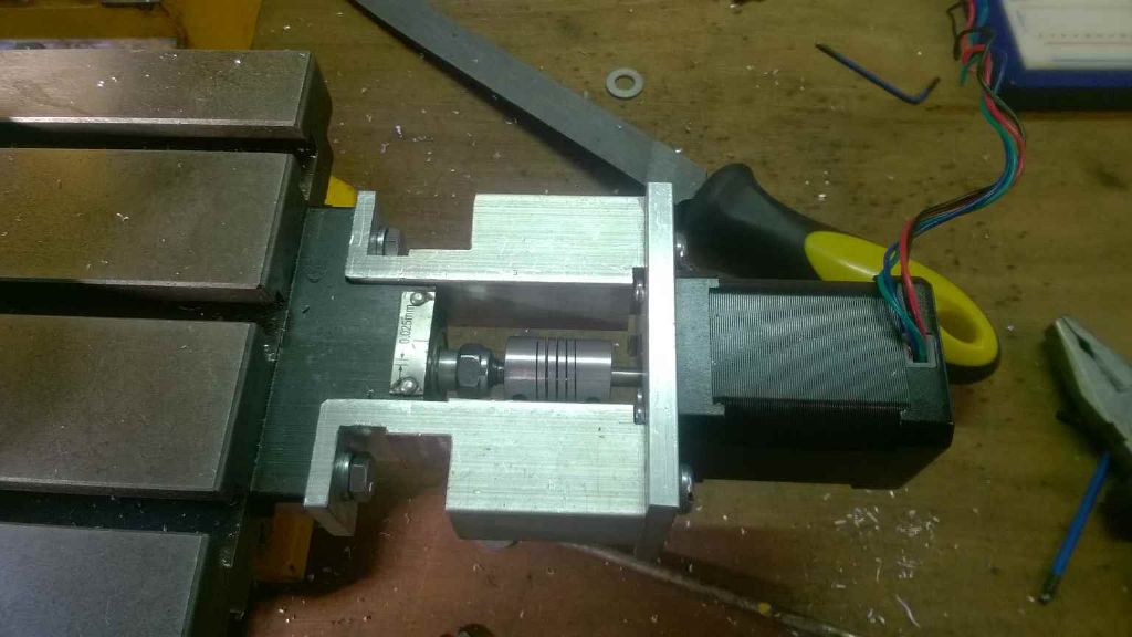

                                            What I'd like to do is to find a motor with the same power and size which has got a axle sticking out the back as well as the front so I can put a turn wheel on it. Failing that I've got some quadrature encoders on order which I can use to input manually. It's a level of indirection I don't much care for if I can avoid it. There's a level of feedback through the wheel which just occasionally stops you breaking the damned gears (again).
                                            Here's a close up of the mount.
                                            Next step is another motor and mount for the Y axis and to turn a test harness into a program.

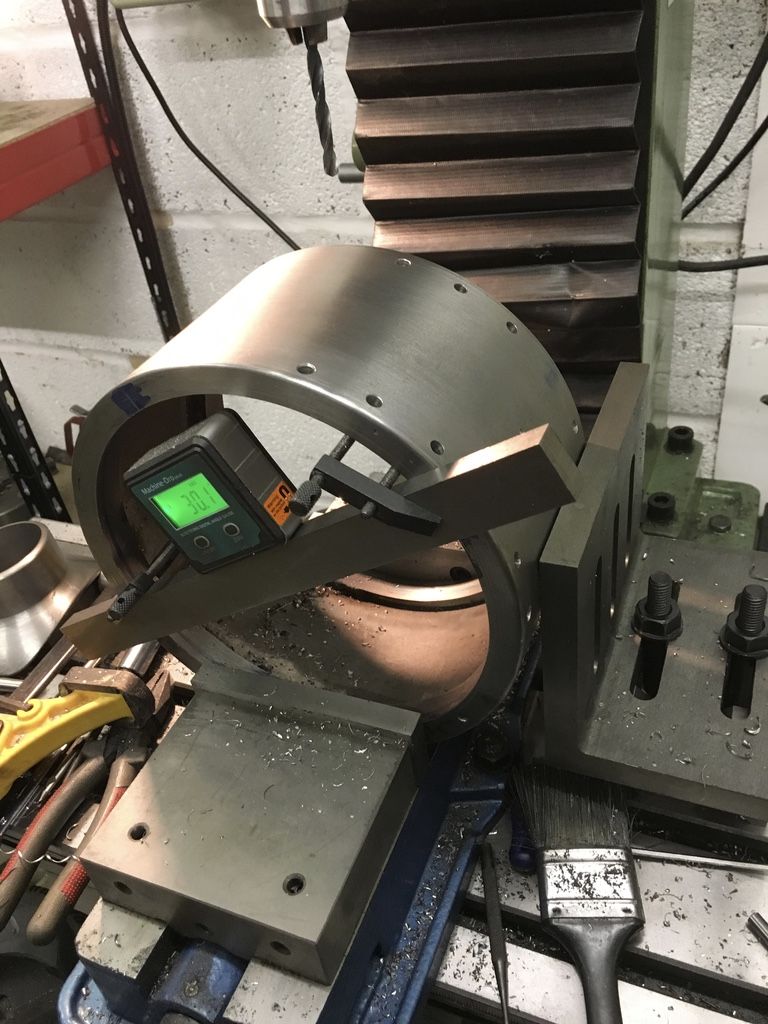

                                              Today I was faced with the challenge of drilling 2 rows of 24 equally spaced rivet holes around the front and rear edges of my traction engine smokebox tube. Ordinarily a fairly straightforward job mounted on the rotary table in the mill however the challenge arose because the smokebox tube is 9" diameter and my rotary table is only 6"diameter.
                                              I had intended bolting a 9 1/2" diam aluminium plate to the rotary table and clamping the smokebox to this extended 'faceplate", then sorting a suitable raising block under the RT to raise the centre height so that the faceplate would clear the mill table. This all seemed a bit of a precarious and fiddly set up and whilst pondering alternative methods I hit on the idea of using my Wixey digital angle gauge to index the 24 hole positions around the smokebox. The smokebox fitted nicely in my machine vice on the mill table and a large angle plate was used as a fence to maintain the smokebox in the correct position as it was rotated for the next hole. I clamped a sturdy bar across the smokebox to mount the angle gauge on then proceeded to do a trial "lap" of the smokebox indexing every 15 degrees as I went. The bar had to be reset a few times when it came close to fouling the vice jaws which I thought might introduce errors but my trial lap ended in the drill being approx 0.030" out when lined up with the original starting point. Not much use for gear cutting but certainly good enough for my 2 rings of rivet holes. So, happy that everything would work I set about drilling the front & rear holes then indexed around to the next station and had the whole job done from idea to completion in about 1 1/2 hours, probably quicker than I would have taken just to set up my original idea.
                                              The photo below shows my setup in progress. I certainly don't claim any originality for the method used although it is not a method that I have seen described before so thought it might be of use to someone else who reads it!
                                              Martin.

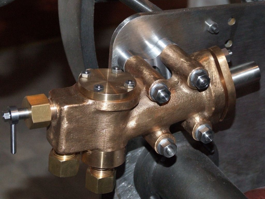

                                                  It's been raining today, so I've had a session on the repetition lathe making bolts and washers (plus the nuts I made earlier) for the water pumps and crankshaft bearing housings. Bottom left are some special bolts for holding the gear change castings to the hornplates. All threads are 1/4" BSF:
                                                  That should make the rivet counters bolt up! And here's the water pump in situ, with the proper bolts and fancy spacer:
                                                  Andrew
                                                  #237221
                                                  Muzzer
                                                    @muzzer
                                                    Very nice! What material did you use? Coventry die head for the threading?
                                                    #237231
                                                    Anonymous
                                                      Posted by Muzzer on 02/05/2016 19:10:07:
                                                      Everything made from EN3B, and yes I used a Coventry diehead. I learnt something about Coventry dieheads though. Initially I lightly chamfered the unthreaded end of each bolt for neatness. But I had all sorts of problems getting the diehead to start. Once it did, it sometimes left a tapered start to the thread. No chamfer and the diehead started without a problem. Another lesson learnt.
                                                      Andrew
