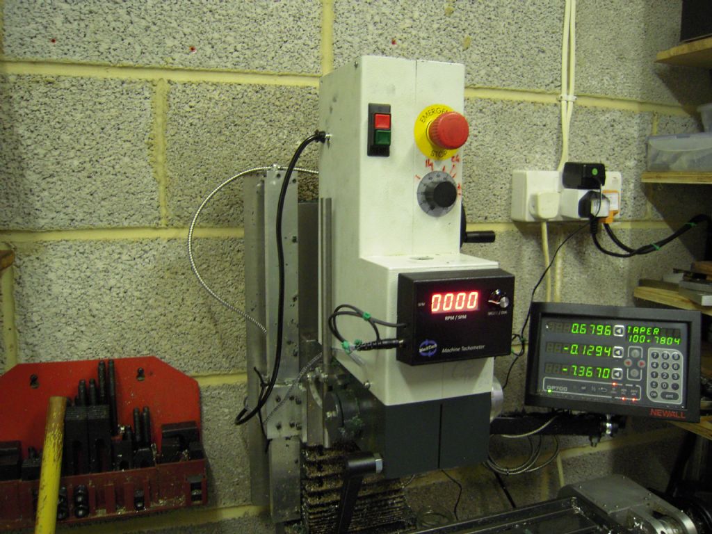

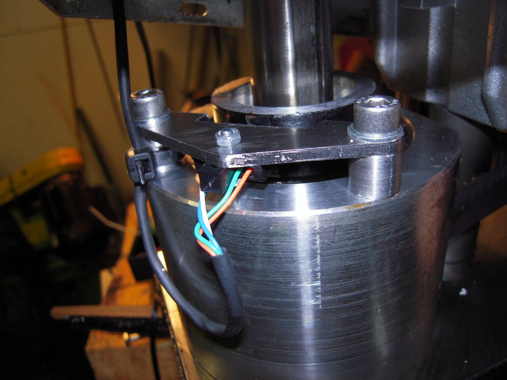

                                      Towards the end of last summer I started thinking about tachometers during which I posted a thread on 555 timers. Following advice given I decided to fit a MachTach tachometer to the milling machine.
                                      It took less than a week to arrive from the States and I was quite impressed with it, the finish and the instructions were particularly good. The only things that let it down were some off the shelf items such as the knob – the locking grub screw was seized. The electronics were assembled quite rapidly in the autumn and thought was given on how to fit the sensor to the milling machine. In the end I used a floating collar to carry a single IR reflective strip as shown.
                                      Sensor head
                                      Finally, last week, after the cold weather and doing jobs for others, I fitted it to the milling machine. It works but I have yet to use it in anger.
                                      Many thanks for the advice.
                                      JA

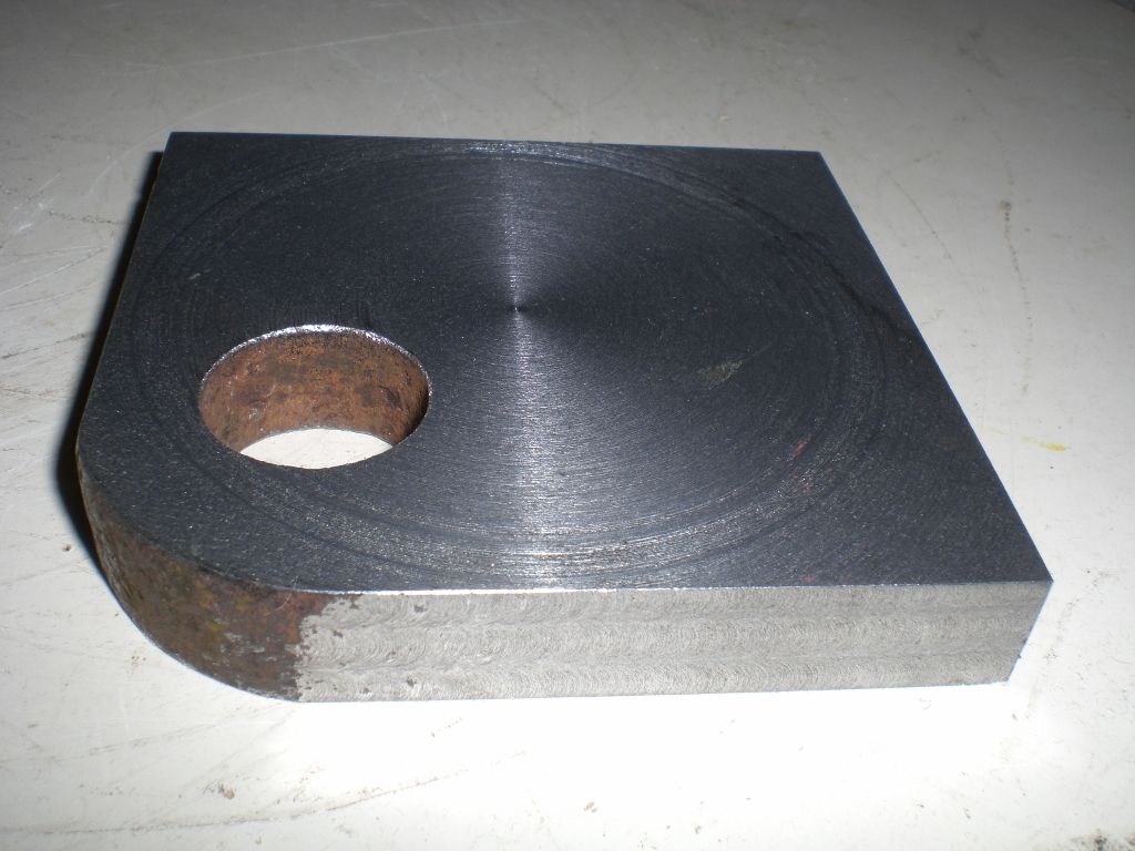

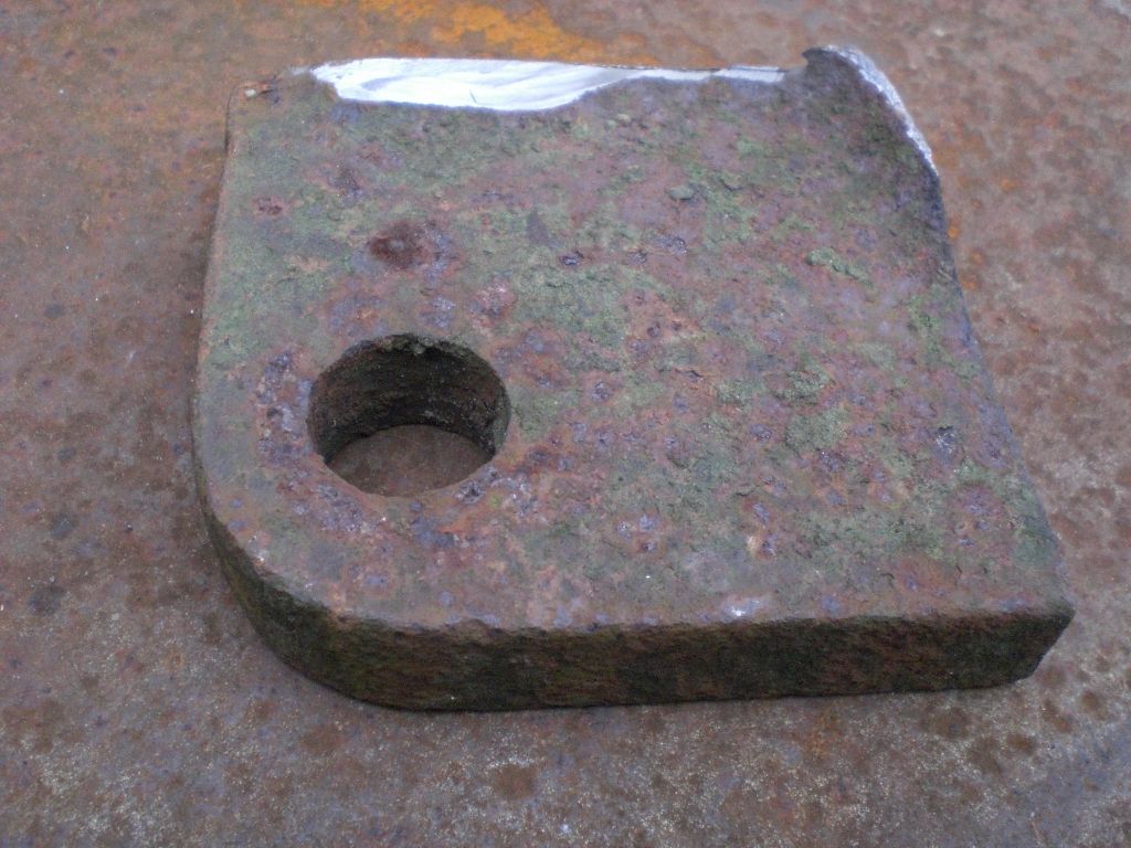

                                                Hi, today (Sat evening) started to make a bespoke traveling steady for my Conquest lathe. First job was to find a suitable piece of metal and remembered this old railway truck buffer that been standing around outside for the last 15 years or so waiting for a job.
                                                So out came the 9" angle grinder and cut off the remaining corner of the mounting flange.
                                                Then after facing off both sides to get about 16mm thickness and milling the edges, I'm sure I will be able to find the basic shape of my traveling steady in there somewhere.
                                                Next job will be to mark out and cut a shape that will look a bit like a figure 2.
                                                Regards Nick.

                                                  Out of curiosity Nicholas what sort of quality was that cast iron and how did it machine.?
                                                  I also wonder what and how broke it all those years ago.
                                                  Nick
                                                  #233080
                                                  Nicholas Farr
                                                    @nicholasfarr14254
                                                    Hi Nick_G, I think it is actually cast steel and it machined very nicely, which I was much relieved by, it looks to be very good quality also.
                                                    No idea how it got broke all those years ago, but the buffer plate, (the bit still covered with the weeds) is a little bit bent, I guess the shunter that the works had, may have jumped the track, which happened once in a while. I just found it one day when we had to do a whole works clear up of maintenance scrap, so I popped it round mine instead of the scrap bin.
                                                    Regards Nick.
