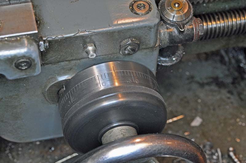

          @roderickjenkins93242

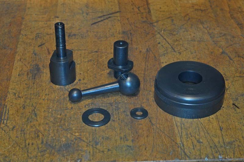

          Completed my Meek carriage handwheel dial today.
          I am very impressed with the design. According to this set up with my giant dial gauge, 1 revolution of the dial, which is one inch, was 25.38 mm.
          Also impressed with my Metalblak kit from Blackgates, which I had not used before:
          Cheers,
          Rod
          Edited By Roderick Jenkins on 12/02/2016 17:15:35
          #225154
          Ian S C
            @iansc
            That look very nice Rod, best part of the lathe.
            Ian S C
            #225170
            Roderick Jenkins
              Ian,
              Thanks. The rest of the lathe does look a bit grubby but I try not to be too precious about it. That's six holes I've drilled in it now – which should please Sir John wink
              Cheers,
              Rod
              #225199
              Jeff Dayman
                @jeffdayman43397
                Very nice work Rod, that will be a handy thing to have. JD

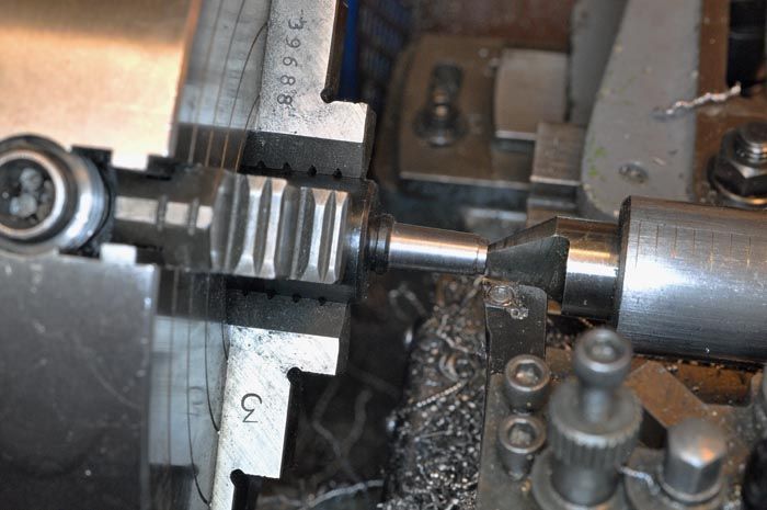

                  #225377
                    Good to see you back on the metal work Rod, is this in preparation for another model build?
                    I had a bit of a boring weekend.
                    Penultimate cut on the Allman engine's cylinder, aiming for 1.25" final bore x 5.25" long, 28mm between ctrs boring bar with HSS bit.
                    Finished cylinder and "cylinder head" which is more of an end cover as the valves and plug go into the sides if the cylinder.
                    What you can't see are all the ports and passages for the exhaust gasses and cooling water like this 4.5" long 1/4" dia one down the wall of teh cylinder which luckily did not wander, blue mark on drill is how deep the hole is.

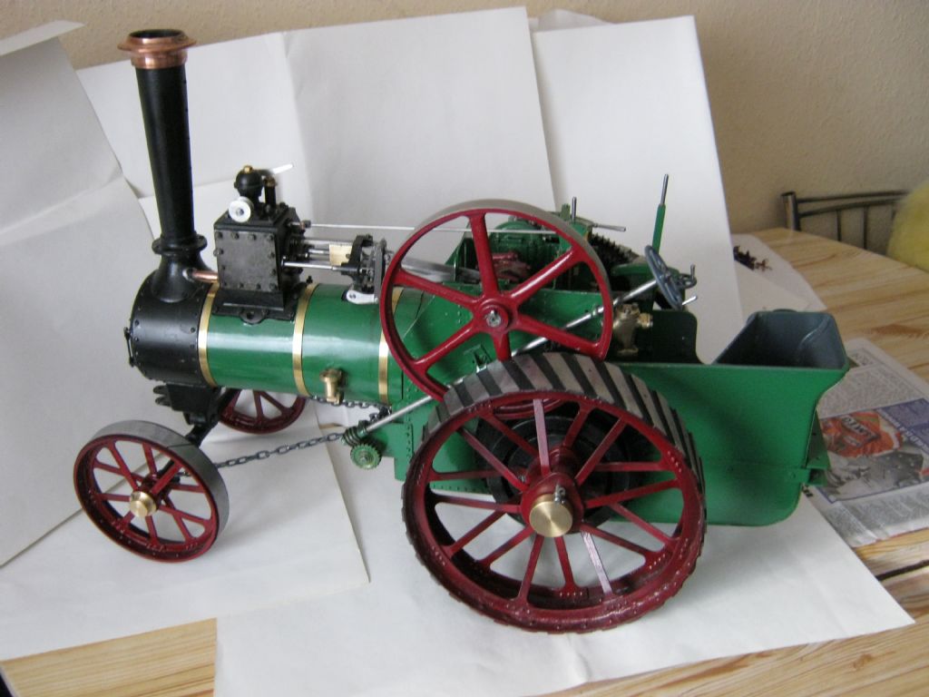

                      colin hawes
                        @colinhawes85982
                        Now and then I do a bit more on the 1.5" scale Burrell I started years ago. I do bits of this in between other projects. No castings used on this model.
                        #225636
                        Roderick Jenkins
                          That's nice. Not much left to do by the look of it.
                          Rod

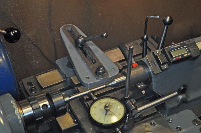

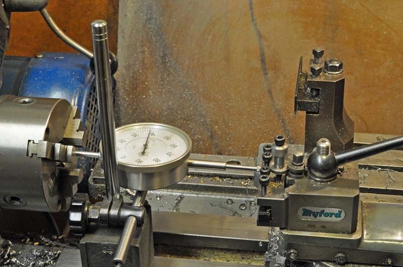

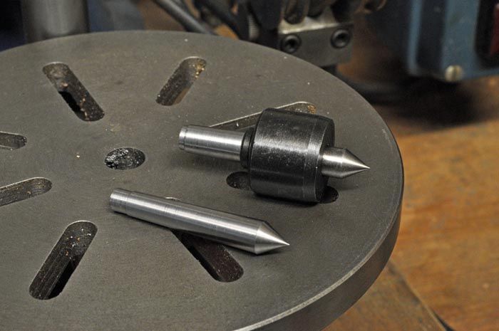

                                  Played with the taper turning attachment today, making some short 0MT centres for the Flexispeed
                                  I trimmed this parallel shank rolling centre from arceurotrade. Turned easily, no different to annealed silver steel.
                                  I need to make a cover for the TTA, all its little nooks and crannies are filling with swarf surprise
                                  Rod
                                  Edited By Roderick Jenkins on 22/02/2016 15:54:54

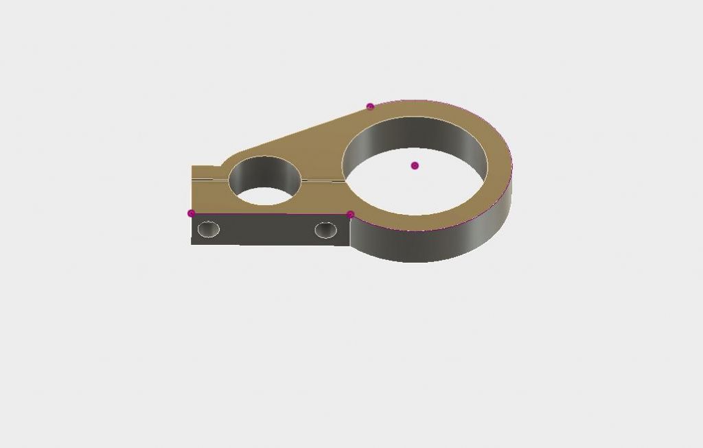

                                        On Monday I received a Kress high speed spindle (6 speeds from 10-29 K RPM.) The intention is to use it for small diameter cutters on my Tormach mill. This morning I drew out the adaptor to fit on the mill spindle nose. I went to Macc Models this afternoon to see if he had any offcuts that I could use to make it from but they were shut until tomorrow. I suppose I can get the G-code prepared so that I can make it as soon as I get the material.
                                        #226569
                                        Anonymous
                                          Bob: I'd be inclined to make the two 'internal' radii a bit larger and then you can use one (larger) cutter to do both the internal holes and the complete profile.
                                          I'll be interested to see how you get on with the high speed spindle. I have a plan to add a high speed spindle and inverter, as sold by Arc, but I need to have a pressing requirement before spending the money. That need may come with the bevel gears for my traction engine governors. For finishing I need a 1mm, or smaller, cutter. Even at 5000rpm it will take tens of hours. Being in the countryside our electric supply isn't that reliable!
                                          Andrew
                                          PS: I'm looking foward to your article in the next issue of MEW
                                          Edited By Andrew Johnston on 23/02/2016 15:49:07
                                          #226650
                                          Bob Rodgerson
                                            @bobrodgerson97362
                                            Hi Andrew,
                                            It is my intention to use the same size cutter for both internal and external Radii just on my drawing I haven't put a fillet on the point where the two straight bits join the circular parts.
                                            Tormach sell Kress spindles complete with an adaptor but the cost of importing would be almost double the price of buying one here in the UK and making your own adaptor. I paid something like £160 for mine. It comes with an 8mm Collet but others are available. I might have a go at making some collets if I can be bothered rather than pay for yet more stuff.
                                            Like you my reasons for buying the spindle are to produce bevel gears using very small cutters. I will keep you posted with progress.

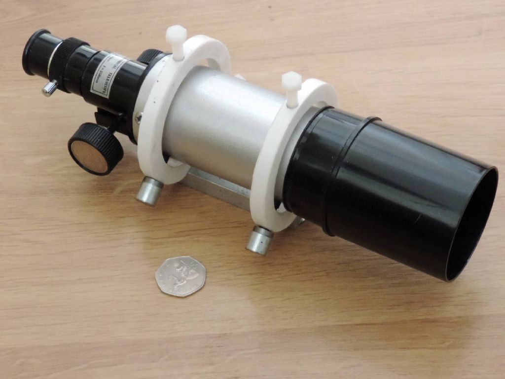

                                                Started converting a cheap old 50x330mm telescope into a usable 150 x180mm finder scope.
                                                So far the main actions have been swapping in a new objective lens, shortening the barrel and making sprung mounting rings, so some machining involved, especially the sprung plungers (metal cylinders at the bottom).
