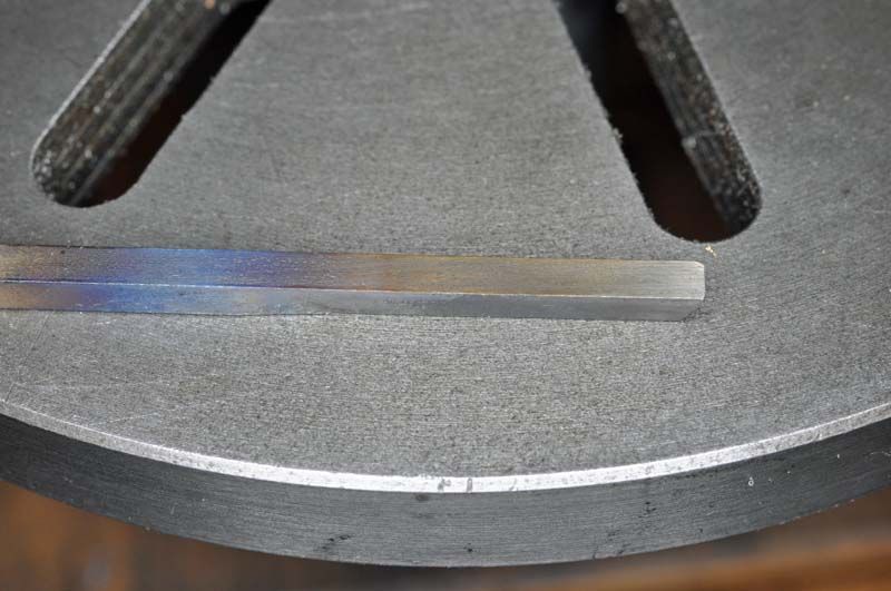

          I've been a busy little bee – well, actually, I made the gear cutter yesterday. Today, the need to cut a slice off a 2 1/2" round prompted me to undertake Neil's mods to the bandsaw. You can really get away with quite a lot:
          This is for the extended movable jaw – I had to lean on the end to start with. Even with the mods, holding a round stub was still not secure enough for cutting – the jaws tend to lift and skew, pushing the job up. So, a further mod was to add two M6 studs to the jaws to provide some down pressure.
          It's a bit crude but the technique works.
          Rod

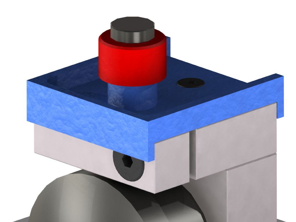

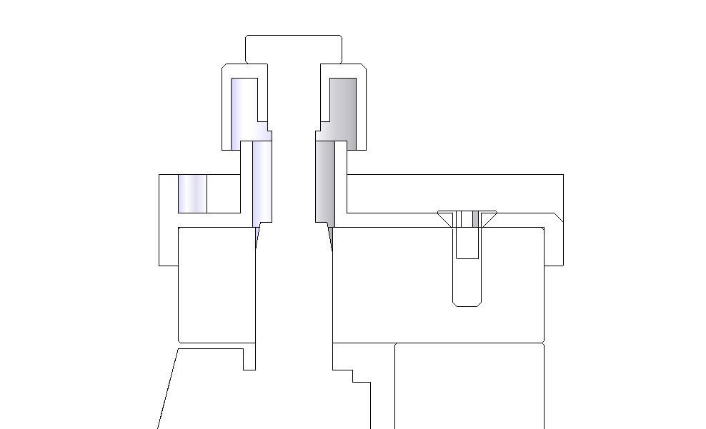

              Here's the grand plan to shield the CNC Height gauge from coolant drips.
              Two parts – an upturned Delrin Bucket and a shroud part, probably aluminium, that is screwed to the top.
              Section view ……..
              Will post when complete with either good or bad news, but I'm hopeful that it'll do the trick with no modifications to the original design.
              Thanks all for the ideas – Will

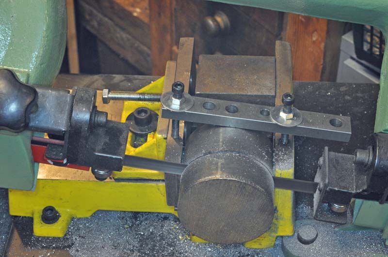

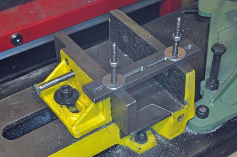

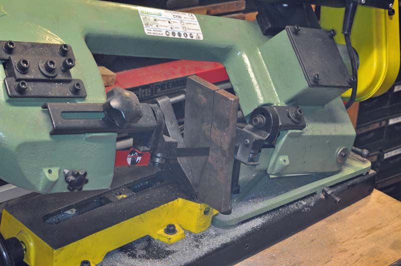

                Bandsaw update: Having proven the concept, I've made a better job of the clamp. The studs are 6mm and the slots in the bar were made with a 1/4" slot drill:
                Cheers,
                Rod
                #223680
                jim’
                  @jim11037
                  Posted by Roderick Jenkins on 02/02/2016 19:10:37:
                  Cheers,
                  Rod
                  excellent.
                  one more for my todo list!

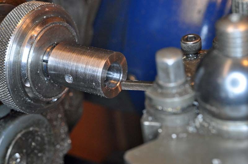

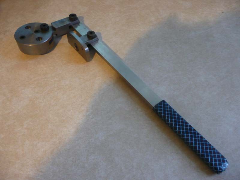

                    A new challenge for me today – slotting a key way in a blind hole. It's for a 1/8" Woodruff key and fortunately the only square silver steel I posses is 1/8" smiley.
                    Also, lurking at the bottom of a draw was this contraption, which came with my lathe and which I have never had cause to use before.
                    Does anybody recognise the design? I don't recall having seen it anywhere else.
                    It all seemed to work OK, if a little tedious – I could only manage 1/2 thou cuts.
                    The cutting tool would be much better made from1/8" gauge plate so that the width is much greater than the thickness to resist bending. And that handle needs some hand friendly slips of wood riveted on.
                    Still, apart from the blisters, a successful afternoon.
                    Cheers,
                    Rod
                    #224174
                    NJH
                      @njh
                      Hi Rod
                      Yes I've certainly seen that method demonstrated for cutting key ways – can't quite recall where at the moment but I'll have a delve through the books later.
                      Norman
                      #224176
                      John P
                        @johnp77052
                        Hi Rod and Norman
                        Slotting attachment for the Myford super 7 lathe is
                        in MHS plan list WE68 .Was published in Model Engineer
                        in around 1994 .I suppose i should know which issue as it was
                        one of mine.
                        #224184
                        Roderick Jenkins
                          @roderickjenkins93242
                          Hi John,
                          I think this design is a little different to yours. I can't recall the exact time when I got the lathe but it was certainly prior to 1989.
                          Thanks anyway,
                          Rod
