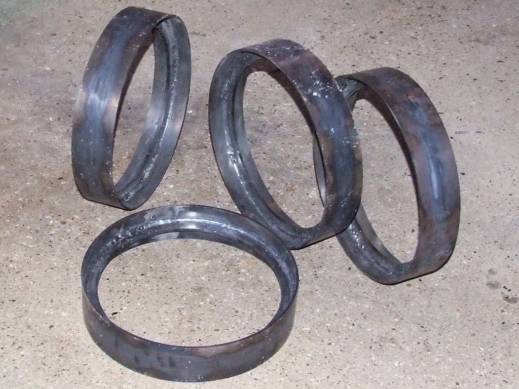

                After a mammoth welding session this afternoon all four front wheel rims and T-rings have been welded, including dressing and welding the new rim to replace a previous one I wasn't happy with, more scrap. sad

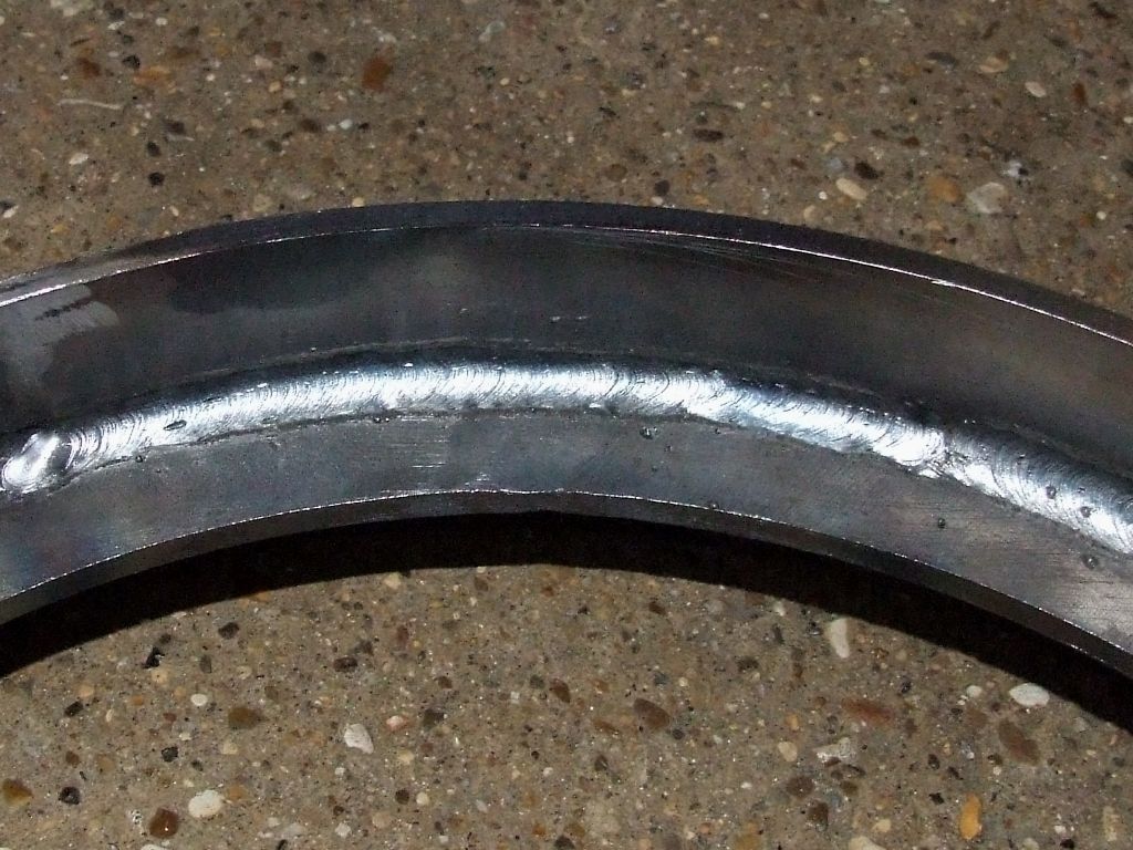

                My arc welding is also improving. I turned the current down to 120A (from 130A) so there's a bit less undercutting. By the time I've finished all the wheels I'll probably be good enough to start again and make the wheels properly!
                For scale the wheel rim OD is 14.5". Next job is to weld the 32 quadrants together to make the T-rings for the rear wheels.

                  Doesn't look too bad at all. Stick or MIG? I'm guessing MIG?

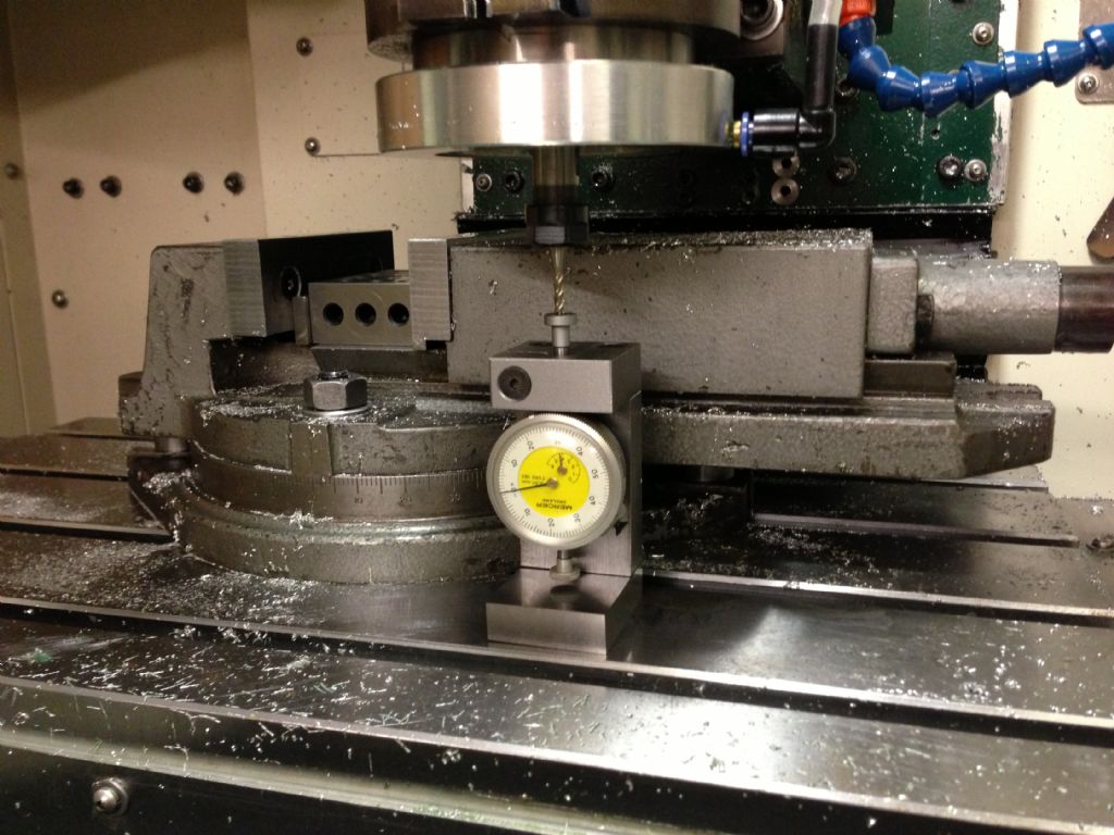

                    A year or so ago I made a height setting gauge for the CNC mill and saved a fortune on the commercial offerings. And it worked a treat.
                    Felt pretty supercilious at the time – used and old dial gauge that had been knocking around for years plus a couple of odd lumps of steel, so zero outlay.
                    But not feeling quite so cocky now embarrassed
                    I went to use it yesterday and found it was sticky from the odd dribble of cutting fluid dropped onto it and it wouldn't return by it's own spring pressure after being pushed down.
                    Spent an hour today cleaning the gauge to get it to work smoothly again. But I know it will do the same again if I keep using it. So what to do ?
                    Thought about making an umbrella type shroud to fit the business end and to deflect the drips away from the shaft underneath. Or perhaps put a bigger spring at the bottom to make sure it always moves. As a last resort, perhaps implement an annual maintenance schedule…….
                    But whatever, I refuse to stump up for a proper one. It's a matter of principle !!!
                    Any other bright ideas ?
                    Cheers – Will

                      Will,
                      My choice would be to make a top contact for the stem that has a drip lip around it so fluid doesn't run down the indicator shaft.

                        You could invert the indicator and drive it with a lever. Any coolant drips in that case would have to go back uphill to get in the indicator. I mounted several with a lever as described for high volume aluminum milling in industry, using flood coolant at several gallons per minute. I visited the factory I did one such set for last year. The original mechanical indicators were replaced about 10 yr ago by LVDT units for in-process gauging but my mounts and levers are still in use 22 yr on. JD

                          It's arc welded; I don't have a MIG welder. The arc welder function came 'free' with an AC/DC TIG welder. So the arc is derived from an inverter, and is nice and stable.

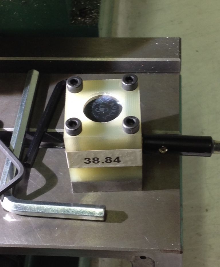

                              Will, this is my home made height setter.
                              The body is made of epoxy fibreglass, with a steel base with a magnet that sticks to the table. There's a tungsten carbide platen in the top that is spring loaded. The platen is isolated from the table, and connected to the probe input of the BoB by the 4mm plug you see to the right. The top of the platen is 38.84 mm above the base. In use I stick it on the table and activate the tool zero button in Mach3. I've written a macro that moves Z down until the tool touches the platen, then retracts a very small amount, moves down very slowly again until it contacts, then lifts up to 50mm above the table surface. Works a treat. Mind you I don't use suds on the cnc mill.

                                I have the same set-up and found like you the foot didn't return, I added a light spring between the elephants foot and the top plate, the gauge always returns now to the same reading. It won't solve the coolant issue though but if you fit an 'O' ring in the top plate bore above the stem gripping point it would provide a seal against coolant, you may then need a little stronger spring.

                                  Thanks for the replies so far ….
                                  Jeff – That's a better way to go and in hind sight, I would definitely have done something similar, but I think that I would almost need to start again. I'll try bodging first.
                                  Peter, I'm going to try that first – I'm thinking a plastic drip lip like an inverted bucket, with a smaller cylinder inside it fixed to the body. So a labyrinth, if I can get the geometry right. I may have to cover the whole top surface to guide any drips away from the gauge body as well, although the gunge was only in the moving shaft, not the mechanism.
                                  I think it would be smart to add another spring at the bottom, you're right Emgee. Adding a proper seal with the spring's a good idea. I'll see if I can get a small lip seal or similar and try something.
                                  John, nice solution. Too clever for me, but nice.

                                    Will, I thought that an upsidedown bucket (I like the visualization) would work as it wouldn't impose any drag like a seal would, and could be made light weight so an additional spring wouldn't be required.
                                    I've done this on fixtures a couple of times years ago and it worked out well.

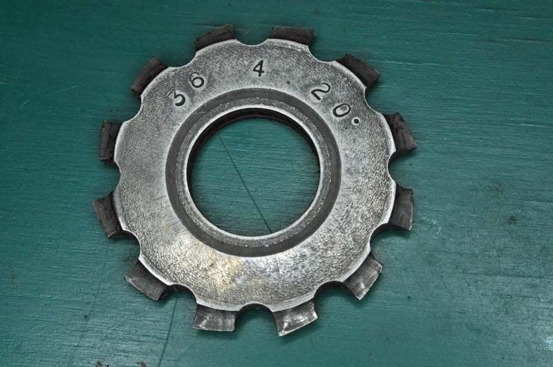

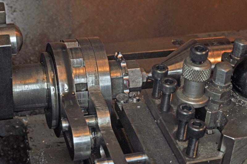

                                      I made a No.4 36DP cutter using the Eureka backer offer:
                                      It's silver steel, hardened then lightly tempered at 190C for 15 minutes

                                        Rod,
                                        Nice.
                                        I have a Eureka relieving attachment but it was scaled up to do full size 1" bore cutters.
                                        It works very well. I was actually paid to make mine at the last place I worked as they needed loads of special profile cutters. I made it all out of gauge plate, had it professionally hardened and a lot was also ground to size.
                                        Must admit made a lot of special cutters on it but ironically never made a gear cutter with it. smiley
                                        Still have it somewhere in it's nice wooden box with felt lining. We used to make piano actions so had loads of nice wood and felt wink

                                          Trying to understand what's happening in the first picture. Youtube came to the rescue:
                                          Interesting device.

                                            John, Did you scale up every part of the tool? I am thinking of building one to do 1" bore cutters.

                                              Hi, what rods are you using to do your fillet welds, I would suggest that if you used an electrode with iron powder in the coating,you would get a better finish and use a drag welding technique( the electrode touching the workpiece)It should leave you with a concave profile which would look similar to an original casting. Just a thought

                                                Wow, I thought I had seen that Eureka gadget a couple of years ago then promptly lost track of it and forgot the name!! Does anyone know if there are drawings/sketches of it so I can make one??? Please??

                                                    Rod, How do you quench a disc like that? Flat or on edge? or isn't it that sensitive to thermal shock?

                                                      There are drawing of the Eureka in Ivan Laws book "Gears and gear cutting" , Special Interest Books.
