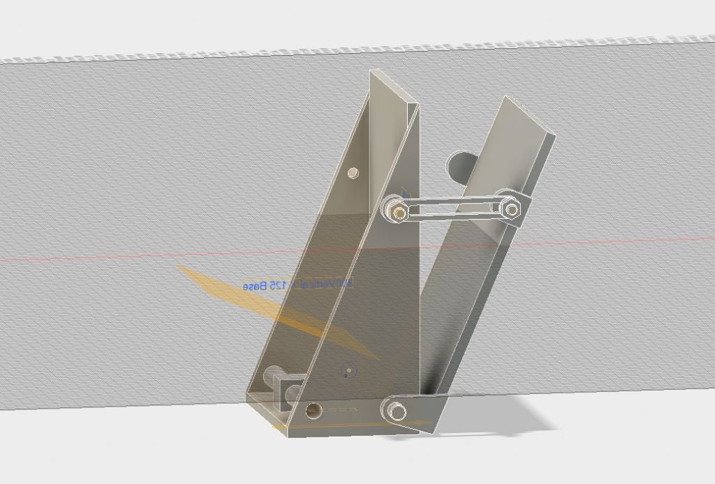

                      When I bought my Tormach Mill a few years ago I bought a plain 8" Rotary Table 4th Axis. At that time I don't think they had a tilting axis table available and even if they did I probably wouldn't have bought one. At the time there was no mention of them not being suitable for use with an ATC (Auto Tool Changer) but I noticed they do say this no., However, because when mounted vertically there is little clearance below tools held in the ATC Tormach came up with the Super Spacer.
                      This table is different from a standard table in that the Stepper motor is mounted in such a way that it can be mounted at the right hand end of the mill table, the old plain 8" rotary cannot be mounted vertically at the left hand end of the table because the stepper motor sticks out in the Y axis direction and fouls with the control panel and column.
                      I have a job that will require me to mount the rotary table at the right hand of the table with table tilted at an angle of 98 degrees so I have come up with this design that should allow me to mount the table in any position from about 60 – 120 degrees. I have also made it so that by fitting the long leg of the mount flat on the table, taking the tilting table part of the mount off, turning it round and fitting it to the other side of the mount using the other hinge holes I should be able to get the table set to any angle from 30 degrees below horizontal to 45 degrees or more above horizontal or more depending on the length of both link arms.
                      I will be getting the welding kit out tomorrow after visiting my metal merchants.

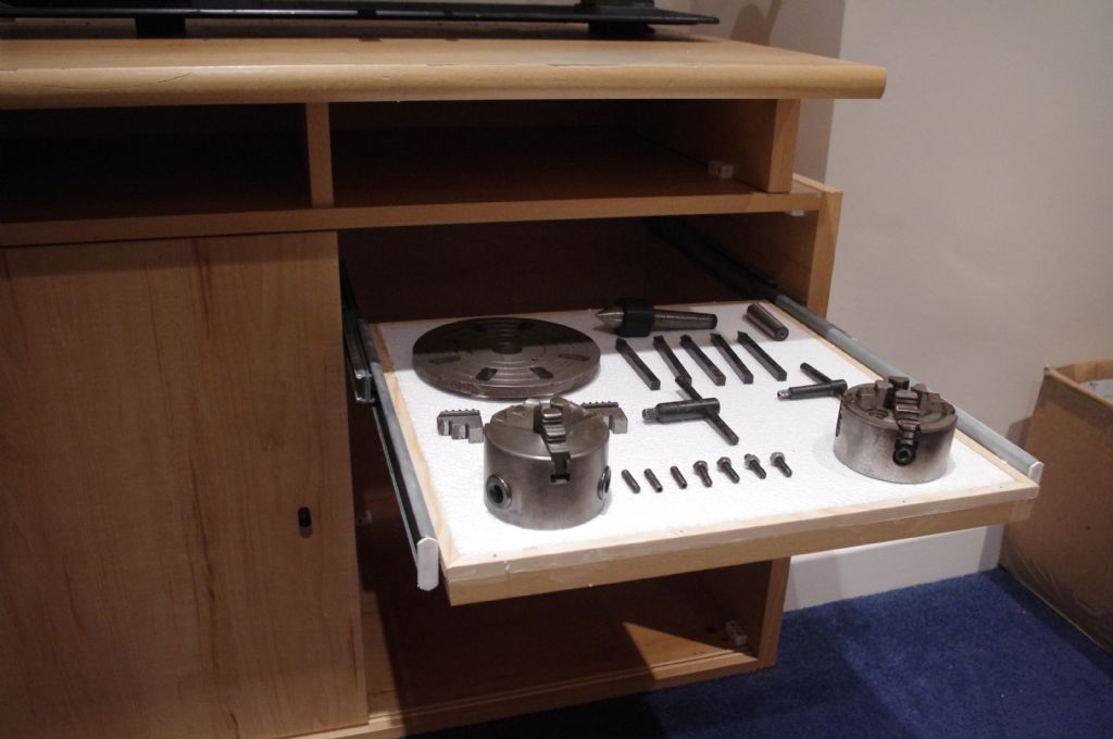

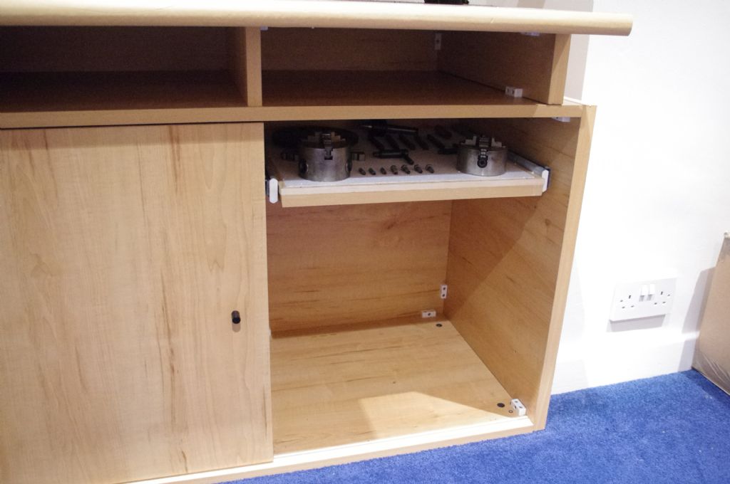

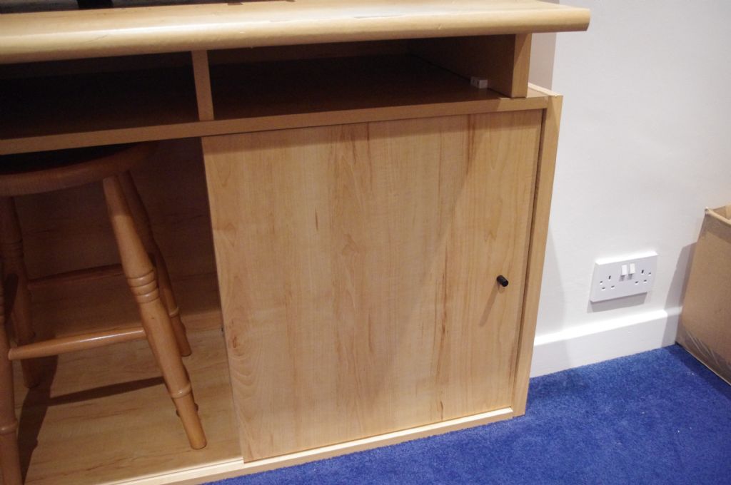

                                        Determined that the new location my for man-cave/workshop would start with the principle of 'a place for everything & everything in it's place', I didn't want all of my lathe & mill accessories just chucked willy-nilly into a cupboard or drawer. I dug out some heavy duty drawer slides from my 'might-come-in-useful-one-day' pile and made up up a couple of sliding shelves and fitted them to my lathe & mill bench.
                                        My original intention was to fit the shelves with polystyrene sheet & cut out shapes for everything to sit in. However, I quickly realised that the polystyrene didn't cut cleanly & easily breaks up into small balls, so I might change it for some sort of foam. On the other hand, I found that the heavier items sit on top & don't move when the drawer is opened or closed, unless it's done rather violently, and the lighter items can be held in place by pressing them into the polystyrene and creating a shallow impression.
                                        Brian

                                          Brian: Good grief, that's smarter and tidier than my house. Let alone the workshop!
                                          Andrew

                                            Brian, have a look at Corex sort of plastic equivalent of corrugated cardboard. Cuts well and can be 'found' in estate agent and political signs.

                                              Posted by Andrew Johnston on 18/12/2016 20:14:31:
                                              Ah, but you can't see the pile of c**p piled up on the bench on the other side of the room! wink
                                              Brian

                                                Yesterday I finished my angle plate/fixture for mounting the rotary table 4th axis at an angle to the Milltable.
                                                #272907
                                                Bob Rodgerson
                                                  @bobrodgerson97362
                                                  I Don't think the video has been added to my posting so here it is just in case.

                                                    Ah, At last I got it to work. I did as instructed re reducing the video size to 450 but it didn't work, however on a hunch I tried it a smaller size and it seems to have done the trick.
                                                    Here it is again My adjustable mount for the 4th Axis
