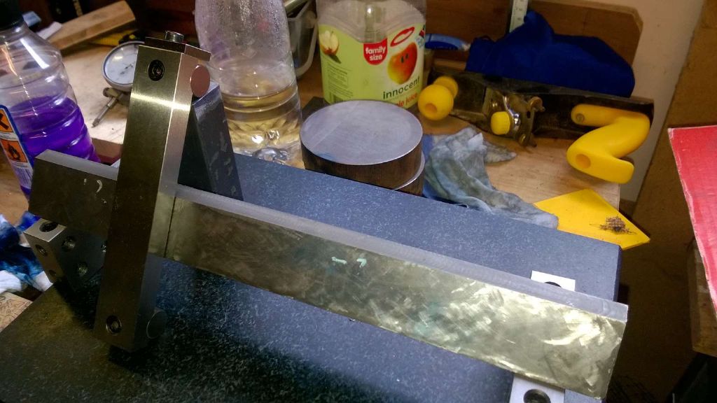

                  After months of stumblings, I've finally done something constructive enough to post on here!
                  Following advice in another thread, I've invested in a sine bar to check the angle of my prism. A back of the spreadsheet calculation showed that the height needed to be 104.03mm.
                  So I've milled, filed and scraped a piece of steel to be 104.03 mm as the riser for the sine bar. That is assuming my height gauge is accurate, which I can't check.
                  Actually, the top varies by +0.01 / -0.02 mm or so, but for something made with my own fair hands I regard this as the ultimate in precision! That would put the angle out by something like 2% of a degree. Far better than I can work to!
                  Next step is to actually check and correct the angle. Well next but one; I'm still working on getting the base flat. I currently on scrape 180 and counting. I expect I'm doing something wrong for it to take so much work, but no doubt I'll get there!
                  Next time I try something like this I'll try and find a bit of cast. scraping mild steel is rather more difficult.
                  Iain

                    Posted by Iain Downs on 06/11/2016 13:25:59:
                    Iain
                    Looking good, Iain. I'd imagine you'd be pushing the limits of a garden variety vernier to measure 0.01/0.02 given that would be it's standard deviation anyway. Hence the necessity of your dial indicator. I dont think i've ever hand filed anything smaller than 0.1 tolerance, so it's commendable handiwork. Well done.

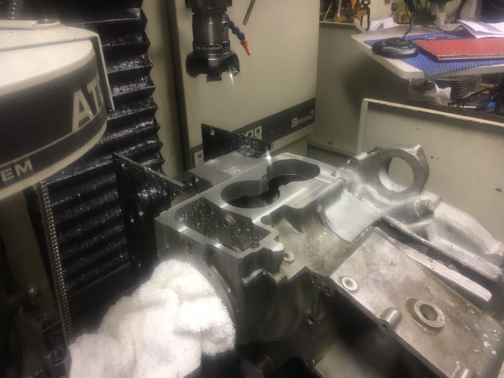

                          Not sure if this should be in the Motorcycle related forum or this one but here it is anyway.
                          At last I have managed to get a set of crank cases for a 1970's British Motorcycle engine set up on the mill and get the cylinder base machined. The problem with this job is that I have no dimensioned drawings and the timing side casing had already been part machined so I was having to reverse engineer things.
                          In order to machine the cylinder base at the correct angle and parallel to the mill table I had to make a dummy crankshaft with extended spindles so that I could place the extensions on raised Vee blocks, align the shaft with the mill X axis and clamp it in position using a couple of adjustable engine mounting plates and various clamps. It took me about 6 hours to make all the bits and mount the engine on the table just so that I could programme the mill and machine the base in about an hour.
                          I have machined the crankshaft journal bearing housings and installed the bearings and the next job will be to fit the crankshaft into the engine and install the crank in the correct position. In order to do this I have made a jig/fixture that will allow me to fit the pistons and land the cylinder block into the fixture aligning the X axis face of the jig with the mill and clamp the jig to the castings. I can then remove the cylinder and then either spot through the jig or centre each hole using the mill coordinate read outs and my centre finder and drill the tapping holes for the cylinder head studs.

                            Posted by Bob Rodgerson on 11/11/2016 09:27:26:
                            At last I have managed to get a set of crank cases for a 1970's British Motorcycle engine set up on the mill and get the cylinder base machined. …
                            Bob, what particular Brit bike engine of the 70s is this one? Not a BSA Fury/ Triumph Bandit is it? Cavity on the left looks very cam-chainish and gearbox cover coming off on the left is very non-British-tradition. Please tell us more about this project. Are you machining cases from raw castings?

                              Hi Hopper,
                              you aren't wrong in your assumption. I was asked if I could get the engine to the stage where the crank would turn and the pistons go up and down so that further work can be carried out to get the engine into running condition.
                              The drive side casting was completely raw and the timing side partly machined. I can't tell you an awful lot more about it because of confidentiality issues.

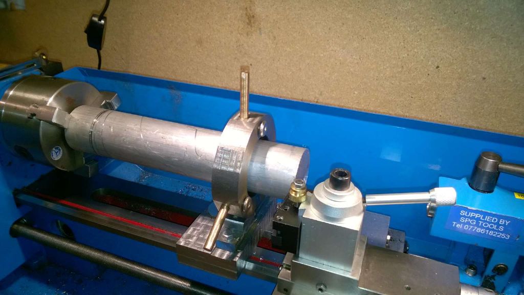

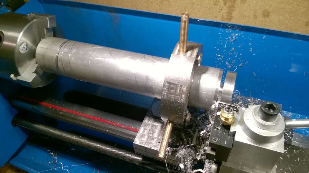

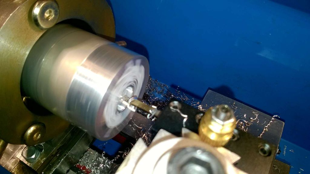

                                    A year after I made my Fixed steady, I've finally got to use it!
                                    I'm making a mount for my indicator and all I had was a very long piece of 50mm ally.
                                    Facing off
                                    Boring
                                    And finally, parting off the bit at the end.
                                    Dead chuffed I am.
                                    Iain

                                        Posted by Iain Downs on 12/11/2016 16:18:43:
                                        I'm making a mount for my indicator …
                                        Looks good so far, Iain yes

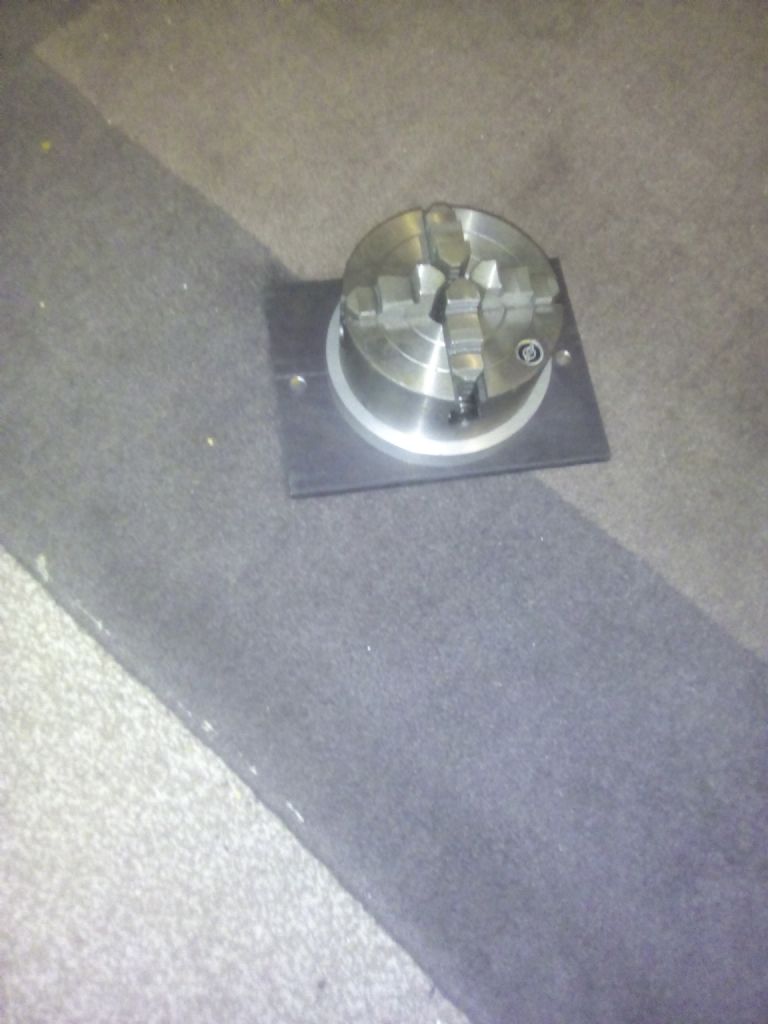

                                            chuck
                                            got rd to mounting my 4 jaw on a plate that i can bolt to drill press.
                                            got some odd shape bits to drill for a project that can't hold securely in drill vice.
                                            also fit's my 3 jaw.

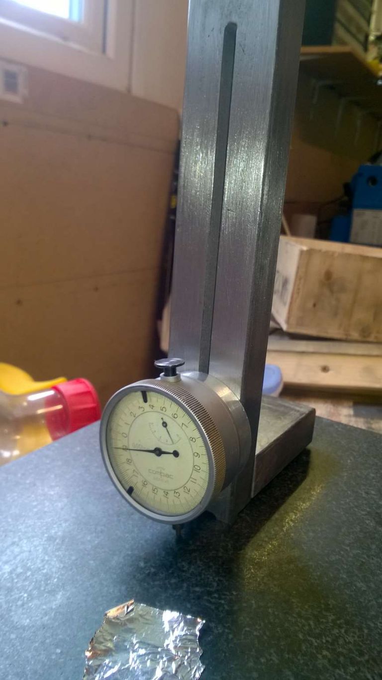

                                                Iain Downs
                                                  @iaindowns78295
                                                  Last weekend I was on a roll – my PCs were finally back together and working (don't ask) and I was on the verge of completing an indicator stand for my Compac micron indicator.
                                                  I was so looking forward to posting a 'look I've finished something!' rather than a 'er…. how do you'.
                                                  Then disaster struck. My 6mm tap snapped in the hole. My own fault. Having a choice between a 5mm and a 5.5mm drill I went the wrong way. And I would be every so grateful if those who so magnificently contributed to my question about M8 tap drills would refrain from any comment on this one.
                                                  Some searching on this forum and a few minutes with eBay found me a 5mm carbide end mill and a new Volker tap (also a spiral tap which is what I actually used – I think I might get more of those…) and a set of 0.1mm separated drills.
                                                  This morning I machined out (high speed and slow feed) the offending tap, re-drilled, re-tapped and assembled and here it is!
                                                  It seems to be very stable with it's 3 feet (and in a pinch I can stick a weight on the back).
                                                  Happy again – until my next disaster!
                                                  Iain
