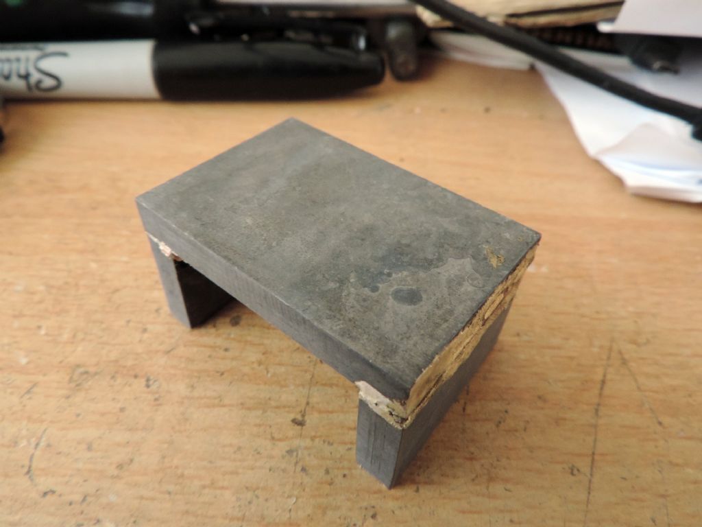

              On cleaning black steel, this is a bit of 5mm black plate, chopped up and silver-soldered into a simple 'U'. A few hours in 'suma scale' a product for descaling in commercial kitchens and all scale and dark grey finish gone and it's ready for machining.

                    Posted by Neil Wyatt on 13/09/2016 14:41:34:
                    Looks good Neil, did you use any kind of "jig fixture" for creating the butt join? If so was there any accounting for the loss of heat transferred away from the needed area for the join?

                          Posted by Michael Walters on 15/09/2016 12:25:09:
                          Michael W
                          Home made engineer's clamp. The clamp was red hot too

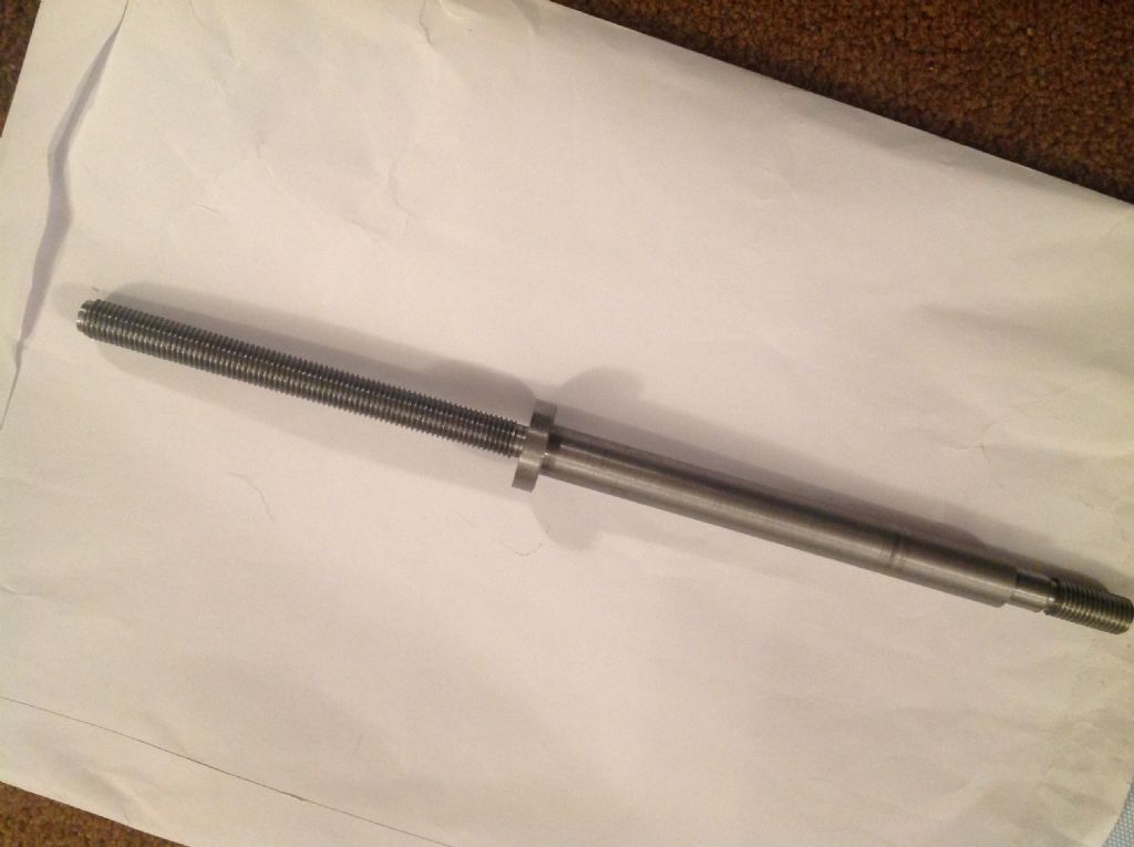

                            image.jpegMain feed screw for the stent the mark on the right is from the fixed steady while I screw cut the 3/8 BSF.
