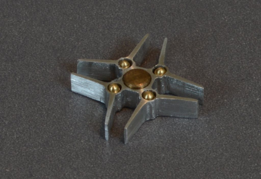

      I made a new set of nuts for the Harrier wheel. Here they are dropped into the centre:
      A form tool for the domed top nuts was made out of W-1 drill rod but I didn't swivel the vise 30 or 45 degrees and so I ended up having to changed the turning sequence as the tool holder fouled the work holding collet. Nothing about the nuts is very small but I had trouble holding them in an older hardened 8mm collet to turn down the shanks. Eventually I changed the diameter of the part that was supposed to be hex section to fit a new unhardened collet and got better results. I also lengthened the bit to clamp from that same diameter out to.025" from .020" and I suspect that made a difference as well. I turned the shanks down a couple thou under that of the holes and now they float around a bit to much. Have to be careful gluing them in. You can still see the dog leg on the left h and spoke of each pair where I drilled them 1 to 2 thou out of position.  Part is off to the caster next to see if it is good enough for what he has in mind.
      After the last couple of jobs I think that a good indexable turret  of the Meek/GHT variety and a depth stop for the WW/8mm drawbars would be pretty handy. Not sure how the latter will work as those types of collets draw the work in a fair bit  for their size but I'd like to try the idea out none the less.

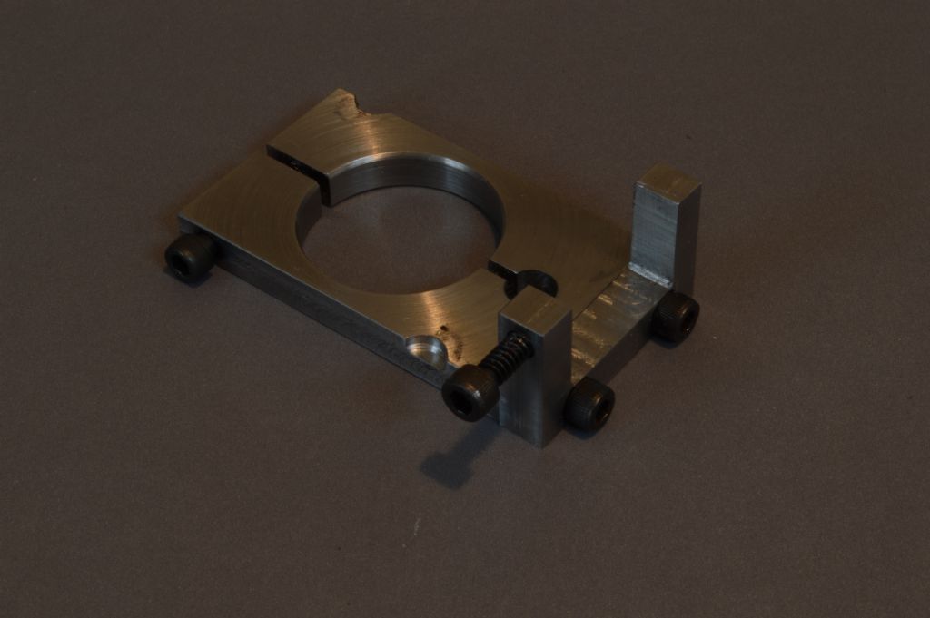

      I've included a pic of a Sherline mill spindle lock below. It is not very pretty but it does the job on the mill at least. I found out that this sort of thing is too thick  to fit on the lathe with the four jaw mounted as that chuck as a protrusion around the rim. Guess I'll be sticking with change gear detent for the time being when using the lathe.

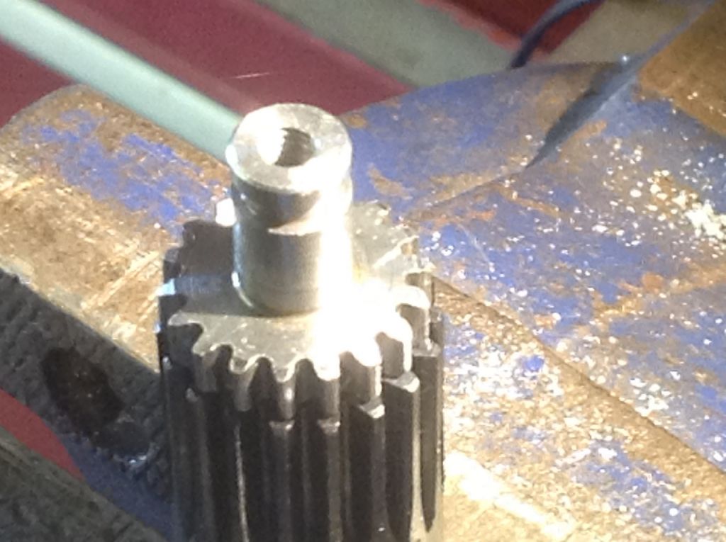

                                  Workshop progress of a sort, I suppose.
                                  Measure twice – cut once. Isn't that what we're always told? Well. . . . . .
                                  I have been trying to work out why the auto feed on my home brew boring/facing head keeps jamming. After a lot of head-scratching, I decided that my gear cutting was at fault and cut some new 12-tooth gears as accurately as I could. Having fitted them, still the darned thing jammed! A brief stay in hospital for a couple of stents to be fitted and rest afterwards allowed me the opportunity to bite the bullet and order two 12-tooth gears and an 18-tooth gear from HPC. Duly fettled the 12-tooth gears and they meshed perfectly, as you would expect. As the feed screw gear is formed as part of the feed screw, I tried to get away with using my effort. It was better, but still there was jamming of the gear train. More head-scratching (by this time I had quite a sore head ). When I held the new gear up to the old one, you could hear the penny drop from miles away. I'd turned the O.D. of the gear too small resulting in a hybrid form that was never going to mesh properly with anything. See below:
                                  Measure twice-cut once
                                  For scale, the HPC gear, below, is 20mm diameter. I'll have to turn my gear effort down and stick a slice of HPC gear on with Loctite 638 and hope it holds.
                                  Like they said – measure twice (or more times ) and cut once. You live and learn.
