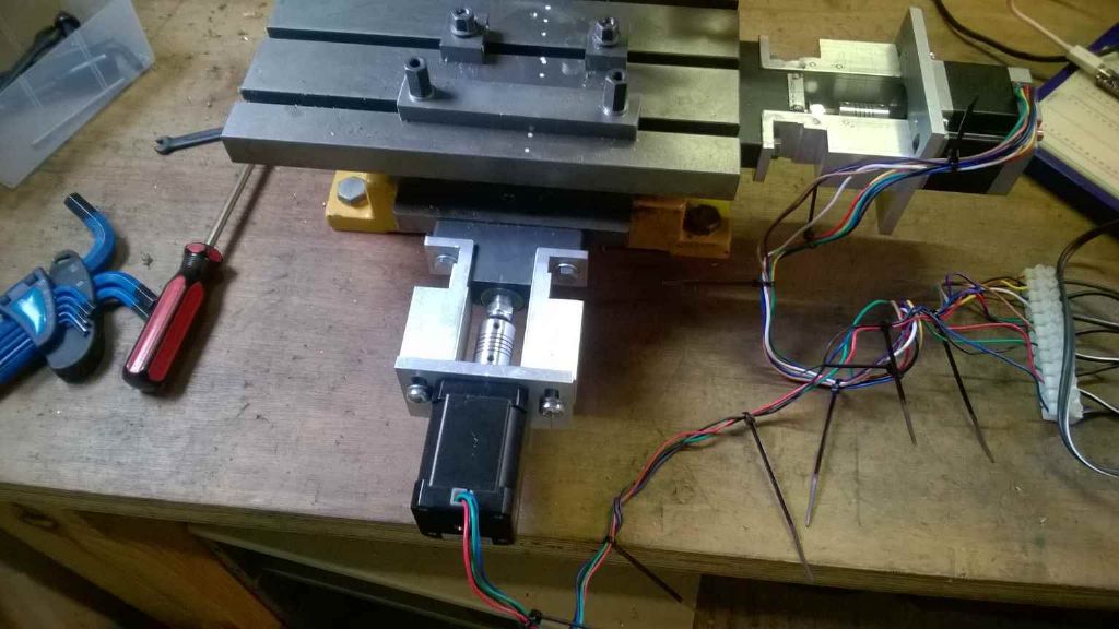

    Iain Downs
      @iaindowns78295
      I've been on leave, this week with merry anticipation of loads of swarf making. As you can guess from the first sentence, it didn't work out quite like that.
      One of my goals was to get my 2 Axis CNC conversion on my little mill finished.. I kind of managed this and it's working sort of, but I made the mistake of deciding to convert my program that drove it to Windows 10 (so I could run if from my phone). Don't ask my why. And don't ask me why I thought that Microsoft for once would have moved versions without totally reworking everything and requiring you to learn it all again.
      And my arduino code was flawed too
      Still it's going (of 5 days later than I expected) and I now await the next delay on my project with anticipation
      (If you're wondering why the motors are different – I started off with a nema 17 then decided I wanted to use NEMA23 – with double ends for manual control. I've not got round to building the brackets for the second NEMA 23 – though I may try that on the Z axis next..)

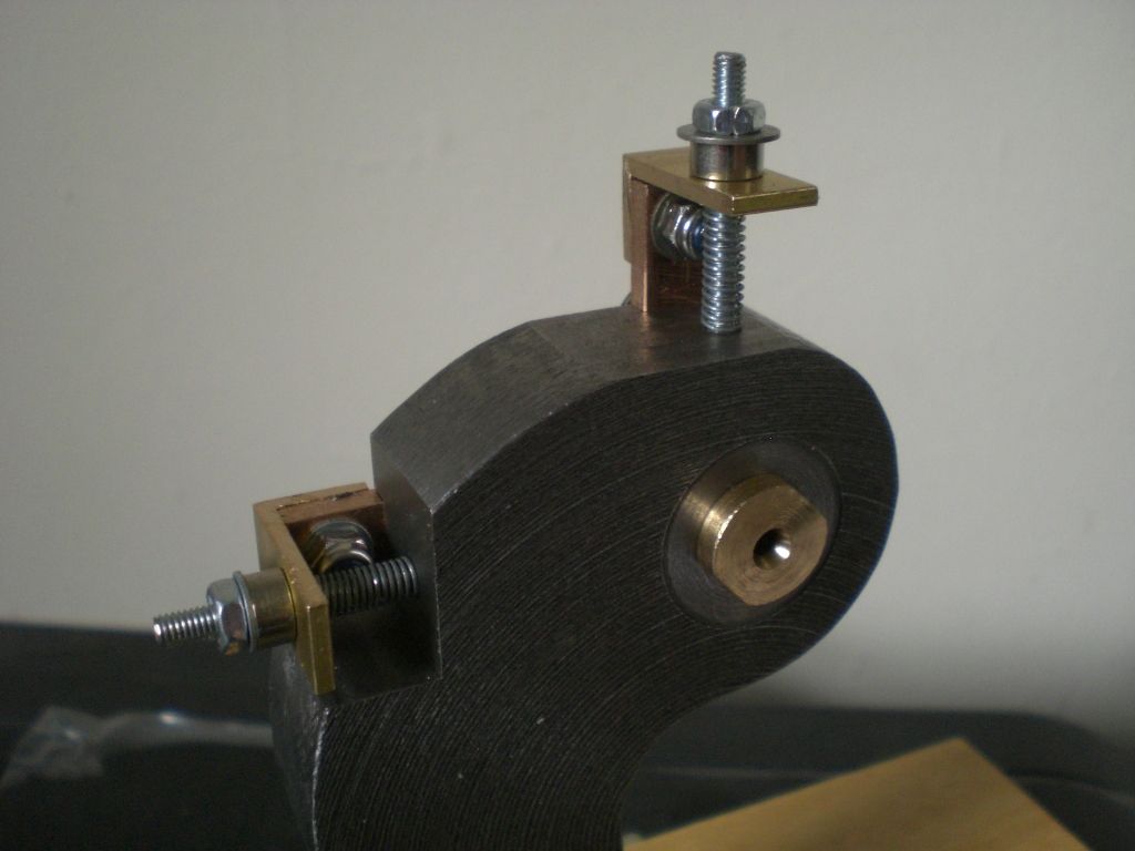

                Nicholas Farr
                  @nicholasfarr14254

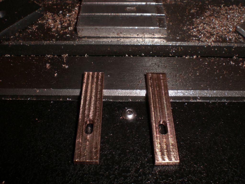

                  Hi, it's been awhile since I've been able to do anything more to my travelling steady. I did make a brass insert to fit into the hole at centre height and drilled it to a close fit to a rod that I wanted to turn down, however, although it did work, the portion that was reduced in diameter turned out to be tapered.
                  Having suspected that the original simple idea may not have worked, I employed my contingency plan. Firstly, two 8mm x 3mm channels were mill at right angles to each other, one is on the centre line on the vertical plain and the other is on the centre line on the horizontal plain.
                  The bottom forward quarter from just above the brass insert was then milled away to a depth just below the two channels. A section at the back of the horizontal channel was then milled out to form a step the whole thickness of the steady and about 2mm below the bottom of the channel. (I forgot to take a photo of that, but it will be seen in a later photo)
                  Regards Nick.

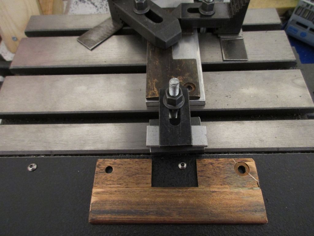

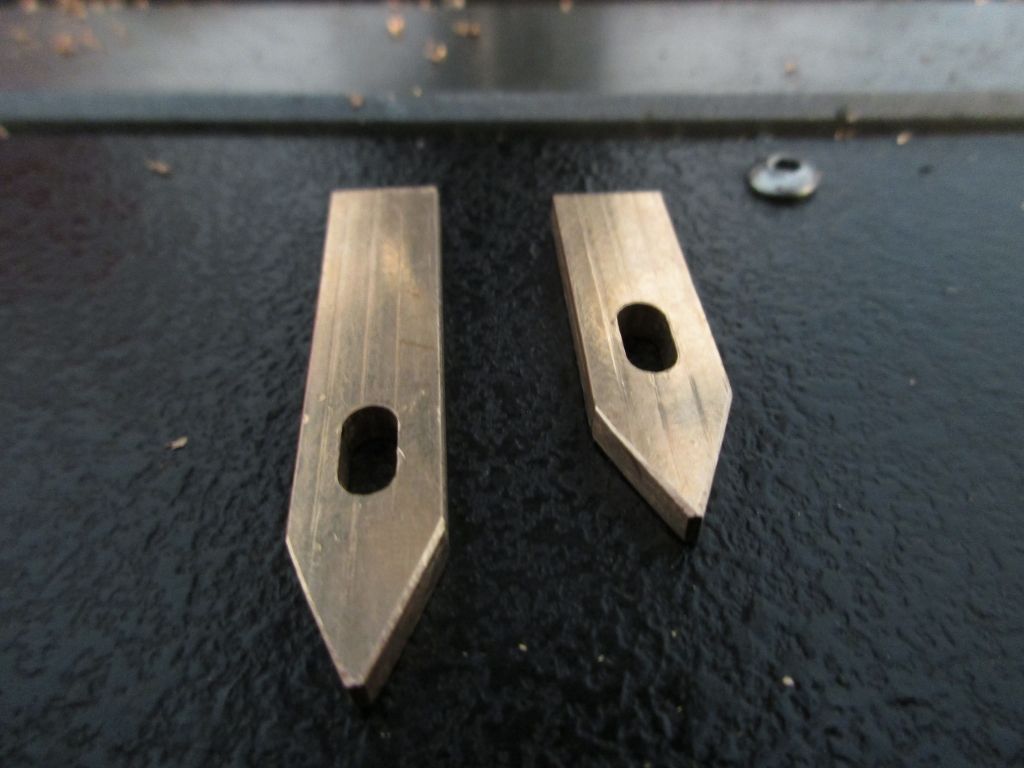

                  #242524
                  Nicholas Farr
                    @nicholasfarr14254

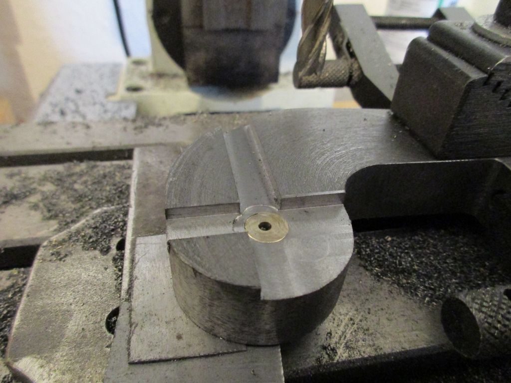

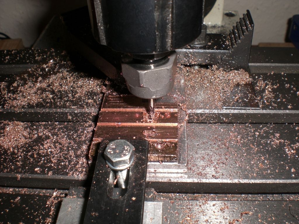

                    Hi, The next thing I did was to mill flat a worn bronze wear plate that I salvaged from a machine that a couple of workmates and myself did maintenance on for a customer earlier this year.
                    Notice the sacrificial piece of aluminium that the bronze wear plate is clamped down onto.
                    Two 8mm fingers were partially cut through with a 3mm end mill and a 6mm long x 3mm wide slot was milled close to one end on the centre line of each finger.
                    Once the slots were finished, the fingers were completely milled out.
                    The ends of the fingers near the slots were then hack-sawed and filed to a 60ish degree point, but leaving about 1mm of flat on the point end and one finger was reduce in length.
                    Regards Nick.

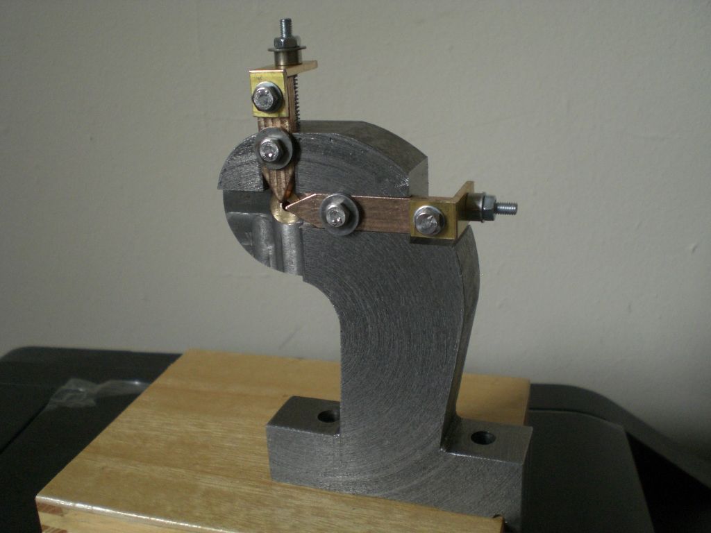

                      Nicholas Farr
                        @nicholasfarr14254

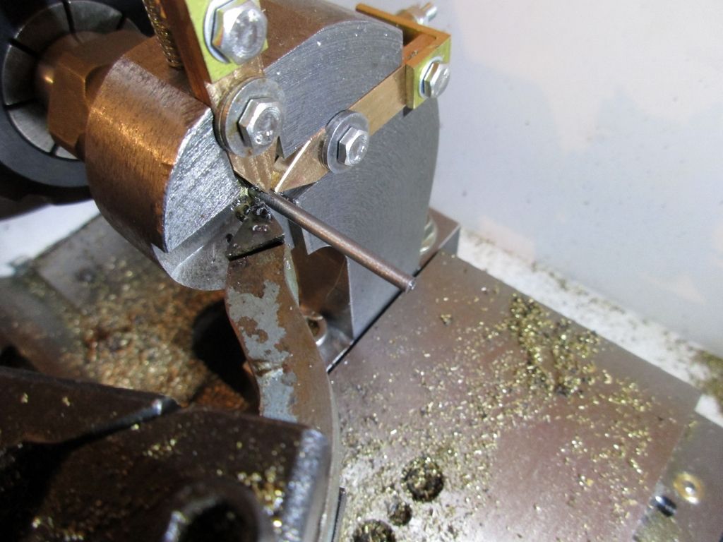

                        Hi, the next stage of my travelling steady was to attach a piece of brass angle 8mm long to each one. These were cut from a 3/4" x 3/4" x 3/32" section that I have and one leg of each piece was then cut down to 10mm, this leg was then drilled along with one of the fingers and were bolted together. A single 3mm hole was also drilled in the other leg of each angle, to correspond with M3 drilled and tapped holes in the top and back of the steady and on the centre line of the milled channels. Two M3 holes were also tapped in an appropriate position in the milled channels for the slots in the fingers. Threaded rod is used in the M3 holes in the top and back of the steady with a spring and these are used for the in/out adjustment of the fingers and M3 bolts and washers are used in the finger slots to nip them tight once adjusted.
                        Upon trying this setup, it was found to be able to reduce my 2.25mm diameter rod by 0.05mm with ease and parallel.
                        I now have a successful travelling steady for small diameter rod for my Conquest lathe.
                        Regards Nick.

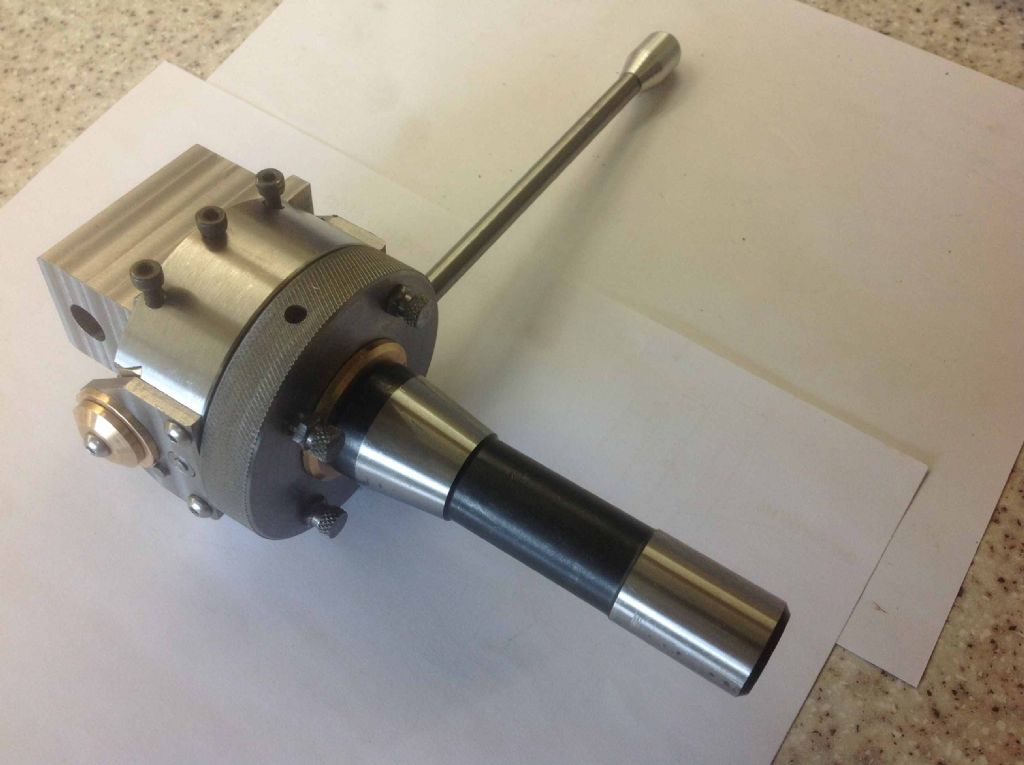

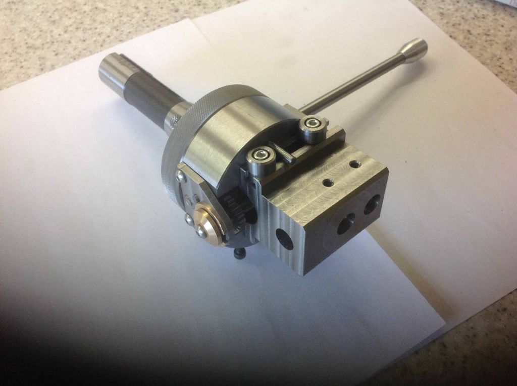

                          Now mostly recovered from my angiogram, I went back into the workshop to build up the boring/facing head. There's still some tweaking to do, but it works (under hand power). Just remains to try it on the mill – but that is for another day.
                          Finished at last!
                          And, flipped over …………..
                          Showing travel stops
                          More pictures of how I got to this stage are in my album "Modifying a Graham Meek design", if you're interested.

                                Hopper
                                  @hopper
                                  Posted by Nicholas Farr on 14/06/2016 06:17:38:
                                  Regards Nick.
                                  Lovely looking bit piece of work there Nick!

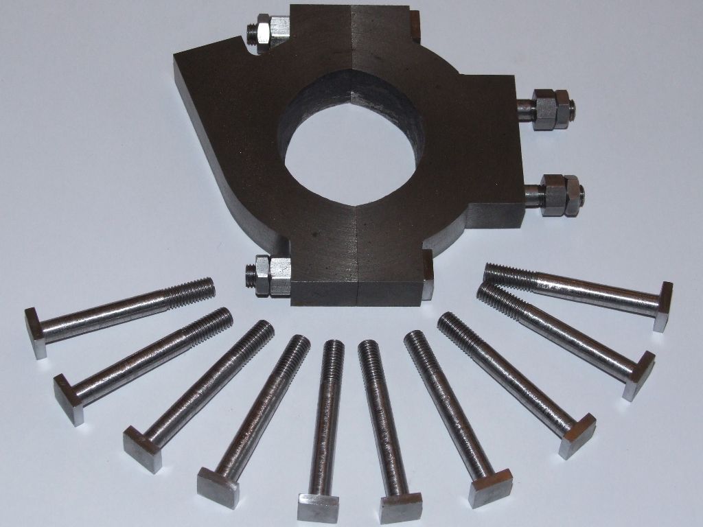

                                  Anonymous
                                    Posted by JasonB on 19/06/2016 07:27:07:
                                    ……always like to see what you have been upto with the Britan or as there were only a few was it not worth setting up for a batch?
                                    Yes, I did use the Britan for most of the operations. However I used the Bridgeport to reduce the heads from 1/2" square. This was necessary due to a foul up in the position of the hole on the eccentric strap. If left at stock size the head would have been proud of the strap. I'm not really happy with the bolts, somehow they don't look right, I think the heads are too thin? But I'm not sure I've got the enthusiasm to make them again. Here are the bolts:
                                    The nuts and studs were made ages ago, and I profiled the outside of the straps last week, on the CNC mill.

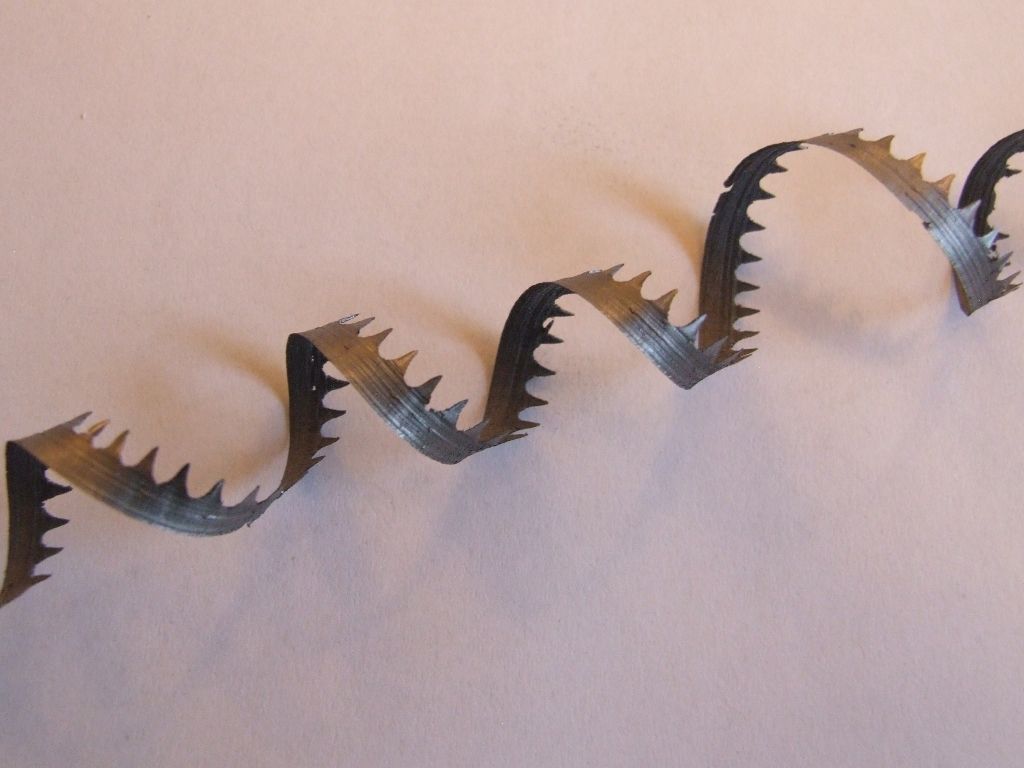

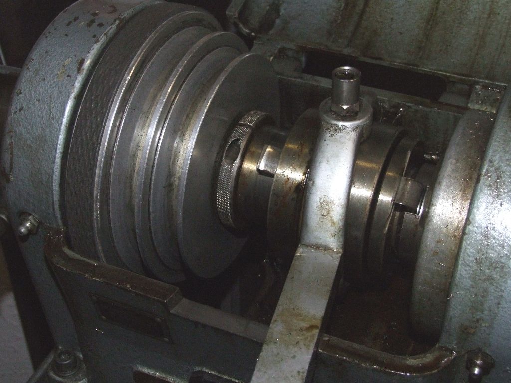

                                    I also had a screw failure on the Britan. sad When changing collets from 1/2" square to 1/4" round the screw that clamps the collar that sets the force required to operate the collet closer snapped. It doesn't stop one using the lathe, but will need to be replaced. I'm hoping I can get the broken bit out without having to dismantle the headstock:
                                    The offending collar is the knurled one in the centre, just to the right of the pulleys.
                                    On a more positive note the swarf that came off when reducing the 1/2" square stock to 1/4" diameter, in one pass, is rather pretty:
                                    Although it varies, the thickness is around 12 thou.

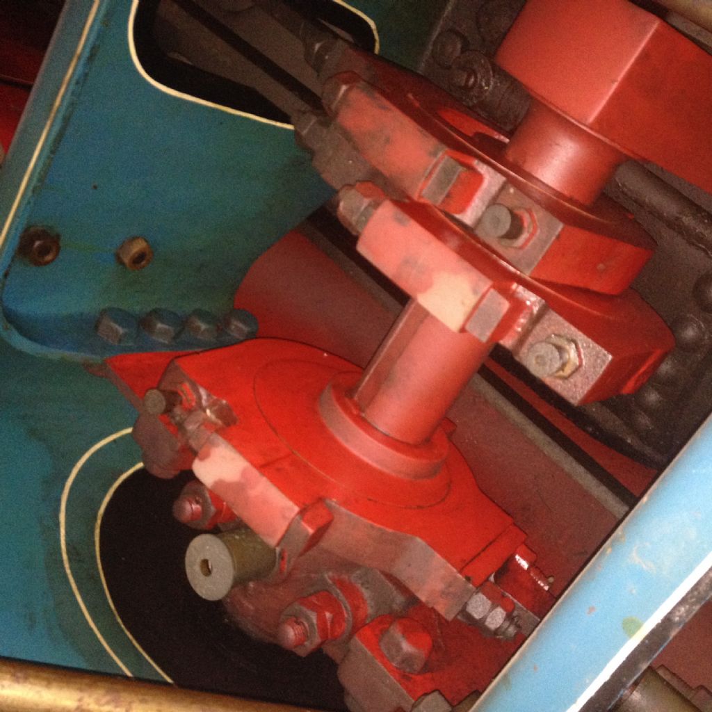

                                        This is a full size Burrell where I used to work. I assume it's fairly original. The lock nuts look good but I must agree the square heads seem proportionately thicker here.

                                          Anonymous
                                            Muzzer, thanks for the picture. I've been all round the ****** houses with the bolts today. Having looked at some pictures of a model Burrell it used hex head bolts, so I decided to bin the square head bolts and make some hex head ones. An advantage is that the hex head will clear the oiling lug so the bolts can be fitted the correct way round, ie, nuts towards the rods. Then I had a closer look at the pictures I took in Burrell museum and the bolts definitely look square headed. This is confirmed by the much clearer picture from Muzzer. Then I tried a square head bolt and blow me down, the darn thing fits the correct way round. So the upshot is that I'm going to stick with the square head bolts and fit them the correct way round. I will take the sharp corners off the heads with some wet 'n' dry. Who'd have thought a simple bolt could cause so much trouble; no wonder the build is taking me years.
                                            I also noticed in my picture of the Burrell, and shown above, that the straps are not flat on the tops of the bolt holes but curved. It's easy to model this in 3D CAD, radius 2", but it's going to be tricky holding the straps to machine them.
                                            Muzzer: There's an inconsistency in your picture, the eccentric strap bolts for the water pump (at the bottom) are the wrong way round. Some-one has b*****ed about with 'em. wink 2
                                            I've removed the broken screw from the Britan without too much difficult, and no naughty words. The broken part measures 0.205" diameter and is as near as darn it 28tpi. So I'm 99.99% sure it's 1BA. I don't think I've ever used 1BA before, so I'll have to order some.
                                            Andrew
