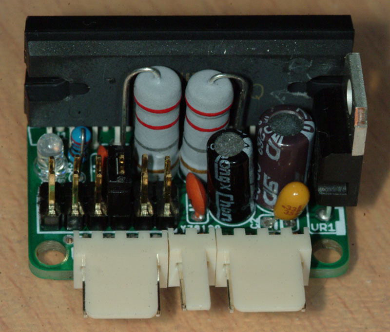

      The stepper driver is a PMinMO design that uses a Toshiba 6560AHQ driver, I had a bunch of boards made up by IteadStudio (10 for $9.99).
      (I will leave out the voltage regulator on the one I put together for this project), total parts cost is under £5.00
          Not familiar with PMinMo or IteadStudio. Presumably IteadStudio is this place. PMinMo.com seems to be no more.
          How does it work – I assume you upload the PCB files to IteadStudio (which you found somewhere) and they send you them in the post. Not a bad price.
          Is there anywhere that will kit all the parts for you (for either or both of the controller and driver) or did you have to scout around for them all? Steve Ward only seems to offer the controller without the display unless you buy it preassembled and tested.

            PMinMO, is as you say, unfortunately no more, the owner closed down due to health issues, although the site can still be accessed via wayback machine, this is the link for the above stepper driver.
            If you have a circuit you (or someone else) has designed and you can export the relevant gerber files (there are well documented processes for doing this with Eagle), you then upload the gerber files for the relevant layers to IteadStudio and select what type of board you want. The stepper boards were under 5cm square so were $9.99 for 10 boards, I had some Sanguinololu boards made (about 5x10cm) for use on other 3d printers I intend to build – 10 boards for $19.99.
            I already had most of the components for the division controller, although to be fair for my implementation it was 8 resistors, 1 variable resistor, 16 buttons (and caps) a screen, a pcb, a microcontroller and a resonator.
            The screen (£2.86), pcb (£1.39), 12mm tactile buttons (£1.39 for 50) and caps (£1.99 for 140), all ordered from ebay, MCU (free) from Microchip, the other components are 7 x 10K resistors, 1 x 800 ohm resistor for the LCD backlight, a 10K variable resistor for LCD contrast and a 10MHz resonator, all of which I already had, but are pennies to buy even individually.
            Steve does also supply PDF files for etching your own boards (if you download the zip file), his original thread on CNCZone is here, by blog entry for the electronics build is here (although it does not say much more than I have already posted on this site).
            My board was made with stripped lengts of wire from solid core cat 5 network cable using this layout (I drew in DIYLC) as a wiring guide:

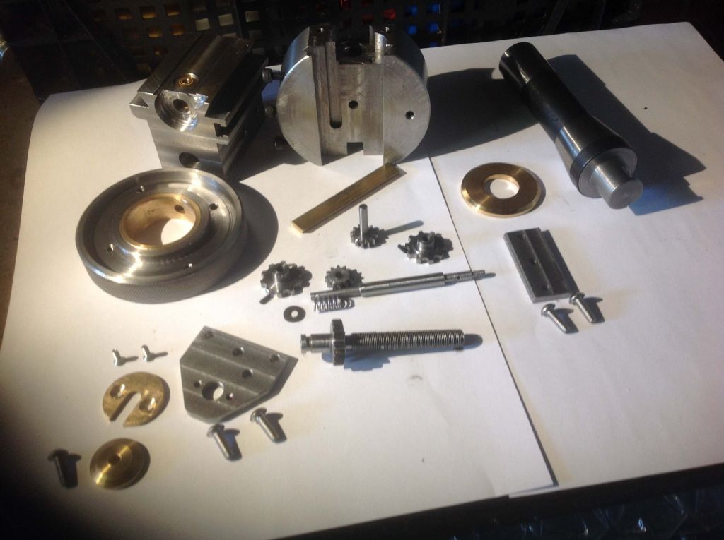

                      After a bit of a lull due to illness, I've been back in the 'shop to carry on with the boring/facing head. Did some lathery and trial fitting of various bits. Looks like I need to tweak the length of the driving pins a shade:
                      Collection of parts nearly complete Gear train trial assembly
                      Off on holiday for week now, so yet another delay! Still, I got David Gingery's book on making a shaper for my birthday (thanks, me!) so I'll come back enthused to make one of those, maybe.

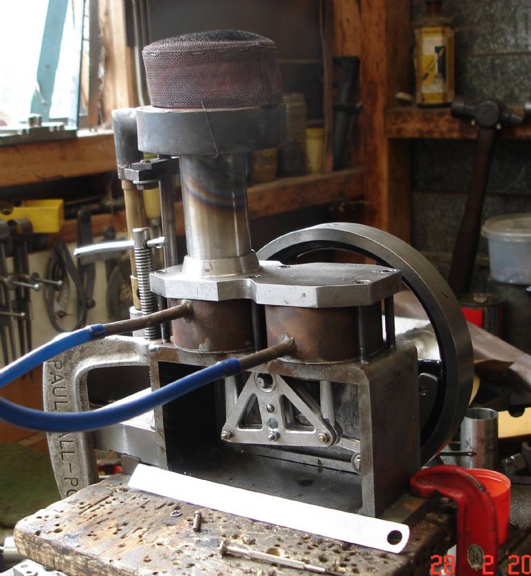

                                      The crankcase for my "Ross Yoke" Stirling Engine was made by welding some cleaned up scrap steel. Ian S C

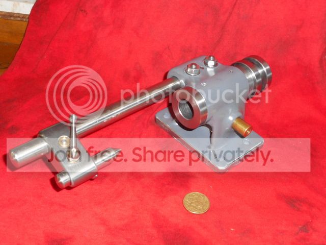

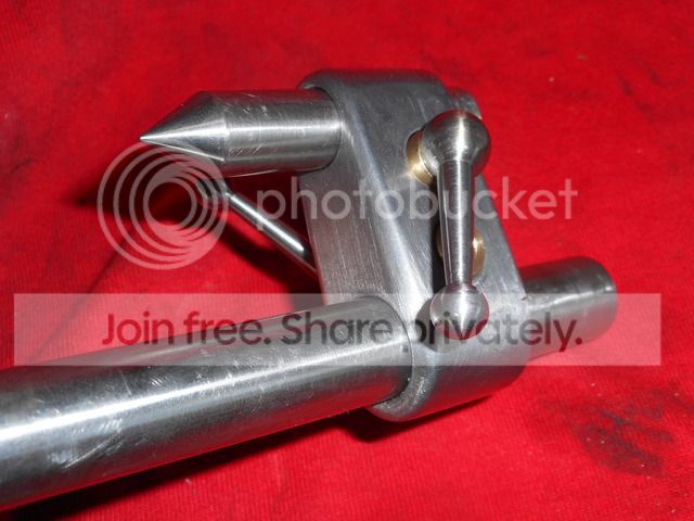

                                        Bit of (slow) progress on the fabricated versatile dividing head:
                                        Got the threaded rings made up, overarm and tailstock made up and all the little twiddly bits, including those very twiddly little tailstock locking ball-handled twidllers. One more to go on the main spindle lock.
                                        The ball handled twiddlers finished up slightly longer than GHT's original plans, by exactly the width of my parting tool blade. Fancy that!
                                        Gotta love Nikon cameras. It's only a little point and shoot but the glass is so good it does a great job of picking out every little emery paper scratch on what in real life looks like a nicely polished finish. That's my excuse and I'm sticking to it. (Well, it's better than "deliberate mistake" innit?)

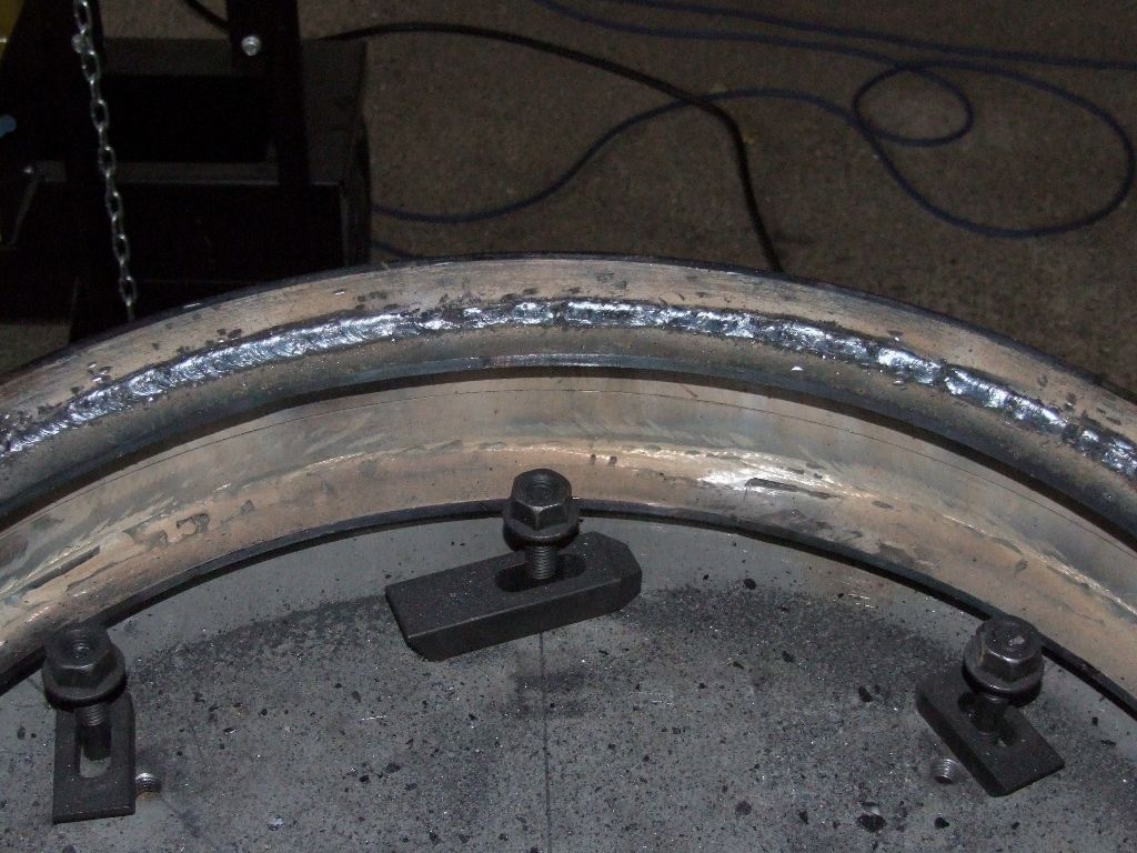

                                          My arc welding is improving, relatively speaking that is; another rear wheel rim and T-rings welded, three down one to go:
                                          Once I've finished I'll be able to start again and do it properly second time around. thumbs up

                                            Indeed, the old story. I've certainly seen a lot worse in my workshop! Looking good to me from where I'm sitting.
                                            What's responsible for it – a stick welder or a TIG / stick inverter? The actual rods used can make a big difference too.

                                              Hi Andrew, I agree with Muzzer, look pretty reasonable to me. I'm guessing you are using stick electrodes.

                                                For a better finish, try iron powder electrodes they will give a smoother finish with less dressing needed Try esab femax 33.80

                                                  Better than my Arc welding (not saying much…)

                                                    I'm using the MMA function on a DC/AC TIG welder. So the arc should be pretty stable compared to a 'buzz' box. I'm running 3.2mm rods at 110A, at which point the welder still has a 100% duty cycle. Just a pity about the defective operator. sad
                                                    Before I started welding the T-rings into the rims I did some experiments with MMA and TIG, but thought that TIG welding on 1/4" plate was a bit OTT. I seemed to need quite a high current for the TIG to get a proper fillet and it was slow.
                                                    Michael: Thanks for the tip; I'll need to buy some more rods to finish the job. A long time ago I bought some Hilco rods, which I didn't seem to get on with. The local welding emporium recommended rods by Oerlikon. Having finished those I reverted to the old Hilco rods to finish the welding session. And what do you know; the welding seemed to go a lot better with neater welds. I keep my welding rods in the airing cupboard to prevent moisture absorption. I've obviously got a lot to learn.
                                                    At least I can say it's all my own work.

                                                      Yes, TIG would have taken forever, cost an arm and 10 legs and you would have been frazzled by the end. It's also pretty awkward when you are trying to fit everything into a confined space – torch, filler, hands, head and mask. Certainly worth trying a few rods out at some point – surprising how different they can be.
                                                      Of course, you realise that this requires you to acquire a MIG / MAG machine. I find them much easier and quicker than MMA, not least because you can see what is going on and the wire feed takes care of itself. Slight downside is that you need a different gas (Argon-CO2 mixture for MAG / steel).
