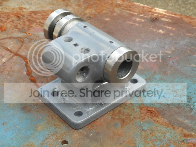

      Doh! I should know better than to try to paint in 80 per cent humidity. Got a bad case of the wrinkles where I laid the paint on the base a bit thick on the fabricated Versatile Dividing Head. So have left it to harden up a bit and carried on making the threaded rings to screw on the spindle and retain the main wormwheel gear, which will be an old lathe changewheel with a bit of fettling.

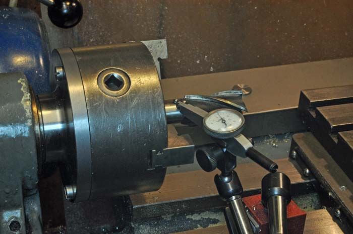

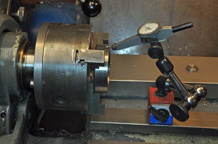

        Today's liitle project is sheer indulgence, or possibly just laziness. Changing the 3 jaws from internal to external and back again in 3 jaw chuck is just so tedious. I've noticed that Burnerd chucks that have become separated from their jaws go for comparatively little on Ebay. I went for a punt and bought a 4" orphan to (I hoped) match my existing 3 jaw. I needed a backplate so bought one from ARC and cut the 3" register then drilled the 3 mounting holes for 1/4" BSW on 3.5" PCD.
        The milling spindle motor struggled with a 6.5mm bit so I drilled 4.5mm and then opened these out on the pillar drill. My existing external jaws are a nice snug fit. Run out using this 1" milling cutter was 1.5 thou TIR.
        I struggled to find something larger to test but this old outer ball race showed 2.5 thou TIR
        Although the body of the chuck looks a bit battered, I seem to have struck lucky.
        Rod

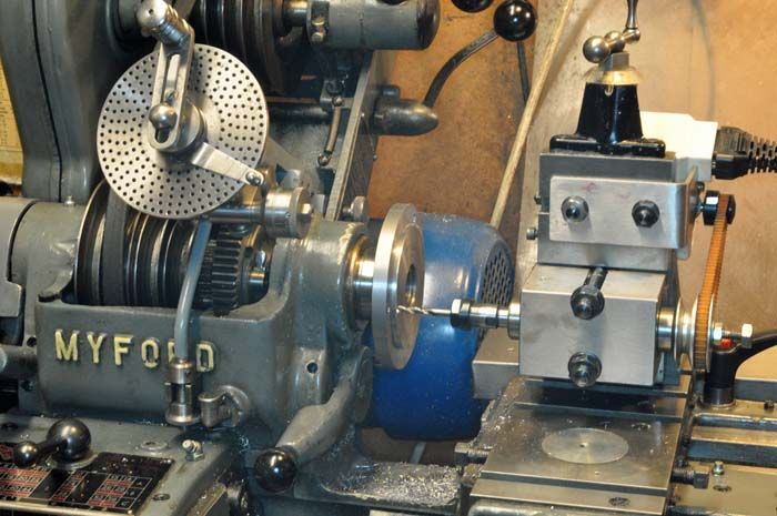

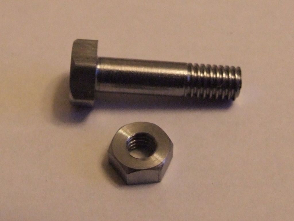

                                  The task this evening was to knock out the 2BA bolts on the repetition lathe for the steering gear brackets, and some M4 nuts for the water pumps. The nuts were made on the manual lathe, quicker than the repetition lathe for 12 off. For some reason I had all sorts of trouble with both sets of 2BA chasers in the Coventry diehead last night. This evening they worked fine – must be the operator. embarrassed
                                  And a close up in all the gory detail:
                                  It's time for a celebration; the M4 nuts are the last machining operation on the water pumps, and thus the end of the saga. thumbs up

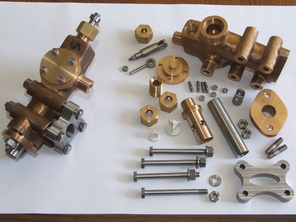

                                    The water pumps have been a right saga; now I can move onto something else. Probably the wheels so that I can empty the hall of all the parts that are currently cluttering up the place. Here's an assembled pump, and all the individual parts:
                                    Apart from a solitary 4BA nut per pump everything has been made from raw castings or stock material.

                                      Looking good Andrew, have you tried pumping one against a pressure gauge to see how the modifications perform?
                                      #238002
                                      Bill Pudney
                                        @billpudney37759
                                        As part of my ongoing Sieg C3 lathe upgrade, today I almost finished the tapered gibs mod. The weather stopped me, it was raining pushrods, it sounded like someone was firing a machine gun at the sheds corrugated iron roof. Just have a little bit to do on the gib adjuster screws, cut the gibs down from overlength and reassemble. The next thing on the list is a swarf/chip guard protecting the apron gears, which may incorporate some bearings. Then some way wipers, I already have some felt. The last thing(s) on the list are thrust races on the compound and cross slides along with a modified leadscrew nut for the cross slide.
                                        Then I can get on with my next project!!
                                        cheers
                                        Bill
                                        #238037
                                        Anonymous
                                          Posted by JasonB on 08/05/2016 13:13:52:
                                          ………..have you tried pumping one against a pressure gauge to see how the modifications perform?
                                          In a word, no – Andrew
