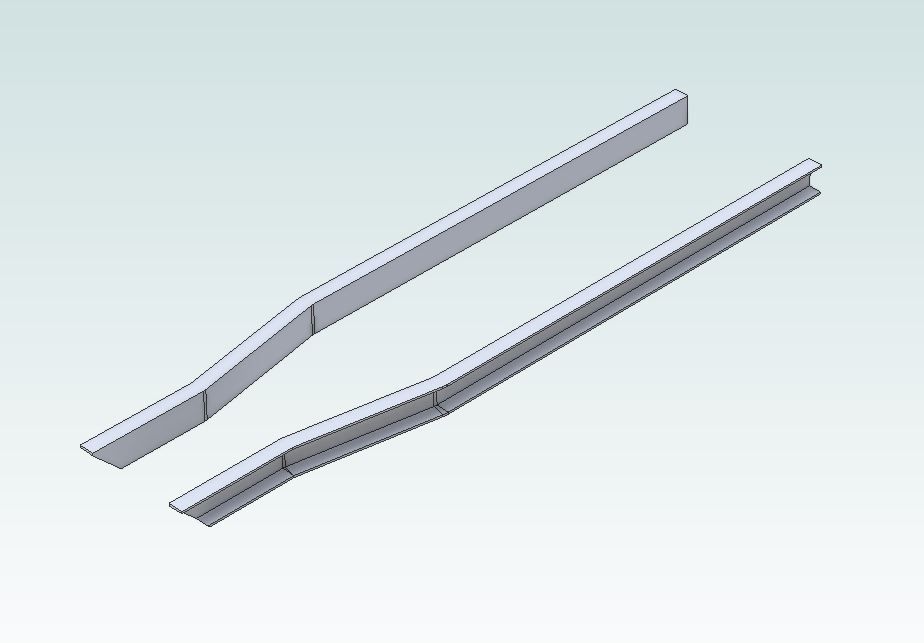

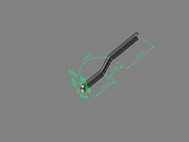

          Computer is usually the limiting factor both memory and graphic card need to be able to handle the file.
          Those chassis rails look to only be bent on plan so should not be hard to draw. Dead easy in 3D but actually produced by doing a 2D looking from above and another 2D of the end section of the "C" channel. Drew one side then mirrored to get the pair and finally chamfer cut at the front Flange taper is in there too. Just need to wipe the chalk marks off my screen nowwink 2

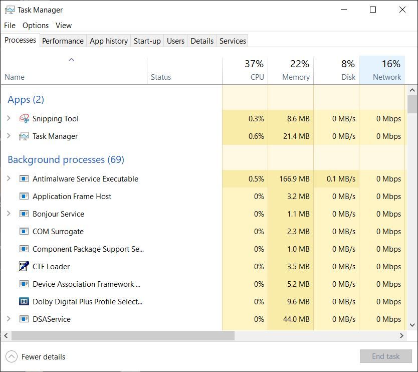

              Posted by Nigel Graham 2 on 05/05/2021 10:02:08:
              The same [Not Responding] problem arose briefly yesterday, with my large general-arrangement drawing.
              So my question…
              Is there a definite limit to the size and complexity of a drawing that TurboCAD and the computer can handle?
              Or is the problem caused by keeping all the Layers visible when working on any one part of the drawing?
              Or something else again?
              "Not Responding" isn't necessarily a fault, though it often is! Operating Systems expect any program displaying graphics to be interactive, that is 'responding' to inputs such as mouse clicks, mouse movements, and keystrokes. If none are received within a certain time and the program has consumed over a certain number system resources, the Operating System issues the 'Not Responding' warning because the symptoms often indicate a fault. But calculation heavy programs, like CAD, might legitimately exceed the warning limit.
              Is there a definite limit to the size and complexity of a drawing that TurboCAD and the computer can handle? Yes. Computers are machines and they can be overloaded. Typical limits are:
              • Number of CPUs and their processing speed. (Limits the number of operations per second.)
              • Size of Random Access Memory. (Limits the size of programs and data that can be stored in fast memory. Programs and queue if there is insufficient RAM, and when computers spend more time managing queues than doing real work the system grinds to a halt. ) Shortage of RAM is a common cause of poor performance.
              • Size of disc storage. (Limits the number of programs and the total amount of storage available. Rule of thumb, filesystems more than 80% full, or fragmented, also slow down dramatically. Although Microsoft's NTFS is much less likely to fragment than early filesystems like FAT, it's worth checking periodically)
              • Network Capacity. (Limits how quickly the computer can exchange data with other computers, again causing queues, especially when Windows is upgrading.)
              • Graphical Processing Unit. (Limits how fast graphics can be manipulated and displayed. Older computers may not have a GPU, in which case graphics are part of the CPU load.)

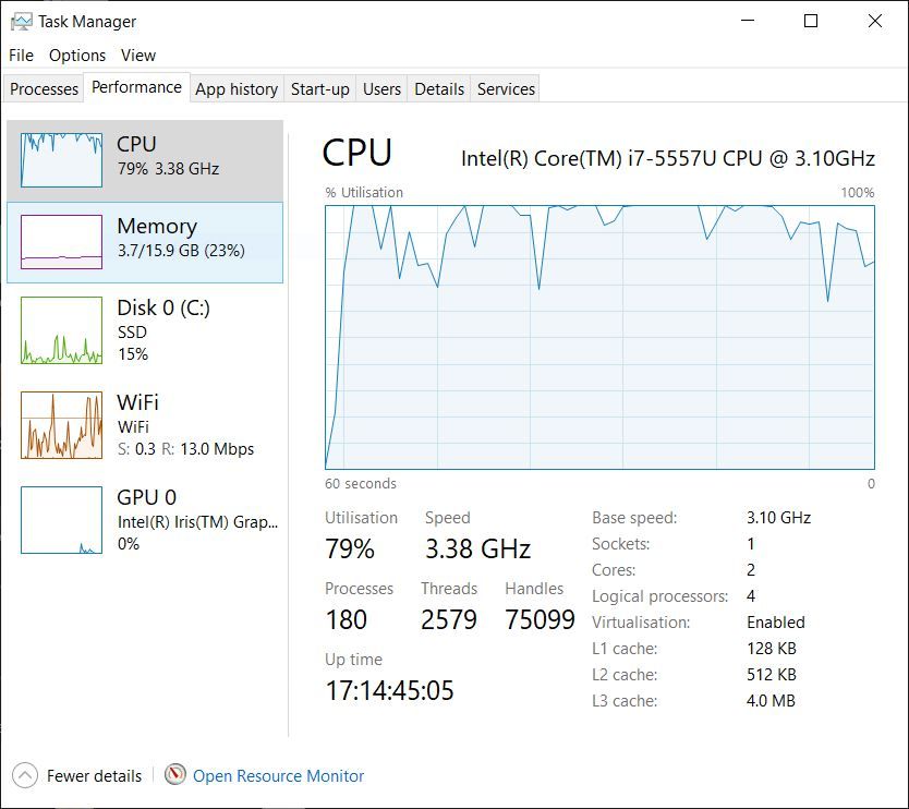

              Windows provides a tool for investigating these. Whilst 'Not Responding', type the CTRL-ALT-DELETE keys together, and select 'Task Manager' from the resulting Window.
              The 'Processes' and 'Performance' tabs are interesting. Fired up my Windows laptop this morning and it was a bit sluggish; task manager revealed CPU running at 100%, shown here dropped to 79% because I was so slow getting the screenshot tool to work! Memory, Disc, Wifi, and GPU are all fine, though the SSD (15%) is a little high considering I'm not doing anything!
              The process screen showed the culprit, though I was too slow taking the screenshot to catch it for you!
              The guilty program was the 'Antimalware Service Executable', turning on Windows triggered an antivirus scan which took most of the computer power for as long as it took to scan the hard disc. There are a number of resource greedy programs that can fire up in background and slow everything down. 'Not responding' might be due to one ore more of these colliding with TurboCAD. A new computer with 4 or more fast CPU cores, 32Gb RAM, a big SSD and a quick network will cope much better than a 15 year old clunker with 2 slow CPU cores, 4Gb RAM, a full slow hard drive, and dial-up networking.
              Software bugs also cause 'Not Responding', maybe TurboCAD is poorly. But check what Task Manager says first – nothing worse than spending days debugging software only to find the hardware was too small!
              Task Manager might reveal unnecessary services running, including malware. One of Windows security shortcomings is how easy it is for owners to accumulate rubbish – by making stuff easy, it opens the door to unwise operator decisions. As some malware works simply by soaking up resources, as does running a horde of unnecessary services and Start-up programs, it's a good idea to spring-clean Windows periodically.

                I had issues with the antimalware running when it was not welcome. I think I changed settings to get it to run only when everything else was quiet by giving it low priority.

                  Jason –
                  I don't recollect previous problems as severe as they were this time. TurboCAD sometimes does need to pause and think about what I've asked it to do, but usually for only a second or two, not ten minutes just to let me re-size a selected object.
                  Looking at your drawing there, I think I can see how I can do that: draw the plan view of the vertical web with its two bends, and turn it into a "solid" wall (an Extrusion). Then do the same with the flange, extruding that but by only 5mm, copy these figures as necessary and add them together. I recall previously making "angle-iron" by joining two extrusions edge to edge then "Add" – ing them. Not sure how I would cut the front ends back to that long bevel though.

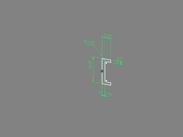

                    Posted by Nigel Graham 2 on 05/05/2021 14:18:29:

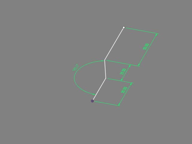

                    Why make it complicated, as it can be done with two simple, fully defined and editable sketches:
                    Sweep this profile(note the internal radii)
                    along this 3 line path(which could also kick up or down on another plane if needed)
                    to get this
                    The bevel would be another single line across the flat face and a 'cut' extrude. The whole thing instantly updates if you alter any of the dimensions.
                    It took longer to copy the images to my forum album than it did to create the 'model'
                    Copy, rotate and move for the other side. Draw the crossmembers directly on one of them, and extrude(they're straight) to the other one. No coordinates or working out needed

                      Strange – Despite that "house-keeping" I mentioned above I still had what should have been a straightforward drawing freeze, my vehicle's GA, for a worrying but short time. It is very easy in TurboCAD to produce all manner of hidden, surplus fragments so there might be some in there.
                      By experiment I ran Task Manager's performance graphs while opening that GA, probably my largest drawing.
                      There were expectedly two big CPU peaks as the programme then drawing opened, but it registered very low memory use, and when I highlighted an object and moved it, the graphs barely flickered.
                      I thought the size of the drawing – 4 orthographc elevations – might be too big but it seems <400kB.

                      Thank you for the hints, but I'm afraid I cannot produce what you say is easy, that pair of cranked chassis rails. I could draw them as Extruded sections if they were straight and parallel to an axis, but not at angles.
                      Jason
                      I think you are using Alibre and perhaps non-axial figures are easier in that. You are right – the rails are bent only in plan (I hope the real ones are, too!).
                      Nicholas –
                      What did you use there?
                      TurboCAD Deluxe 19 has no "sweep" command, according to its manual. The TC Users' Forum sometimes refers to "rail sweep", but I don't know what that does.
                      I don't think it allows dimensioning in full 3D as you have, only on elevation views. TC has associative dimensions that follow object changes, but I do not know if reciprocally.
                      The exercise proved I cannot draw in TC complicated items like those cranked channels from extrusions of the cross-section. Instead, I would have to work from the component's plan. The real metal is 50 X 25 X 5mm, but I used inches to suit the model itself, rounded to 2 X 1 X 0.2 inches. SO:

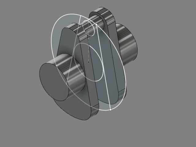

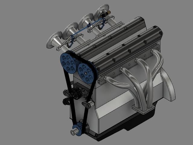

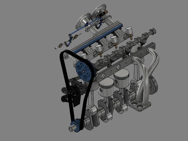

                        That's Fusion360, but Alibre that Jason used and any other 3D program is very similar.
                        You're trying to force the complex restrictions, that fudge a 3D object onto a flat piece of paper, onto a system that simply doesn't need them. Look at how complicated your description of how to do that is compared to mine.
                        Turbocad's workplanes, scales and viewports confused the hell out of me so I didn't get very far with it. I've never used coordinates for anything I've done in Fusion. This
                        is based entirely around this simple crank web and a known spacing of the bores:
                        with all the components designed in place and can be switched on and off, or animated as needed
                        I wish Fusion had a follower joint so the entire valvetrain could be animated properly. It took about a week of evenings in front of the telly, and there is no way I could do it as 2D. It does need a couple of modifications to actually produce it. Nor do I see much need for traditional flat drawings to make most of it when the models are available in any orientation or dimensions you need.
