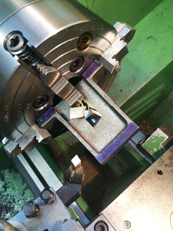

      #169633
        Hold in 4-jaw , with spigot facing outwards and get it running as true as possible, use packing behind the flange to keep it at right angles to lathe axis. Remove packing and true up & face the spigot, you really only need the larger spigot dia so the small bit could be sawn off.
        While still in the 4-jaw face the flange to leave the boss that goes into the cylinder, use the cylinder to gauge the size as you get close . Also drill and ream right through 3/16". This will keep the 1" dia and 3/16" hole concentric and at right angles to the top face of the cylinder.
        Now hold the part by the spigot your Bison 3-jaw should be good enoght for this and face the gland boss so it is 7/16" from the machined flange face, counterbore 5/16" a drill will do for this. While held this way turn the top of the flange until it is cleaned up, leave the raised area around the gland boss as cast.
        Finally hold it the other way around and turn off the chuck spigot and face the 1" dia, not critical if its a bit less than the 1/16" long
        Finally mill the 4 edges square measuring off the 1" dia, then set the part true under the mill spindle and use co-ordinates to drill the 10 holes (zeuz tables will give you the calculation for the 6 holes)

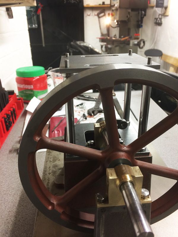

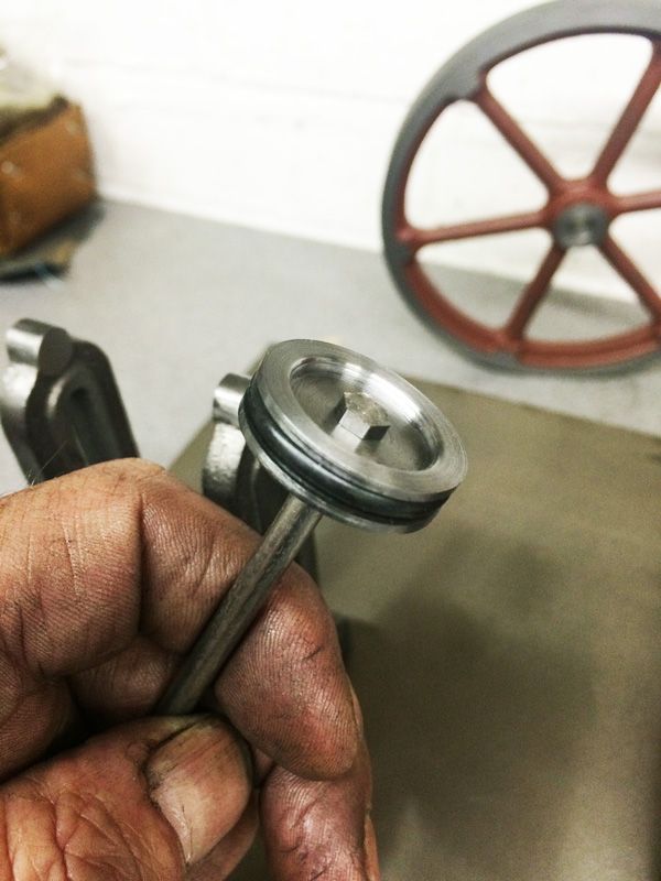

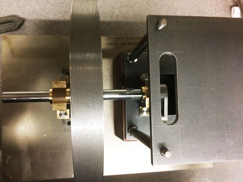

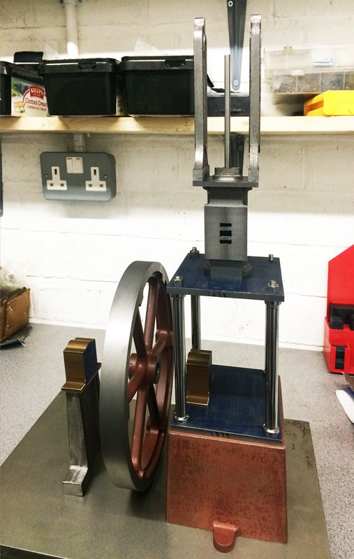

                  Some more progress made today. Although I did forget to photograph the cylinder end machining as described by Jason.
                  The piston was made.
                  And I could not resist stacking bits together to see how she was starting to look. (think I may need to 'fettle' the ports on the cylinder)
                  Nick smileywink

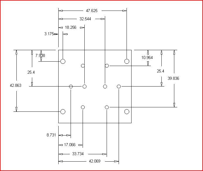

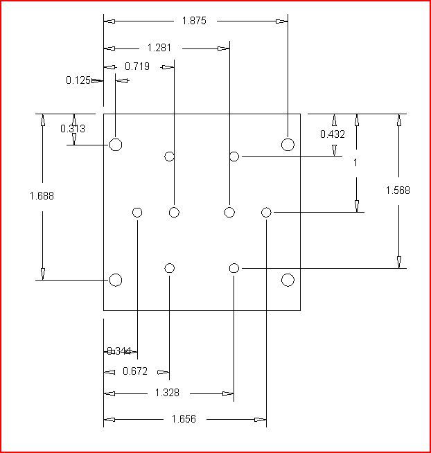

                    Are there any 'tricks', tips and general advice for drilling the PCD of holes.?
                    I know it's simple with a DRO fitted. But I have not.! sad
                    Cheers, Nick
                    #169861
                      As I said in my instructions the formulas for various PCD numbers are in the Zeuz book so you just multiply your 1 5/16" by these to get the x & y co-ordinates. Or is you have a CAD package that will do it for you.
                      To eliminate any backlash you may have it is worth then calculating these from one corner of the part rather than the centre point of the pcd, that way your handwheels will only be turning in one direction so you don't have to worry so much about backlash.
                      If you are going to spot through the covers to get the hole locations in the cylinder then a few thou error due to backlash is nor an issue
                      J

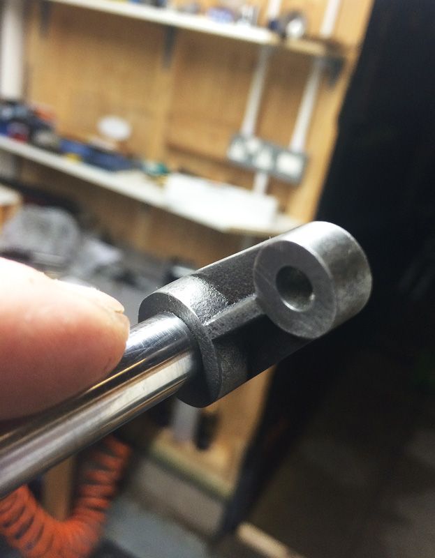

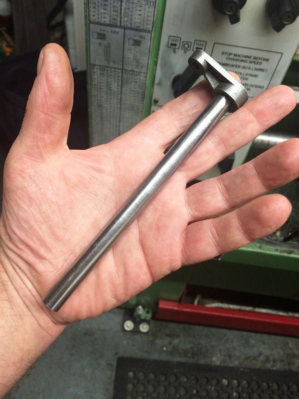

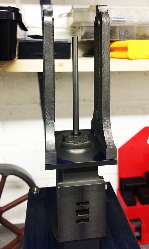

                        Today I made the crankshaft and it's associated casting. Fixing them together with locktight and a 3/32 silver steel pin pressed in through the side.
                        Then it seemed a good time to machine the bearings.
                        Have a good weekend everyone, Nick

                          Posted by JasonB on 17/11/2014 16:43:39:
                          I have been thinking about the backlash and the fact that my machines are graduated in metric. To someone of my limited experience it's a recipe for disaster.! blush
                          The options I have are thus. (without taking the parts to my pro engineer friends workshop and using his DRO machines.)
                          1) Buy a DRO setup myself. – Nice, but I really have other calls on my money ATM so that is probably for the future.
                          2) I have a 2" travel dial guage. – Buy a second one (20 odd quidish) and configure them to record the X & Y thus eliminating any backlash and my feeble brain issues.
                          Nick
                          #170441
                            3. use a claculator to convert to metric
                            4. Use your height guage to mark it out carefully, punch and drill. Use that part to spot positions onto teh second.
                            5. click a tab on the CAD to change dimensions to metricsmile p
                            Edited By JasonB on 23/11/2014 12:54:39

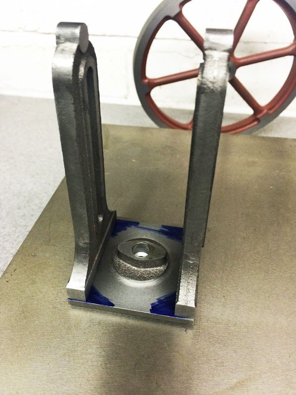

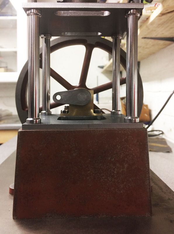

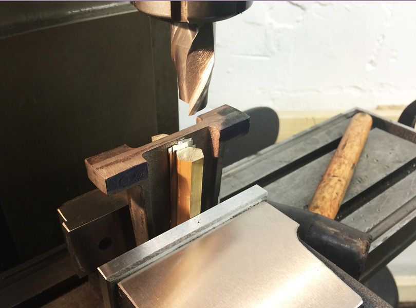

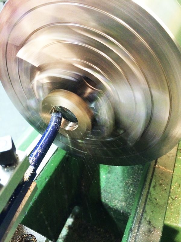

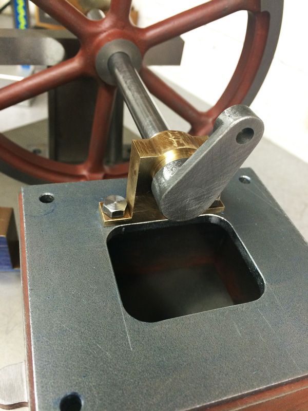

                                    This evening I decided to machine the pedistal that supports the outer bearing.
                                    Not the strongest of set ups so I took slow and light cuts.
                                    It seemed to work out OK (except for the auto focus from the iphone wink)
                                    Over to the mill to do the base side. Again not a major sturdy set up so I again went slow and light.
                                    I gave quite a but of consideration to the mounting as I did not want to introduce even a small twist in the casting that would spring back once I took it out of the vice and leave me saying very rude words.! angry
                                    It went thankfully OK – I deviated from the plan slightly by putting a recess into the center section of the casting.
                                    Nick

                                      To drill holes on a pcd, for example 6 or 8 holes in a cylinder cover,aquire a vertical indexing chuck with 24 positions, which provides most of the useful pitches ,and use it mounted on the vertical mill table.Its accurate and there is no backlash error or indexing of the mill table.
                                      #170485
                                      Nick_G
                                        @nick_g
                                        Posted by Nigel McBurney 1 on 23/11/2014 22:44:47:
                                        Thanks for that. smiley
                                        I did consider this option. But a 1/2 decent one would cost as much as a DRO setup. And a 'decent' one many times more.!
                                        Cheers, Nick

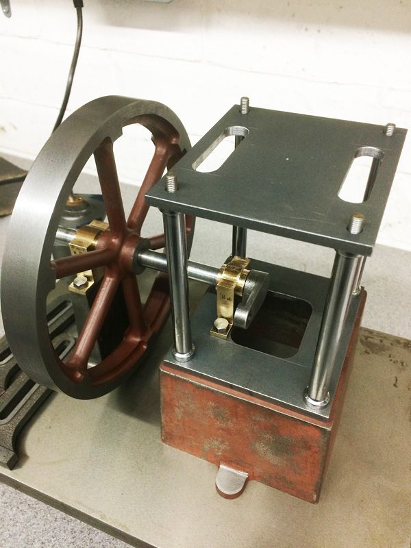

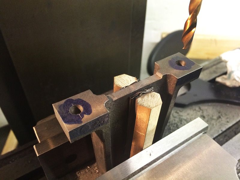

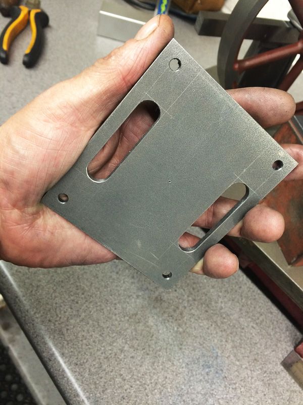

                                          I am now 4 weeks into this my first build. – But sorry Jason still no PCD holes yet.! wink
                                          Carved out the holes in the plates. Diverted from the drawing slightly as I want to give the engine a 'personal touch' with more rounded corners. (I will use that excuse later when I make a cock-up cheeky)
                                          The hole is larger on the bottom plate than the drawing says due to me having an a-la Baldrick " cunning plan"
                                          The bearings are drilled, tapped and fitted. Although they do need dressing. Nice snug fit but rotate nice and free with a dab of lubrication on the crankshaft.
                                          While on that subject what is a good oil for running in.? (when the time comes)
                                          I wonder the stage I will be at in another 4 weeks.? – Maybe even some PCD holes eh Jason.! laughsurprisecheeky

                                                Nick looking at your marking out you could just mark, punch and drill the holes as you seem quite capable of accurate marking out. Any light oil will do but not steam oil.
                                                J

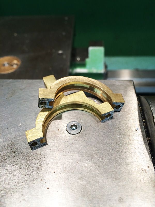

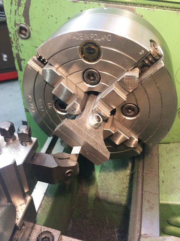

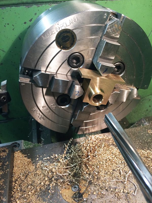

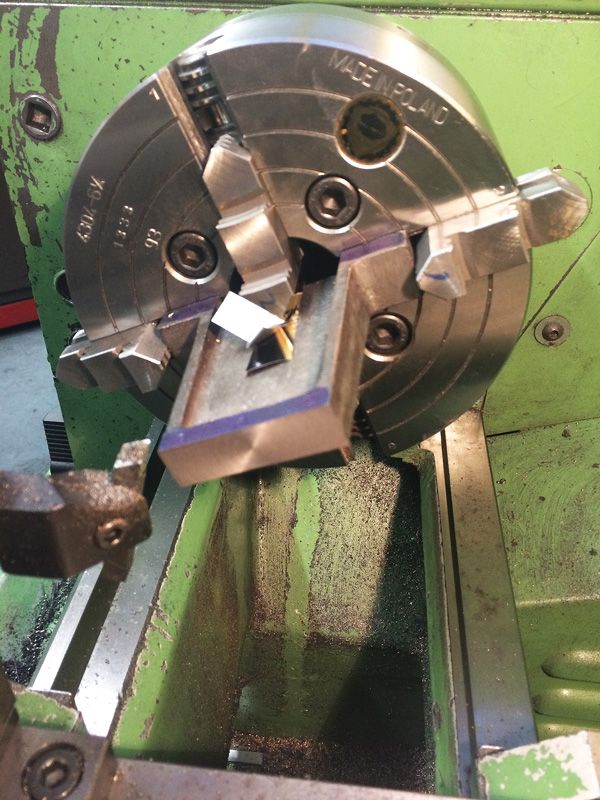

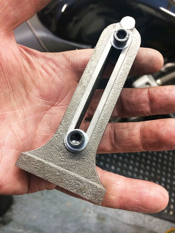

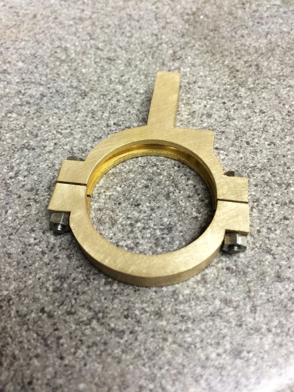

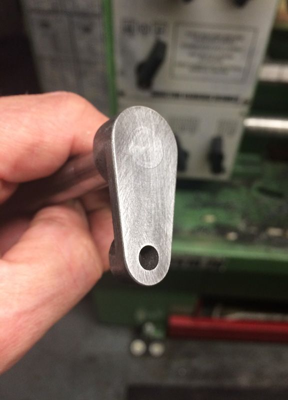

                                                    OK-ish I think. Not done so much this week but I have made the eccentric strap.
                                                    I first sliced the casting and soldered it back together before placing it in the 4 jaw. I 'tinned' the 2 halves and used spring bulldog clips to hold it together in alignment. This snapped the parts together nicely when the solder remelted.
                                                    They came apart easily after the machining was done with little heat.
                                                    The remaining solder cleaned off.

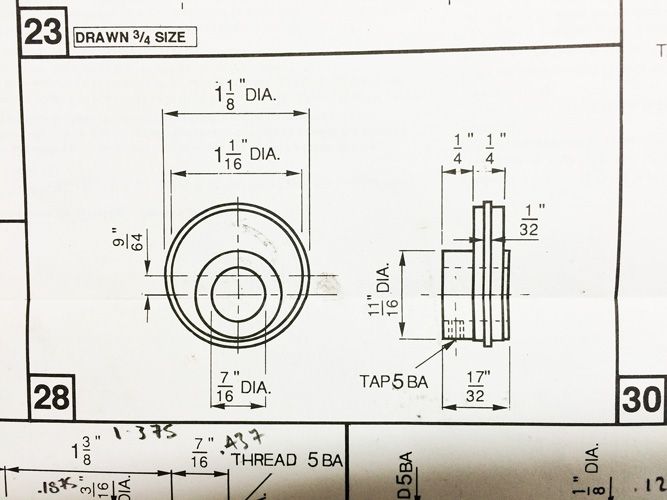

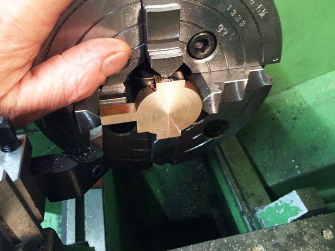

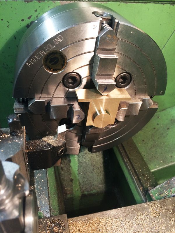

                                                    The next thing I intend to make is the crankshaft eccentric and would like a little bit of advice please on the best way to go about it. The supplied stock is quite short in length but I do have a longer length already if it would make things simpler.
                                                    So guy's what is the best machining order to produce the eccentric part below :-
                                                    Many thanks, Nick
