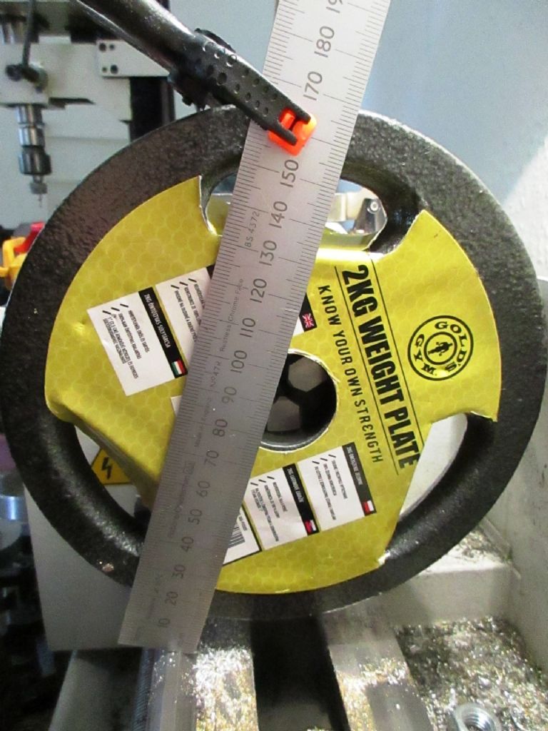

                                      Hi Alec, I don't know what you mean about a nasty lathe, I on the other hand think it would be a worn out very inaccurate one that you would have keep checking the size you are trying to achieve every step of the way. While a Zyto may or may not be a cut above the rest, it is still pretty much on the same band wagon of hobby lathes of its time. I don't know the weight of a Zyto, but probably close to 30 Kg, but like most of the lathes of this period, they didn't have the motor and drive train integral with the lathe, so you have to consider the weight of that as well, unless you like stripping things down into units every time you wish to move it. You must remember that all these old hobby lathes of their time were made to an affordable price for the average modeler and wouldn't stand up to industrial use. I've had a Chester mini lathe for six and a half years, which has plastic gears and I've not had any of them stripping teeth, but as JasonB has said, they are no more made for industrial type of use than most of the vintage hobby lathes. You say accuracy tends not to be an issue, yet you are bothered about the Drummond round bed one not being able to take up wear in the bed, but the Drummonds were very well made but are heavy with the round bed one at around 47.6 Kg just for the lathe and you would have to add the weight of any drive train to that and the M type is about 63 Kg for just the lathe. I have a round bed Drummond and it doesn't have any wear in the bed to be of any concern but of course it doesn't mean they are all like that. The Hobbymat is in order of 45 Kg but one disadvantage is the saddle is it contact with the leadscrew at all times, so can only be moved forwards or backwards by turning the leadscrew. Even the little baby lathes that were once available were in the 20 to 25 Kg range.
                                      Regards Nick.
