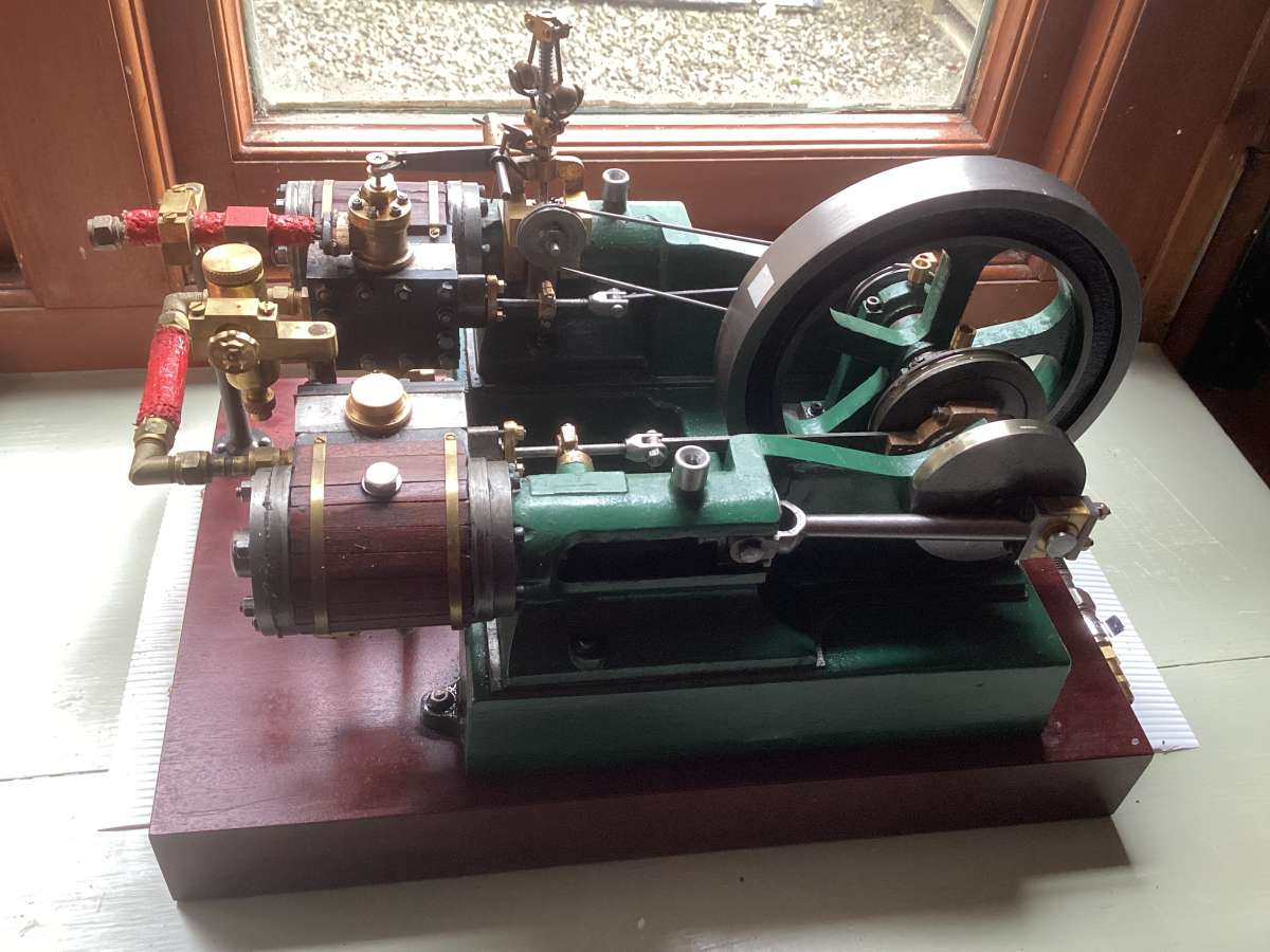

      The double Tangye
      In my life I’ve completed several ‘big’ model projects including the Mastiff, the Reeves triple expansion engine, a 3.5” William locomotive, a Beam engine and finally the Reeves Double Tangye engine. All but the Tangye have been given away. I found the machining of that double Mill engine the most challenging of all my projects. It was obviously a company that liked big complicated castings!
      Added to the expected difficulties was the fact that the thin end parts of the two trunk standard castings were chilled and required localised grinding with a Drexel set up on the tool post.
      The 7 equally spaced cylinder and head bolts are an interesting exercise when complete interchangeable is desired and machining the connecting rods out of rectangular bar is quite challenging.
      When I was an apprentice one of our tests was to machine, then hand scrape the white metal bearings of an in-line shaft with three bearings; this engine has four bearings in line the outer two being in housings set at an angle to the horizontal.
      I’ve ran it once on steam, but to avoid corrosion it now occasionally runs only on compressed air, the speed governor has too much stiction to operate subtly but it’s smooth and powerful. It sits on my bedroom window ledge and is a source o, until now, private pride because it was the most difficult of all to get absolutely right.

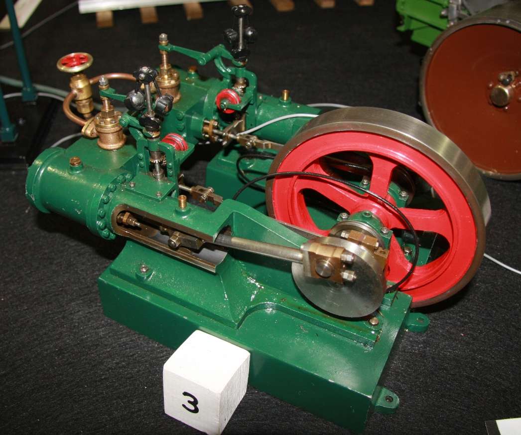

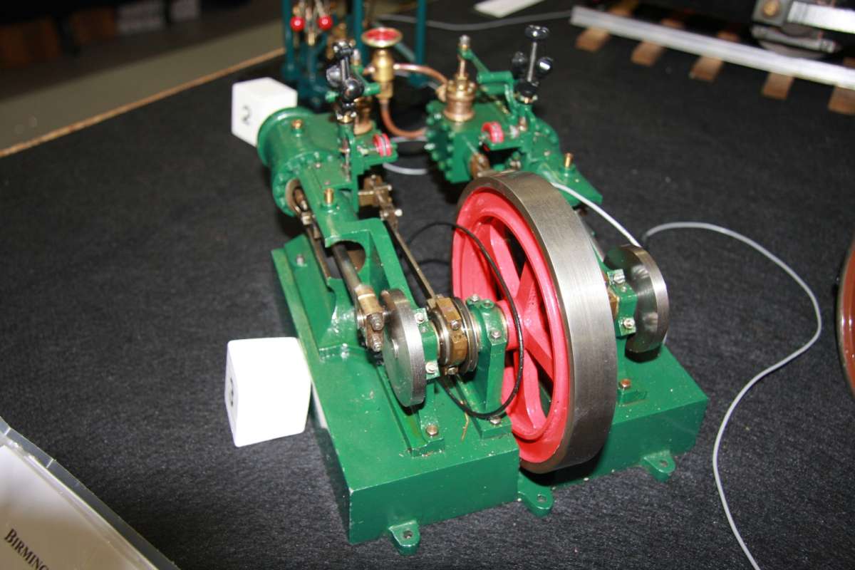

                          Hi, I saw this one at the Midlands ME in 2016.
                          Double Tangye#!
                          Double Tangye#2
                          Regards Nick

                            I really don’t see the purpose of two governors when the cylinders are coupled on the same shaft
                            #781941
                            Tony Martyr
                              @tonymartyr14488
                              Looking at Nick’s photos I think the straight shank connecting rods are of composite construction, which is a hell of lot easier job than turning the tapered rods out of one piece of rectangular bar!

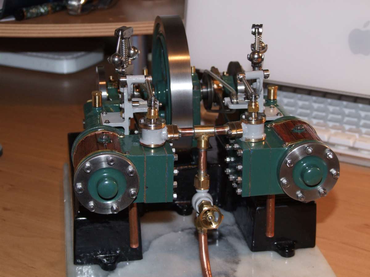

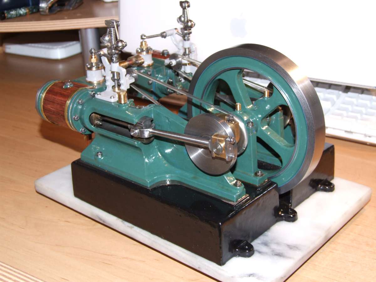

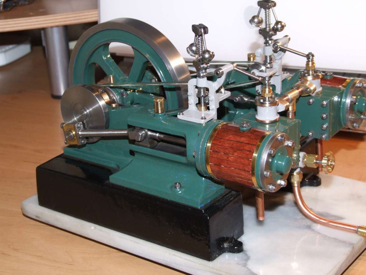

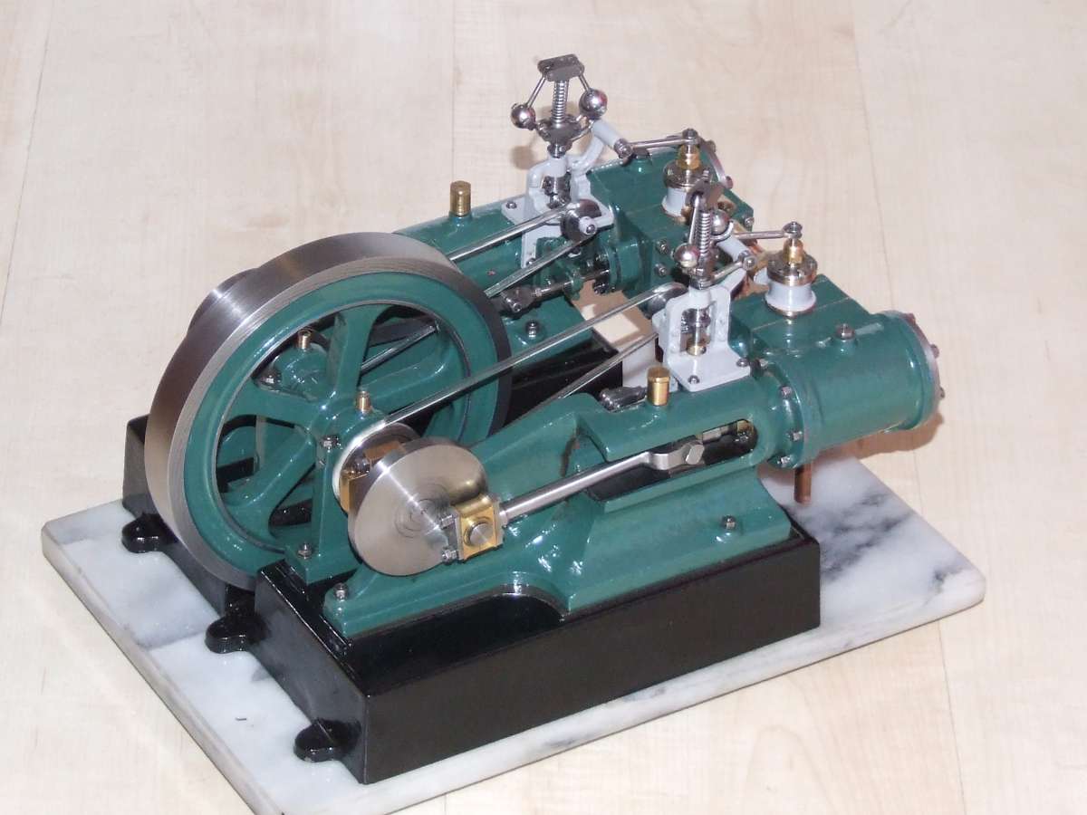

                                Here’s a few pics of mine built 15 year’s ago.
                                Ian
                                DSCF0737DSCF0745DSCF0746DSCF0749
