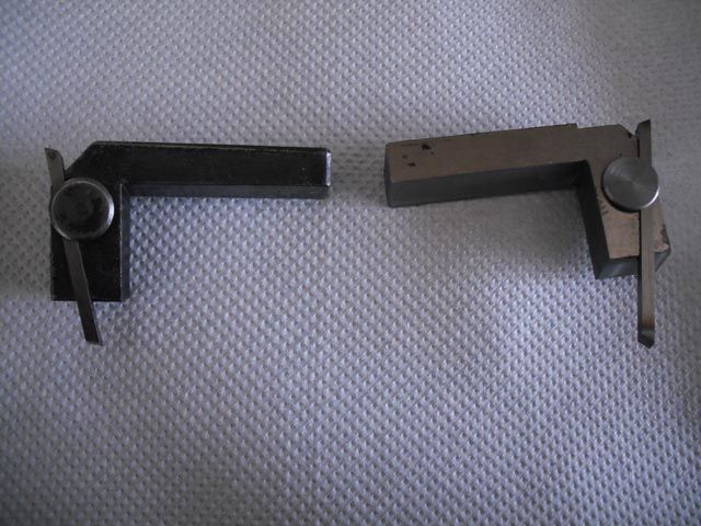

                  #392197
                  Anthony Knights
                    @anthonyknights16741
                    I made both left and right handed tools from the article in MEW. The same info is on "mikesworkshop" site.

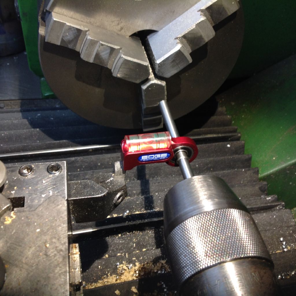

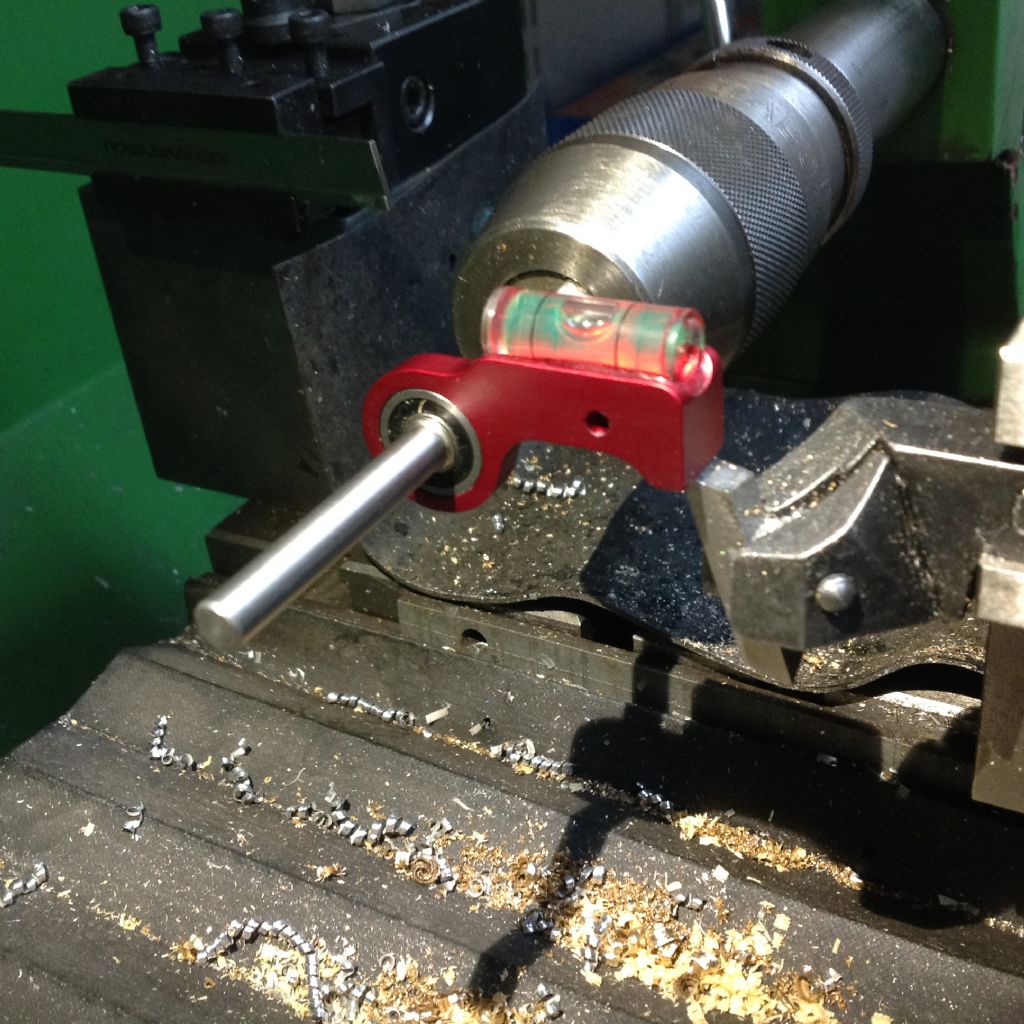

                                  #392349
                                  OuBallie
                                    @ouballie
                                    Can attest to what John said about tool being pushed downwards on a heavy cut, but in my caseI hadn't tightened the holder enough.
                                    That moving down, however, saved my bacon when I had a dig-in, due to not paying attention, the toolbit being pushed clear of work.
                                    Here's my Edge gizmo for setting the toolbit heights, and what a pleasure using it:
                                    Tangential Tool Holder
                                    Upside down tools a little tricky to set in my rear QC though, but I can put up with that.
