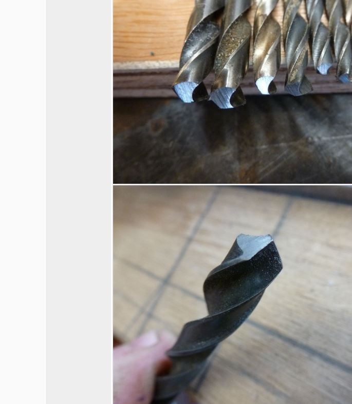

            is it just my eyes or do the sharpened drills have rather long central chisel edges?
            #600200
            Richard Kent 1
              @richardkent1
              JasonB – Thanks for the info.
              Some clever comments here today – Not your eyes- it's photographic distortion – 2D representation of a 3D object.
              The bits were ground according to the instructions.
              They drill and work perfectly fine.
              Just like new drill bits.
              P.S just double checked them by eye against the photos and it is indeed photographic distortion.
              The best way to evidence this is for someone else to grind some bits on their Picador jig and compare the results.
              Or perhaps send me a drill bit and I will sharpen it and send it back to you for testing?

                Posted by Richard Kent 1 on 01/06/2022 13:29:44:
                Edited By Richard Kent 1 on 01/06/2022 13:46:07
                There's a few comparative photos in this thread, the first post of which has a link to a different thread again.
                https://www.model-engineer.co.uk/forums/postings.asp?th=139828
                Bill
