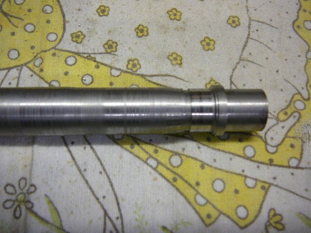

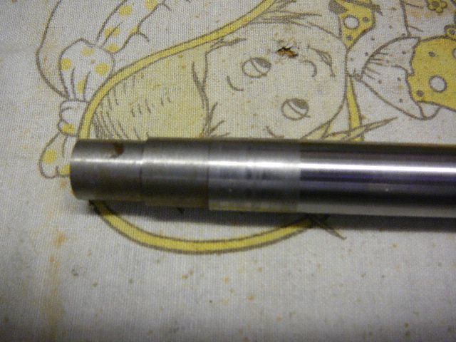

          Here is a picture of the results of another quick trial. The first 1/2", from the right, was run at 40 thou doc, 2 thou/rev, 1200rpm and no coolant. The remainder up to the first step is identical, except for coolant. The last step, on the left, was 20 thou doc, with coolant, the other parameters the same.
          Silver Steel Banding
          The finish with no coolant is torn under the magnifying glass, the other finishes are not torn, but there is a definite and regular difference in the finish, which shows up as the banding. Surface roughness measurements, from the right, are 3.15µm, 1.80µm and 2.16µm respectively. Certainly on the results from this quick test I'd use coolant on silver steel. All very confusing.
          I guess the next thing to try is a different bar, from a different supplier.

          #91594
          MICHAEL WILLIAMS
            @michaelwilliams41215
            Hi ,
            Are ridges separate circular hoops or one multi turn screw thread ???
            #91625
            Anonymous
              Posted by MICHAEL WILLIAMS on 26/05/2012 14:24:53:
              Good question; and the answer is……neither. Close examination with a magnifying glass shows that the banding is in fact a multi-start thread. I counted eight starts. That implies that the phenomenon that is causing the banding is to some extent regular in time, and at a rate about eight times the spindle speed. Whether it is actually locked to the spindle speed is another matter.
              I did another couple of tests. One at 1700rpm with coolant; the banding is still there. It's difficult to tell if it is at a different spacing. I also tried a test at 1200rpm, with coolant, on a different bar, albeit from the same source. This also exhibited some banding, but much less obvious. You have to get the light on it at the correct angle to see the banding.
              On the next test I'll dig out a piece of genuine Peter Stubs silver steel and try that.
              Regards,
              Andrew

                Eight starts? Probably a resonance or slight misalignment in the auto-feed setup.

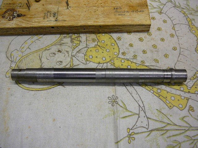

                              Sorted! Thanks one and all for the suggestions; they helped me clarify my thoughts and identify the problem. A special mention for Nigel, who, in essence, identified the actual issue.
                              A quick look at a number of previous turning exercises showed a very slight banding on stainless steel, but on nothing else as far as I could see. This tells us the problem is not specifically related to silver steel, but may be related to tougher materials, and hence higher cutting forces. My lathe is a Harrison M300, on the makers stand, and solidly bolted to a concrete floor. It is three phase and runs from a true three phase supply. The chuck is a Burnerd high speed collet chuck. Thus I discounted vibration from the machine itself, or the main motor. I calculated a few frequencies for spindle speed and the rough frequency of the banding, but no obvious resonances sprang to mind. I didn't do the calculations for the drive train, as the fine feeds are driven by a separate drive shaft rather than the leadscrew.
                              Now what I didn't tell you is that the cross slide is a fairly easy fit, and one of the bolts that holds the top slide down is a bit iffy. enlightened Yes, I know it's obvious in retrospect but us country boys are a bit slow on t'uptake.
                              The task this morning was to make and fit two new T-bolts for the top slide, like this:
                              T_Nuts
                              As an aside I discovered that the cross slide tapered gib has a special brass insert and grub screw pressing on it from the side of the cross slide, as well as the normal adjustment screws each end. I never knew that! It's not mentiond in the manual either, although it is shown in the exploded parts drawing.
                              With everything cleaned, adjusted and re-assembled I tried another couple of tests on the original silver steel bar. Both tests were done at 1200rpm, 0.2mm radius insert, depth of cut 20 thou, and feedrate 2 thou/rev, one test with coolant, one without. In both cases the swarf came off as a long open spiral. Both surfaces look pretty uniform under the magnifying glass, with just a hint of tearing in places, although the finish doesn't feel rough. Surface roughness measurements (Ra, µm) are:
                              With coolant: 2.15 1.72 2.10 Average=1.99
                              Without coolant: 1.40 1.55 1.40 Average=1.45
                              So in this case without coolant seems better, which is what I would have originally expected.
                              As is so often the case the solution to what seems to be a mysterious effect is actually very simple, in this case operator stupidity. sad I should have fixed the iffy bolt issue long ago.

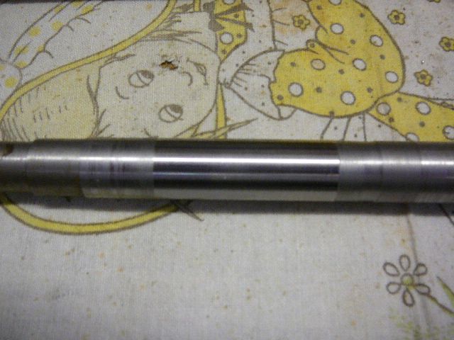

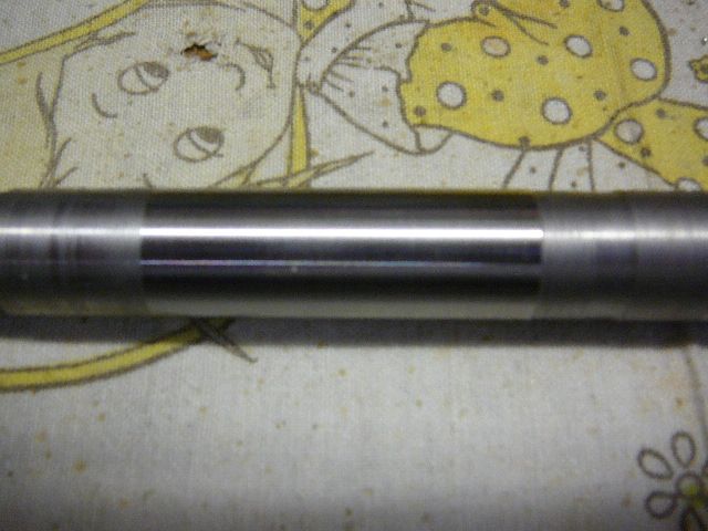

                                  Firsly, apologies to Andrew for hijacking this thread but I thought this was the best place for this rather than start another!
                                  Pictures below are on a piece of unknown BMS (originally 35mm embarrassed&nbsp
                                  Only 2 feeds used, 2 thou and 10 thou, depths 1/2 thou and 5 thou, speeds 600rpm and 1800 rpm, all mixed and matched but with a smear of neat cutting fluid applied first..
                                  My deductions are that I'm more confused now than before!
                                  Undoubtably rigidity has a lot to do with it as the inserts just scraped on the surface making a right mess, speed, depth, feed, nothing made any difference.
                                  But chipbreaker form did!
                                  The middle section was using a high positive rake insert, 1/2 thou depth at 600 rpm. My diamond toolholder turned the 'ring' at the righthand side end (finish is better than it looks in the picture) but high rake on a less rigid machine seems to be the answer for me at least as far as surface finish is concerned.
                                  (I also now have a decent collection of about 15 different types of 0.4mm CCMT inserts)
                                  Paul

                                      Paul: Feel free to add to the thread at any time. The finish on the central part looks very good. Can you expand on the high positive rake insert; manufacturer, bought from where?

                                          Andrew, The inserts that gave the best finish at low depths of cut were Korloy inserts from Cutwel. Basically I ordered one of just about all of them to try. I found that the PVD coated inserts worked much better than the CVD coated ones and the best of the lot were CCGT-AK inserts in grade PC230 (which don't seem to be listed in their new catalogue, only in DCGT style).
                                          The AK chipbreaker seems to be identical to the high rake aluminium style inserts but work better on steel.
                                          Paul
