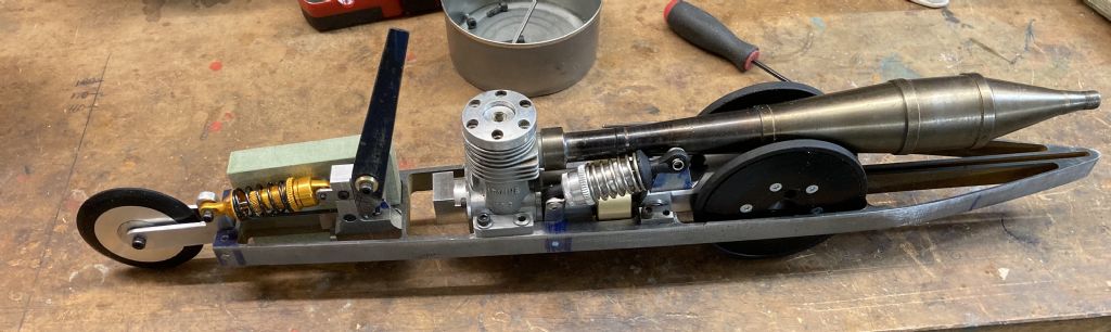

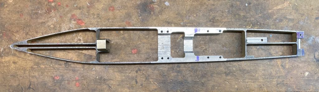

      A while ago I asked if someone could recommend a water jet cutting company who would cut a couple of chassis’s.
      I got them cut and have started building a 2.5cc class car, two pictures to show progress.
      Chassis
      The chassis is cut from 12mm mild steel plate .
      Car
      Here is the car so far more work yet to do, the engine needs the needle valve assembly making a support for the tuned pipe which was machined from the the solid and has a wall thickness of 0.3mm and a fuel tank there is just a wooden block at the moment.
      When it gets warmer I will make the fibreglass top and bottom.

          Forgive my ignorance, is this some form of remote control car drag racing? Or top speed for a standard size engine or something?
          #522383
          Old School
            @oldschool
            It’s a tether car it runs in a circle tethered by a steel cable on a purpose built track. No radio control it’s all about speed, timed over a flying 500 metres distance. I expect it to run in excess of 150mph.

                  You would not believe the stretch on the tether when they get up to speed. Lovely work Old School. Love the Ohlins copy front shock.

                      Looks good Oliver yes but what have you made those rear wheels from?

                              Ramon the wheels are aluminium but anodised black it was the fashion a few years ago they came out of my box of spare parts.

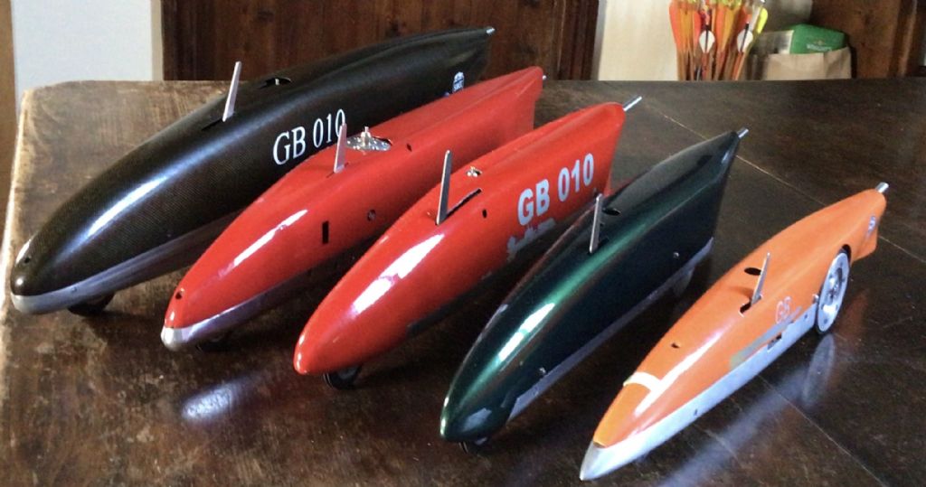

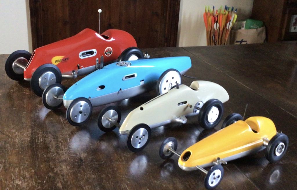

                              Old School
                                @oldschool
                                These are my modern tether cars some built by me and others bought and sorted out to perform. They range in engine sizes from 1.5cc orange car to 10cc the black one. All hold British records except the orange one.
                                Last year was the first year I have not raced for a long time, but we ran cars at Buckminster.
                                These are some of my old timer cars all built by me engine sizes 2.5cc to 10cc. These sort of car were raced in this country between the 1950s to the end of 1960s when the last track closed in this country.
                                Tether car racing continued in Europe both east and west, Russia the USA Australia and New Zealand.

                                DrDave
                                  @drdave
                                  Posted by Old School on 25/01/2021 10:44:39:
                                  Hi Old School. Is the arm that pokes out the top a fuel cutoff? I have never seen tether cars “live”, only on YouTube, but they are most impressive.
                                  I used to fly control line speed. I keep getting the draw to go around in circles again, but I have managed to beat it off so far!

                                      Yes they are the shut off, the rules require the engine to be shut down by 8 laps after the timed run so at best you have about 10 seconds to do it.

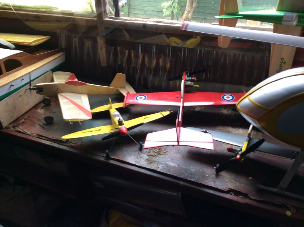

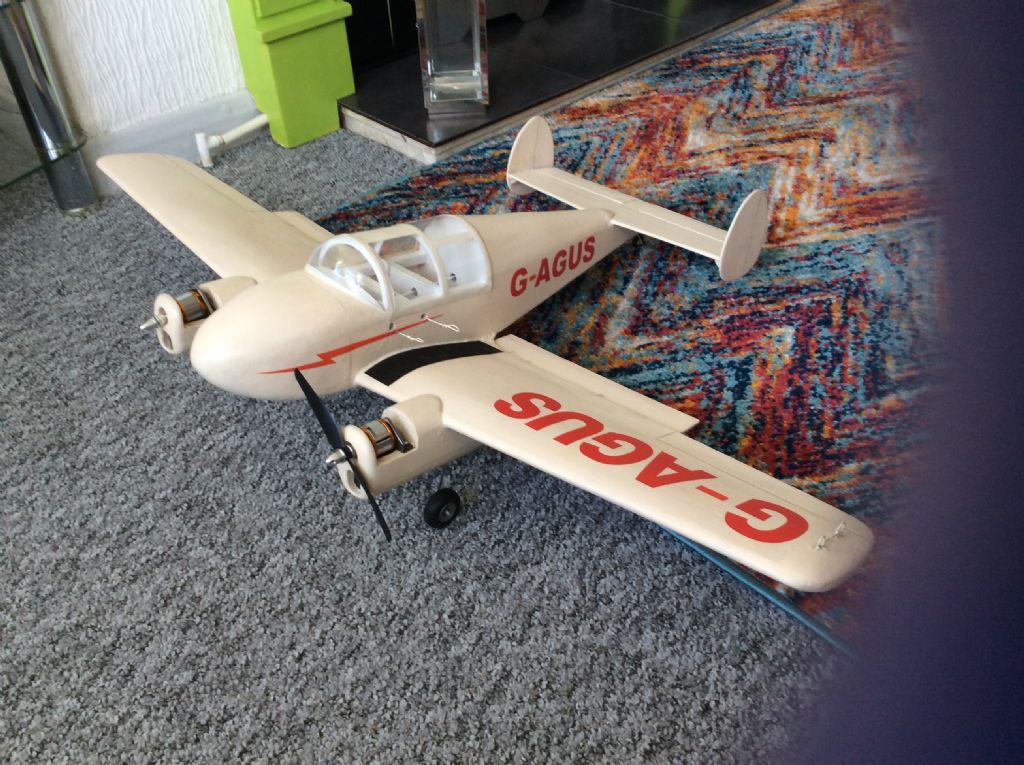

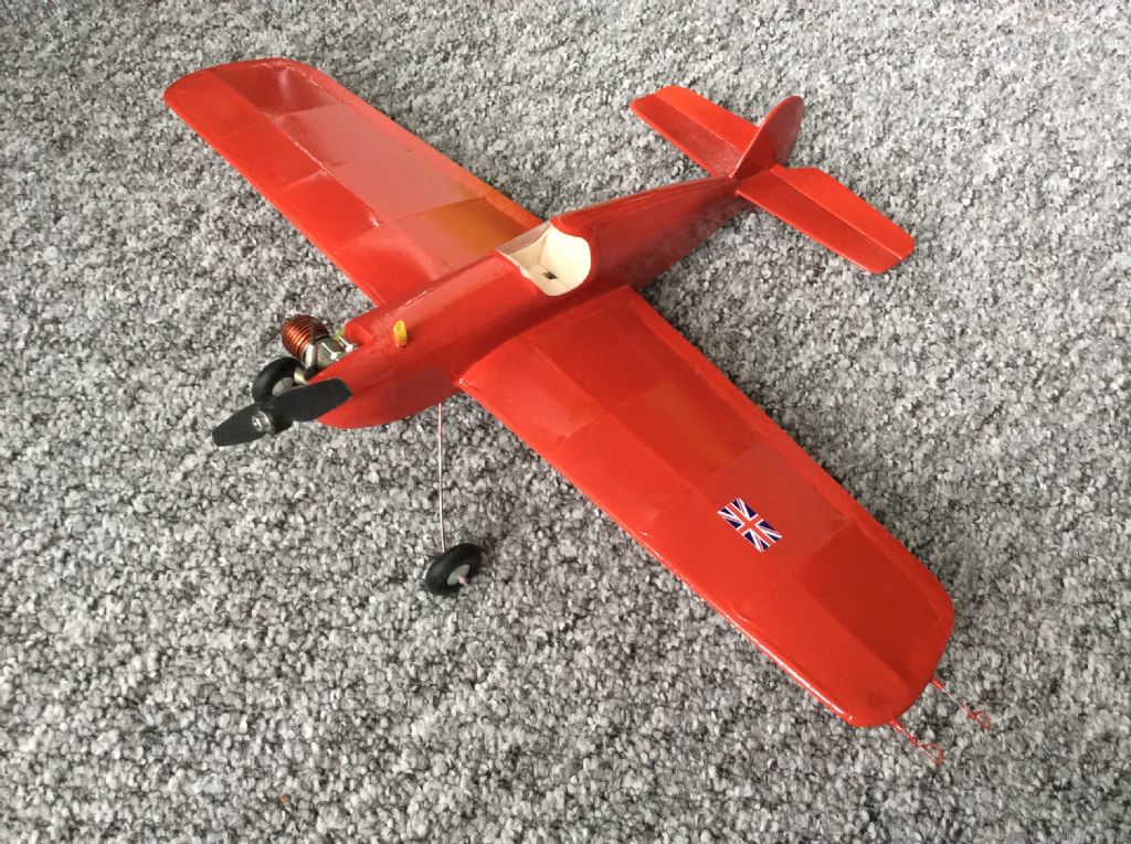

                                          A couple of photos for Tug ,my miles Gemini.C/L
                                          Miles Gemini (oz2985)
                                          by FH Buckland
                                          from Model Aircraft
                                          October 1955
                                          36in span

                                                  Thanks for doing that Tony, that does look very nice indeed. Are those brushless motors?
                                                  There are two smaller models I never built but always had a liking for – one was an ME109 for an Elfin 1.5 and featured in my first Aeromodeller (August '58) and the other for some reason was the Lockheed Sirius Floatplane in the APS plans handbook. Have no idea why but they always did appeal.
                                                  Thinking that I would be unlikely to ever be interested again I sold all my flyable models on about three years or so ago. Two of them have come back thanks to an act of incredible generosity but I have been unable to fly them yet which has been disappointing. Also a good friend passed away and I have inherited several of his models including a very nicely made Veron Sea Fury with a Comp Special in and a Veron Spitfire with an AM 25. Again not been able to fly those either.
                                                  Sorry for going OT Oliver – perhaps we should start a new thread – 'General Aeromodelling Discussion' to go with the aircraft onewink Any takers?
