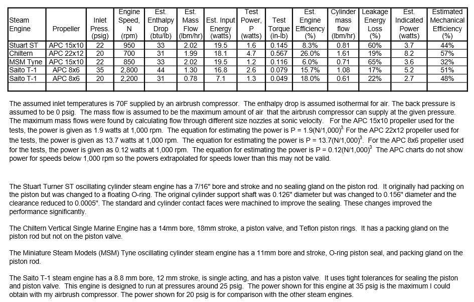

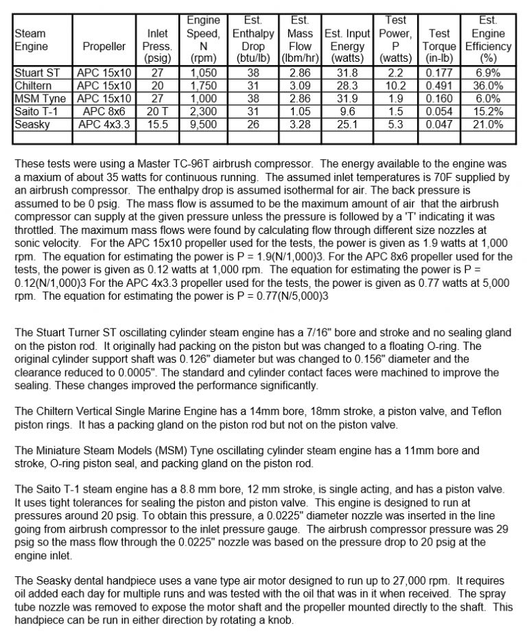

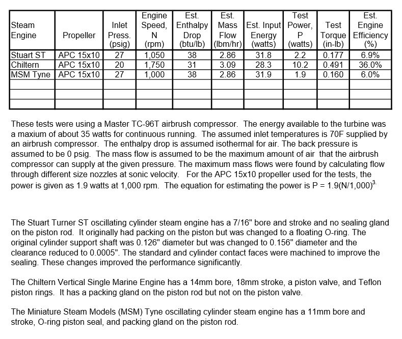

      The following chart shows the performance of the turbine, steam engine, and boiler described in the last post. Both Turbine 2 and the Saito T-1 engine are affected by the way I tested them with propellers. The propellers blew cold air over the outside of them preventing the turbine housing and steam engine cylinder from getting very hot. The large mass of the turbine housing made it even worse by taking a relatively large amount of the available energy to change it’s temperature. The steam turbines have an additional disadvantage. In addition to the energy lost by condensation of the steam, the moisture in the steam reduces the efficiency by a factor of approximately 1.3 times the percent of moisture. Turbine 2 should have the unnecessary material removed from it’s housing and be insulated. The Saito T-1 engine has a relatively small cylinder wall thickness which reduces the mass needed to be heated to a minimum. It also has a very small heat transfer area to the standard, so the heat conducted to the standard and base is minimal. Also the thin Saito T-1 cylinder reduces the heat transfer area to the air so the radiant and convective heat losses are minimized. The video showing the Saito T-1 engine propelling a boat I mentioned in the last post can be seen at this Saito T-1 Video Link.
      Steam Tests

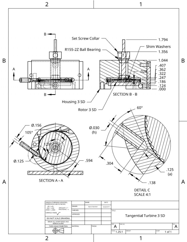

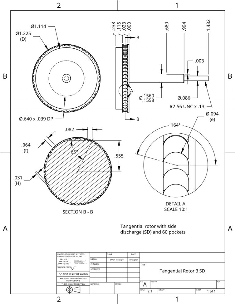

            The following drawing shows the dimensions of the nozzle and rotor in turbine 3 to change to side discharge (SD). This drawing also shows the position of the parts that gave the best performance. The position of the new nozzle was the result of trying to add other nozzles that failed by the drill drifting or breaking. This was about the only space left. Ideally the nozzle would be placed at the top of the turbine so that condensed steam would not collect around the nozzle. The next post will show the changes of the rotor to make it side discharge.
            Tangential Turbine 3 SD RA
            #504306
            Turbine Guy
              @turbineguy
              The following drawing shows the Turbine 3 rotor modified to side discharge (SD) by removing one row of pockets.
              Tangential Rotor 3 SD

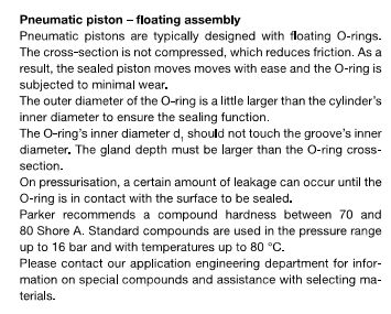

                    Our hardware shop says they can get two kinds of O-ring: Nitrile eg N70 which are recommended for temperatures up to 90 degrees C, and red Vitron up to 200C. I assume I would need the Vitron type.

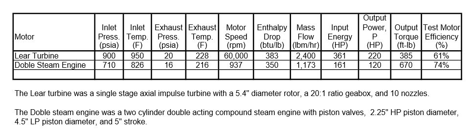

                      I was interested in your mention of Doble: "I thought I would compare this turbines performance with that of one of Abner Doble’s steam engines that was probably one of the best ever put in a car. ". The engineering Co A&G Price Foundry I was talking about had a license to male Doble steam buses for Auckland City. Would they have been turbines?
                      Evan

                        Evan , I think the o rings you are looking for are made from Viton. Just a word of warning, back in the day while still working we received a memo about not touching viton rings that had reached a high enough temp to have changed colour as they were thought to have carsonegenic properties. Not saying don’t use them just be careful.

                          For simplicity I am thinking of using O-rings for piston seals. To keep friction down I understand they would be fitted loosely. I imaging they should only just touch the cylinder walls with no perceptible compression. Is that right? I tried both floating and light compression of the O-rings. The floating type as described in the follwoing link worked best. Floating O-ring
                          I am using pistons as valves instead of the usual flat plate so that I can do it easily on the lathe. Can I use rings on these valve pistons too or will they get torn up by the ports? Both of my steam engines that use piston valves rely on a close fit and have very low leakage. Whatever gain you get with seals will probably be offset by the extra friction.
                          Our hardware shop says they can get two kinds of O-ring: Nitrile eg N70 which are recommended for temperatures up to 90 degrees C, and red Vitron up to 200C. I assume I would need the Vitron type. I used the Viton.
                          My radiator man found that it had 5 O-rings from China that had gone soft and gummy, completely flattened. But why did it pass pressure tests? If the pressure is enough to move the O-ring, it will press against the sealing surfaces and stop the leakage.
                          The engineering Co A&G Price Foundry I was talking about had a license to male Doble steam buses for Auckland City. Would they have been turbines? I think the only steam buses tried in California were the Lear turbine. There were other competitors and might have been tried.

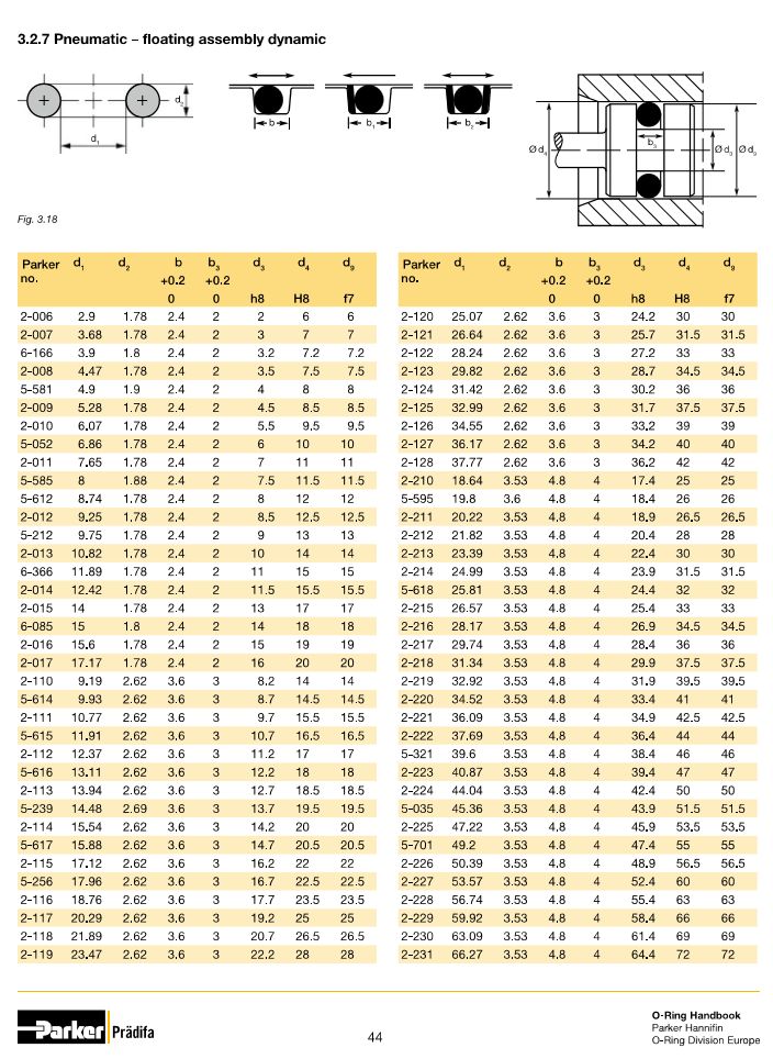

                            The following was copied from the Parker Metric O-ring catalog. It explains the concept of the floating O-ring. In the next post I will show a copy of the table that gives the groove dimensions for the metric floating O-rings.
                            Metric Floating O-ring 1
                            #508282
                            Turbine Guy
                              @turbineguy
                              Hi Evan,
                              The following table shows the groove dimensions for the 2-115 size O-ring you will need for your 22mm bore. The amount of leakage with the floating O-ring is more than offset with the reduction in friction. You can also use packing in the groove if you want to try that. The pest performing packing I have tried was suggested by Thor. I spun Teflon tape into a thread and wound it into the O-ring groove as tight as I could. When you add oil the small spaces in the packing absorbs some of the oil and it wicks out while running. The wicking of the oil and the lubricity of Teflon reduces the friction considerably.
                              Metric Floating O-ring 2

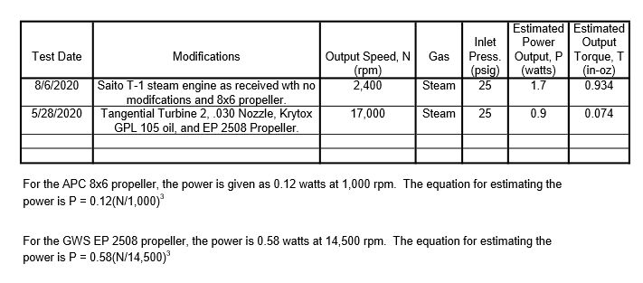

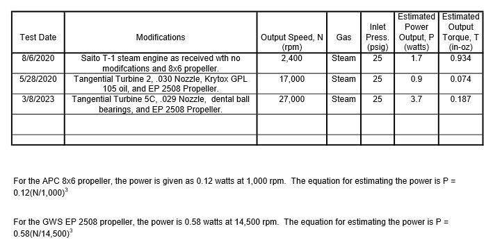

                                I updated the table shown in the post of 12/07/2020 to include the tests of the Saito T-1 steam engine. I added a disclaimer to the notes included with the chart that the test power shown for speeds below 1,000 rpm may not be valid. The performance given by APC for their propellers is not shown for speeds below 1,000 rpm but since the power coefficient increases at lower speeds due to the Reynolds number effects, the test power shown should be conservative for the lower speeds.
                                My Steam Engines 3

                                  It has been a while since I updated this thread. I made a new type of turbine called a Drag Turbine that is explained in the Model Turbines thread starting with the 09/12/2020 Post. If you start with this link and read the Model Turbines thread to the last post, it will bring you up to date on all the changes and testing I have done since I last updated this thread. The following is the table I showed in the last post in the Model Turbines thread that is an update to the table shown in the 12/10/2020 Post of this thread. This table summarizes what has worked best for the turbines and steam engines I have tested running on the low pressure and low energy that my small Stuart Twin Drum boiler is capable of. The photo below shows Tangential Turbine 2 connected to the Stuart Twin Drum boiler.
                                  Steam Tests 2
                                  Turbine 2 Steam

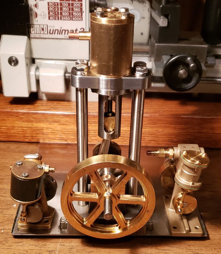

                                      I created photo albums for all my steam engines. I hope this makes it easier to see the details of an engine when it is mentioned or shown in a test report. The following photo shows the steam engines I recently ran with the twin cylinder airbrush compressor mentioned in the last post. The Stuart ST is on the left, the Chiltern is in the center, and the MSM Tyne is on the right. I left out the Saito T1 steam engine since the smaller airbrush compressor I had been using had enough energy to make the pressure higher than it was designed for. The test sheet shown below is a simpler version than shown in the 19/11/2020 post. Estimating the leakage loss and the mechanical efficiency is very time consuming. I can add this to the test sheet if this is helpful.

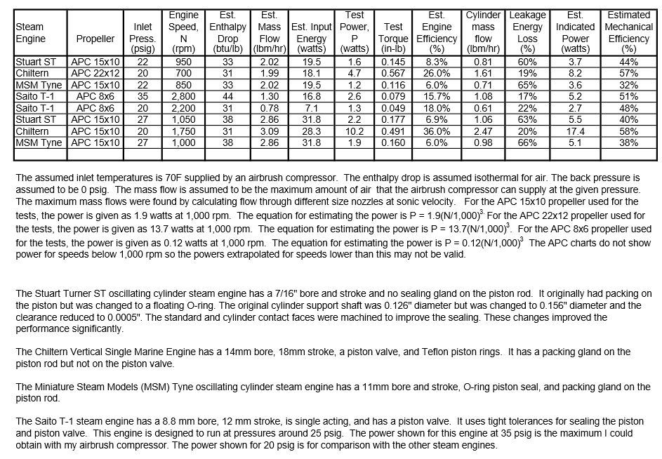

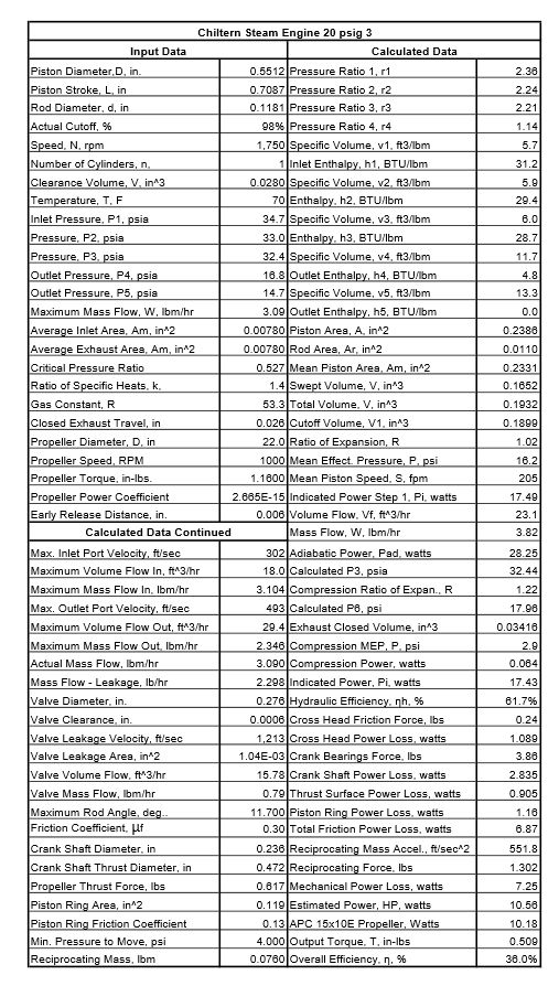

                                          As I stated in the 22/07/2022 post, estimating the leakage loss and the mechanical efficiency is very time consuming. The following spreadsheet is what I used for estimating these for the last test of the Chiltern steam engine. I estimate the pressure change required to fill the cylinder and empty the cylinder in the time available. I use these pressures to calculate the enthalpy and specific volume of the gas at each step of the cycle. For air, these are calculated based on an isothermal process. For steam, I use the steam tables and Mollier chart from Thermodynamic Properties Of Steam by Keenan and Keys, first edition. I estimate the leakage, compression, and the friction losses for these pressures. This was the way I estimated the data shown in the test sheet in the 19/11/2020 post. I think estimating the leakage and mechanical losses are important to understand the strengths and weaknesses of different types of steam engines. I decided to try a simpler method to estimate these losses which I will explain in the next post. chiltern spread sheet 3.jpg
                                          #607938
                                          Turbine Guy
                                            @turbineguy

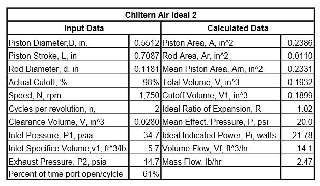

                                            I read through the section on steam engines in Mark’s Standard Handbook for Mechanical Engineers, tenth edition, by Eugene A. Avallone and Theodore Baumeister III. They stated that a diagram factor of between 0.7 and 0.95 could be used to estimate the actual indicated power from the theoretical indicated power. The theoretical indicated power can be estimated relatively easily as shown on the following spreadsheet. The mass flow into the cylinder can also be estimated with the input data shown. I updated the test sheet shown in the 19/11/2020 post to include the latest tests of my steam engines shown in the 22/07/2022 post using the data from the spreadsheets like the one shown below of each of the steam engines and using a diagram factor of 0.8. You can see that the results look very similar to those found using the methods described in the last post.

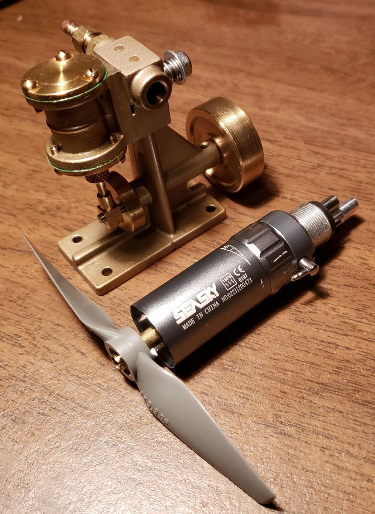

                                              Turbine Guy
                                                @turbineguy

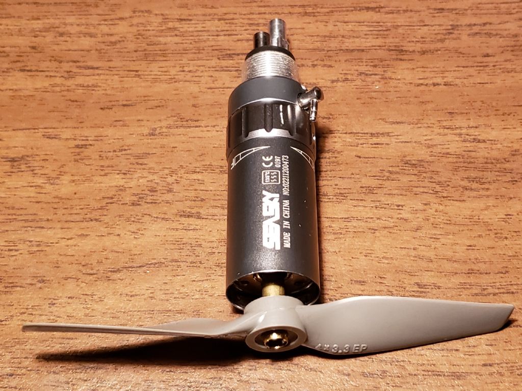

                                                I wanted to test a small vane type motor so I couldn’t resist purchasing the Seasky dental handpiece from Ebay shown in the following picture. The photo below it shows the modified Seasky air motor next to the MSM Tyne steam engine to illustrate its size. The size and cost of $17.59 seemed hard to beat. I will add some more information and the first test results in the next posts.

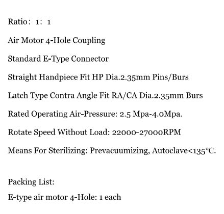

                                                #625692
                                                Turbine Guy
                                                  @turbineguy
                                                  A copy of the specifications given for the Seasky handpiece is shown below. No model number or dimensions were given. The OD of the housing is 20mm. It was surprisingly easy to attach the propeller and add an enlarged extension to the air inlet tube as shown in the following photo.
                                                  #625696
                                                  Turbine Guy
                                                    @turbineguy

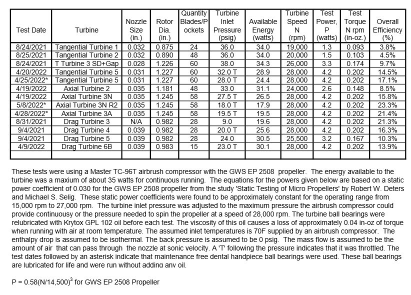

                                                    I added the first test results for the Seasky air motor shown below to the test sheet shown in the 22/07/2022 Post. The vane type air motor was very competitive with the Turbines and Engines I have tested at a surprisingly low cost.
                                                    #636951
                                                    Turbine Guy
                                                      @turbineguy
                                                      I added Radial Turbine 1 shown in the 09/01/2023 Post to my Model Turbines thread and Tangential Turbine 5C in the last posts since I last updated this thread. Tangential Turbine 5C had the best performance of all the turbines I have tested when running with the Stuart Twin Drum boiler. I added the performance of Tangential Turbine 5C to the test sheet shown in the 12/10/2020 Post of this thread. The following test sheet shows this update.
