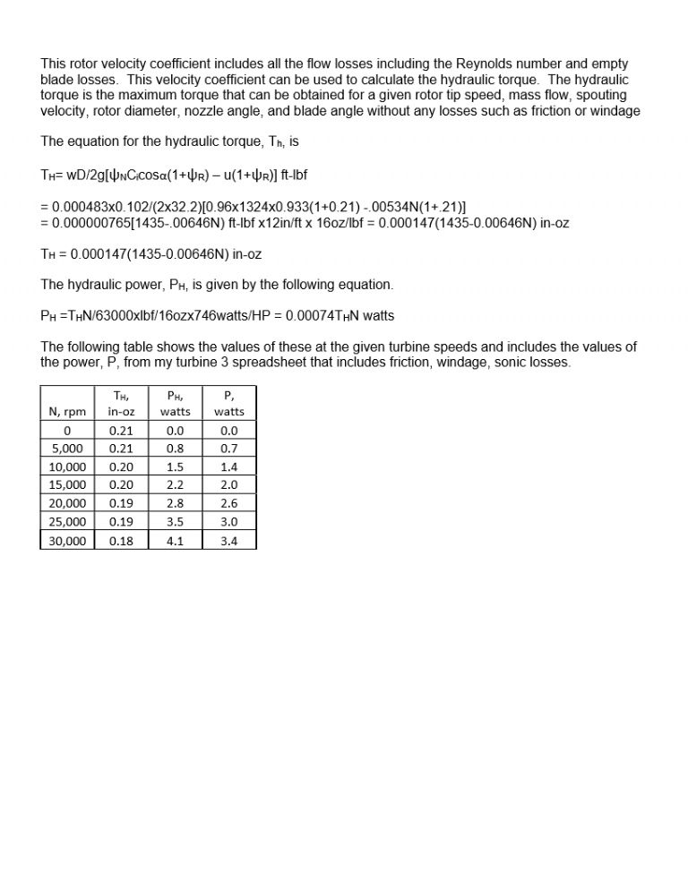

        The hydraulic torque and power can be calculated as shown below. The values used are from the test to find the stall torque in the preceding post. The table gives my best estimate of the power of my turbine 3 running on air from my airbrush compressor.
        Turbine 3 Hyd. Power 4

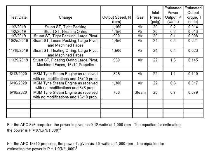

          I purchased the Tyne steam engine described below from Miniature Steam Models (MSM). This engine comes with a displacement lubricator and a small bottle of steam oil and is intended to be run on steam. It was only available as a partially assembled version at the time of purchase. I decided that I would do my first tests with all the installed parts in exactly the position they arrived in. This included the position of the nut that compresses the spring that pushes the cylinder against the standard. That is the most critical adjustment. I liberally oiled everything on the engine and drew oil into the cylinder by putting a few drops of oil into the exhaust and turning the engine backward. I mounted the APC 15x10E propeller that gave the best performance with my Stuart Turner ST oscillating cylinder steam engine. I then attached the hose from my airbrush compressor and carefully increased the pressure until I found the minimum pressure of 12 psig that the Tyne would keep running with. I made many runs of only a couple of minutes long between reoiling. After several minutes of doing this, the Tyne would keep running with a pressure of 4 psig. MSM gives 25 psig as the operating pressure for their boilers recommended for use with this engine. I kept increasing the pressure until the airbrush compressor reached the maximum pressure of 22 psig it could supply with existing engine adjustments. The maximum speed was about 825 rpm for this inlet pressure. I made several short runs at this pressure with reoiling between each run and the speed stayed approximately the same. I noticed that leakage started at the interface of the cylinder with the standard before reaching this pressure. I also noticed that the speed increased when I turned off the airbrush compressor and the pressure started to drop. This indicated that the optimum pressure for the initial settings is lower than 22 psig. I will find the pressure I get the maximum speed with the initial settings in my next test.
          MSM Tyne

            I tried running the MSM Tyne steam engine with different pressures with all the assembled parts in the same position as when they were received. I could not find any pressure that the speed increased over the 825 rpm maximum of the first test. 22 psig was still the pressure that obtained the maximum speed. The run lengths were only a couple of minutes for each pressure with reoiling after each pressure change. I then tried tightening and loosening the nut that adjusts the spring force pushing the cylinder against the standard. The position of the nut for maximum speed was the initial as received position. Tightening or loosening the nut caused the speed to drop. An air pressure of 22 psig is the highest my airbrush compressor is capable of for this engine and the optimum adjustments. The operating characteristics for this engine are similar to what I found for the Stuart Turner ST oscillating cylinder engine. The adjustment of the spring force needs to be lower than required to stop all leakage for maximum performance. I never tried the APC 15x10E propeller on the ST oscillator until I made several modifications, so I don’t know how the as received performance would have been. The modifications I made based on the guidelines given by K. N. Harris in the second edition of Model Stationary and Marine Steam Engines did improve the performance of the ST as shown in the 29/11/2019 post. I updated the following chart from that post to include the test of the Tyne steam engine.
            Oscillators Test Results

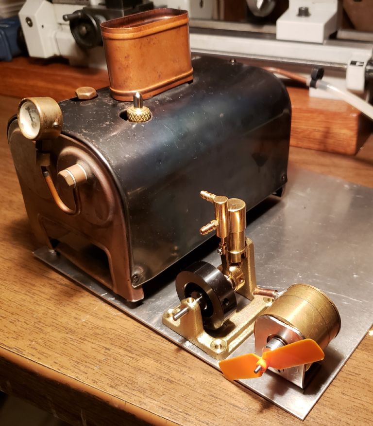

                  I ran the Tyne engine on steam with my Stuart Turner Twin Drum Boiler. This is my smallest boiler and was intended to be used with engines like the MSM Tyne or Stuart Turner ST oscillating cylinder engines. I thought I fixed the relief valve, but it leaked in this test preventing the pressure from getting to the 25 psig I planned to run at. After running long enough for the speed to stabilize at the lower pressure, I blocked the leakage out of the relief valve just long enough to get the pressure up to 25 psig and run at that pressure for a short time. The maximum speed obtained with the APC 15×10 propeller was approximately 700 rpm. The speed remained almost constant for all the time I had the 25 psig pressure. I updated the following chart to include this test. The Tyne was very easy to get running. It passed the slugs of water you get when first starting with steam and started running at a constant speed very quickly. The total time of the run was 8 minutes and 40 secs. It ran very smoothly for the entire length of the run. The displacement lubricator and steam oil provided by MSM appeared to give the piston and O-ring all the lubrication they needed. I oiled all the external joints needing lubrication with a light machine oil. The vibration of the Tyne engine was quite a bit less than the ST even though neither of these oscillators show any attempt to control vibration.
                  Oscillators Test Result 3

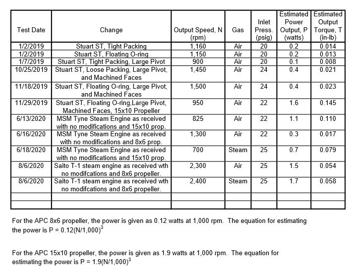

                      The following table shows the maximum performance of my three steam engines running on air. It also includes the percent of the total available energy lost due to leakage for each of these engines. I wanted to point this out since it is the biggest loss for the simple oscillating cylinder engines and is significant for the more complex engines. I determined the amount of mass flow lost due to leakage by subtracting the mass flow required to fill the cylinder from the total mass flow going to the engine. The energy lost due to leakage is proportional to the amount of mass flow lost due to leakage divided by the total mass flow going to the engine.
                      Energy Loss due to leakage = (Total mass flow – Mass flow to fill cylinder)/ Total mass flow, %
                      The Tyne steam engine comes with almost all the improvements I made to the Stuart ST steam engine, plus a sealing gland on the piston rod. The one improvement I did better on the modified Stuart ST engine was the very tight clearance of the cylinder support shaft. The Tyne steam engine has tighter clearance on the cylinder support shaft than the original Stuart ST steam engine but not as tight as the modified Stuart ST steam engine. You can see from the table how important that clearance is.
                      My Steam Engines 1

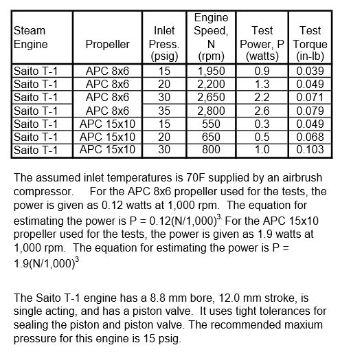

                                  My first test runs of the Saito T-1 were with the APC 8×6 propeller that I thought would be best for this engine. I ran the Saito T-1 at different pressures up to 30 psig. I oiled the engine before each run with a new pressure and ran it long enough to obtain a maximum speed.  I then ran a series of tests with the APC 15×10 propeller doing the same thing. In all the first tests the airbrush compressor was cycling on and off. The Saito T-1 is designed to run at pressures around 1 bar or approximately 15 psig. Running the engine at that speed had my airbrush compressor cycling with the motor constantly turning off and on. Since the performance was best with the APC 8×6 propeller, I increased the pressure until the airbrush compressor was running continuously. The maximum pressure the airbrush compressor was able to reach with this engine was 35 psig. My tests with nozzles showed the mass flow was approximately 1.3 lbm/hr with the airbrush compressor running continuously at 35 psig. The following table shows the results of these tests. Running the pressure much higher than 15 psig will shorten the life and is not recommended. The performance at the pressures shown in the table illustrates what the engine is capable of. The Saito T-1 and the matching Saito boilers have been used in several small model boats as shown in videos on the internet. I will add the maximum performance of the Saito T-1 in the table showing the performance of my other steam engines in the next post.
                                  Saito Test 1

                                        I thought about the comments you made copied above and went back and looked at some of my charts for the steam engines (especially in my Testing Models thread). I should not have extrapolated the performance based on the APC propellers to speeds below 1000 rpm. Even the APC chart for the 22" diameter propeller I used testing my largest steam engine does not show performance below speeds of 1000 rpm. I am going to copy these comments and add them in a post on my Testing Models thread.
                                        Thanks for pointing this out,
                                        Byron
