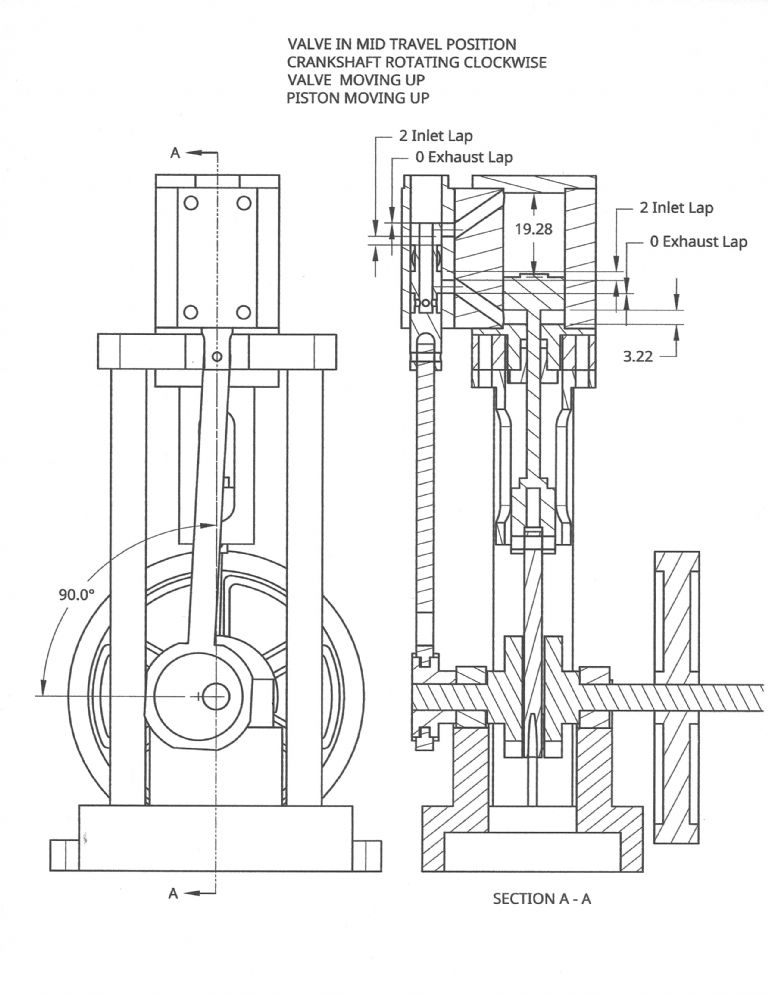

      I tried various combinations of inlet and exhaust lap for a single valve and found that an inlet lap of 2mm and no exhaust lap that gave an average cutoff of approximately 75% was the best combination for air with an available energy 17.5 watts. The air has an inlet pressure of 24 psig, a exhaust pressure of 0.0 psig, and a mass flow of 1.74 lbm/hr. The estimated output power is 5.6 watts. The estimated hydraulic efficiency is 51.8% and the estimated overall efficiency is 32.3%. Making a new valve without any other changes could increase the power by approximately 0.9 watts, a 19% improvement, and only require 1 new part.
      Valve 2 Mid Travel

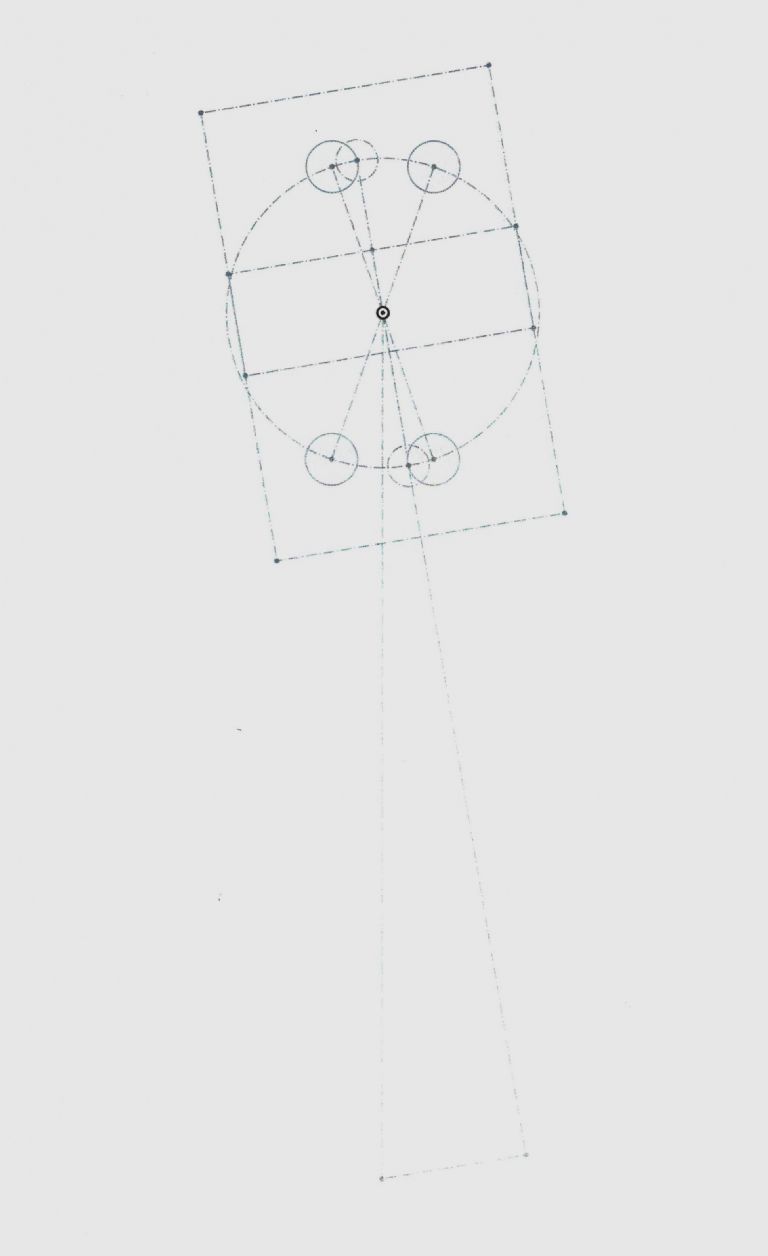

              I decided to make a velocity staged tangential turbine and the next few posts update the testing I have done.. The following drawing shows my initial design. Since I didn't get the first nozzle hole in the correct position I had to add another nozzle hole in the vertical position, but the concept is the same. . I designed this turbine to be able to run with the first row of blades only by leaving the reversing chamber off. The air or steam can exit the first row of blades out the opening required for the reversing chamber. I want to do this so that I can see the performance of the rotor with the larger diameter and greater number of pockets. The testing I have done on the last turbine indicates the open pocket design has about the same performance of a Terry turbine with the same rotor diameter, number of blades, nozzle admission length, and available energy. My first rotor with 24 pockets appeared to match the performance given by Dr. Balje’s diagram for Terry turbines with around 25 blades. My second rotor with 48 blades also matched the performance for Terry turbines with approximately 45 blades. The new turbine rotor has 60 pockets and the pocket angle has been reduced from 30 deg. to 25 deg so that the flow is closer to being perpendicular to the direction of rotation. Since the number of blades or pockets has a very large effect on the efficiency, I expect my new turbine running with just one row of blades and a larger diameter to further improve the performance even with the rotational losses of two rows of blades.. Tangential Turbine 3 VS 2A

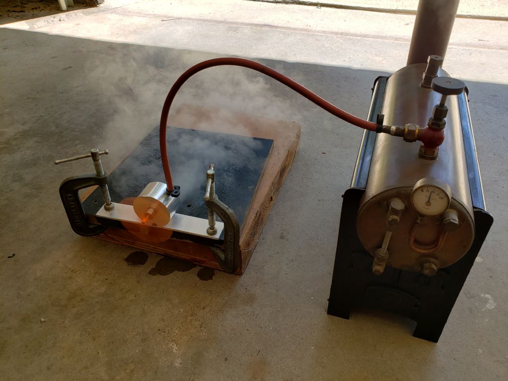

                I ran my new turbine without the reversing chamber with my airbrush compressor and it obtained a speed of 21,500 rpm turning the EP2508 propeller. My estimation of the power required by this propeller to turn at that speed is 3.8 watts. The power available to the turbine from my airbrush compressor is approximately 18 watts so the efficiency is approximately 21.9%. This is an increase in power of about 1.5 watt over what was obtained by my last turbine for the same amount of energy. The increase in power is primarily due to the increase in rotor diameter, increase in number of pockets, and reduction of the pocket inlet angle. The increase in the rotor diameter was from 0.892 in. to 1.226 in. This increases the rotor tip speed and torque. The increase in rotor tip speed raises the power but also increases the rotational (windage) loss. The rotational loss is still low enough at 21,500 rpm that even with the extra set of pockets it did not appear to be excessive. The increase in number of pockets was from 48 to 60. With single nozzles, the number of pockets under the nozzle discharge opening becomes very important since energy is lost in filling the empty pockets. The pocket inlet angle decreased from 30 degrees to 25 degrees. The smaller the angle, the less energy is lost from the flow not being perpendicular to the direction of travel. The power achieved was greater than expected so my estimations of power from the propeller might not be conservative. However, the increase in performance with each of the changes using the same propeller and airbrush compressor verifies that Dr. Balje’s guidelines are useful in the design of model turbines.
                The following photo shows my test setup.
                Tangential Turbine 3 VS Test
                #418424
                Turbine Guy
                  @turbineguy
                  I also ran my new turbine on saturated steam at a gage pressure of 50psi (3.4 bar) and an estimated water rate of 0.55 oz./min. The maximum speed it turned the EP2508 propeller was 28,000 rpm. The estimated power required for the EP2508 propeller at this speed is approximately 8.6 watts. The steam was supplied by a Stuart Turner model 504 boiler and the assumed temperature was for saturated steam at the inlet pressure. I assumed the modest superheat of this boiler was lost to the cold turbine housing with air from the propeller blowing over it. The following photo shows the test setup.Tangential Turbine 3 VS Test 2

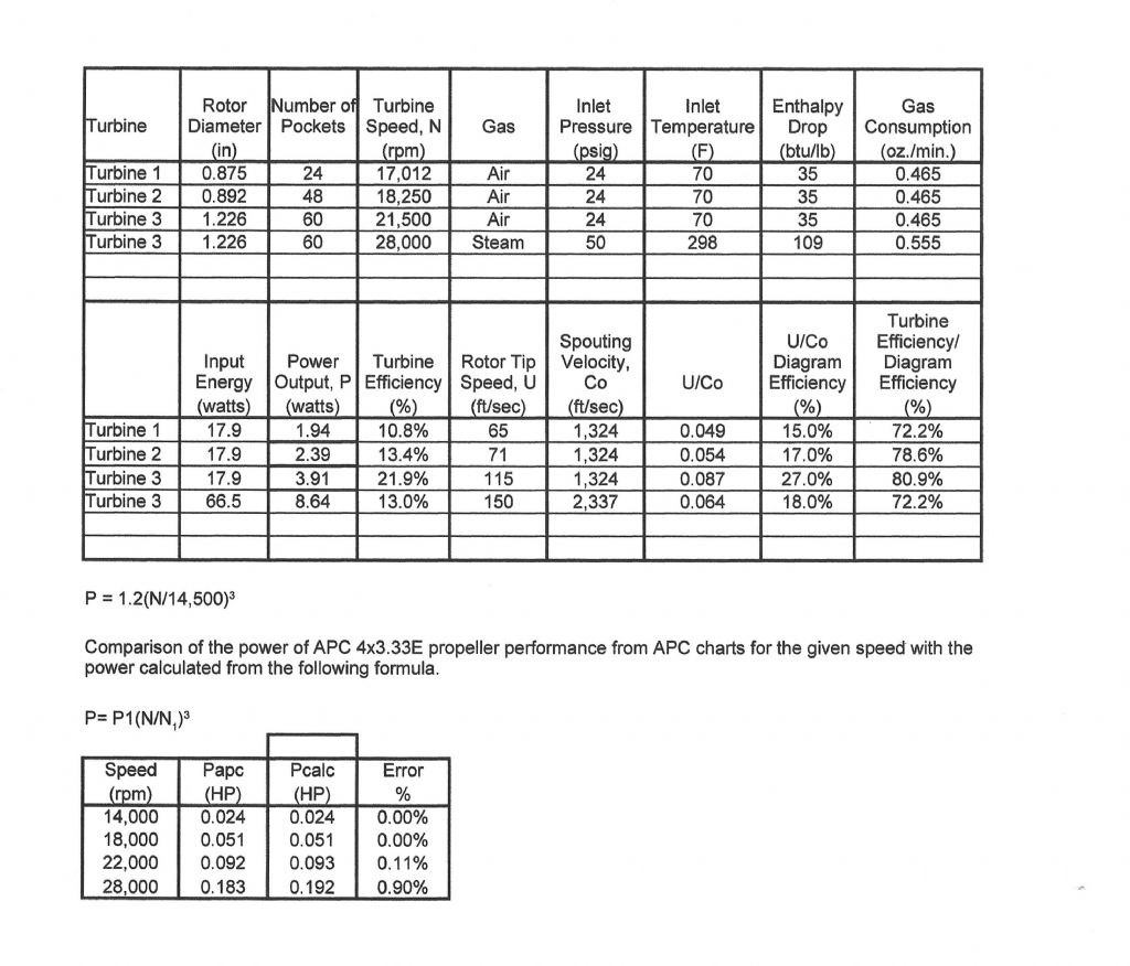

                    I made the following chart to summarize the testing of my turbines and a chart at the bottom to check the validity of my equation for estimating the power required by the EP2508 propeller. I had only one speed of the EP2508 propeller that I could verify the required power. I wanted to see if my use of increasing the propeller power by the cube of the turbine speed was valid for the range of speeds of my tests. Since APC has performance charts for all its propellers, I checked the performance of their propeller closest in size to my EP2508 propeller at the speeds nearest to the speeds obtained in testing. As shown in the chart, increasing the power by the cube of the speed for the range from 14,000 to 28,000 rpm was accurate to within 1%. Since the first test was with Rulon bushings and run with a smaller boiler, I did not include its performance in this chart. This way all the tests on air or steam will be with the same airbrush compressor or boiler and all the turbines have the same ball bearings. I also added a comparison of the efficiency of my model turbines with the efficiencies of high duty axial turbines shown on the U/Co diagram that will be added in the next post. I added this to show under similar conditions, even the optimum axial turbines do only approximately 20% better than my optimized open pocket tangential turbine.My Turbines 3

                      The following chart shows the efficiency of high duty turbines as a function of the velocity ratio of the rotor tip speed U to the ideal spouting velocity Co. This chart assumes turbine stages with enough nozzles, tight clearances, and power to make the filling losses and rotational losses negligible.Turbine Efficiencies
                      #418436
                      not done it yet
                        @notdoneityet
                        Interesting. ‘Estimates’ to three significant figures. How do you manage to measure the power to even a precision of one in five hundred, let alone an accurate figure, to three sig figs? Just wondering – from a mathematical view-point.
                        #418535
                        Turbine Guy
                          @turbineguy
                          Posted by not done it yet on 12/07/2019 06:43:06:
                          Very good point. I explained how I assumed a power of 1.2 watts for the EP2508 propeller turning at 14,500 rpm at the beginning of this thread. And later explained how the actual accuracy of the 1.2 watts was not as important to me as the change in power with each modification to my turbines. That being said, an accuracy of two significant places should have been used for the values of power. Thanks for pointing this out.

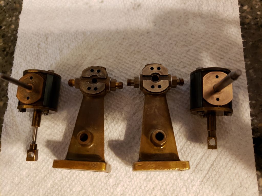

                                      Since I was able to achieve the performance I hoped to obtain with my turbines, I decided to work on my Stuart Turner St oscillating steam engines again. The following photo shows the machining done on the cylinder and standard of the parts on the right and the same parts without modification on the left for comparison. I machined the mating faces of the standard and cylinder on the parts on the right. As I suspected, the mating surfaces were worn conical by the tilting back and forth of the cylinder as the engine ran. You can also see in the photo how much larger the cylinder support shaft is on the parts on the right side. The following is the speeds I posted 1/7/2019 after running the APC 8×6 propeller with the enlarged cylinder support shaft. The maximum speeds for 5, 10, 15, and 20 psig were 450, 655, 765, and 851 rpm respectively. After machining the faces, the maximum speeds for 10, 15, 20, and 24 psig were 1,000, 1,125, 1,215, and 1,450 rpm respectively. I was able to maintain a pressure of 24 psig after machining the faces. 20 psig was the maximum I could maintain before machining the faces. After testing I took the cylinder off and tried moving the piston with the ports open and closed. There was only a slight increase in force moving the piston with the port closed so the packing loosened up from the previous tests. For propellers, the power goes up by the cube of the speed so the increase in performance was substantial. In the next post I’ll add a chart similar to the one I used for documenting the testing of turbines.
                                      ST Parts

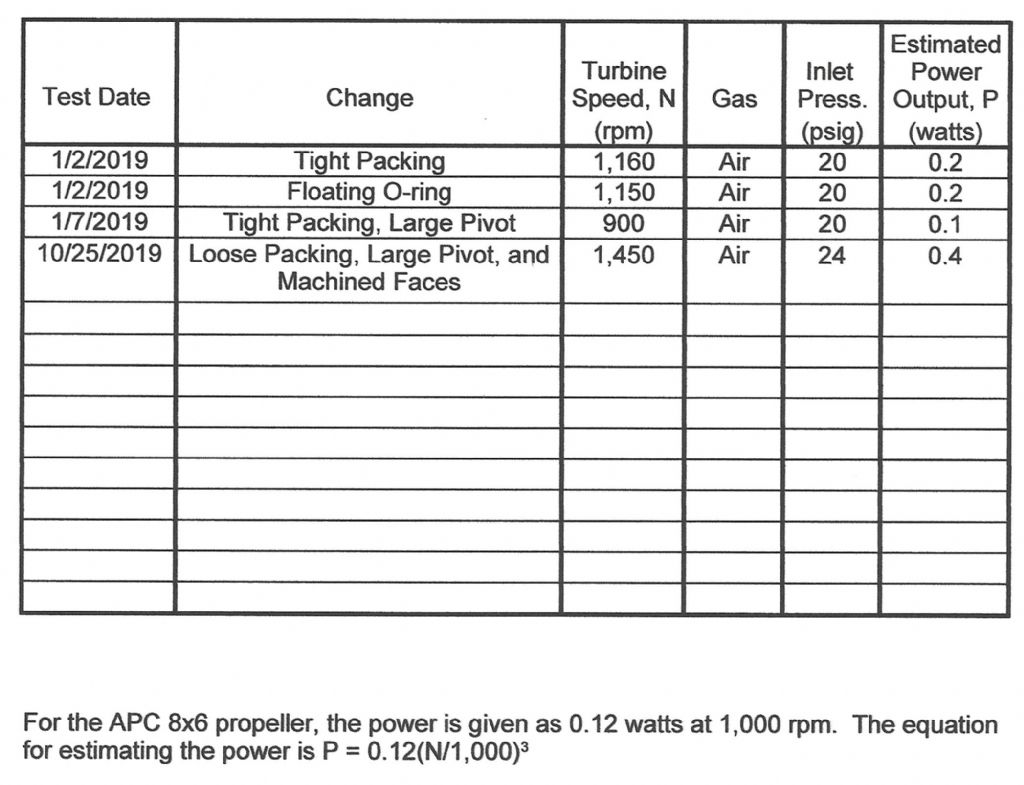

                                        #438247
                                        Turbine Guy
                                          @turbineguy

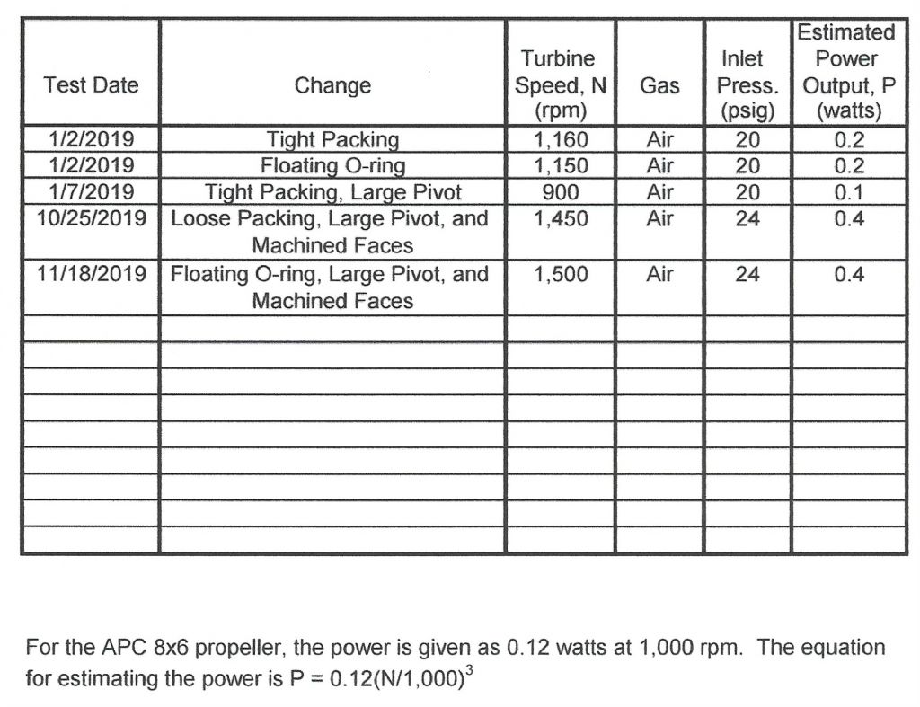

                                          The following is the speeds I posted 10/25/2019 running the APC 8×6 propeller after machining the faces. The maximum speeds for 10, 15, 20, and 24 psig were 1,000, 1,125, 1,215, and 1,450 rpm respectively. After switching to the floating O-ring, the maximum speeds for 10, 15, 20, and 24 psig were 1,000, 1,250, 1,400 and 1,500 rpm respectively. I was able to maintain a pressure of 24 psig after machining the faces, 20 psig was the maximum I could maintain before machining the faces. After testing I took the cylinder off and tried moving the piston with the ports open and closed. The force to move the piston was very large with the port closed when moving toward the top cylinder cover. The force was quite a bit less with the port closed and moving toward the bottom of the cylinder due to leakage around the connecting rod. There was very little force required to move the piston in either direction with the ports open. Even with the much tighter clearance on the cylinder support shaft, the cylinder is pried away from the standard if the pressure is above 15 psig (1 bar). This only happens with the tight packing or floating O-ring. Tightening the spring to the maximum doesn’t keep the cylinder from being pried away. I believe the biggest weakness of the simple oscillating cylinder engines is the cylinder pin riding in a hole on one side only. If the seal is good on the piston, the force cocking the cylinder can be very large. If you make the spring large enough to keep the face of the cylinder from being pried away from the face of the standard, the friction loss becomes too large. From my testing with a relatively tight clearance on the cylinder pin, the best power came with the spring compressed less than the maximum. The flow lost by the cylinder cocking was still relatively low because of the tight clearance. The cylinder would tilt away from the standard each time the pressure was above 15 psig. This caused a leakage at higher pressures that limited the power. My airbrush compressor had to run continuously at pressures above 15 psig but could maintain pressures below 15 psig by running intermittently. Apparently, the friction and binding caused by the increased pressure partially offsets the gain in performance from having less leakage by the piston.
                                          The following chart has been updated to show the tests with the floating O-ring and shows the maximum performance was about the same for the floating O-ring and bedded in packing.
                                          ST Test Results 2

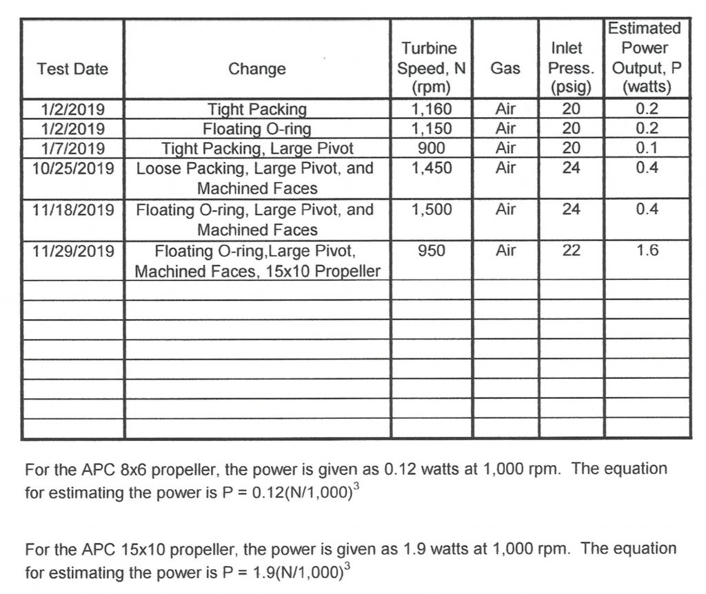

                                            I kept looking for reasons my Stuart ST oscillating steam engine was putting out such low power. I analyzed the flow through the ports with the small opening area. The following diagram shows the ports in the maximum opening position. The circles with the solid lines represent the holes in the standard. The dashed circles represent the holes in the rotating cylinder. As you can see the maximum overlap is very small. The hole in the rotating cylinder is 1/16 inch in diameter and the full flow area is 0.0031 square inches. The maximum opening area of the overlapped ports is 0.0013 square inches. The average opening area during the intake cycle is 0.00084 square inches. I estimated the pressure drop in the inlet and exhaust ports to fill and empty the cylinder at 1500 rpm with the average opening area. The estimated inlet pressure drop was 3.7 psi and the estimated exhaust pressure drop was 8.3 psi. With half the available pressure lost in filling and emptying the cylinder at 1500 rpm, I thought running at a lower speed would be more efficient. I removed the APC 8 x 6 propeller and mounted an APC 15 x 10 propeller. The maximum speed I was able to obtain with the 15 inch propeller was 950 rpm. The power required by the APC 15 x 10 propeller at that speed is 1.6 watts. This is a major increase in power from my previous tests and is more like I expected from the Stuart ST steam engine. Apparently, it is best to run at a low speed due to the very small port opening area. I will add an updated chart including this test in my next post.
                                            ST Port Opening
                                            Edited By Turbine Guy on 29/11/2019 21:13:22
                                            #439439
                                            Turbine Guy
                                              @turbineguy
                                              The following chart shows the test described in the last post. 22 psig was the maximum pressure I could obtain with my airbrush compressor running continuously with the APC 15 x 10 propeller.
