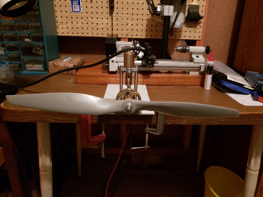

              I like using the propellers for a load since I can get the amount of power they require for a given speed. For a small air compressor and medium size engine, I have to use a very large propeller to keep the speed low. If I use a small propeller, my compressor can't keep up with the flow required and the pressure drops. With a 14mm bore and 18mm stroke, my Chiltern engine requires the maximum output of my airbrush compressor to maintain a pressure of 24 psig (1.63 bar) at a speed of 675 rpm with no leakage. With leakage, the speed will be even lower to maintain this pressure. I bought a 22" (560mm) diameter propeller for testing this engine. The propeller is a APC 22 x 12 WE It is 22" diameter propeller with a 12" pitch and requires about 14 watts to run at 1000 rpm. I show this propeller mounted to the Chiltern steam engine below. There is also a couple of pictures of the Chiltern steam engine without the propeller mounted in my album. I would appreciate it if someone could tell me how rotate the pictures in the album to the position they should be viewed.Chiltern with propeller
              #391910
              Turbine Guy
                @turbineguy
                I attached the propeller to the engine, mounted the engine on a plate, clamped the plate to my workbench, and turned on the airbrush compressor. The propeller spun at a maximum speed of 700 rpm with a pressure of 20 psig (1.36 bar). The power required by the propeller at this speed is approximately 4.71 watts. The amount of air required by the engine to fill the cylinder at this speed and pressure is approximately 1.52 lbm/hr. Since my airbrush compressor is only capable of about 1.74 lbm/hr, the total leakage was very small. I was very pleased with the Chiltern engine. It did better than I thought it would. The energy available from the airbrush compressor is approximately 16 watts, so I would like to determine where the losses come from. With steam engines, friction, pressure loss through the ports, and leakage can all be major parts of the loss and are difficult to estimate. In addition, using the full pressure for almost the entire stroke (almost no cutoff) wastes quite a bit of energy. Also, the Chiltern engine has relatively large clearance volumes that waste some energy. I’ll see if I can estimate where the major losses came from.

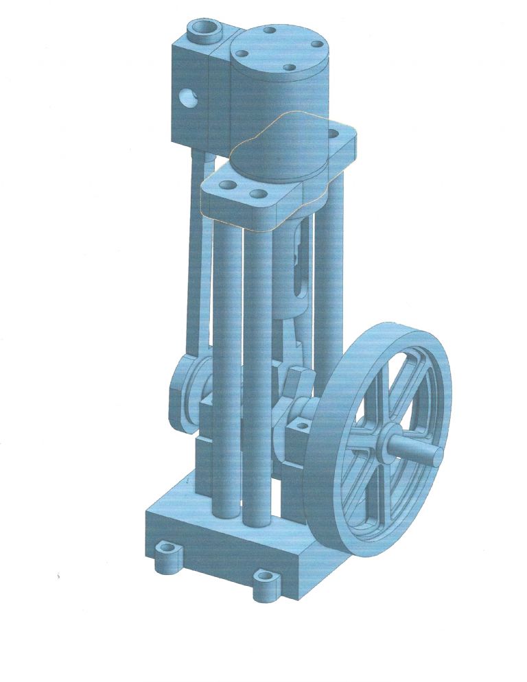

                                            After estimating the magnitude of the losses and what caused them for the Chiltern engine, I looked at ways to recover the losses. I started by seeing if the cutoff could be changed and what would be required to make the changes. I started with the best case. I estimated the indicated power without any pressure drop through the ports, no clearance volume, full expansion, and no compression of the air on the exhaust cycle. This is a perfect condition where the power produced equals the energy available. I used a 14mm bore, 18mm stroke, air with an inlet pressure of 24 psig, an exhaust pressure of 0.0 psig, and a mass flow of 1.74 lbm/hr. The cutoff for the ideal case is 48%. With these conditions, the power is approximately 17.5 watts at a speed of 1,620 rpm. I assumed a slightly higher inlet pressure than I was able to attain in the previous testing since I can get a propeller that keeps the maximum speed low enough that my airbrush compressor can maintain the higher pressure. I found by changing the piston valve and changing the ports from holes to slots I could get a cutoff of approximately 50% and still keep the pressure drop through the ports very low. I calculated the indicated power and mechanical (friction) losses by the methods I previously described plus added the 0.6 watts loss I was unable to account for. I estimated I could get a maximum power of 5.9 watts at a speed of 1,040 rpm. The test of the unmodified Chiltern engine resulted in a maximum power of 4.71 watts at 700 rpm. I’ll explain why this major change only has a potential gain of approximately 1.2 watts in my next post.
                                            #394219
                                            Turbine Guy
                                              @turbineguy

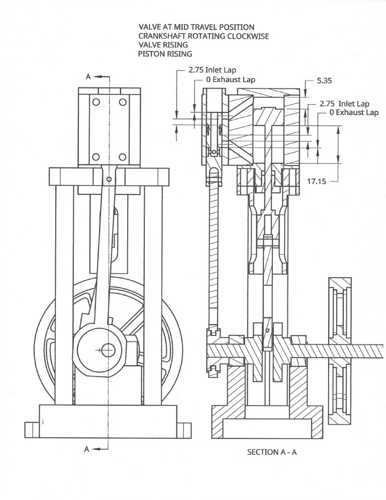

                                              The following drawing shows the valve I designed to try to get approximately 50% cutoff with the existing eccentric and valve linkage. The existing valve has a 0.4mm inlet lap and a 0.6mm exhaust lap. My revised valve has an inlet lap of 2.75mm and no exhaust lap. It wasn’t until I made a series of drawings to check the valve operation that I learned the importance of exhaust lap. Valve Mid Travel Position

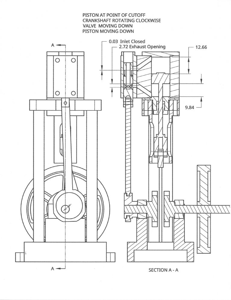

                                                The following drawing shows the distance from the cylinder cover to the piston when the inlet valve closed. The distance traveled minus the clearance distance divided by the stroke is the cutoff. The actual clearance is 2.25mm, so the cutoff is approximately 58%. Because of the time it takes to close the valve, the effective cutoff is probably close to the 50% I was trying to get.
                                                Valve Cutoff Position

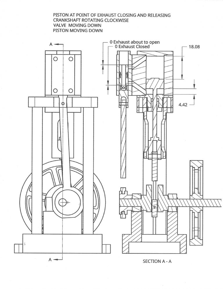

                                                  The following drawing shows the distances from the end plates when the exhaust closes on each side of the piston. The distance below the piston is used to calculate the volume of trapped steam or air that is compressed. I estimated the amount of power to compress the trapped air to be approximately 0.67 watts. The distance above the piston is used to see the point in the stroke the exhaust is released. The distance moved by the piston 18.08mm minus the clearance distance of 2.25mm and is approximately 15.83 mm. Since the stroke is 18mm, the air is released 2.17mm before the piston has moved the full stroke. I estimated the power lost due to the early release to be approximately.0.85 watts. In my original estimate of the power with the revised valve, I missed the early release. With this loss, the gain in power would be very little. The cure to this problem would be to add exhaust lap. The exhaust lap would almost eliminate the early release but increase the compression. If I could add the required exhaust lap, I would probably get the performance I first estimated. There isn’t enough room to add the required exhaust lap so I will have to look for a better way to improve the performance.
                                                  Exhaust closed and release points

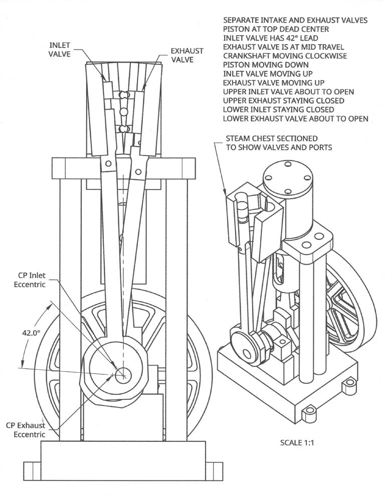

                                                    I decided I would have to make separate exhaust and inlet valves to substantially increase the efficiency. The link **LINK** confirmed the increase in efficiency with separate valves. This article also gave me enough information that I could check my formulas and methods of estimating performance with some actual test data. I used the 1.27 in. bore, 2.00 in. stroke, 15% clearance volume, 38% cutoff, early release distance of 0.30 in., exhaust closed distance of 0.44 in., inlet pressure of 38 psig, superheat of 81.2 C, and 502 rpm engine speed shown in fig. 6 for the conventional valve. With these inputs and using my equations I calculated an indicated power of 116 watts. The test result was 119 watts so my equations and methods appear to be valid. The following drawing shows a concept to add a second valve to my existing engine. Separate Valves TDCAdding the separate valves requires 1 each of the following new parts, a valve chest, inlet valve, exhaust valve, eccentric, and a valve connecting rod. To get maximum efficiency I would also add new top and bottom cylinder covers to the preceding new parts. These covers would extend further into the cylinder to reduce the piston clearance from 2.25mm to 1mm at each end of travel.
                                                    #396151
                                                    Turbine Guy
                                                      @turbineguy
                                                      With the preceding new parts, 14mm bore, 18mm stroke, air with an inlet pressure of 24 psig, a exhaust pressure of 0.0 psig, and a mass flow of 1.74 lbm/hr. the input power is approximately 17.5 watts. The average cutoff for each side of the piston is approximately 52%. The estimated output power is 7.52 watts. The estimated hydraulic efficiency is 66.9% and the estimated overall efficiency is 41.9%. Adding separate valves and reducing the clearance volume increases the power by approximately 2.8 watts, a 60% improvement, but requires 7 new parts.
