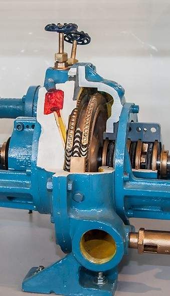

                                  #388770
                                  Tim Taylor 2
                                    @timtaylor2
                                    It was easier than I thought!
                                    This pic is a cutaway of an actual Curtis type single stage turbine – this one happens to be a Coppus TF-9.. You can see the 2 row wheel, the reversing sector, and the cutaway nozzle. The hand valves on top are used to isolate one or more nozzles. Reducing the number of active nozzles to the minimum needed to maintain load insure that the pressure drop is happening across the nozzles, where is designed to, and not the governor valve.
                                    Tim
                                    #388867
                                    Turbine Guy
                                      @turbineguy
                                      Tim,
                                      I would choose air based on my experience using both. My airbrush compressor puts out a very consistent air flow and starts with the push of a button. I'm able to use pre-lubricated ball bearings without worrying about the steam washing out the grease. I also don't have to worry about wet steam and rusting. I suggest you choose your power source and make a nozzle. You will need the maximum diameter of the nozzle for scaling the blades. You're right about using multiple nozzles and being able to isolate them individually. The supersonic nozzles are very sensitive to pressure drop and can become unstable with pressure ratios higher or lower than their design. For optimum performance the angle of the blades needs to take into account the speed difference between the stationary and moving parts. If you plan on only running at low speeds this won't be as important.

                                                  #389684
                                                  Turbine Guy
                                                    @turbineguy
                                                    Tim,
                                                    It looks like you picked a very good turbine to base your design on. I searched on the internet for information on this turbine and found the following for a rebuilt turbine. They didn't give the temperature or the mass flow of the steam for this power. It surprised me the turbine would operate at such a low speed.
                                                    Specifications
                                                    Coppus Steam Turbine TF-9
                                                    RPM: 1250
                                                    HP: 0.75
                                                    Inlet PSIG: 75
