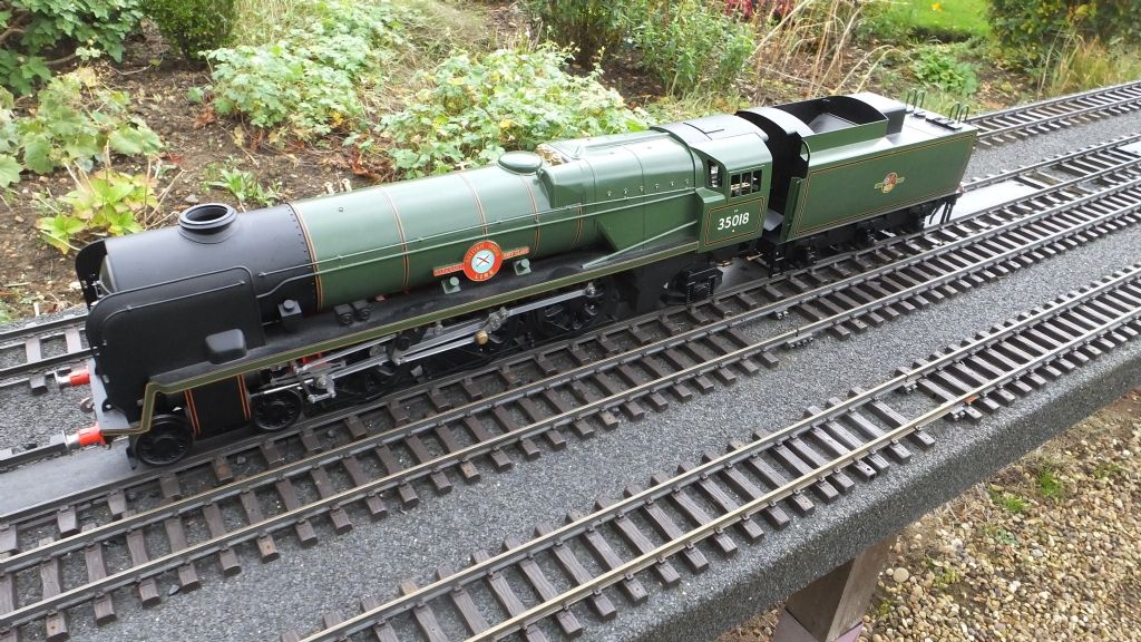

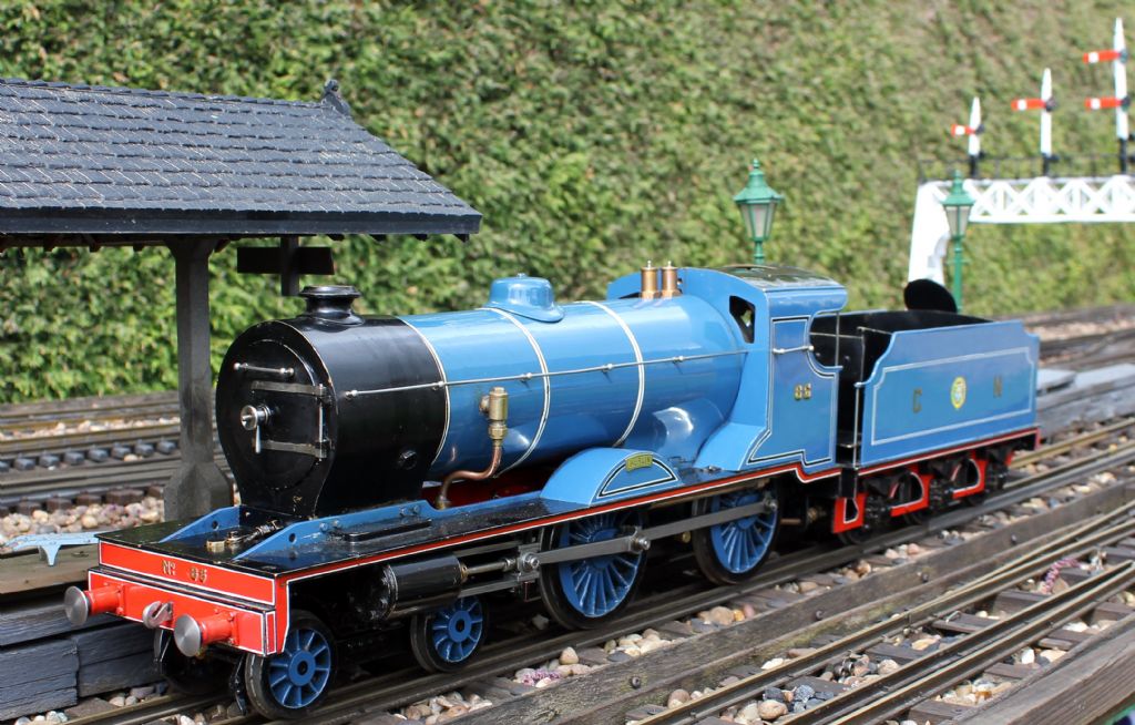

                            If you plan to go to the larger gauges William, my advice would be to do exactly that. A Project will take time and some money and unless you plan to stay & model in G1, then I'm not sure there's much point.
                            You asked about Tender vs Engine build 'proportions' and I think RRMBK has given as good an estimate as is possible. It does depend of course on what you decide to build – and the level of complexity and detail.
                            Several posts ago, I recommended Martin Evans "Eagle" as a simple 2.5" loco for a beginner – here is my friend Roger's version of it. He built it some years ago and it always runs very well. It's an attractive engine, simple and reliable to run. The tender is fairly basic and the loco has twin outside cylinders and is coal fired.
                            GNR(I) Eagle at Thurnby
                            But if you want something more challenging in G3/2.5" – then you could go for something several steps up in ambition and build something like this rebuilt Merchant Navy class. This engine was shown at a small G3 gathering earlier this year and is really a superb example of what is possible in Gauge 3.
                            It would certainly make an impressive ornament for your mantlepiece too.
                            My advice is this – think carefully about what you would really (really) like to build and eventually own.
                            It's going to take you a lot of time, much devotion and some money whatever that is. So choose something that you will love doing – not what others think you are capable of or need. Then just get on with it – small steps, first foot forward and all that!

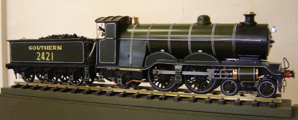

                                          Are we homing in on something like this then William?
                                          IanT
                                          Marsh Atlantic
