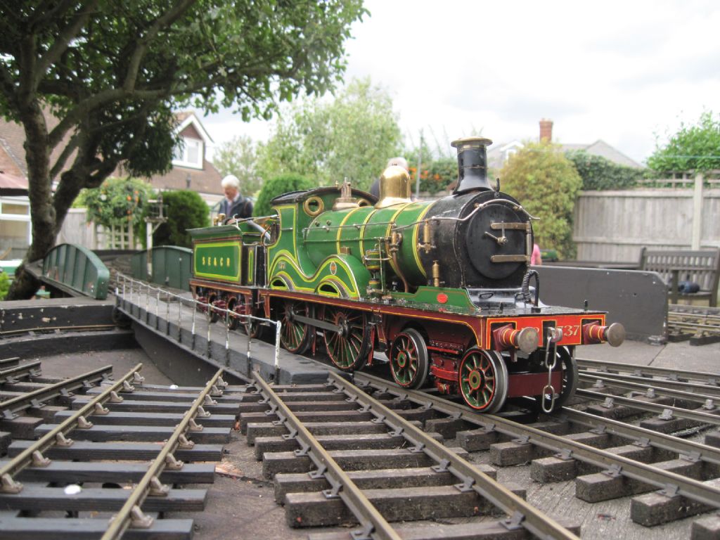

          Why not consider 2.5" gauge? Plenty of locos to choose from as listed here:
          2.5" Gauge Locomotive Designs
          And this list doesn't include some of the newer designs (like Dick Allan's Gauge 3 'Dee' )
          A fairly straightforward 2.5" 'tender' loco to build is Martin Evans 'Eagle' . There is at least one example I can think of that runs very nicely at our GTGs. It's a GNR (Ireland) prototype and looks very good in blue. It wouldn't bring the chimney breast down either if you plonked one on the mantelpiece.
          Nor will a 2.5" loco damage your back or bank balance as much as a larger gauge loco either!
          I am a bit biased of course!
          Regards,
          IanT
          PS One of these would look good on display… (Dicks G3 "Dee" at a GTG in 2018)
          Gauge 3 Dee

                                                    That line is in Bedfordshire William and it is normally very popular with G3S members because it has twin running circuits for live steamers and a branch line for the R/C engines to operate on. There are other G3 railways around the country but this one is quite central, so gets people from London, the Midlands and South East. It's also a G3S boiler test site at the beginning of the running season – so I guess those are the reasons it tends to get photographed a lot.
                                                    The best way to settle your mind normally, would be to go and look at the different options and try to narrow down what you want out of your hobby. We often have guests who are invited to GTGs and are free to chat to members about their engines and have a drive. Not possible at the moment I'm afraid.
