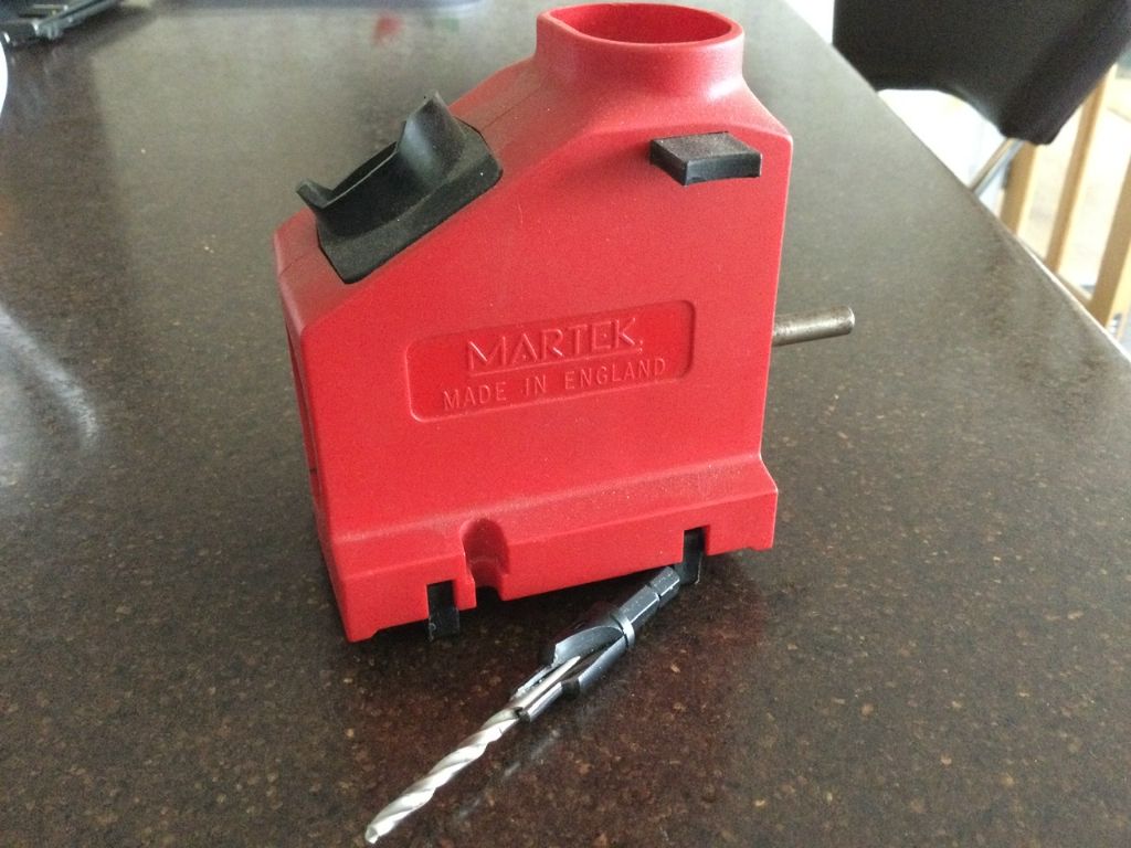

          I hope the OP doesn't mind if I piggy-back this thread:
          Not a machinist, so can I ask those with experience – if I use my angle grinder to quickly dry-grind* an approximate 25° angle on the end of my wood chisels before diamond grinding them to the correct final dimensions in a Trend diamond chisel hone: will I bugger the temper of the chisel steel with the angle grinding step?
          Secondly, when I sharpen my DIY HSS drill bits in a Martek drill bit sharpener containing a small drill-powered dry grinding wheel, (below), should I be dipping the drill bit end in water for similar reasons?
          Finally, how do I sharpen the type of tool shown next to the drill sharpener without a mill? (It cuts a clearance hole and counter-sink as well as the hole, in one operation). The drill bit is removable but the cutting body has a ground cut-out that forms the cutting surface, but I only have a drill press?
          Or a can you please recommend a good book on tool sharpening for the amateur. Many thanks.
          *for example to remove a notch in the blade.

              Posted by John Doe 2 on 25/01/2022 13:34:24:
              Yes you can overheat HSS in an a grinder. Sparey says if the metal goes blue near the tip, that section of HSS has to be ground off. He doesn't say so, but I think if the body of an HSS cutter has gone blue, the chances are the sharp edge got a lot hotter.
              The answer is to not grind metal off as fast as possible and for more than several seconds! Take it down gently in stages, don't let the metal get too hot, and dip in water.
              Same principle with a twist-drill except the risk of overheating is lower because the edge just needs touching up. It's unusual to have to grind of lots of metal.
              Sorry, I don't know how to sharpen the countersink tool and can't remember to title of the book that told me about sharpening.
              #582364
              pgk pgk
                @pgkpgk17461
                Agree with taking time if sharpening chisels on a dry grinder. I wouldn't bother using it unless there are significant dings/chips in the end of the chisel and just slick it up on a stone or diamond pad. For my fancy woodcarving chisels I use a Tomek water grinder and even then avoid unnecessary grinding..just re-establish the edge to chip free and hone with paste and leather. A well honed wood chisel lasts for ages with just repeat honing. For dodgy chisel work – old timber with plaster or cement stains or nails nearby – I use old cheap chisels that i don't mind damaging or grinding chunks off
                I rarely bother trying to sharpen drill bits – jobbing quality drills from the likes of UKDrills are cheap enough not to waste time.
                For HSS lathe tooling I doubt one will get it hot enough to damage the temper and still be able to hold it unless using thick gloves. Tom’s Techniques did a video on hot hardness to prove that point. Like many i keep a bowl of coolant by the grinder and keep dipping.
                I'd guess that all-in-one tool would be best hand-dressed with grades of round stones or diamonds.
