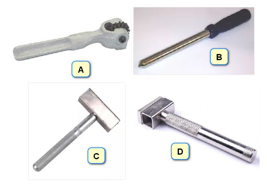

                                        #501509
                                        Gary Wooding
                                          @garywooding25363
                                          I don't have a wheel dresser. Which of these is the preferred type? C and D look similar.
                                          #501520
                                          IanT
                                            @iant
                                            Type 'B' is the diamond type Gary – which I use in addition to having a dressing stone. You can use them freehand but I think they are best if you can guide them to get an even surface. I use the diamond dresser on my fine wheels but generally clean up my coarse wheels with the stone. They both work but the diamond dresser gives a more precise finish if guided.
                                            I have no experience of the other kinds – I've always felt that the 'Star' dressers (type A) look a bit crude…but I've never used one, so others should comment on them.
                                            Regards,
                                            IanT

                                              #501535
                                              Grindstone Cowboy
                                                @grindstonecowboy
                                                I use Type B, but made up a simple collar and grubscrew so I can use the grinding rest to guide it across the wheel. Never used C or D but have used A – very fast but a bit violent for me.
                                                Rob
                                                #501541
                                                Mick B1
                                                  @mickb1
                                                  Posted by IanT on 15/10/2020 11:38:53:
                                                  Regards,
                                                  IanT
                                                  Yes, I'm with B too – except my singlepoint diamond is set in a short bit of steel, hammered into a bit of copper pipe I found lying about…
                                                  blush
                                                  #501548
                                                  Tim Hammond
                                                    @timhammond72264
                                                    I have always known type "A" as Huntingdon dressers and have used them several times on off-hand grinders at my place of work. As you would expect, quite vicious, quite scary and VERY messy, but they do work well. Nowadays at home I use a diamond dresser bought from Machine Mart mounted in a home-made jig to ensure a uniform surface on the wheel.
                                                    #501601
