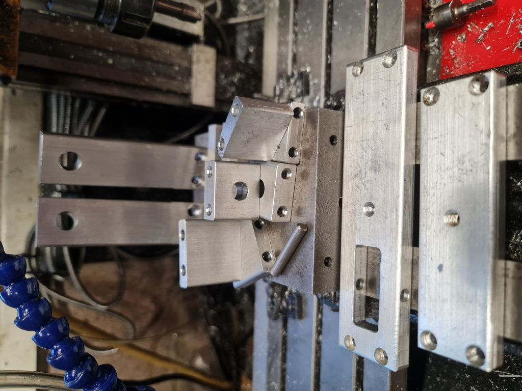

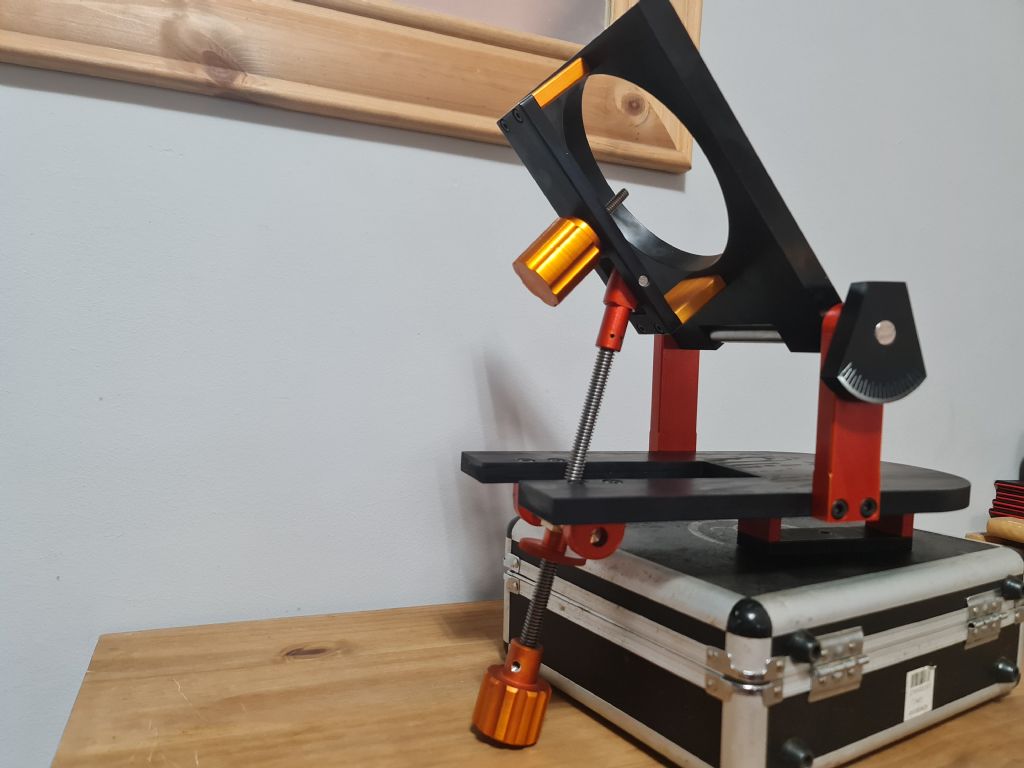

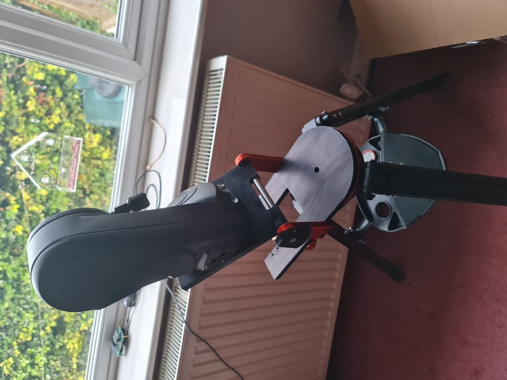

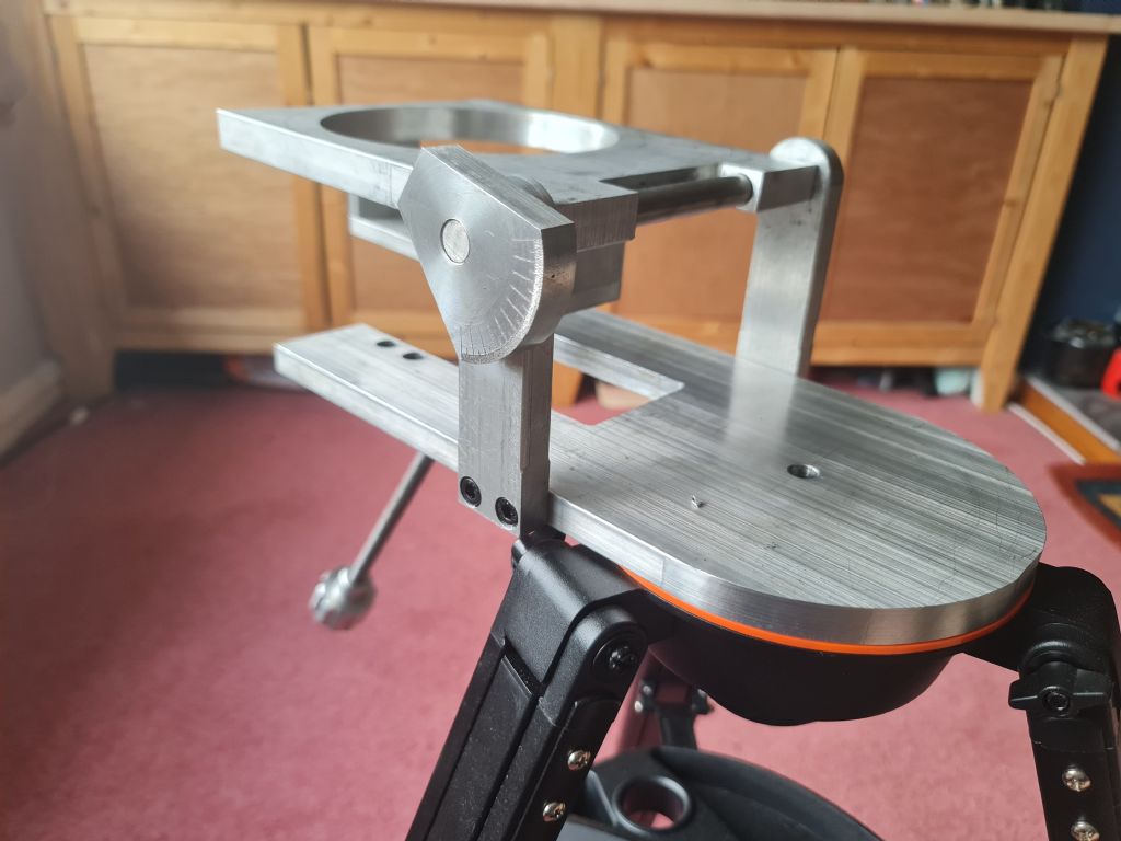

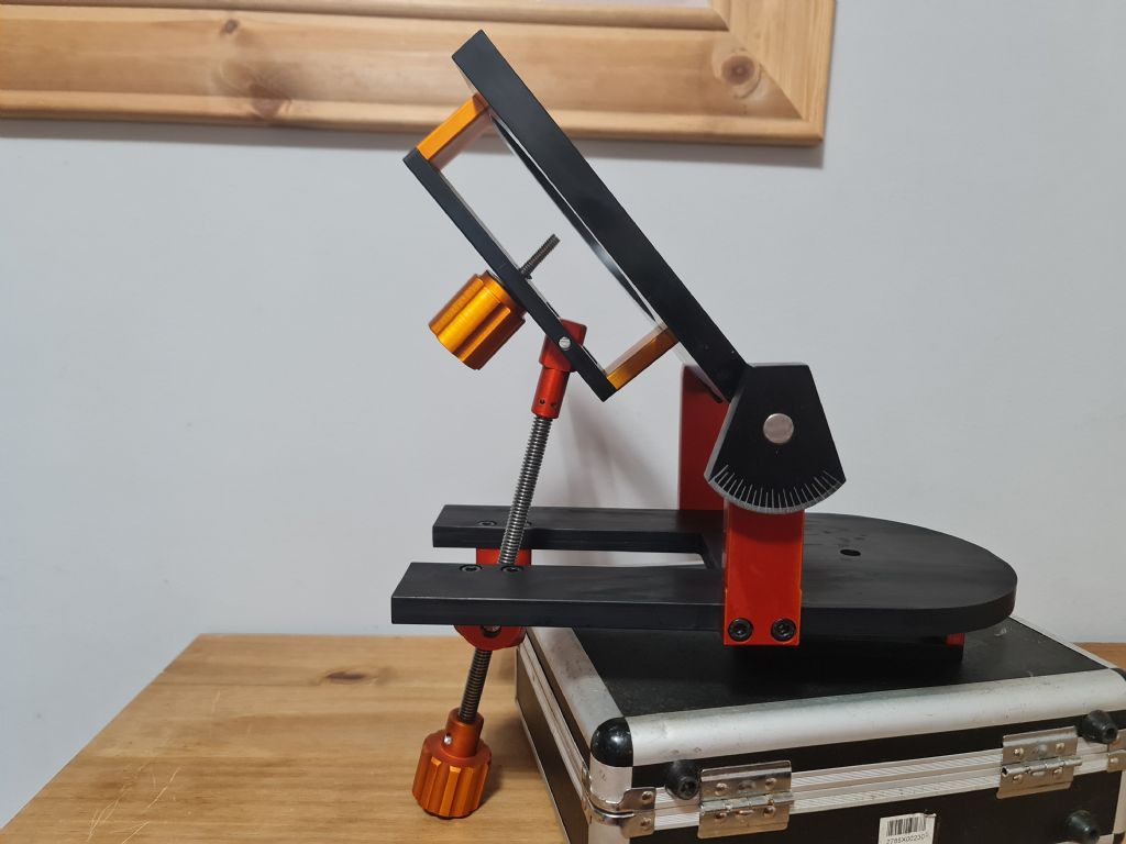

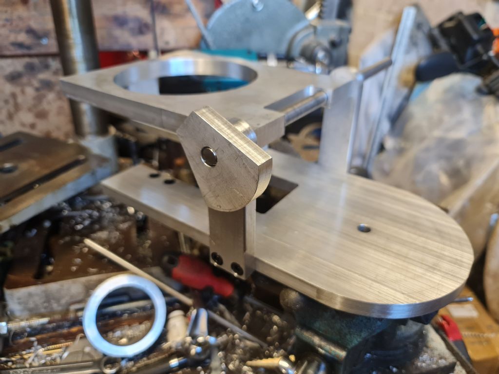

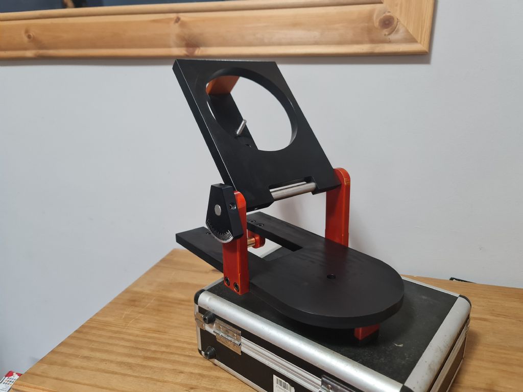

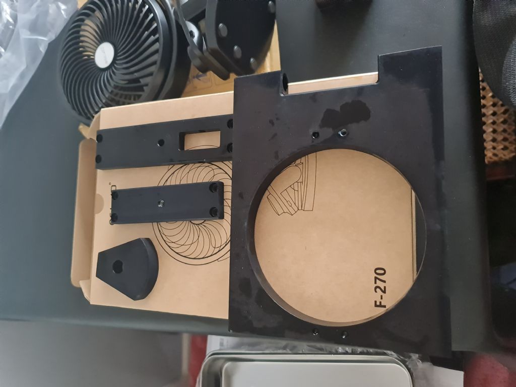

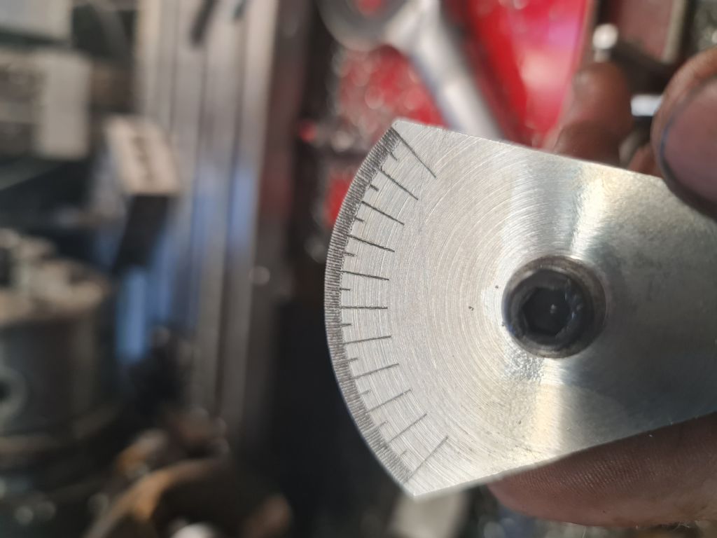

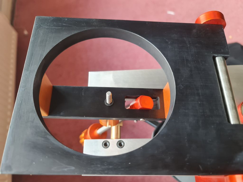

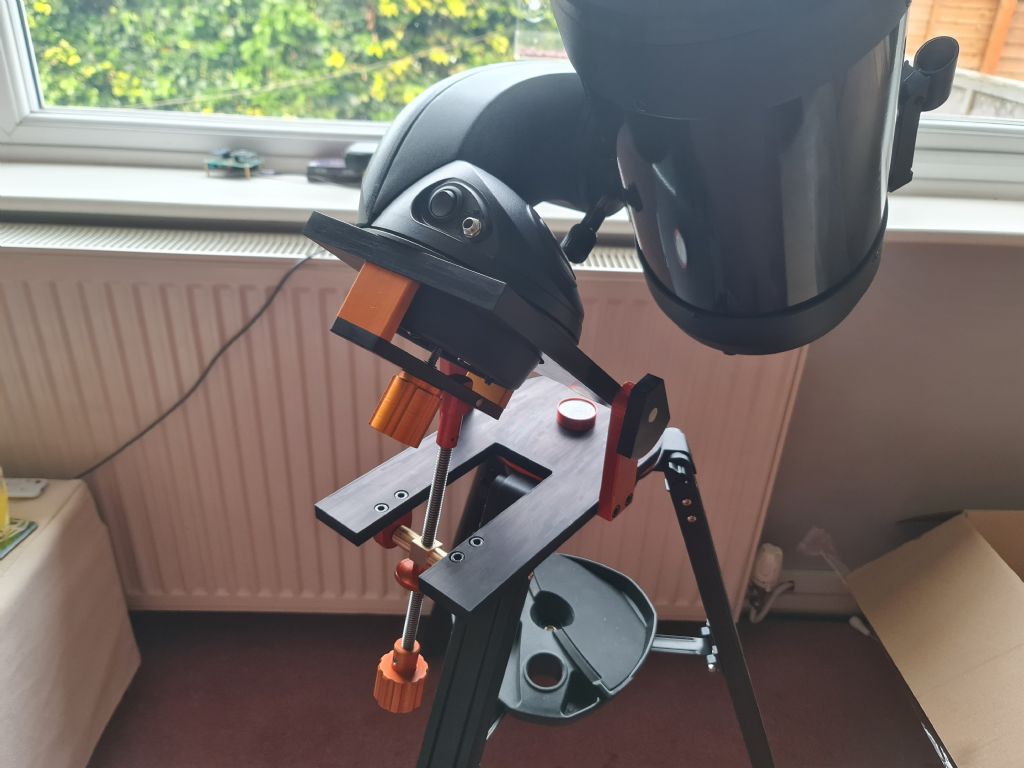

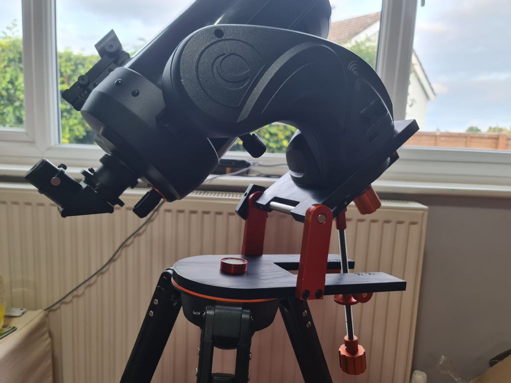

      For the last few weeks I've been making a telescope wedge for my Celestron telescope. I've been filming the endeavour for Youtube in both Welsh and English. I've never made such a lengthy series of videos and tend to write things up on my WordPress site.
      Anyway, here are a few photos from the build. I hope it works when we get a clear sky.

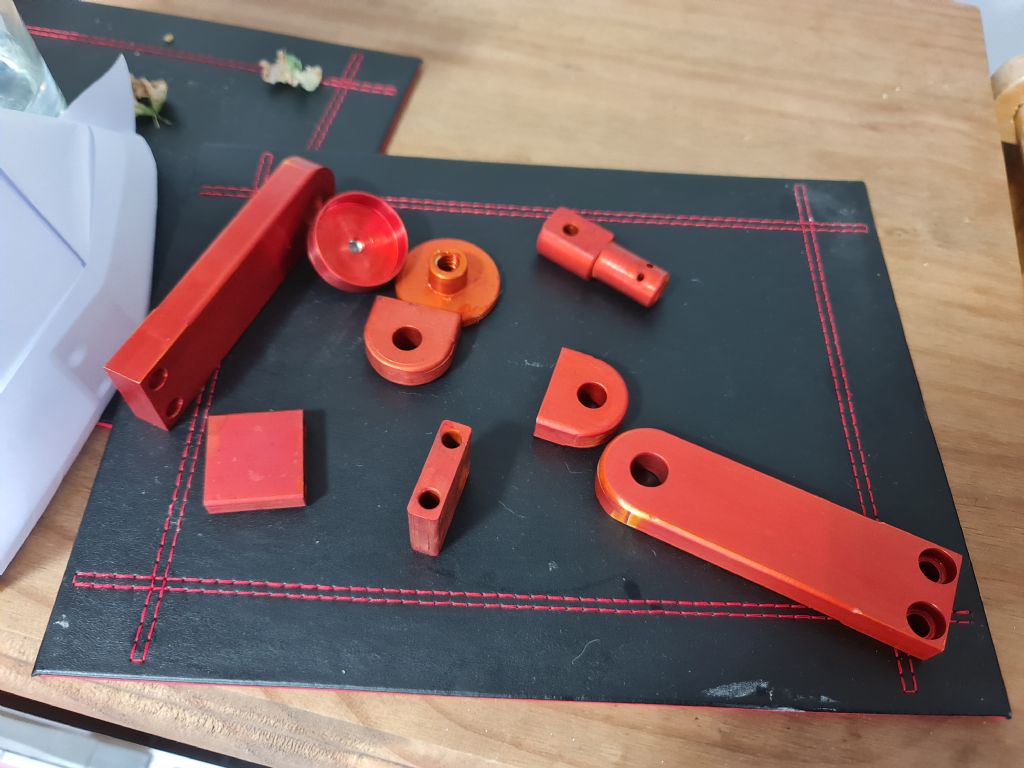

            Looks very nicely made, and the anodising really sets it off
            Well Done!

              Well done and a good anodising result.

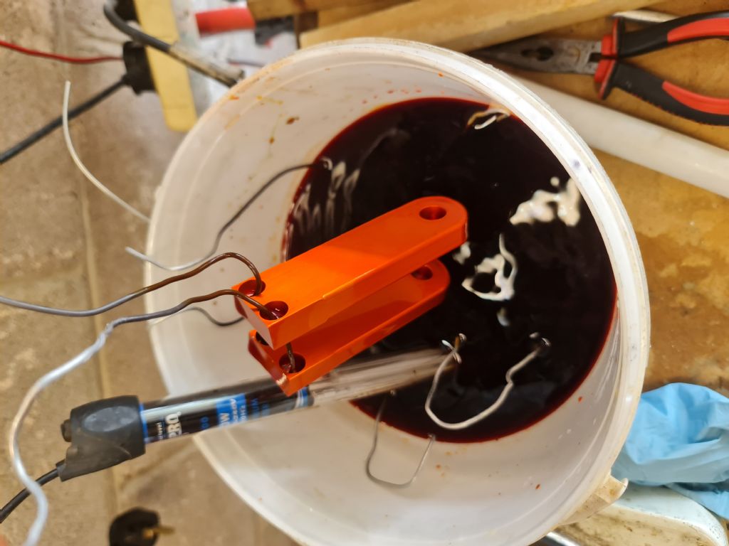

                Thank you Howard, Huub. The anodising really does complete it, I think I need to spend a bit of time trialling a variety of polishes, grinds, brushes etc to see what results work best.

                  Excellent work as befits a scientific instrument, really matching the telescope and tripod !

                    Thank you Nigel. For some reason I designed it to be red and blue. I'm glad I changed my mind 😂

                              Hi Gaz,
                              Late reply to this and very nice work and a very well turned out project.
                              How is the anodizing bearing up and could you detail more of your set up?
                              I’m putting together a set up myself but only have 5L of battery acid and it is difficult to get more. I have run through getting an EPP licence to the stage where the home office now want to send out a counter terrorism security advisor to assess my property.
                              I’m guessing you already had your sulphuric acid?
                              Thanks

                                Damian,
                                In my experience Sodium Bisulphate is just effective as Sulphuric Acid for home anodising and is readily available here in the UK.  I have used both and find no difference.

                                    Hi Damian,
                                    Thank you very much! The anodising is holding up well thanks!
                                    I was able to get the supplies from Gateros plating quite a few years ago (probably 10) for the bath etc.
                                    I did top up the sulphuric acid a few years ago when I bought a motorbike battery and had some extra acid left over. I’ve had a few batteries in the post since which came pre filled so I’m assuming they aren’t allowed to post acid in containers anymore.
                                    I cant remember the quantity of acid involved however if you have 5L, you would be able to have a significant bath or plenty of refills over the years.
                                    All the supplies live in my unheated garage and give good performance whenever I use them.
                                    As far as the set up goes. All the acids etc get put into a suitable container for what I’m coating. the dye will get warmed either on a hotplate or with an aquarium heater.
                                    The acid is agitated with an aquarium air pump with a coil of tubing with some holes poked in it. the coils get weighed down with some lead strips.
                                    Hope that helps.

                                        Nice one Gareth, that looks really good.. Yes, glad you changed your mind about the colour!
                                        Does it work as well as intended?
                                        Got something to watch on YouTube later too 👍🍻

                                          Taf, it does work better than without it but it still isn’t as good as a proper EQ mount would be.
