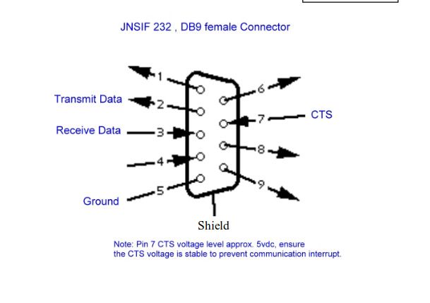

      I got a TECO inverter for my mill, never being one to make things easy for myself I opted for the RS232 cable rather than the speed control knob.
      I laid out a circuit board with an RS232 connector, IBM style, but the TECO manual was very squiffy on wiring detail so I took the adapter apart.
      I will be relaying my PCB to have a dual op-amp where the RS232 used to be because nothing else makes sense face 22
      I think this is the programming manual, curious because it only lists RS-485 and RS-422, plus it's at tecowestinghouse.com but Firefox won't go near it, it is somehow dodgy link

            At risk of teaching Granny how to suck eggs, this 7300 CV manual is the paper manual that comes with the inverter, I have that.
            If you buy the inverter with the RS232 interface cable you get one without the speed control knob on the front panel and absolutely no clue as to how to talk to it. I think they presume nobody would be stupid enough to buy it if they didn't have some third party software to drive it.
            If you moan at them they send you a weird program that tries to interface you with the inverter. Possibly talking to it as a PID because that is the language they assume you speak.
            I have this crazy idea that the inverter is the 7300 PA, the PA-C is a card inside that allows you to plug in various devices to control it and the PA-C communication manual is how to talk to the inverter at base level using the communication protocol of your choice.
            I could be wrong but I need the connection before I can say "Hello world" and see if a voice from the darkness answers back smiley

                        I could try, but what about the RTS pin where it expects 5 Volts to drive the RX pin?
                        If I had a 1488 line driver with access to a +-12V PC PSU then I expect it would work. However I only have 100mA of 5V being squeaked up and down by a USB to serial adapter.
                        I think I need to lay out the PCB so I can hardwire RTS to a hard 6 Volt rail laugh
                              Try it and see. RS232 implementations have always taken a slack attitude to the standards and most modern kit (I think) will work with 5V logic levels. Quite likely to ignore RTS/CTS & Co as well.
                              When RS232 first appeared it worried about driving 1950's electro-mechanical devices like tele-typewriters over noisy wires. Electronics didn't take long to remove the need for lots of volts and milliamps, and clean up the signals.
                              The standard covers 20 or so control wires, most of which are rarely used. Over time the interface has tended to simplify by ignoring most of them. Modern chip sets may be brainy enough to work out what's needed without using any control lines at all.
                              Wiring up and getting the volts right can still be problematic because implementations vary but there's a good chance the electronics will sort it out, perhaps firing up with only 5v logic RX, TX and GND. Older gear is much more likely to be fussy than new stuff.
                              Tecos documentation suggests their RS232 is simple, ie straightforward. Assume it's easy unless it doesn't work!

                                  A useful frig on RS232 is to link pin 4-6 and 7-8 to satisfy the handshake lines. As these are not through wired on your cable they may already be wired in the moulded end. The other trip up point is the Tx and Rx are often crossed despite what the standard says. A breakout box is most useful for troubleshooting RS232.

                                    Perhaps they did – I don't see anything asking for an external power supply? Are you trying to make the whole option unit, rather than just use the RS232 port that it provides?
                                    The DB9 connector on the option plug-in looks simple enough and there's a note saying CTS is 5V.

                                      Pin 7 on a db9 would be the output pin RTS. To make it high you have to set RTS=0 in the UART. The output then drives through what I take to be a 1n4148 glass diode before powering a PC400 isolator.
                                      The TX line back to the inverter looks even less friendly. When they want to light up the opto-isolater on RX they drive through a 470R, when I want to light the other side I have to drive through a 2k43. I can see that coming out dont know

                                        The unit clearly ignores CTS/RTS as it only has RXD/TXD wired up.
                                        If the PC adaptor uses an FTDI chip it should generate enough on CTS to work the optos.
                                        Keeping the optos seems a good idea to me. Potential(ho ho) to get quite a voltage from inverter to computer if there's a ground loop.
                                        However baud rate is set at the inverter, the PC still needs to be set to match, experience shows that trial and error takes a long time…

                                          I drive TX with an op-amp wired as an inverter, an easy way to get 5V to light the TX LED.
                                          I handle RX with a comparator wired the same way. The processor pins are 5V tolerant but why take a chance?
                                          I hardwire pin 7 to power.
                                          Simples smiley
