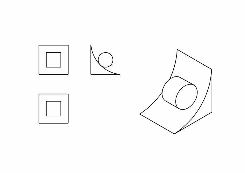

                        #67475
                        Sam Stones
                          @samstones42903
                          Gentlemen,
                          Nick has shown us the side view of the simple test and, with his rather faint construction lines, how to get there. Always assuming that you know about these things.
                          There have been suggestions too, that there are many other possibilities (than just Nick’s solution). No doubt we’ll (mostly) agree to these alternatives so long as they do not contradict the two primary (FRONT and PLAN) views.
                          However, after too long and a distinct loss of kudos, I can hold off no longer, so here are my two.
                          Regrettably, when I came to use the built-in (software) switch to `convert’ from three dimensional to two dimensional, the settings for `view alignment’ were for third angle projection. On this occasion, changing back to English projection did not appeal to me.
                          I’m not even sure if the isometric view is the right way around or in the right position, but at least it fits neatly into the empty space. Leaving as is, does offer further debate.
                          I still find great delight in viewing drawings like the clock/watch lever escapement which I introduced a few pages back.

                          #67478
                          John Olsen
                            @johnolsen79199
                            If you take the curved solution, there is an infinite series of curves that meet the necessary constraints. For instance if you imagine the curve as shown but just flattened a little, it would still work. The curves that are possible solutions must not create any hidden lines, for example by bulging out too far, but within those constraints there is in fact an infinite series.
                            regards
                            #67479
                            Sam Stones
                              @samstones42903
                              I wish I had said that John!
                              That’s (perhaps) where centre lines become necessary.
                              In years gone by, shading of round(ed) parts was normal practice, and which served to make ones drawings `come alive’.
                              Sam
                              Edited By Sam Stones on 25/04/2011 07:38:40
                              #67481
                              Anonymous
                                Precisely why I pointed out that the number of solutions is infinite! The curve doesn’t need to be part of a circle, so centre lines wouldn’t necessarily help.
                                Regards,

                                                    #67640
                                                    Steve Garnett
                                                      @stevegarnett62550
                                                      I think that this is my personal favourite solution so far:
                                                      Apologies for the only approximately correct (and oversize) isometric projection – it’s only to give you the idea.
