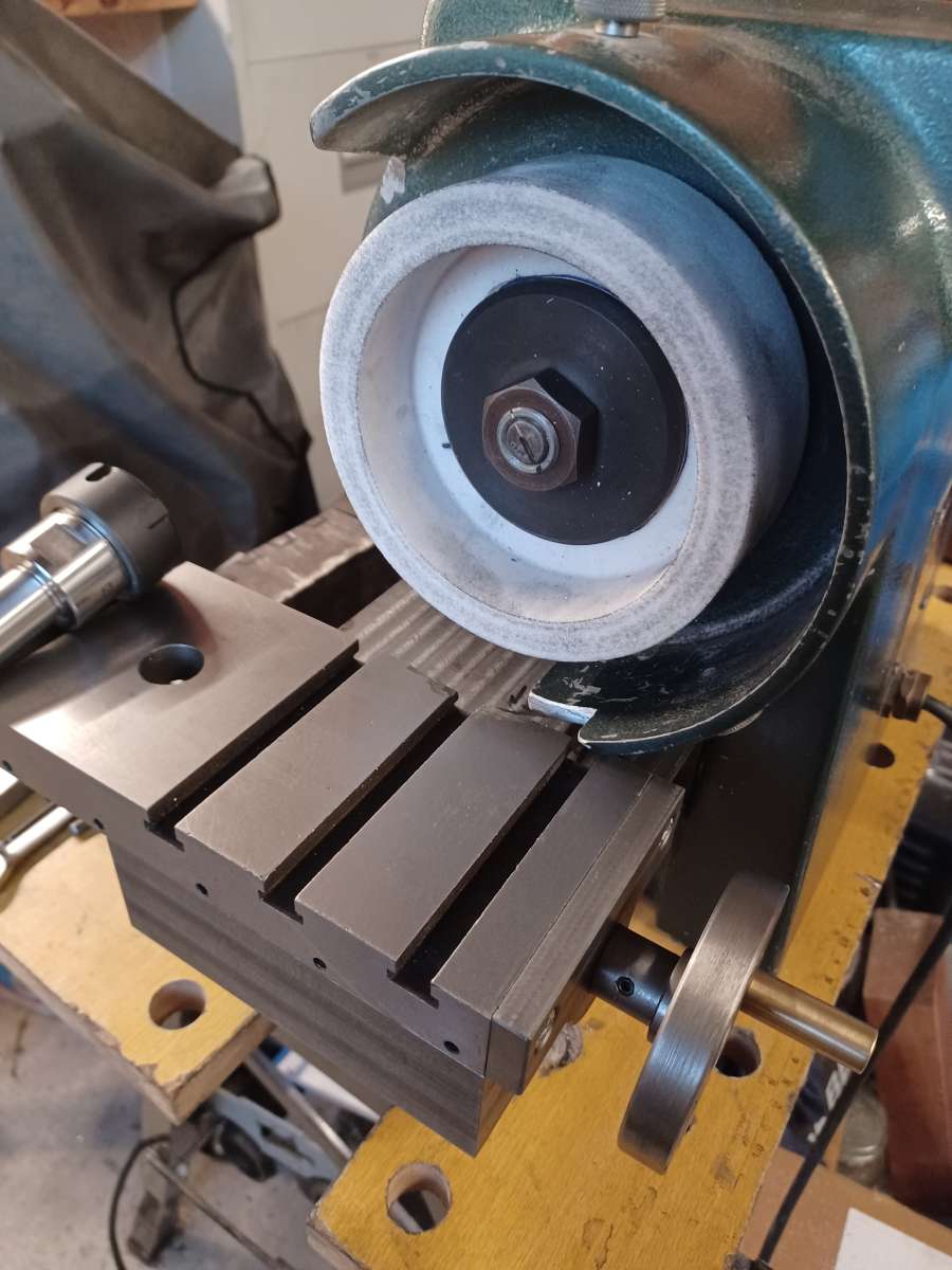

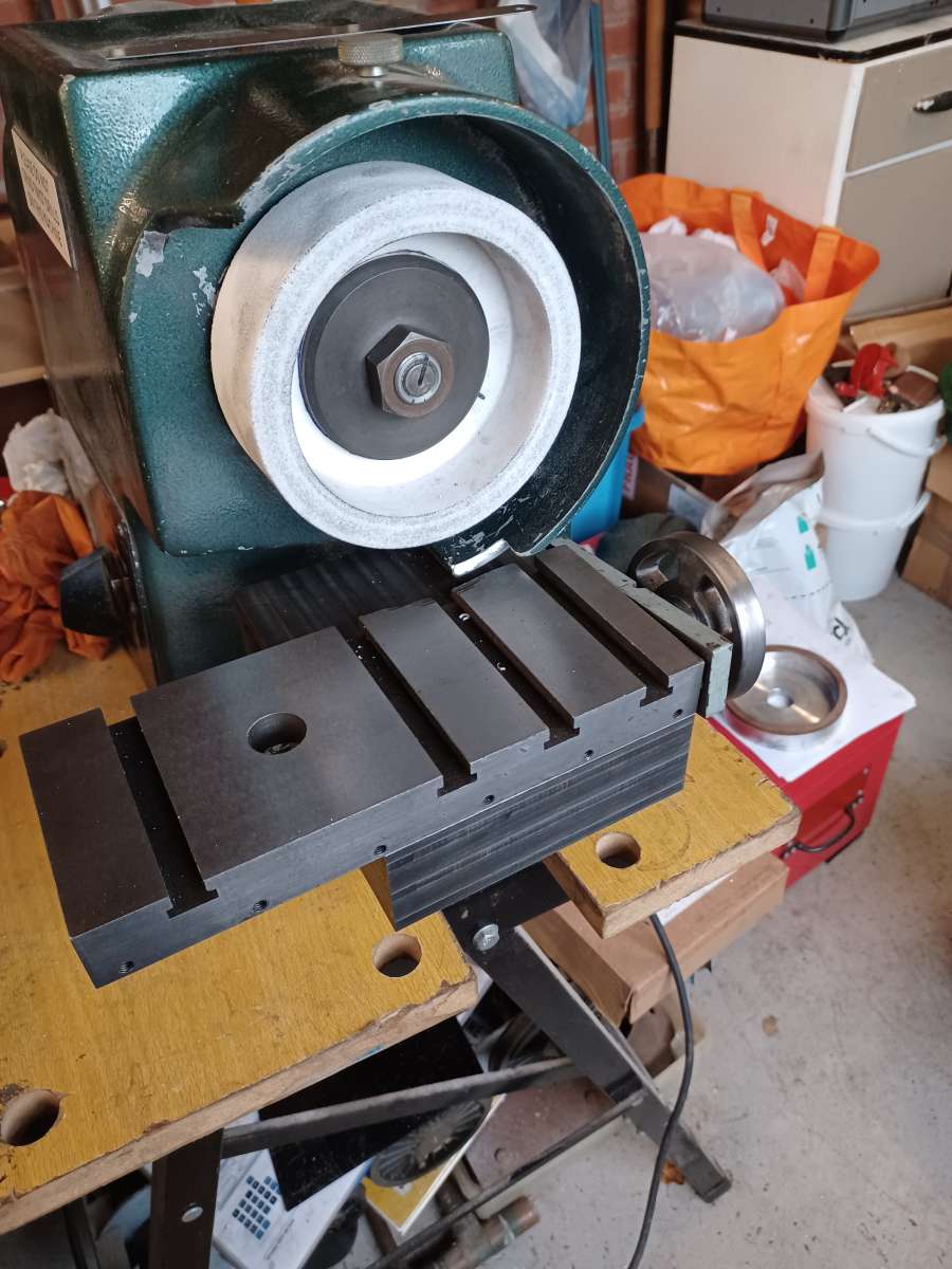

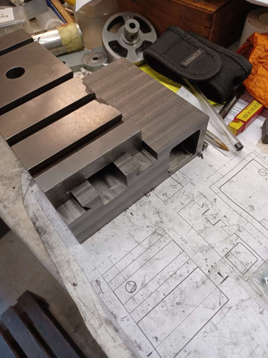

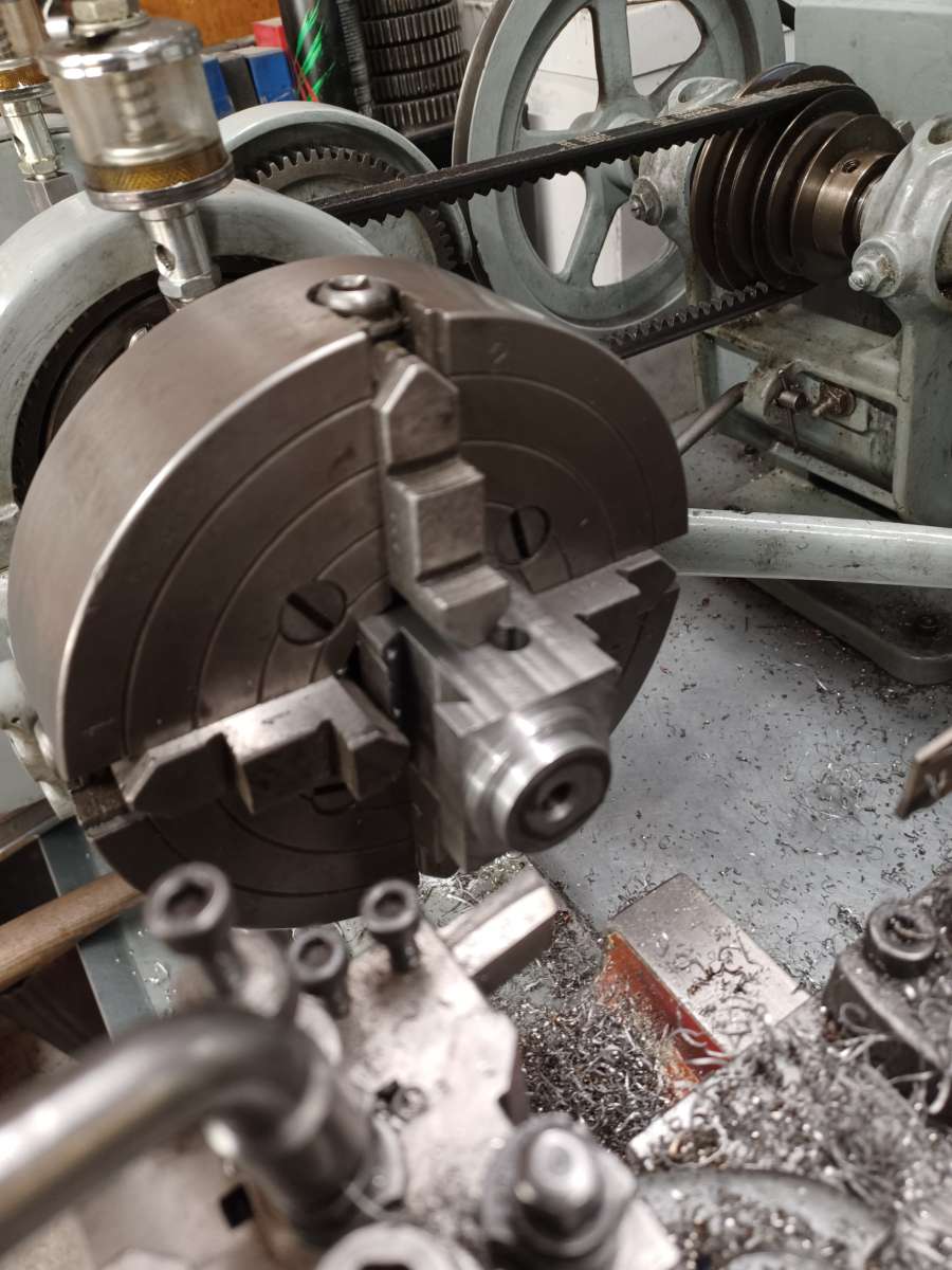

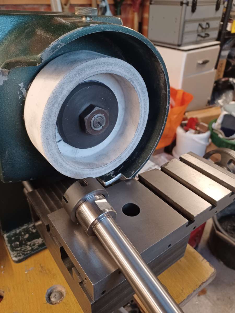

      Taylor hobson tool and cutter grinder modification.
      I have a cutter grinder which I did asimple modification by putting on a table which i used to sharpen turning tools and sharpen inserts.  Recently I started to think it could be also be used to sharpen cutters.
      I started by Looking for a table and found a Myford 7 cross slide at the Midlands show and set about making a support bse to bolt on to the side of the grinder. I bought a chunk of cast iron and milled it square and flat before milling in a dovetail for the top slide to slide on. I have a spare 3/8″ leadscrew, handwheel and a collet set with a 1/2″ shank to hold the cutters.
      20241109_153002_1
      20241113_085949_1
      20241113_143721_1
      20241119_151619_1
      20241120_144301_1
      20241129_10292220241129_102714

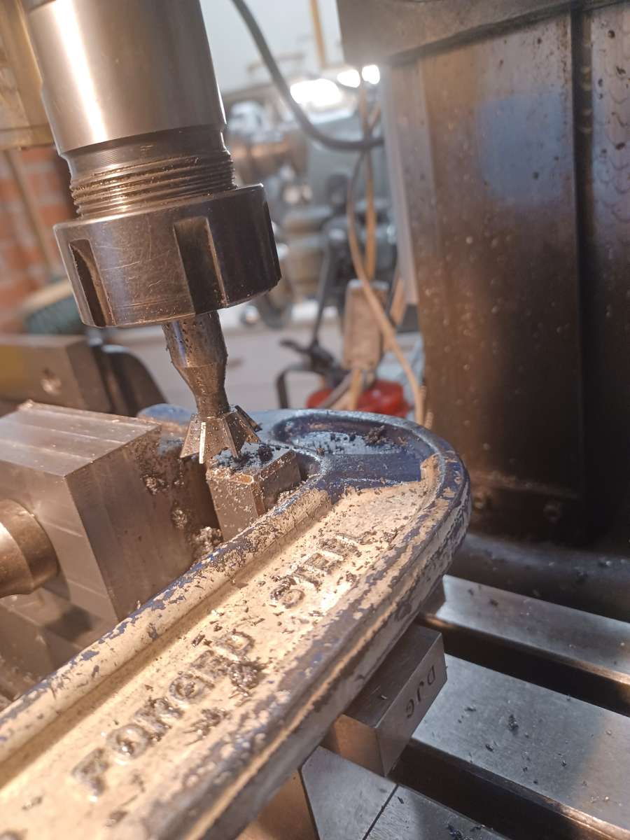

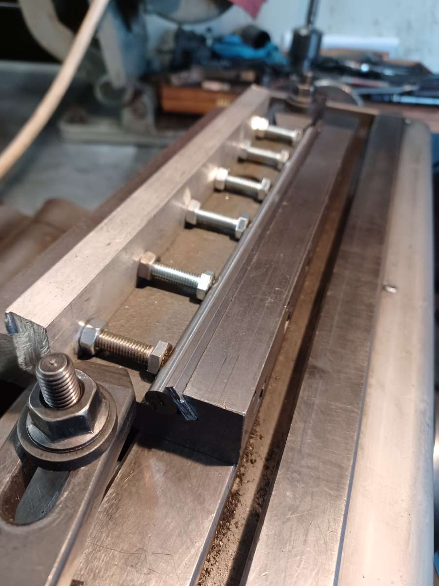

      I used a piece of sijversteel to hold the jig strip i place to cut the angles on the side to match the dovetail 60 degree.
      20241129_145047
      there is a slight damage to the top slide but it is only on one area which will not be used for the tool holder.

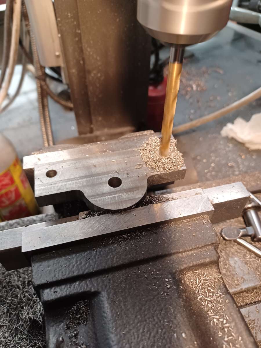

          #767752
          David George 1
            @davidgeorge1

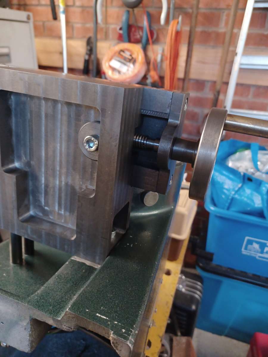

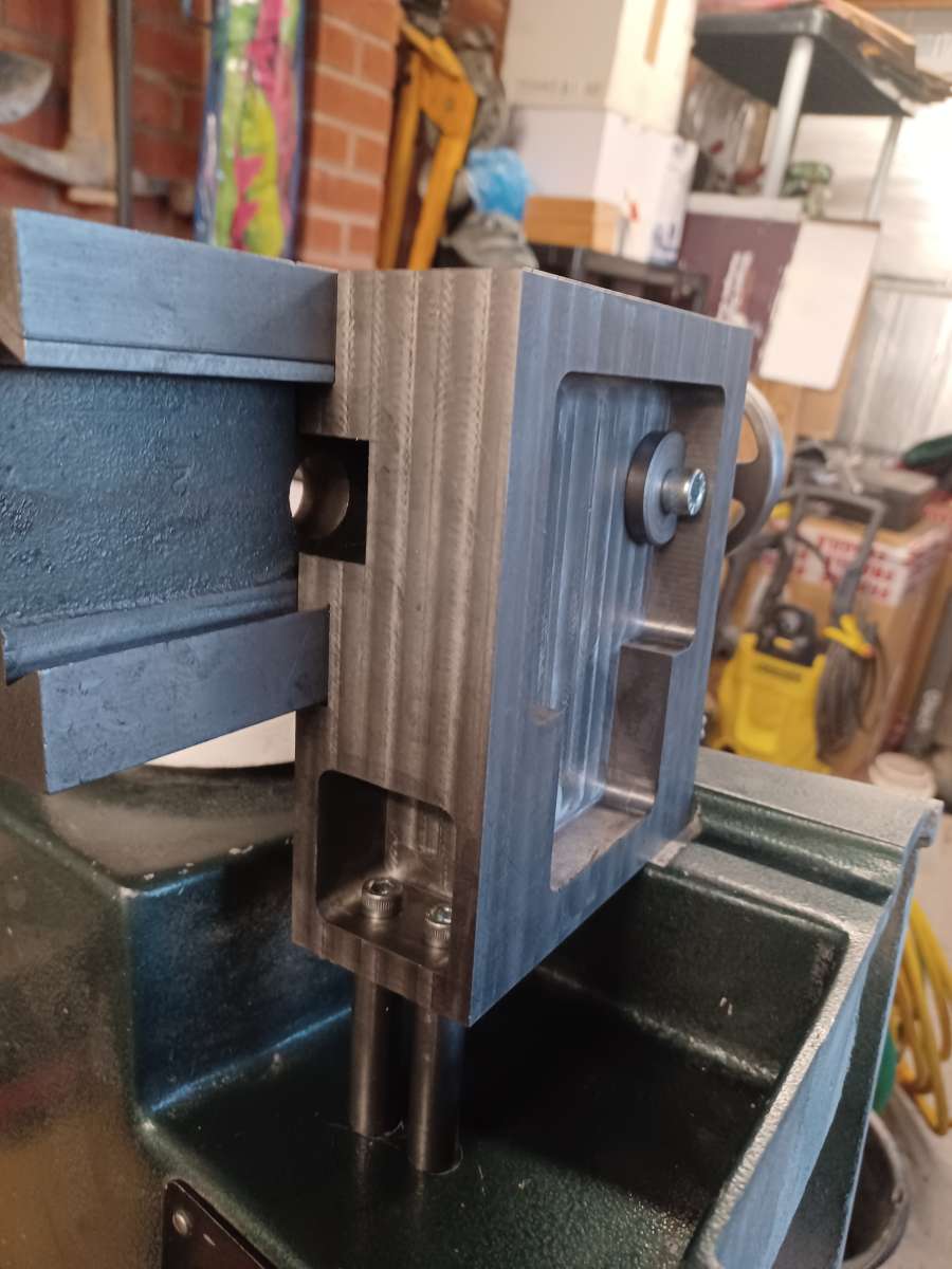

            I have drilled the first holes to mount the slide to the grinder.
            20241130_105851
            I have put the leadscrew and handle in place to see how it looks.
            David

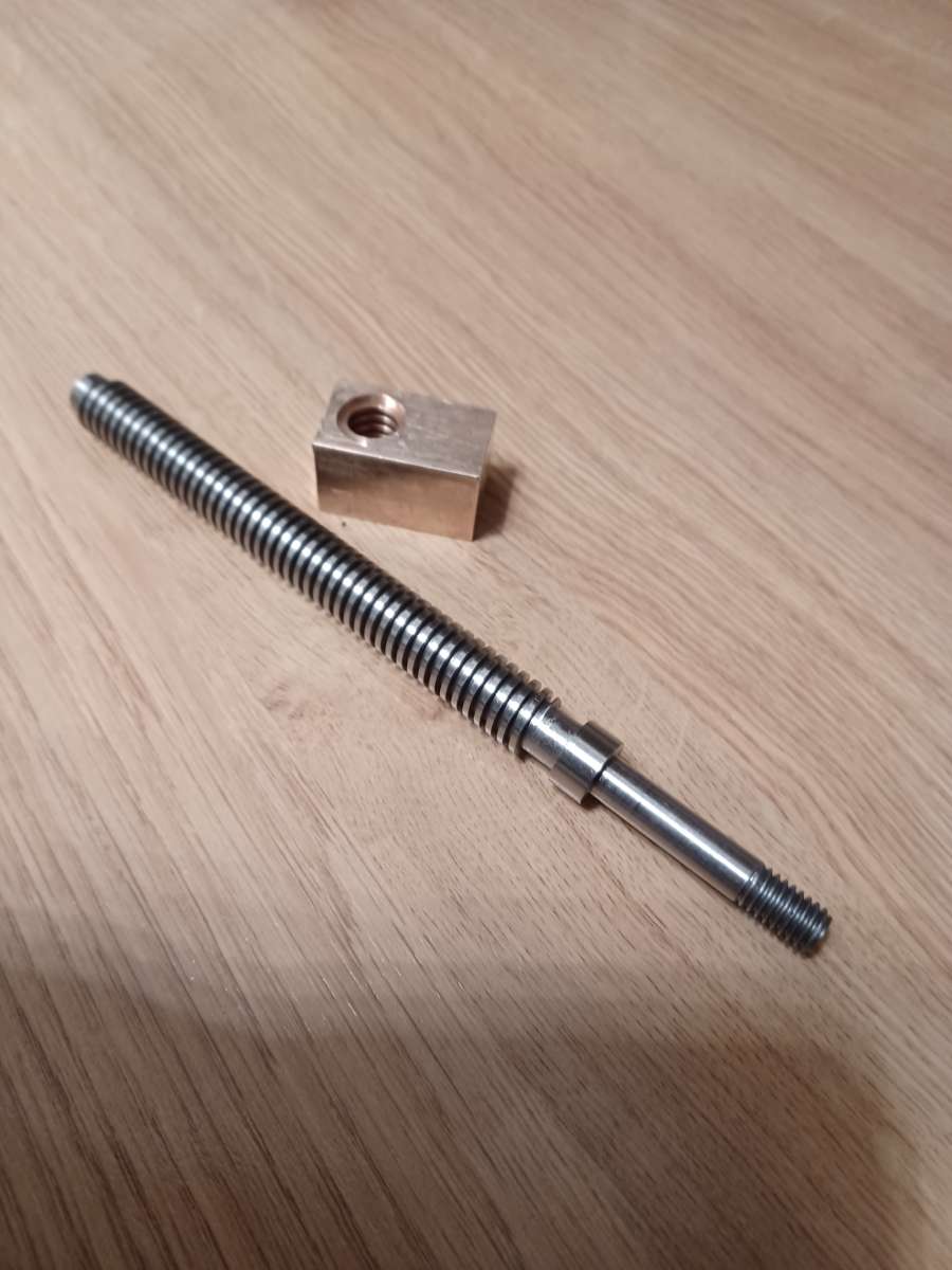

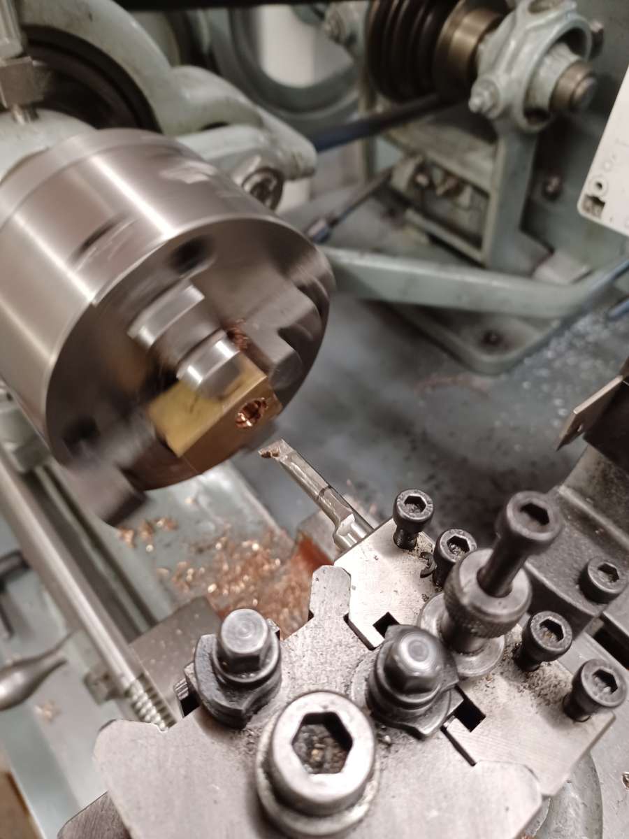

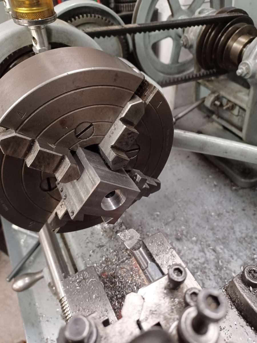

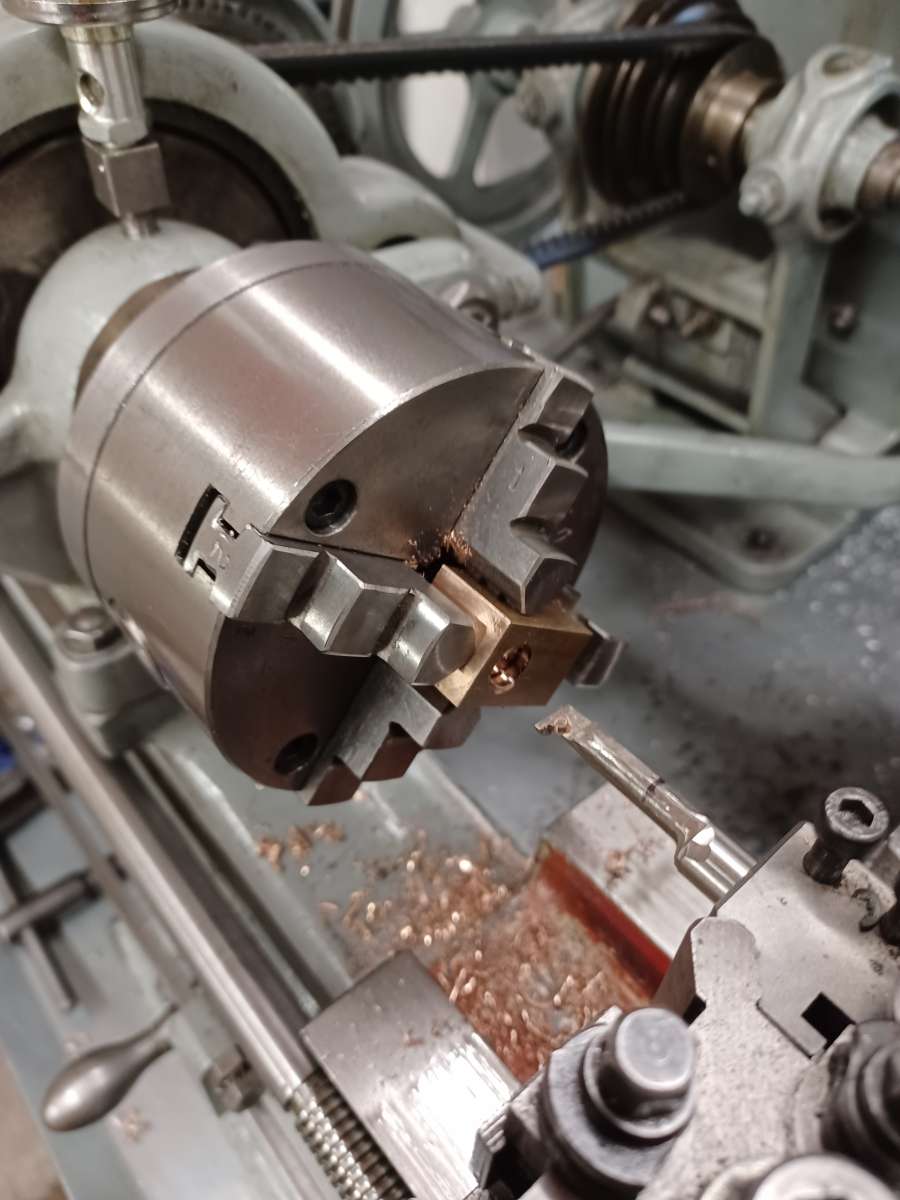

            #768614
            David George 1
              @davidgeorge1

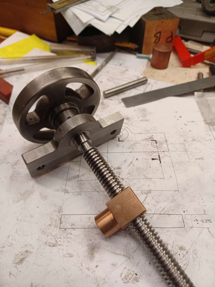

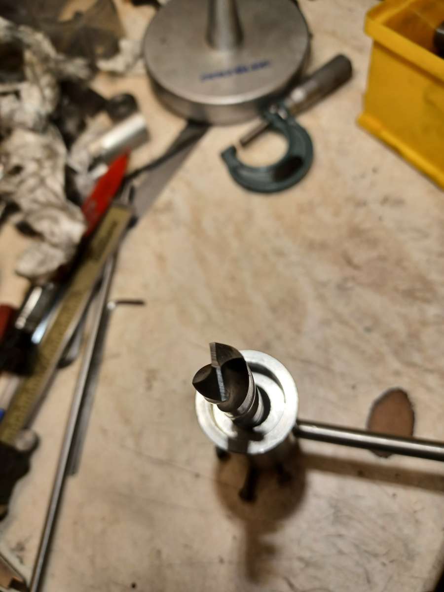

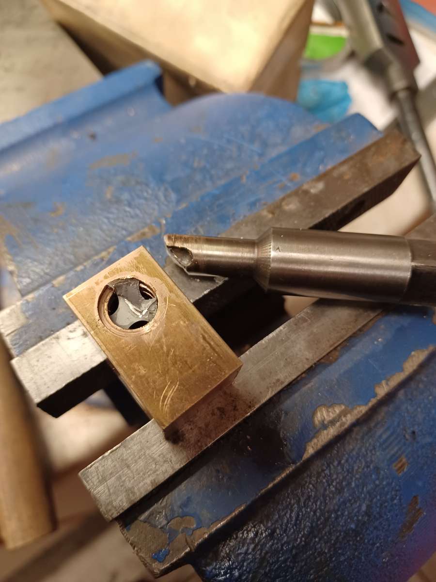

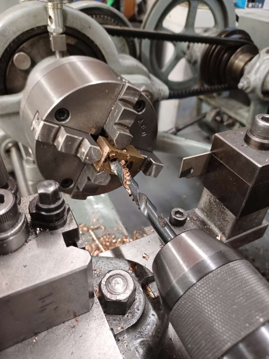

              I started to make the leadsrew nut from Phosphor bronze. It started ok in my self centering chuck with the fourth jar swapped for the fourth jaw external jaw which worked perfect to cut the square thread.
              20241204_085134
              It went well at first screw cutting but when i tried the leadscrew in it was a bit tight and decided to use my home made tap!
              The tap worked fairly well but cutting phosphor bronze was a bit tight and was better but still tight and decided to re tap and the tap broke and scraped the thread in the nut.
              20241204_210754
              Start again!
              David
              #768615
              noel shelley
                @noelshelley55608
                OH DEAR ! David save the nut, I have a good spark eroder and that would make a good test piece. The machine and all it’s bits are in the shed – I need to find/get them out. It may take a while. Noel.
                #768826
                David George 1
                  @davidgeorge1

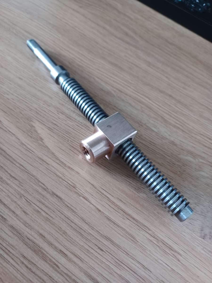

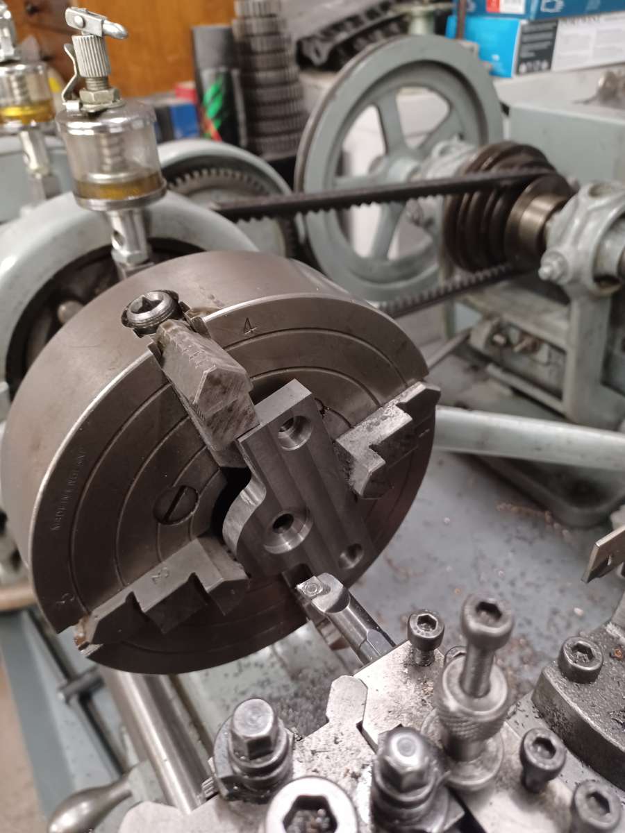

                  Remade the Leadscrew nut. New piece of Phos Bronze and only used the form boring bar as Tap smashed.
                  20241205_084116
                  20241204_085114
                  20241205_163306
                  It took a while to cut the thread as I didn’t have a tap anymore.
                  David

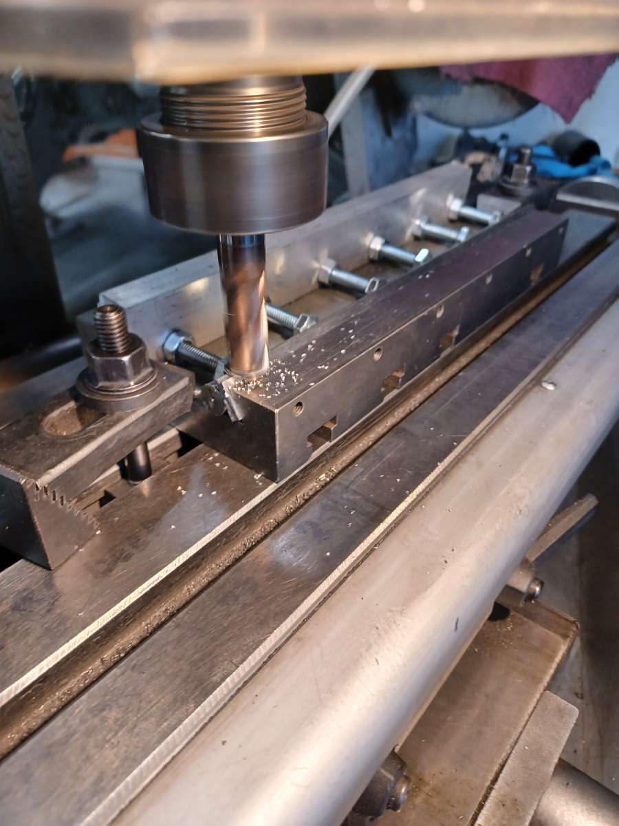

                  #768883
                  Nigel Graham 2
                    @nigelgraham2
                    Interesting work!
                    Neat tip on how to machine the gib strip bevels.
                    A shame about the broken tap. Is it alum solution that, if I remember rightly, will slowly corrode the tap away? I have used it once, and it is a slow process.
                    #768885
                    bernard towers
                      @bernardtowers37738
                      Keep the alum solution warm to hot this speeds things up as well as regular flushing

                      David George 1
                        @davidgeorge1
                        finnished the nut.
                        20241206_110858
                        David
                        #768983
                          Big sigh of relief from the audience !
                          … Well done, David

                            Got a while spare from Christmas and other duties and started the end plate for the slide except for machining the counterbores which takes the thrust bearings.
                            1000003088
                            1000003089
                            David
                            #770587
                            David George 1
                              @davidgeorge1
                              I have finnished the end plate for the slide.
                              20241216_161437
                              I put it on the lathe and bored the recesses for the thrust bearings to prevent any backlash.
                              20241216_174513
                              Two needle roller bearings and washers.
                              The next thing is to drill tap and bore the holes to mount the end plate screws, the hole for the end of the bronze nut and the support to go under the table to prevent tiping with more weight on.
                              David
                              #770595
                              Taf_Pembs
                                @taf_pembs
                                Excellent David, as someone has said, I like the machining of the gib strips.
                                As for the tap, one of those moments of the realisation pause on it happening while the colour slowly drains from you, top down, just before the expletives begin!
                                Look forward to more 👍🍻

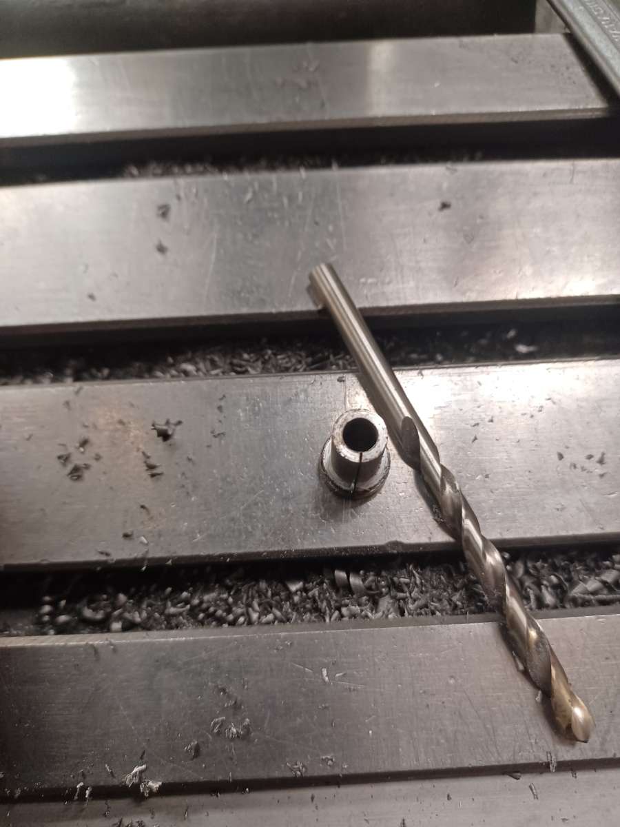

                                #771093
                                David George 1
                                  @davidgeorge1

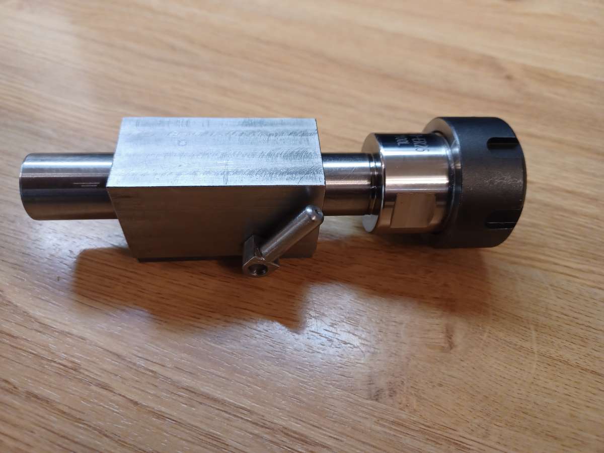

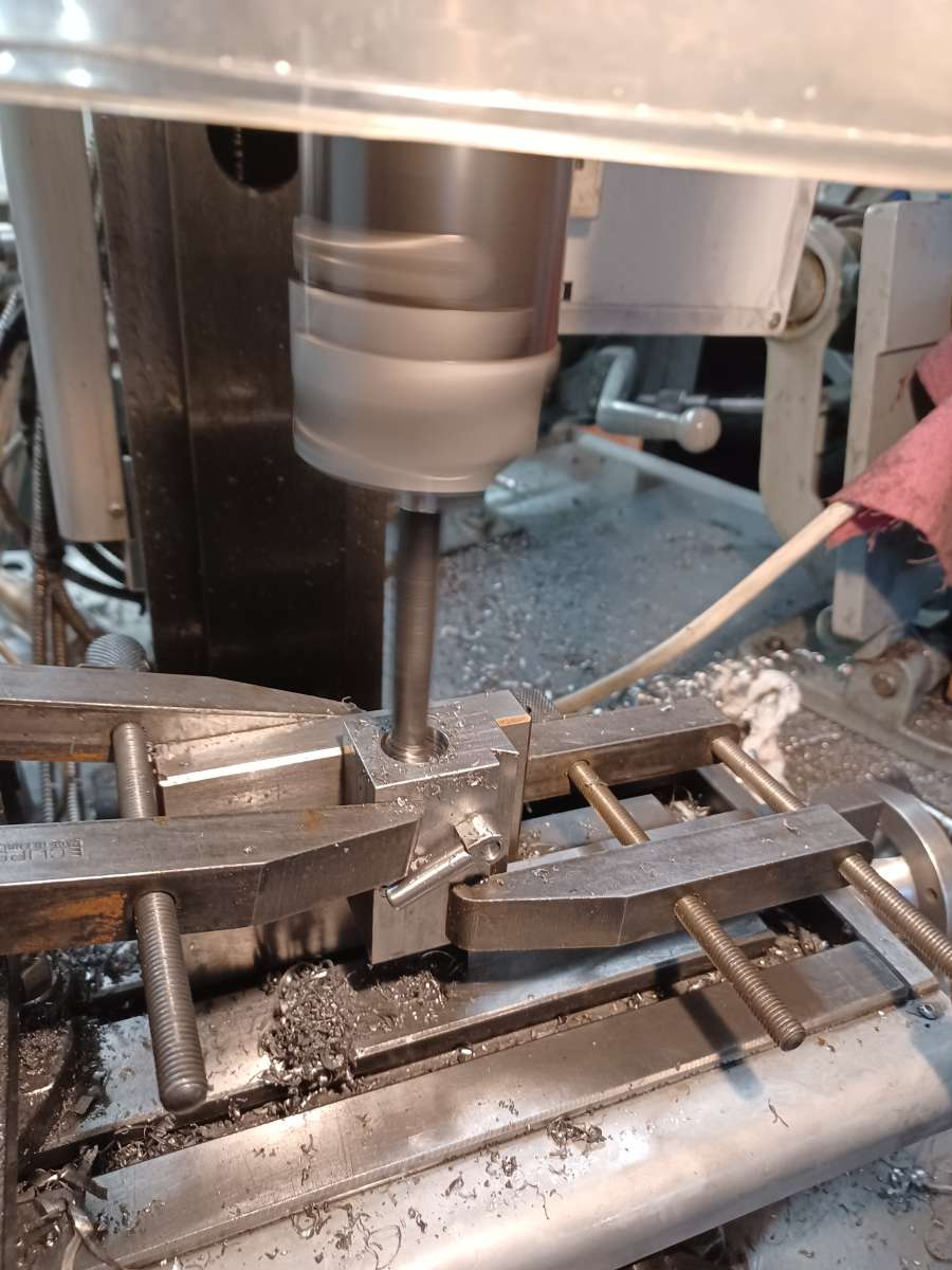

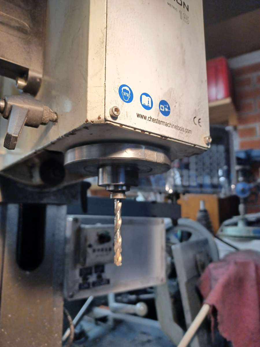

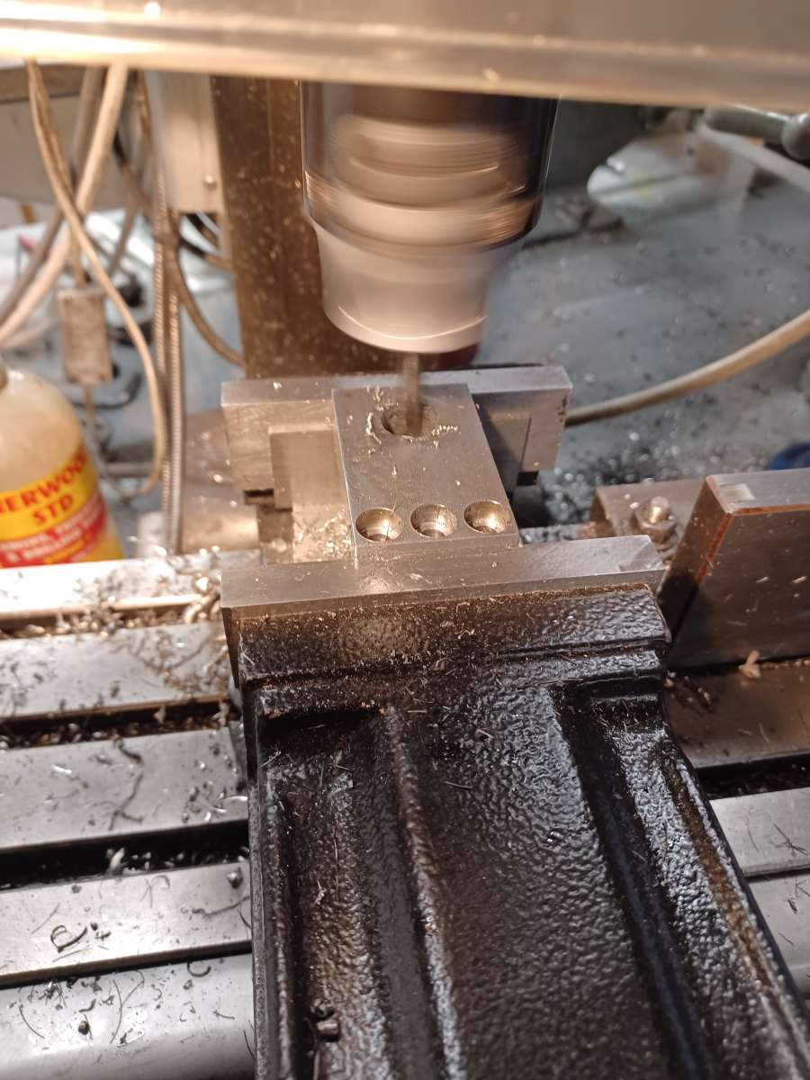

                                  Made the washer to hold the bronze nut in place, Drilled the the Tapped holes in the end of the slide to attach the end plate and assembled the slide which workes well with no play or backlash.  Whilst drilling the end of the casting I struggled to get a drill on to the end of the casting but remembered that I had an 8mm collet to fit the spindle and also a 8mm to 5mm bush which will hold the tapping drill.
                                  20241219_154449
                                  20241219_154651
                                  20241219_154104
                                  20241219_154113
                                  20241219_154519
                                  20241219_154540
                                  All I have to do now is to make a holder for the long stem collet set which is adjustable to hold the cutters to sharpen or make cutters.
                                  David

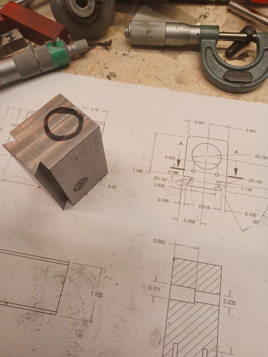

                                  #773035
                                  David George 1
                                    @davidgeorge1

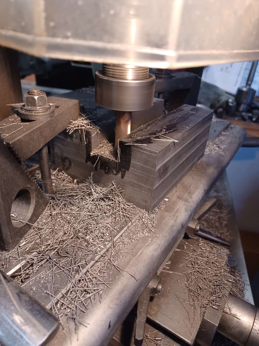

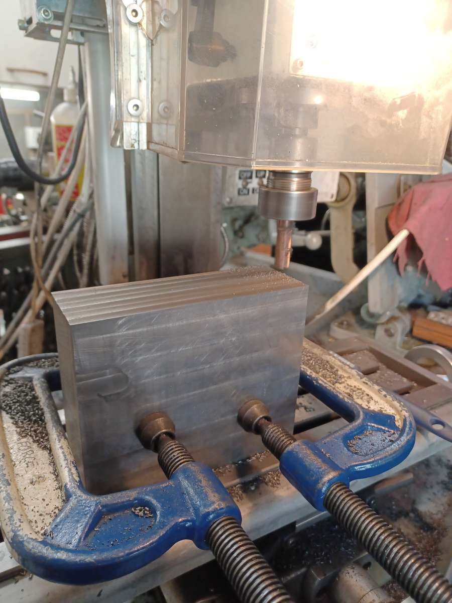

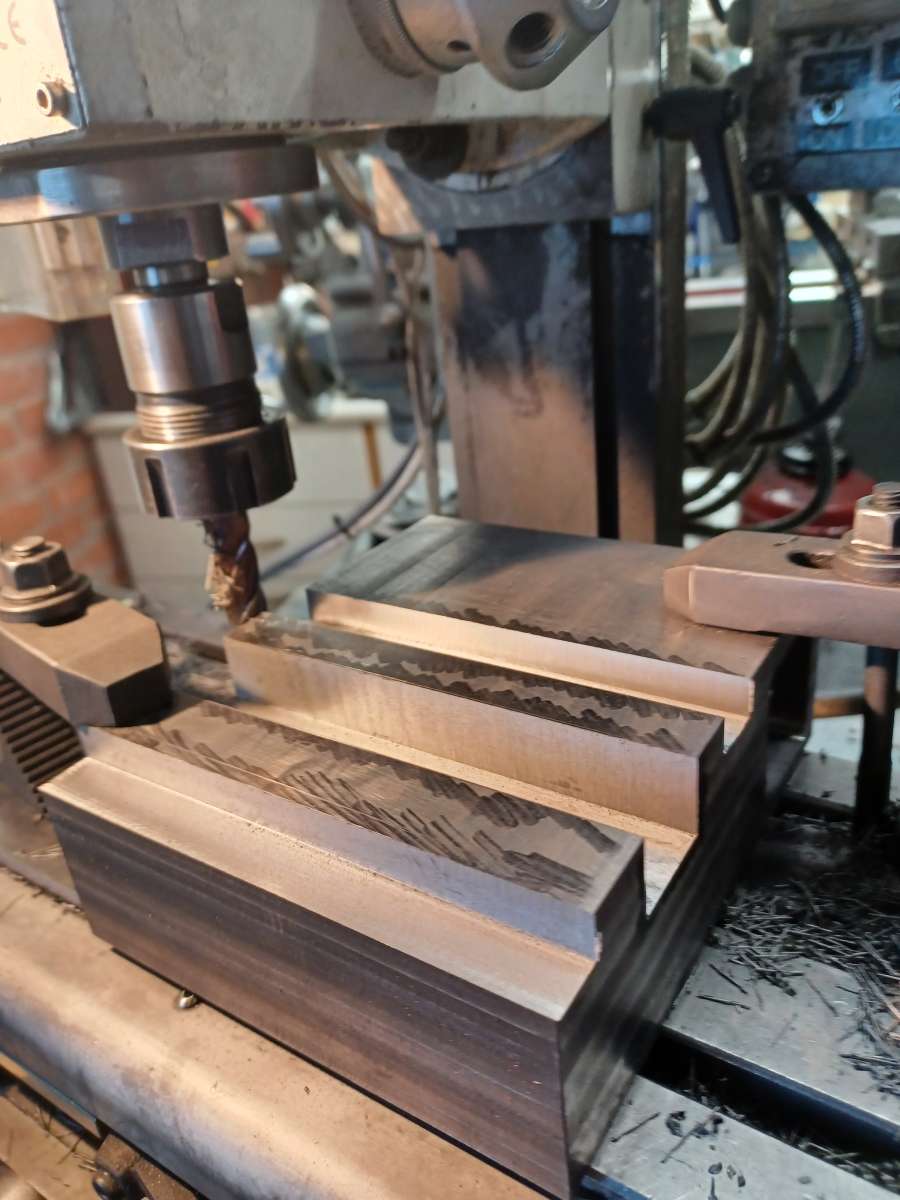

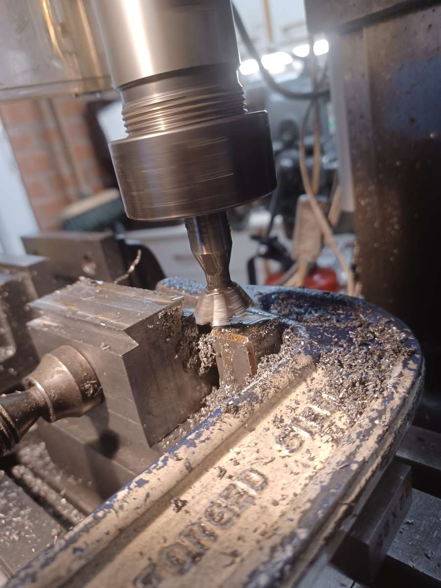

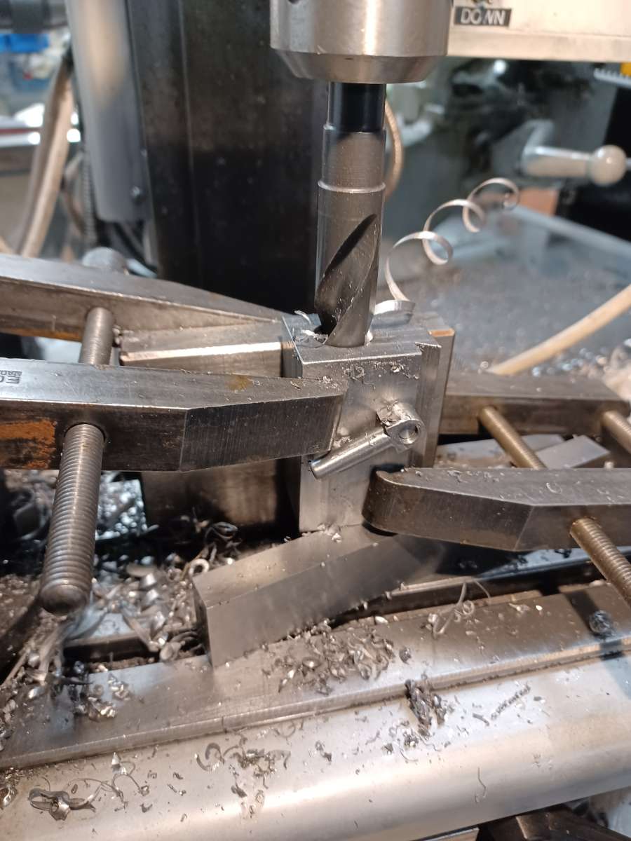

                                    I have started to make the top slide. Blocked up the first part and cut the dovetail firstly. Next cut the hole for the clamp for the tool holder clam so that the hole bored for the collet holder will match the clamp radious.
                                    20241227_145700
                                    20241227_151716
                                    20241227_152808
                                    #773380

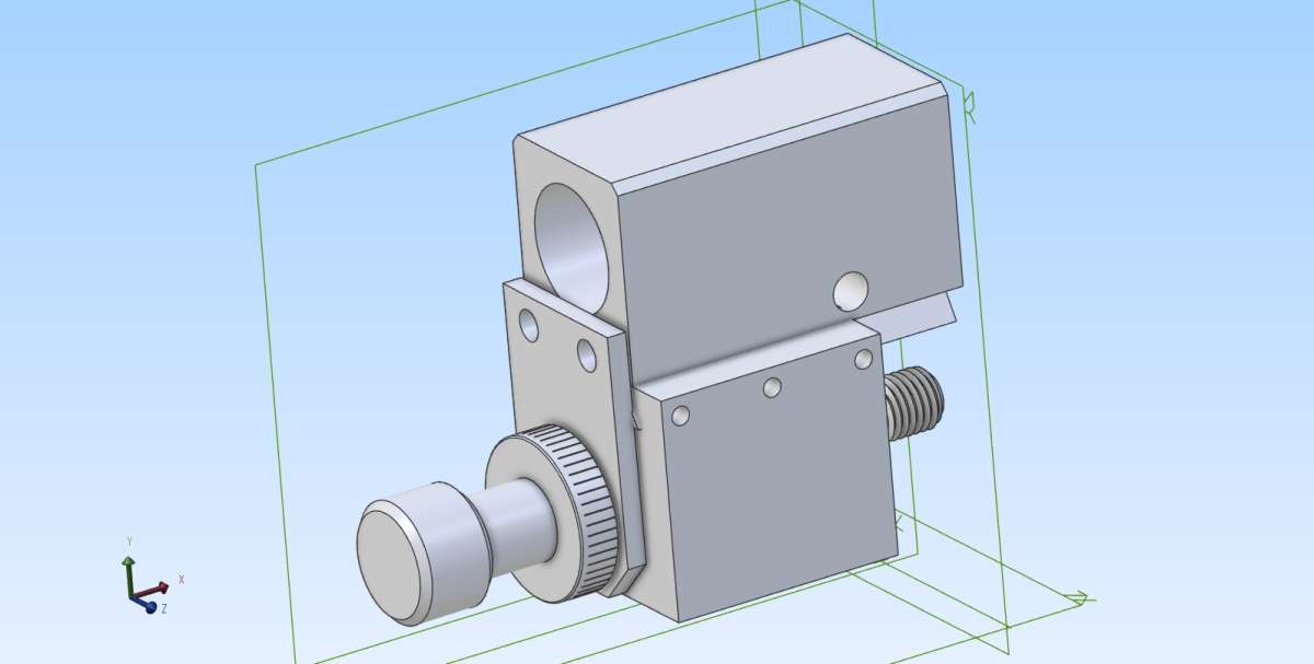

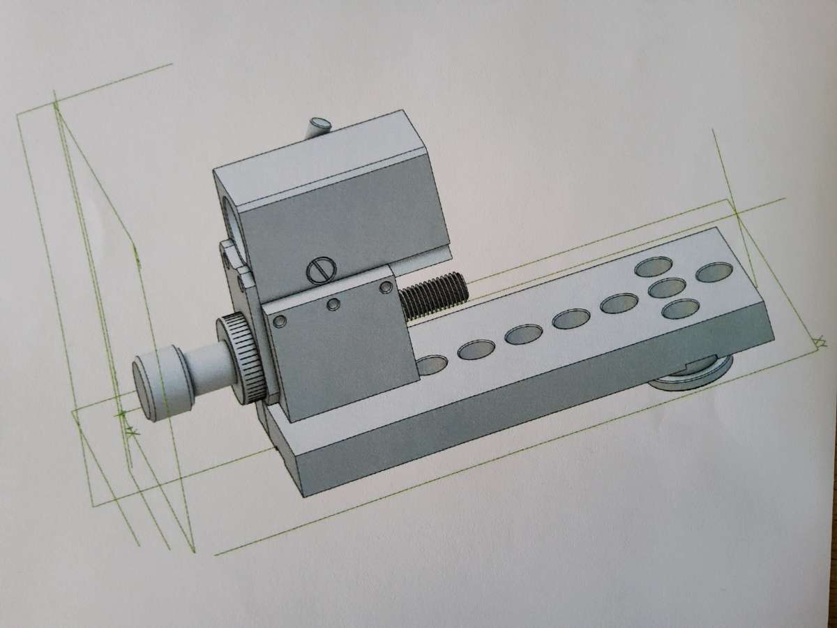

                                      I have been playing with Alibre Atom to do a bit of design on the slide parts but it takes time and at least I have done apart assembly which has shown me a couple of problems which I have, I think, overcome.
                                      Tool grinder mod top slide assembly
                                      David

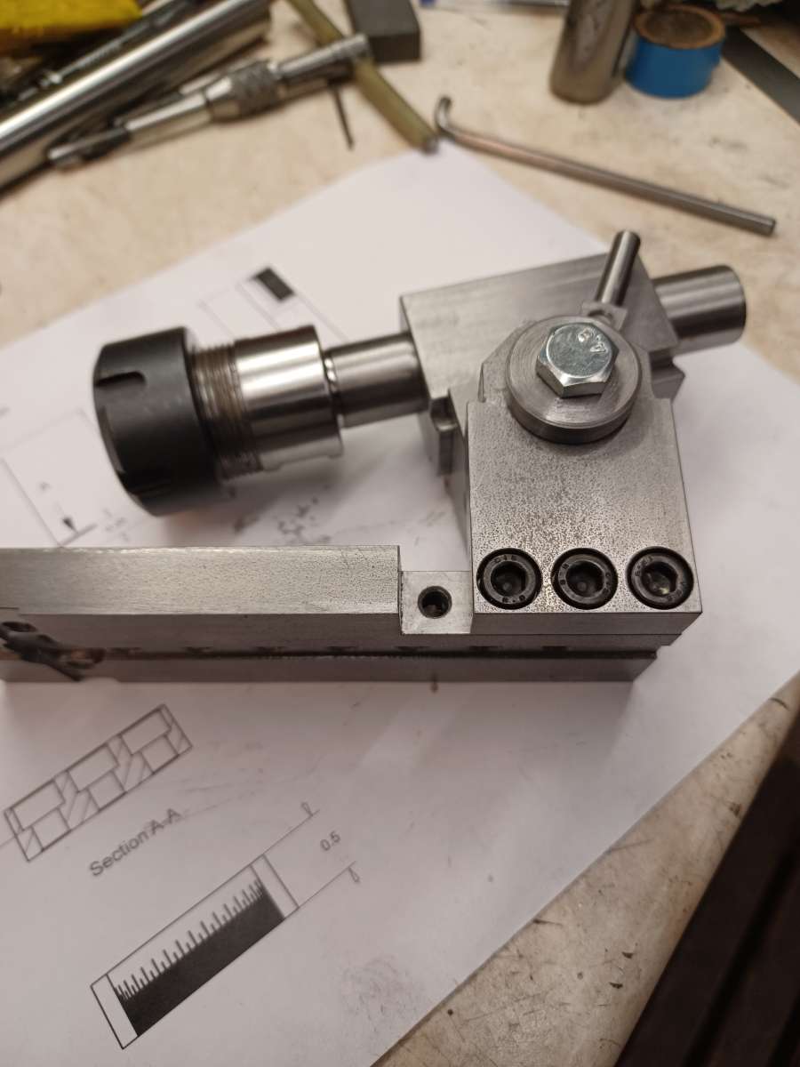

                                      David George 1
                                        @davidgeorge1
                                        I have Fitted the clamp and lever to the top slide body so time to drill and bore the hole for the ER25 collet chuck.
                                        20250101_121017
                                        20250101_143056
                                        it slides with less than a thou clearance and the clamp works great.
                                        20250101_172912
                                        A bit of chamfering and this part is finnished.
                                        David

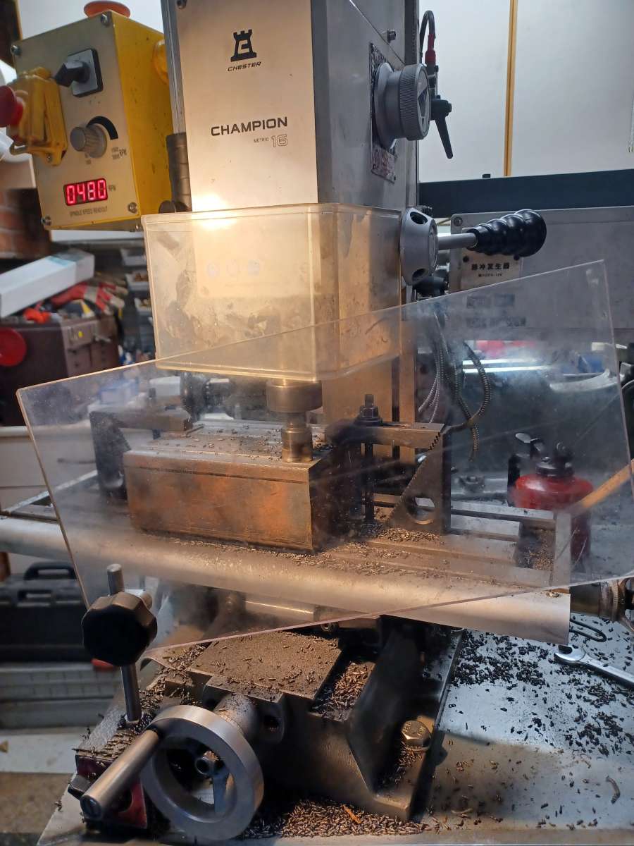

                                        #778188
                                        David George 1
                                          @davidgeorge1

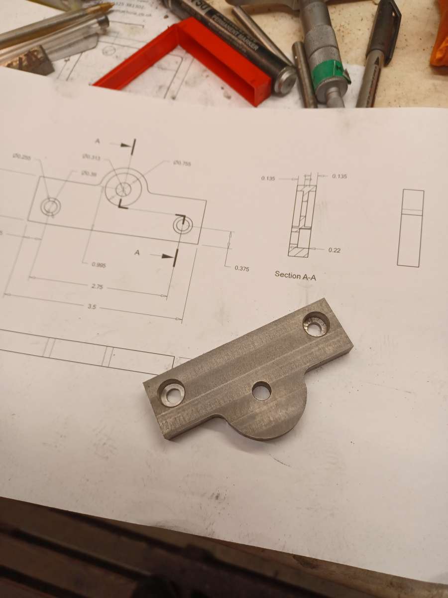

                                          I have been drawing a few more bits for the cutter drill grinder but as it has been a bit cold it has restricted the time in the garage and so have been learning a bit more about Alibre and assembling the models as an assembly.
                                          20250118_101414
                                          Also I needed some more steel and after geting a quote from a local supplier of around £100.0 plus Vat for a meter of 1″dia 1/2″ dia 3/4″ dia at 1 meter long ms as well as a 18″ length of 2″ x 1/2″ ms . I went to Better Metals for same as well as a 12″ longth of 2″dia ms for £62.30  Total.  Much better.
                                          David

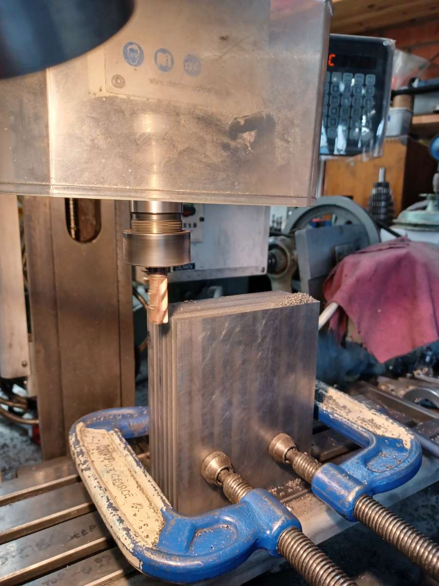

                                            I have managed to get into the garage for a few hours today. I managed to finnish machine the bottom piece of the collet holder. I drilled the hole centers on the mil for the two tapped holes and then mounted it in the four jaw chuck and firstly turn the side diamiter and the location for the angle plate. The counterbore for the feed screw was similar turned using the four jaw chuck.
                                            20250119_145317
                                            20250119_153503
                                            20250119_171933
                                            20250119_180243
                                            Next To start the angle plate parts to hold this.
                                            David

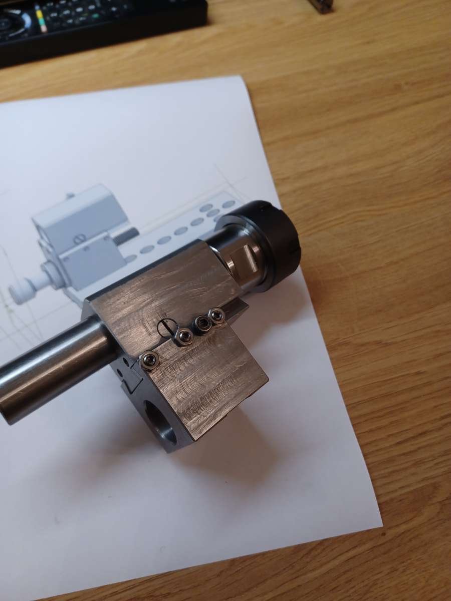

                                              I have had a little time to start to make the angle plate holder and a few other bits.
                                              20250118_10141420250129_111823
                                              the side of the angle plate was finnished except for machining the top radius and degree markings. The top sllde fitted to the angle plate well and machined the base plate with no problems.
                                              20250129_153610
                                              next to start making the top slide screw and plate.

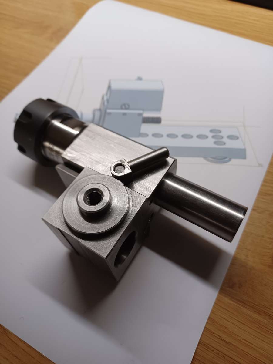

                                                @davidgeorge1

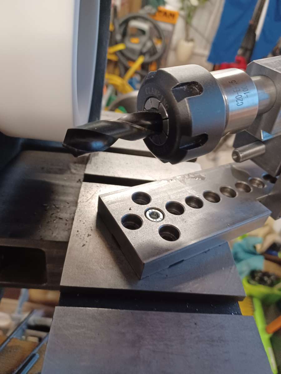

                                                First assembly of two parts for a try out. I tryed a drill in to the collet holder and it looks good.
                                                20250131_152151
                                                I have drawn up lots of small parts so I hope the wether isn’t to cold.
                                                David

                                                  @davidgeorge1
                                                  Drawing of assembly with collet set.
                                                  assembly top slide collet holder
                                                  David

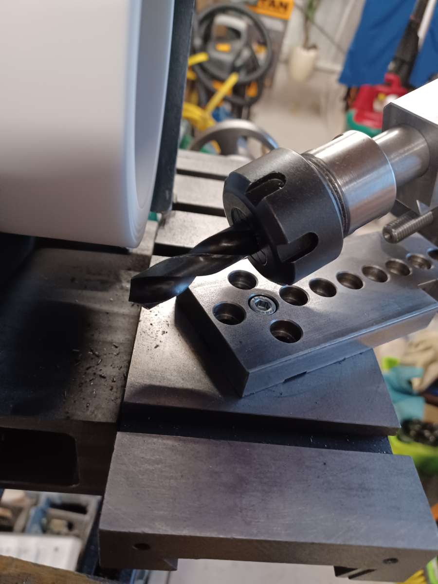

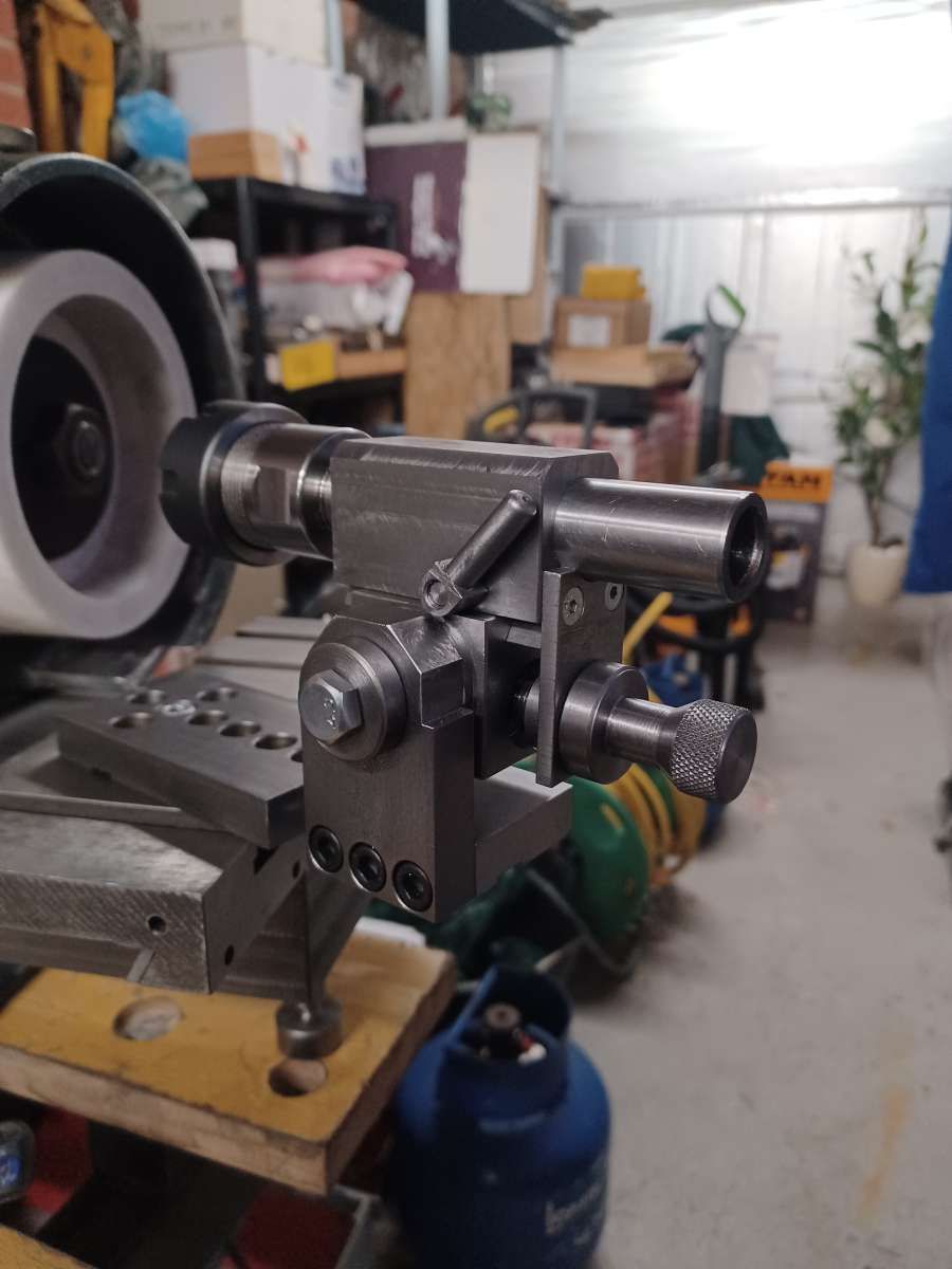

                                                    David George 1
                                                      @davidgeorge1

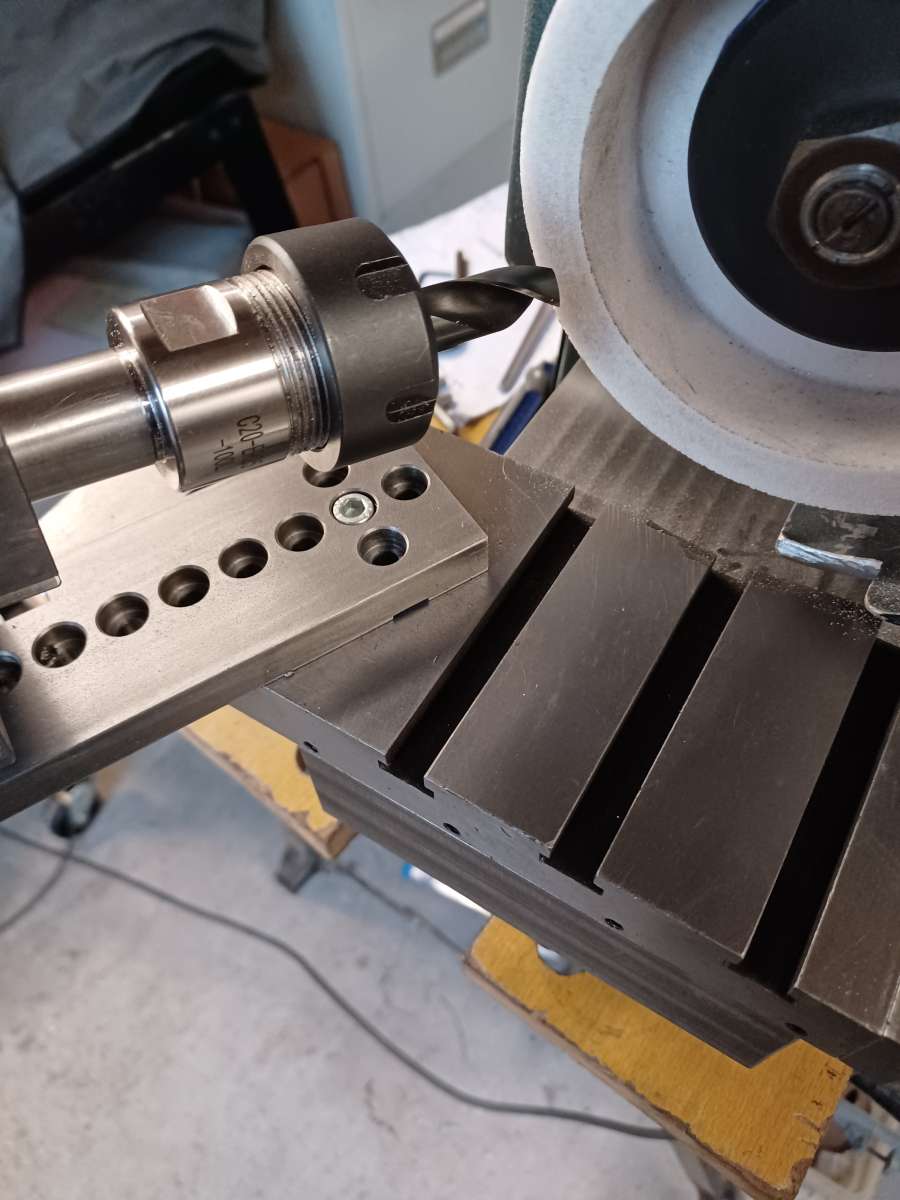

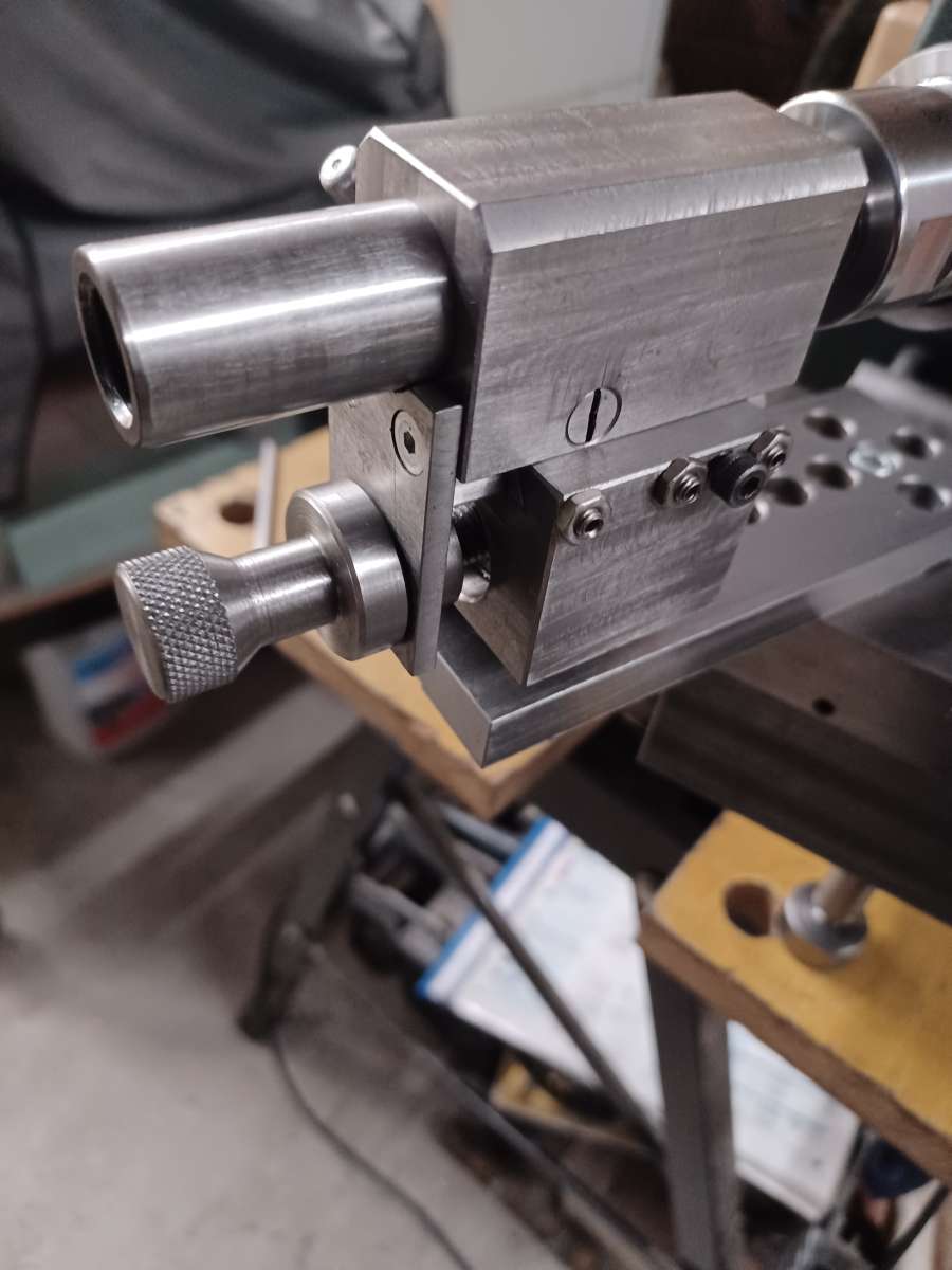

                                                      The Mod isn’t finnished yet but I have enough done to give it a try out sharpening a drill. just set the angles roughly and it seems to work very well to grind a slit point on to a 12mm drill.
                                                      20250208_163415
                                                      Back clearance angle
                                                      20250208_163853
                                                      front cutting edge looks ok.
                                                      20250208_164822
                                                      The drill looks very good and sharp.
                                                      David
