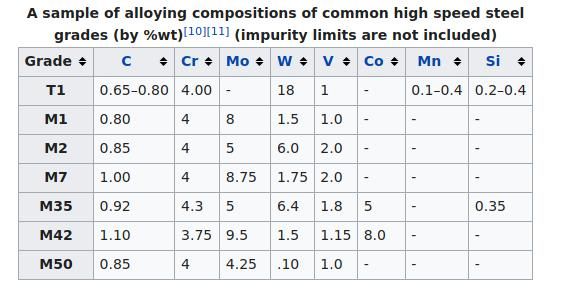

They are of 'tungsten steel', which I guess isn't quite HSS…
Actually, I suggest, nowhere near HSS. Normal O1 type gauge plate has 0.5% tungsten. Record plane blades were described as Tungsten Steel and they, like gauge plate, do not have the hot hardness of HSS. Most hardenable steels have various small quantities of elements such as vanadium, chromium and tungsten to modify the behaviour of the microstructure during the heating, quenching and tempering process. I suggest that in every day model engineering terms tungsten steel is no different to carbon steel.
Rod
Probably not, but in every day model engineering use at hand-driven speeds at shed temperature, not greatly different from HSS either.
Well, except HSS might be a Tungsten Steel! (Table from wikipedia.) Note T1, M2 and M35 all contain more Tungsten (W) than anything else.
