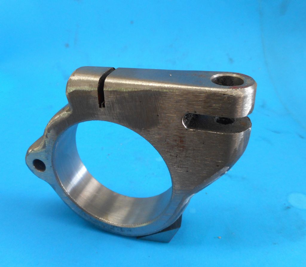

      WIP
      Made to take the Pillar Tool accessories.

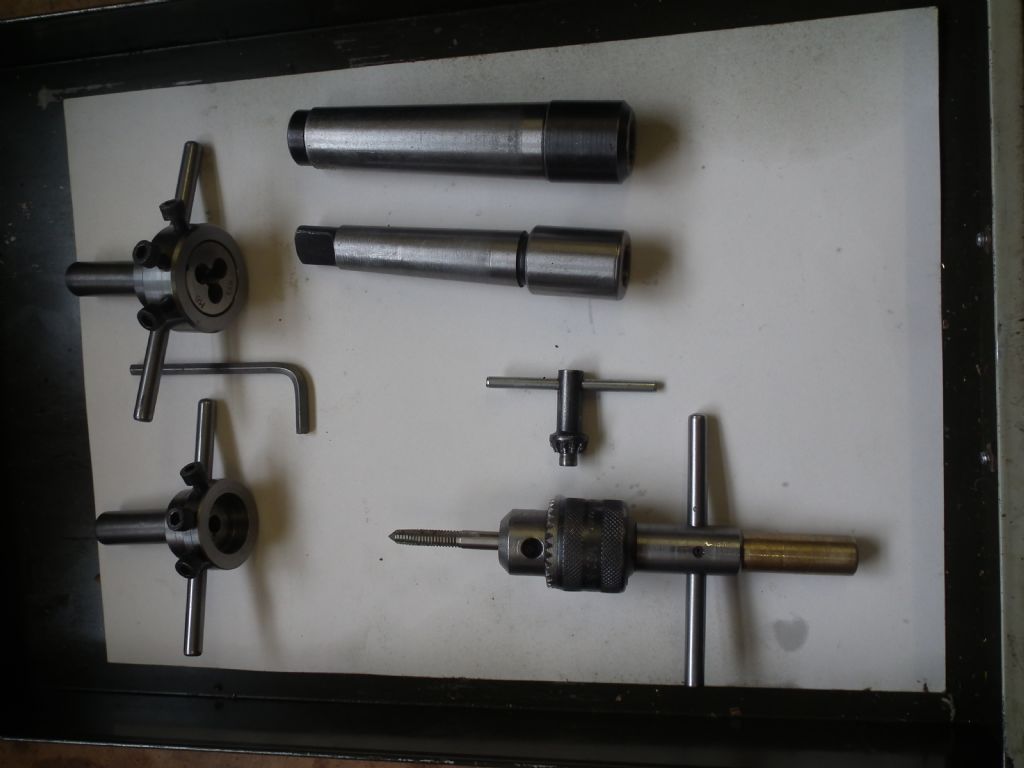

                Here's my approach to this issue. :-

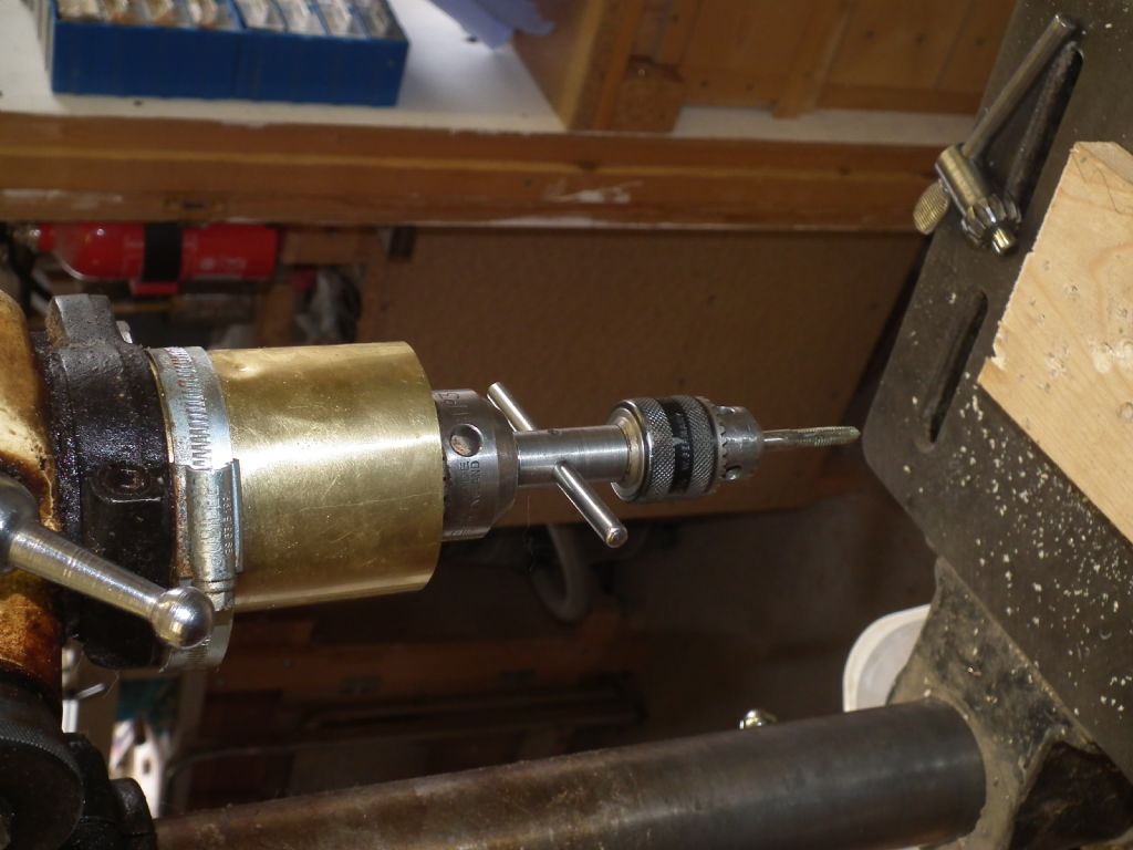

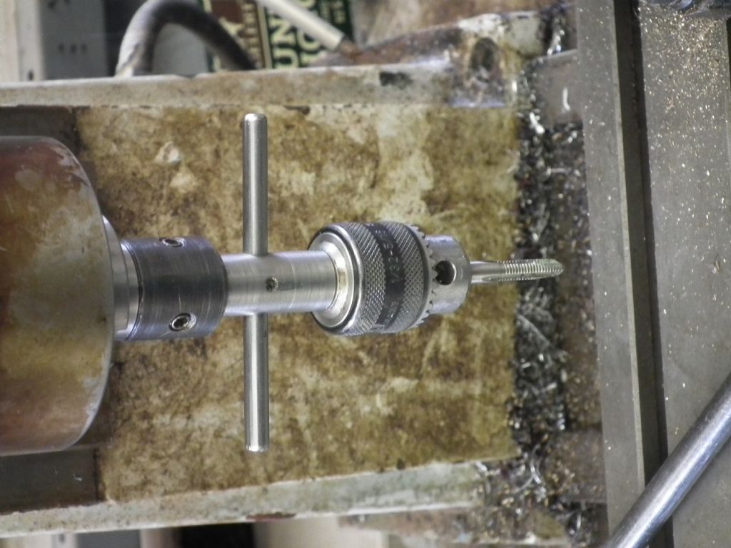

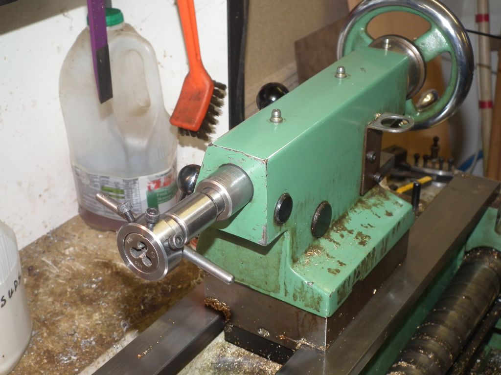

                I have a tap-holder (jacobs chuck) and two different sized die-holders on 1/2" shanks, and A pair of MT adapters for my lathe tailstock and mill spindle – on the drill-press I just use the chuck jaws. This set-up will deal comfortably with thread-sizes ranging from 12 BA to 3/8", and can be used to start larger threads which can then be finished by hand. If a non-cylindrical thread's position and alignment are critical, I'll usually set it up in the milling vice to ensure accuracy.
                Use in lathe tailstock (the die holder is hollow) :-
                Mill spindle :-
                Drill-press :-
