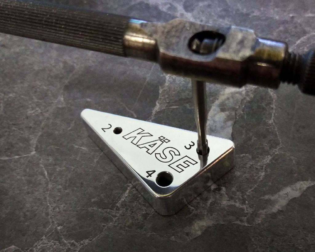

                  I made myself this tiny tapping block for small diameter work:
                  When I first started planning to build my little CNC mini mill I figured that I'd need a way to drill and to tap into the edges of alu plate in a somewhat accurate and perpendicular manner, so had this made – those top hats have proved very useful time and time again:
                  Wal.

                    I did laugh at the Kase slice! It has a lovely finish for a workshop tool, I seldom have the patience.

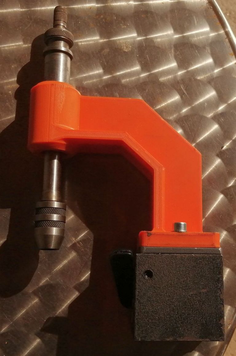

                      A problem with many of the freehand tapping guides I've seen is that you need two good arms to operate them: one to hold down the guide and another to turn the tap.
                      On iron and steel a guide like the Gator that had a very strong on/off magnet that left the actual work area unmagnetised might be a solution, but on brass and aluminium I'd still have to faff about with clamps of various kinds.
                      Because a magnetisable Gator-type guide doesn't exist, afaik, when tapping freehand on flat surfaces I nearly always have to resort to just eyeballing it.

                      Peter Ellis 5
                        @peterellis5
                        I´ve been considering a 3D print of the Gator design. Incorporating magnets seems a good idea.The variations in shank diameters would probably mean making several.

                            Posted by Jon Lawes on 28/03/2022 00:50:04:
                            Edited By Jon Lawes on 28/03/2022 00:50:42
                            Hehe – yep, it was literally a bit of scrap that I was simply going to drill some holes in – then it turned into an 'evening project'…

                                                    Peter Ellis 5
                                                      @peterellis5
                                                      tapping fixture.jpgWIP
