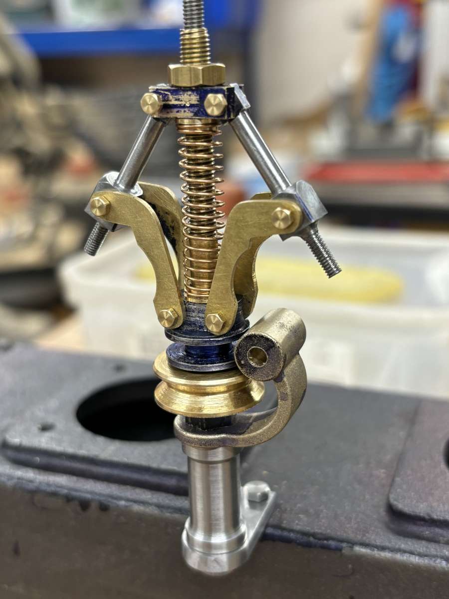

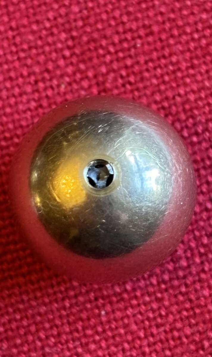

      I’m currently building the Stuart governor and am on the final component, drilling and tapping the Phosphor Bronze balls. I made an Aluminium collet to hold the balls as advised by the very helpful Tug, and all went well in terms of drilling the 2.05m hole for tapping 7BA.
      Holding the first (taper) tap in a a T handle wrench guided by a spring tapping guide in the tailstock chuck, I started cutting the thread using cutting fluid and regularly reversing the tap, and managed to tap almost to the required 3/8 depth, then disaster struck.
      So now I have 2 problems, firstly sourcing another ball and secondly working out how to avoid repeating the problem.
      I have struggled to find 5/8 Phosphor Bronze balls, Stuart provide them only as part of the fittings kit but that would be an expensive way to buy them. My thoughts are to use Brass balls which are readily available, and the difference in density is negligible (8.73 gm/cm3 vs 8.86 for Phosphor Bronze).
      So firstly, can anyone advise where to source 5/8 PB balls at a sensible price, if not I will just go down the Brass route. Secondly, any views on what I could have differently to avoid breaking the tap would be greatly appreciated!

        On small threads like that although you were backing off to break the chips they will build up around the tap so worth withdrawing and cleaning the tap maybe half way through. Alternative is a spiral flute tap that will push the swarf up out of the hole.

                Try soaking the existing ball in a saturated solution of alum. Watchmakers use it to get broken steel screws out of brass. May discolour the ball but should turn the broken tap to mush.

                      Use Alum powder from your friendly
                      indian spice shop, mix up a strong solution and dunk agitate the solution down the tap flutes with a hypo and you should see black gunk which is the tap being dissolved. Use warm if you can it speeds things up (be Patient) and the alum will not damage your bronze ball. Only works on non ferrous.

                                  Thanks all for your most helpful suggestions, I will have ago at recovering the first ball and drilling & tapping the second using the above advice, and change to Brass as a fallback if needed. The video is excellent, Joe gives a very clear explanation as to the most likely cause of my tap breaking – and I had no idea the plunger in the spring loaded tap guide was reversible! Will report back in due course when the weights are fitted to this…..

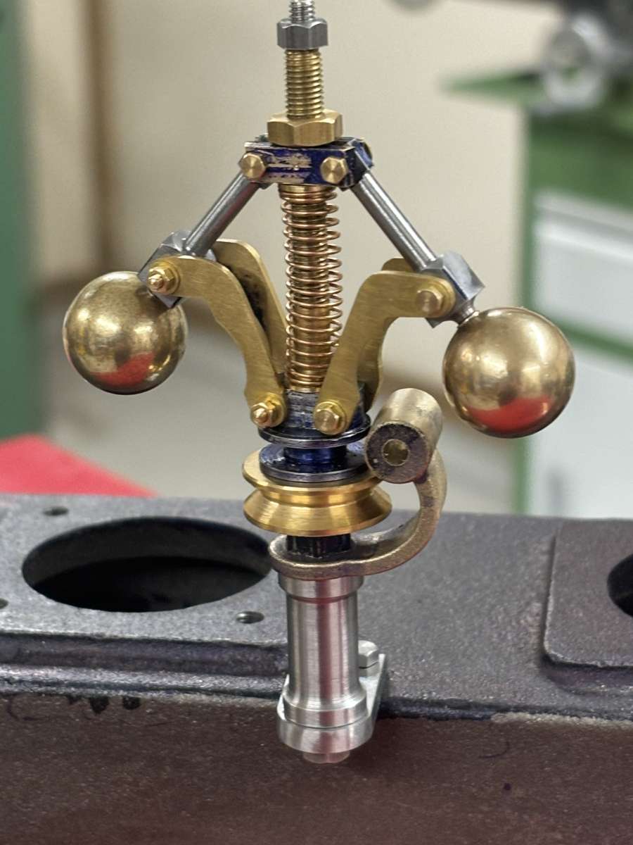

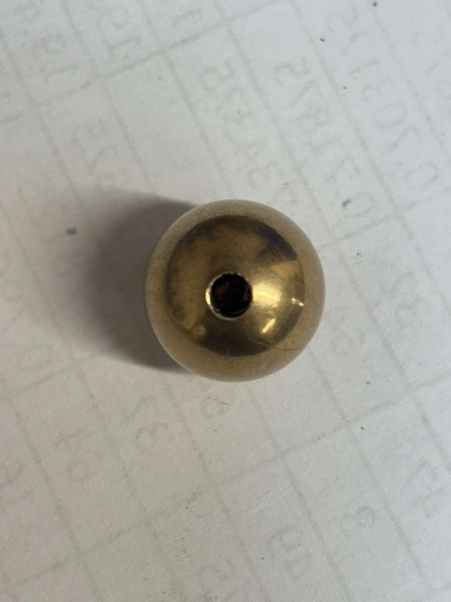

                                                    so this is what happened…. I drilled the tap out successfully using a Carbide drill (advised by Tug) then fitted a Brass bush tapped 7BA, and also fitted a bush into the second ball. This has been a very instructive exercise in terms of working with Phosphor Bronze, tapping technique, and removing a broken tap. Also I did purchase a bag of Alum so have put the other part of the broken tap in that to see what happens! Thanks all for your very helpful advice.

                                                      Nice work, nice result and a good save Steve 😊
                                                      Governor looks great 👍 👍
