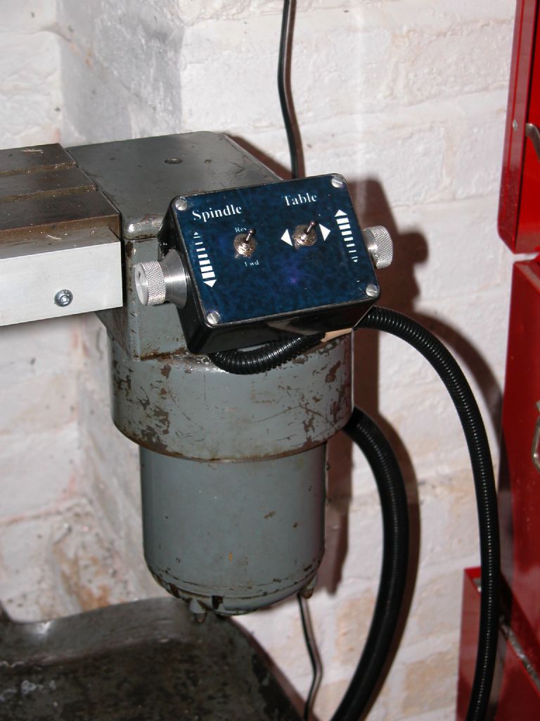

                              I fitted VFDs to my Centec 2B (X-axis and spindle) and made a small control box that's attached to the end of the table. When the workpiece can be put on the table I always tap under power. I don't have spiral taps. The slow speed and forward/reverse switch provide excellent control for power tapping. I use the quill digital depth gauge when tapping blind holes.
