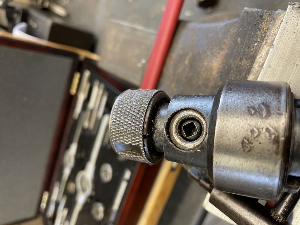

      Clutch tapping head
      #642265
      Boiler Bri
        @boilerbri

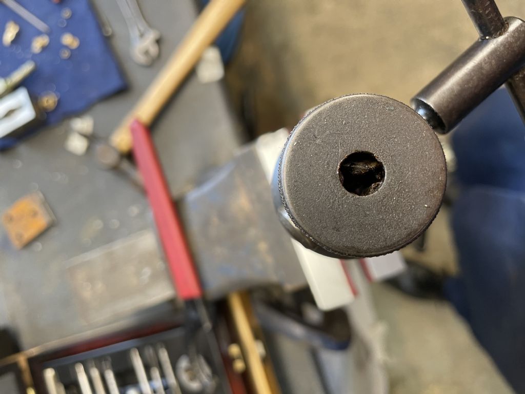

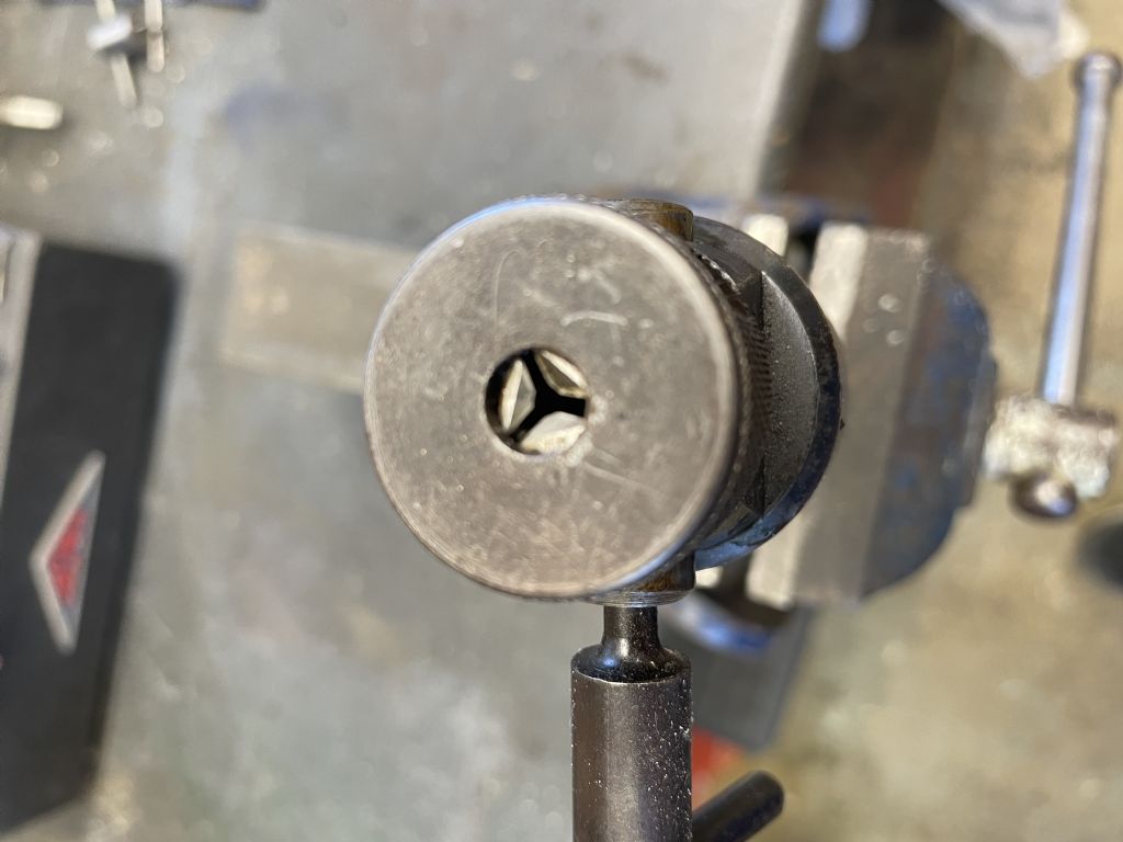

        703fafd9-612f-4c8e-8650-b1ba60504b23.jpegIn my tapping head one of the jaws has slipped and because of this the tap is not held straight. Has anyone taken one apart?
        I can not see how to get the knurled ring off.

          It has a threaded ring at the rear with two slots

            That ring can be a right pain to undo if its gotten tight or gummed up over the years.
            Best to make a clamp ring thing bored to sit neatly on the round casing behind the slotted ring with two sheet steel fins to engage in the slots. With the ring sitting securely the fins don't cam out of the slots so it's much easier to get things undone. You seriously don't want to damage the slots.
            Naturally if you do go to the trouble of making tool it will come undone really easily.
            The proper tool for such things is pretty much a simple friction opening divider with flat bent over ends so those rings are clearly not supposed to be vey tight.
            The quick and dirty tool is simple sheet steel U with the ends bent up to fit the slot. I find that style, and the proper divider like adjustable one, hard to hold in proper alignment so one or both tips jumps out when I try to turn things. YMMD.
            The jaws are simple triangle shapes held apart to fit the closing cone by springs. Tipped jaw usually means a damaged spring. A spring from retractable ball point pen (Parker knock off perhaps) cut down nicely to fix things when I had that problem many years ago.

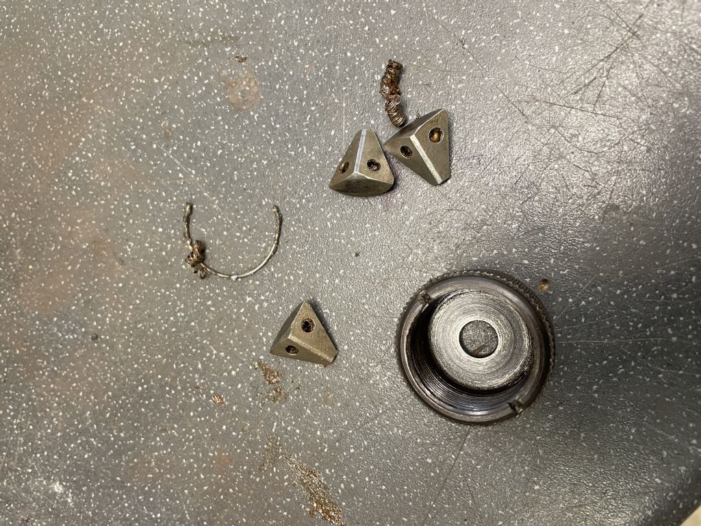

              Finally got in in bits. There was a small circular spring clip stopping the top screwing off.
              The jaws are ok it’s the springs that have collapsed.
              happy days.

                  The springs are .25mm wire size and 3mm o/d I recon the length would have been around 8mm to 10mm ??
                  Looking around there are some on eBay for about £10 for the three. Does anyone know anywhere else to look?

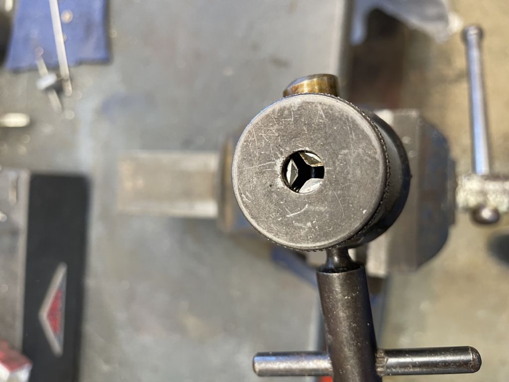

                      I have some 3.05mm O/D, 0.45mm wire dia, 10mm long if you want 4 of them.

                        img_2178.jpegFinally got some springs and it’s all as good as new.
                        Thank you for all your help and offers.
