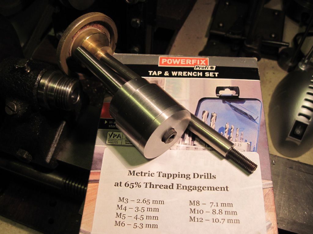

                                IanT
                                  @iant
                                  Martin,
                                  For my bread & butter metric tapping in mild steel, I use an inexpensive set of taps (purchased from Lidls) and they seem to work very well. They also came with a matching set of "tapping" drills & the one provided for the 8mm tap is 6.8mm. However, I found these tapping sizes to be hard work in mild steel – so I don't use them.
                                  Instead I use the 65% flank engagement recommended by Tubal Cain in his ME Handbook (my copy is the 1993, 8th version – page 63) which for an 8mm (1.25mm pitch) thread is given as 7.1mm. These sizes work very well and makes tapping a far more relaxed process – and I've never been concerned about the strength of anything I've tapped using this thread engagement.
                                  To save me reaching for the book every time – I've stuck a reminder from Tubals book on the box. Just my experience…
                                  Regards,
                                  IanT

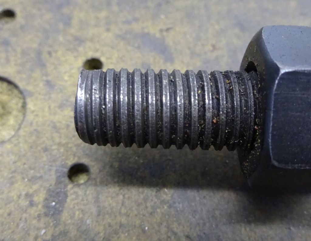

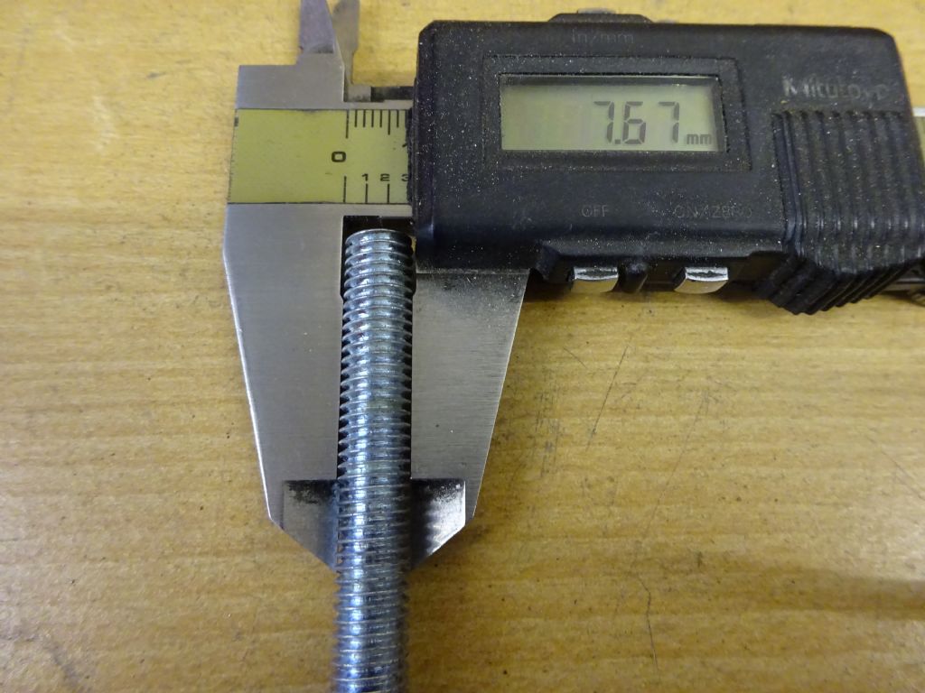

                                                    #433878
                                                      You don't say whether you are making the studs to go into your tee nuts or using off the shelf studding but if the later then it is worth measuring that before deciding if you can up the tapping drill size. Some studding is quite a bit under size so the percentage thread depth can drop quite a lot if you use a larger drill.
                                                      Some typical M8 studding.
                                                      And a M10 stud that looks like it was roll threaded on undersize stock
                                                      PS i'm mostly on the 6.8mm side of the fence
