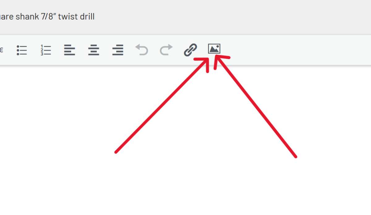

        Hi Les,
        Square tapered shanks are used in a Joiners Brace.
        Pictures can be inserted using this icon.
        Screenshot 2025-03-15 154202
